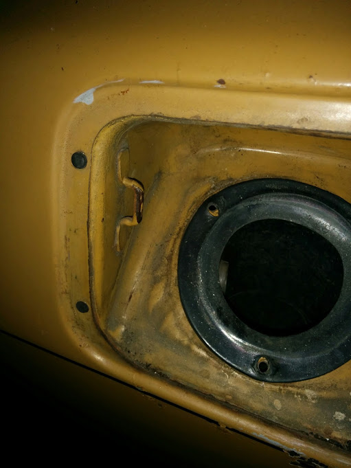

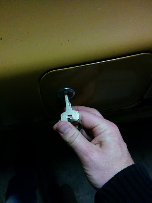

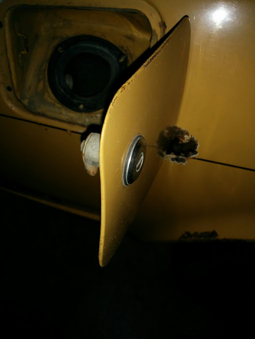

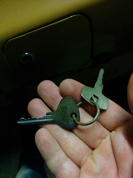

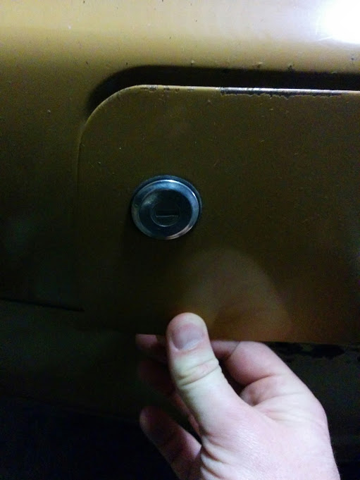

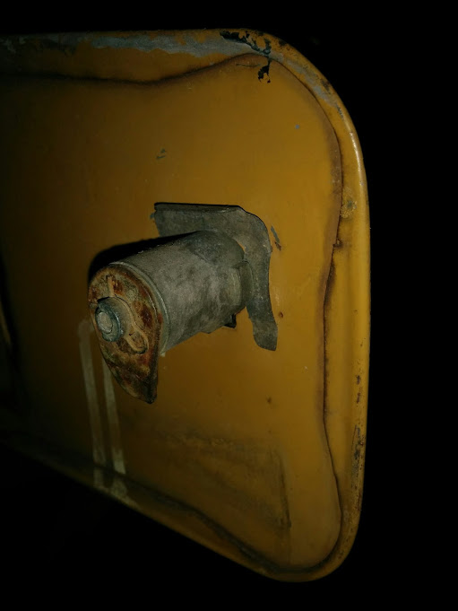

Here are some photos of an early AU delivered 240z I'm restoring. You can see the early style key, the locking mechanism and the bracket it locks with.
 Nice. It looks like it was keyed to match the doors and the hatch. I like it. Much cleaner look than the protruding twist knob. Is everything the same on the body and the door the same as US models except the lockset?
I assume so, but have never seen the US fuel door (or taken much notice of the differences). That's why I took those photos so you could compare.

 I don't have door locks to look at BUT the hatch lockset EXCLUDING the removable offset tab from a late 71 is the same length as the early 71 turn knob INCLUDING the offset tab. Conclusion, a fabricated straight tab on the hatch lockset (Easy Peasy IMO) would work with the original wire catch on the body.
 A bit of blacksmithing on the ends of the appropriate ga. wire for the catch (perhaps a pc. of welding rod) a couple of holes and screws or pop rivets to hold the catch in place would be easy on later Zs. The only problem on later Zs is the lack of a hole. This "easy peasy" mod is based on the assumption that the diameter of the hatch lockset is the same or smaller than the orig. gas lockset and won't interfere with the cap. I think the locksets were all the same diameter.
