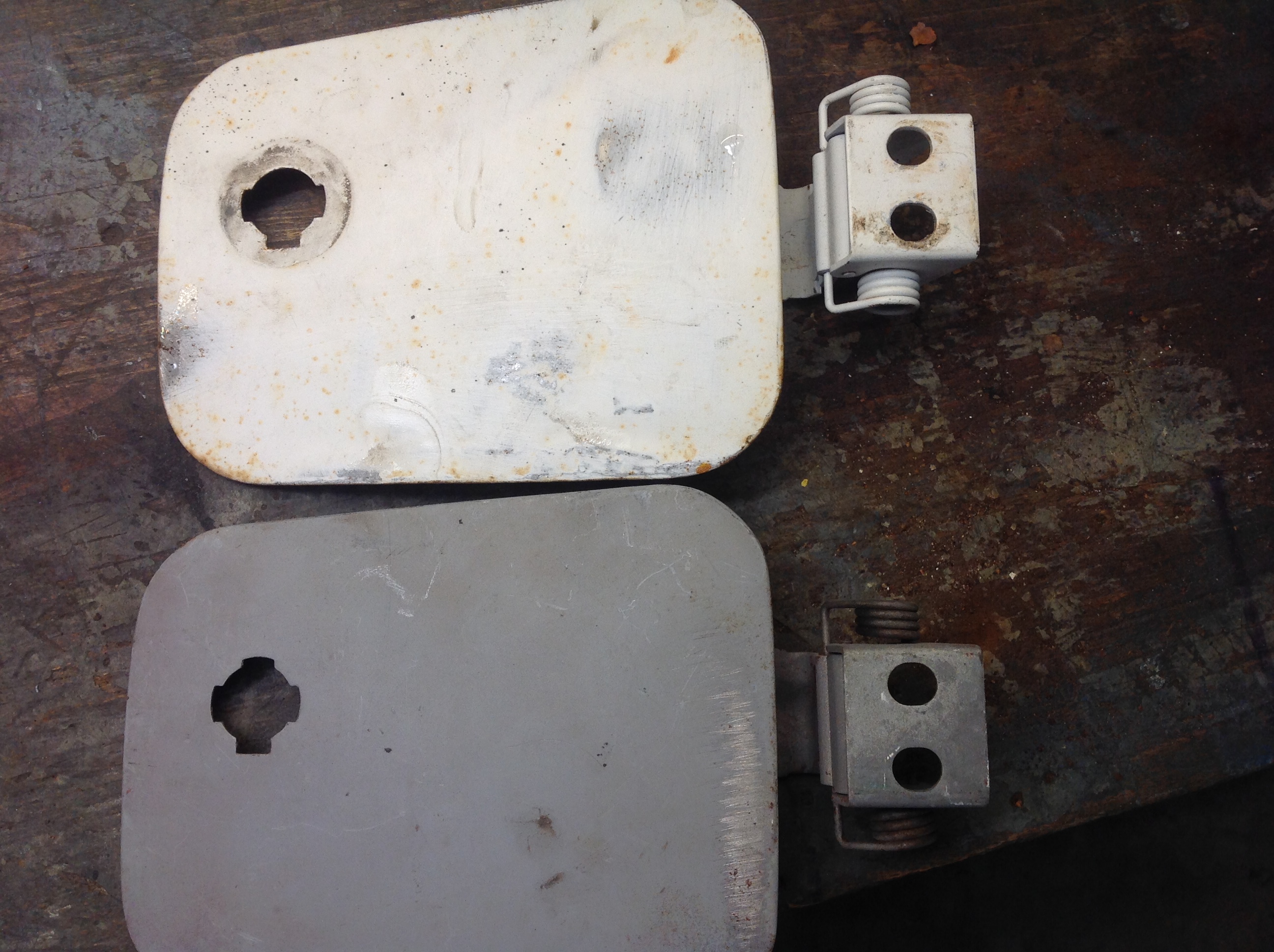

I have lots of cylinders and gas doors with latch holes to test out.  There are cylinders with three or fours tabs that align the thing in the holes in the doors (or gas covers!) , early had 3, later 4, but a slot can be added to a hole or a tab ground off a cylinder. No biggy.
Velly Intellesting...  (tell me where that came from and how said that way for extra bonus points...)
The "stash" reveals not one but two different gas door with latch hole configurations. The three slot and the four slot.

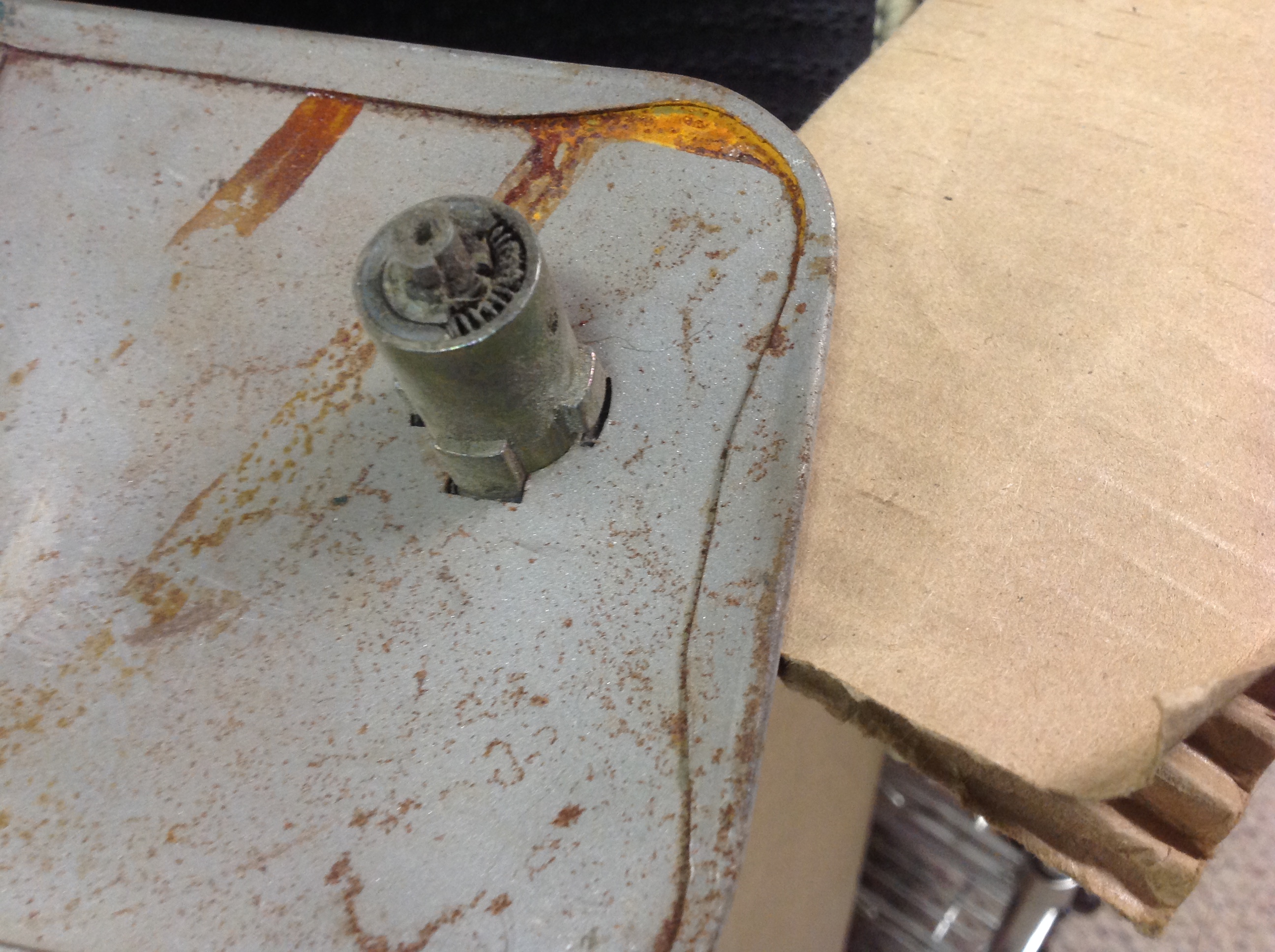

The good news here is that standard door cylinders slip right in there like they belong. Either three or four tab styles. Either can be positioned in any orientation.

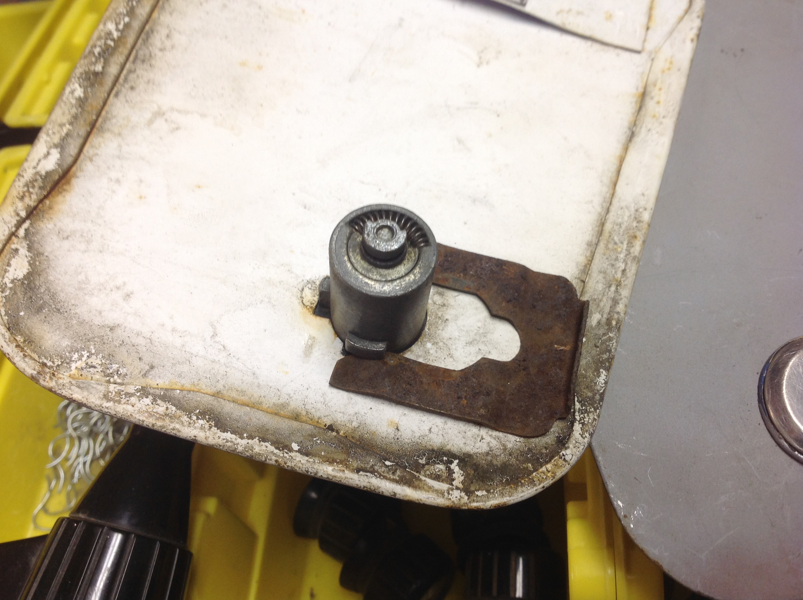

Standard lock cylinder retaining clips work just fine too.
Now the only remaining issue, other than creating some rear brackets to fit on the end of the cylinders that will engage the body mounted loop, is that door cylinders may not have the correct "action".  The key when inserted, can be turned left or right about 60-70 degrees, where the key cannot be removed of course. Is this enough to swing the rear mounted bracket up or down enough to clear the loop to allow the door to open?
I envisioned that a gas cap lock cylinder would be rotate 90 and stay in either position, rather than the spring loaded auto-return action that a door cylinder provides.
Anyway, I think this still would be a workable solution. All you need to do if you don't have a door with a hole is drill one in the right spot and file/dremel in some clearance slots.
