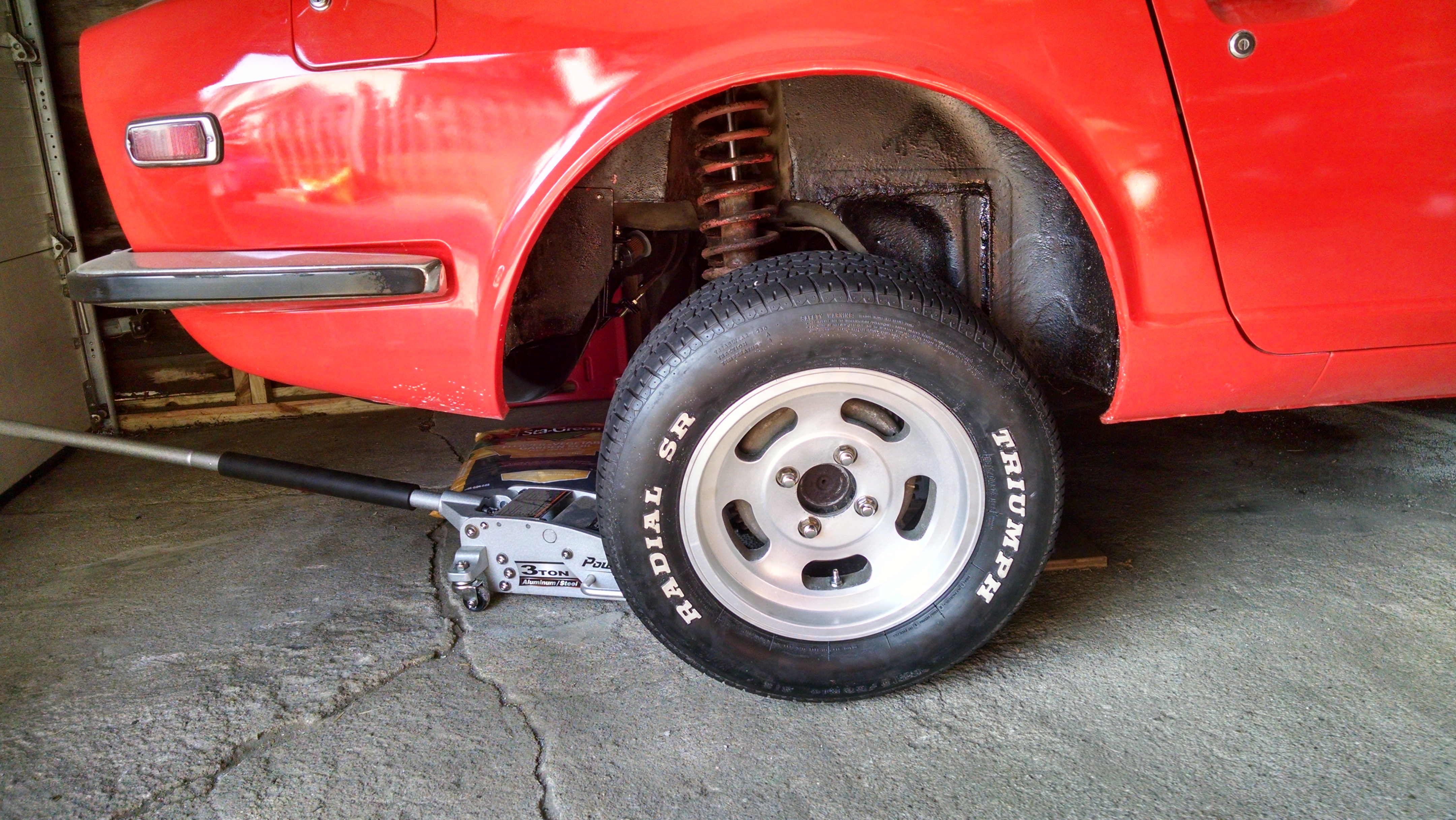

So, I put the wheels back on last night, and went to roll the rear passenger tire.  For one it was hanging very low in the corner.  2, it did not want to roll forward easily.  If I put enough rotational force on the tire, the corner would actually lift up and then roll over maybe 90 degrees and would then fall back down. If I keep doing this it will keep spinning and lifting, as if going over a hump.
If I jack the corner up enough (to roughly where the rear drivers side corner sits when in the air) it will roll freely.

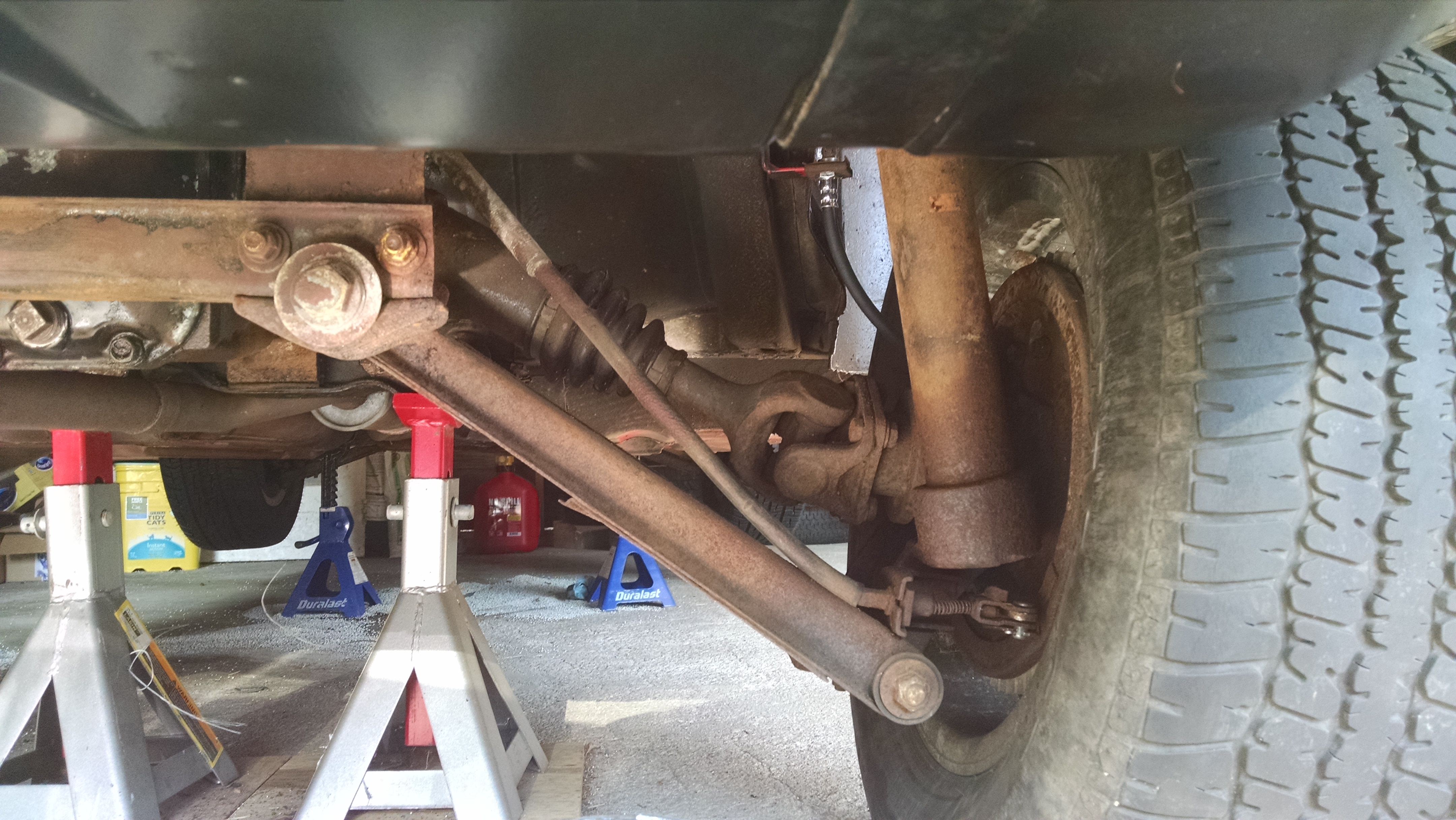

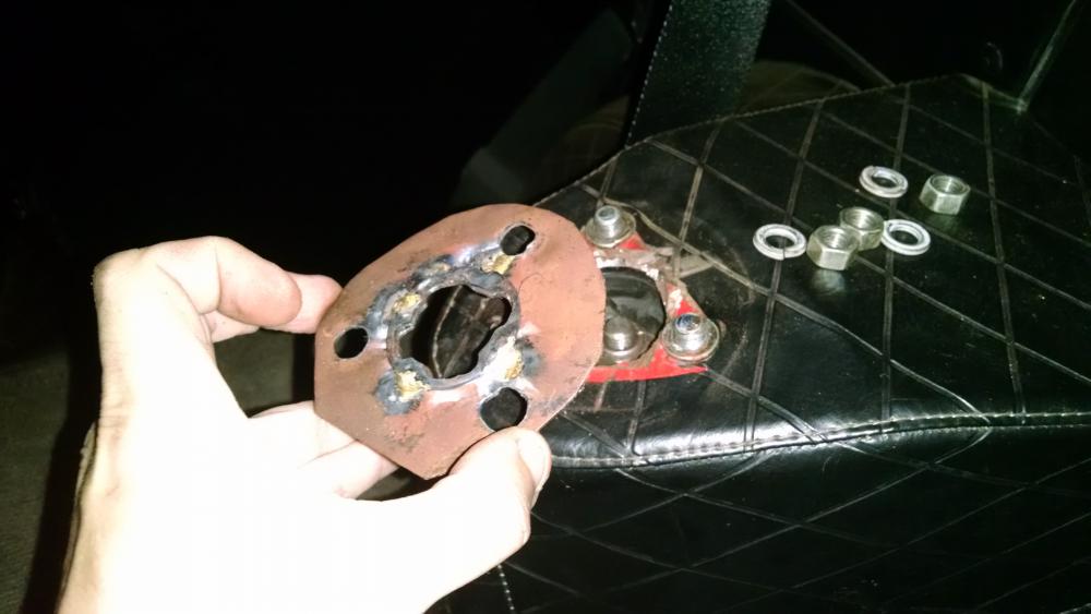

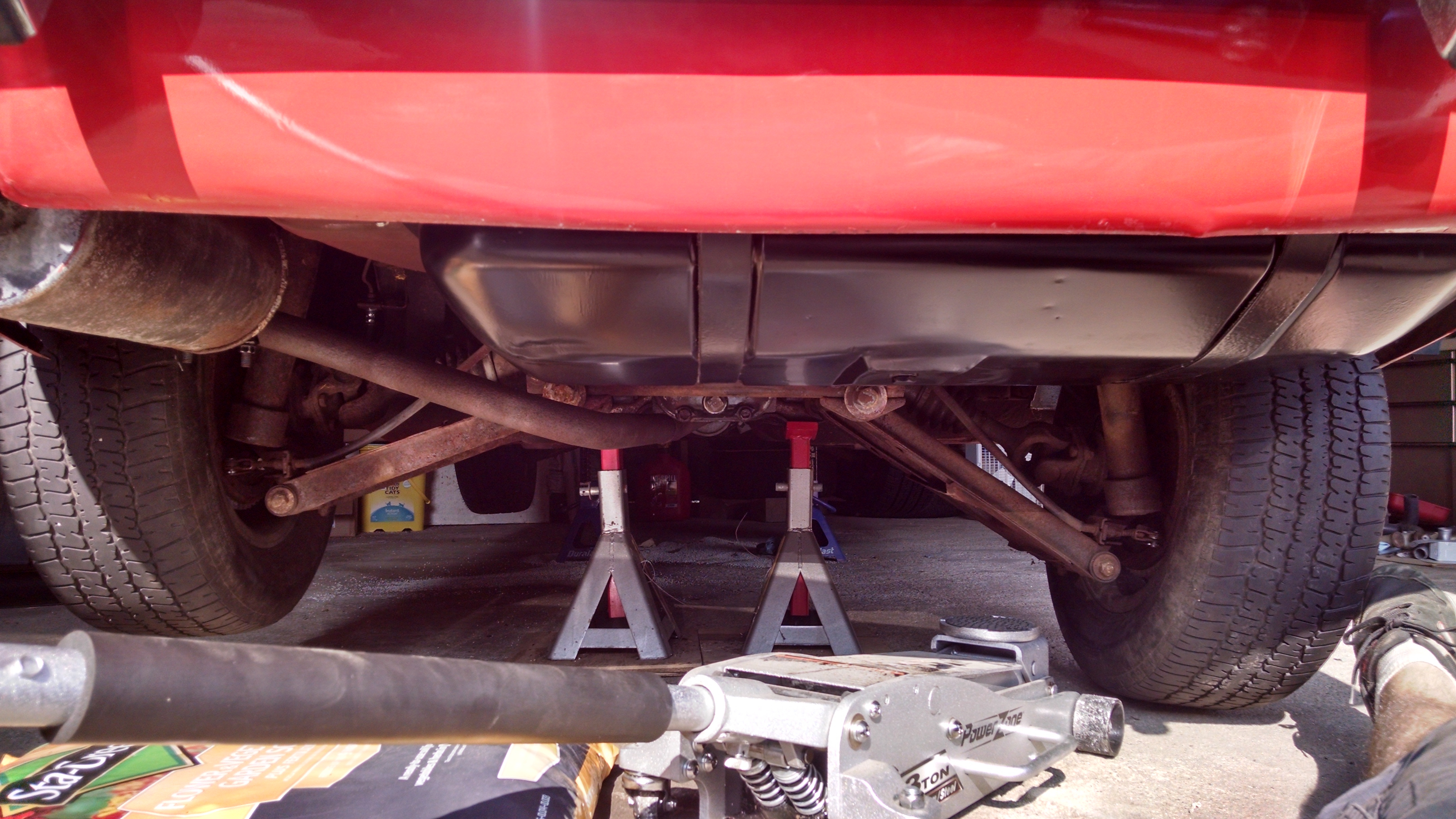

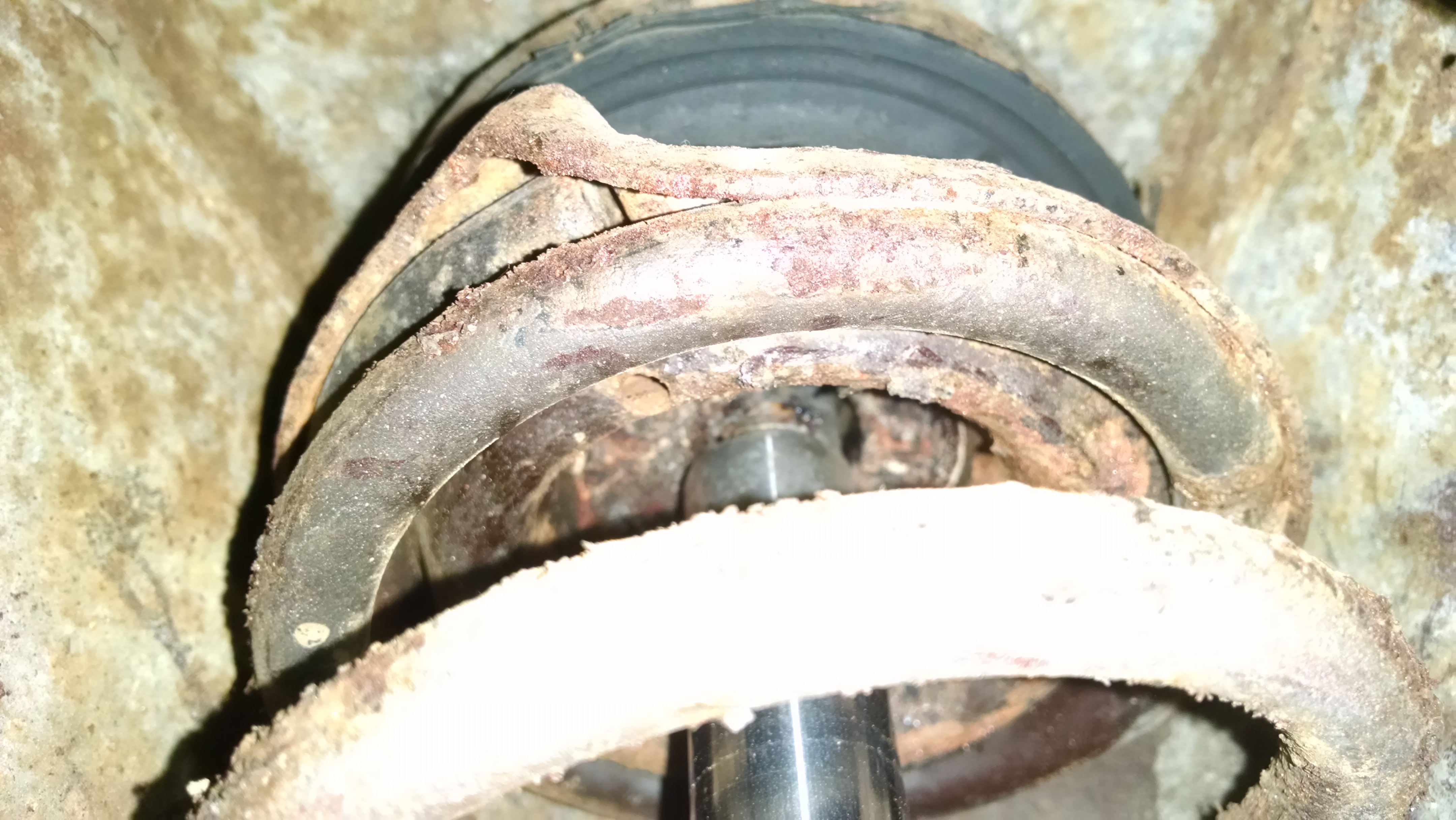

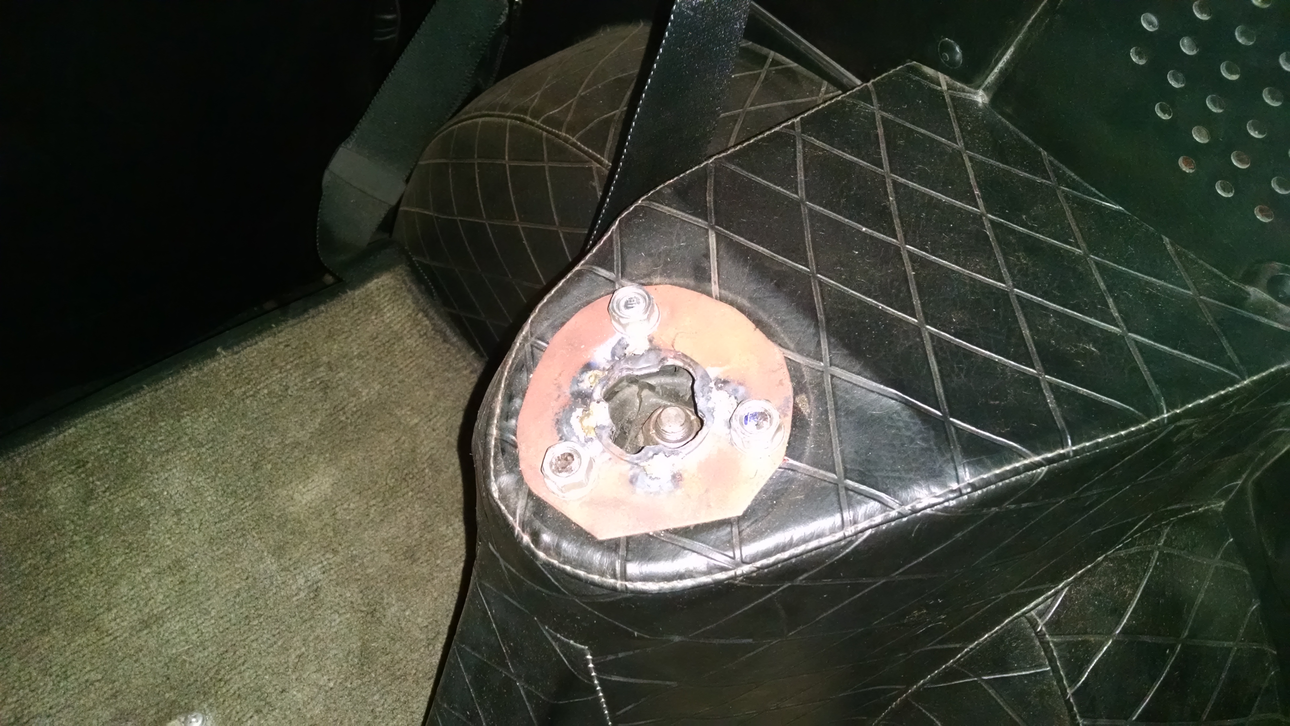

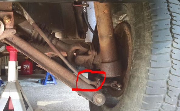

Some more info for you guys.  It definitely seems to be the strut or something related to it. Attached are some photos that may shed some light.
I wasn't super excited to find the little custom plates on top of the struts, not really sure why they are there and what was removed/done prior to them. Seems like some metal was knocked off in that area, although i couldn't tell you why. Maybe to get more access to the nut at the top of the strut?
If i had some spring compressors I would have taken the strut out and taken a look up top, but that will have to wait.

Are those pictures with the car on jacks or with weight sitting on the wheel?
You can remove the strut without removing the spring.  Disconnect the brake parts and the halfshaft.  Described in the Rear Axle chapter of the FSM.
Car will always be on jacks for these photos.  That last picture is with the wheel removed (i believe I am remembering correctly), so there is no additional hanging weight from the wheel, but i assume the spring is what is pushing it apart.
Seems likely that the strut is simply hyper extended. It doesn't look like the rubber bits are ripped up. Guess I'll be looking into new struts....  Since I don't have air tools I may attempt to get the spindle nut out of there so I can bring the entire assembly somewhere. Or disconnect the entire control arm and replace the bushings while I am at it.
and yes, unfortunately I think that cable has been loaded like that for quite some time in my garage.

BGM was probably on it then.  I don't know how the extension stops work inside the shock but yours looks way over-extended.  Might be damaged in other ways also.  Should be okay to drive but don't catch any air.
Copied a picture of what grannyknot was talking about.  That's not good.
