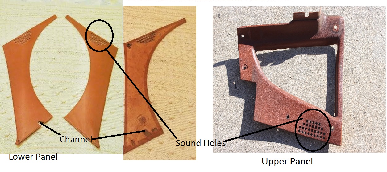

July 27, 20168 yr comment_499646 Hello, I didn't know there were the two speaker locations in those back corners; My back panels are completely solid- no sound holes. I do have the 2 speakers under the quarter windows. They mount in those big round holes under the window, and there are 4 threaded holes that you put screws through to hold the speaker. Then the plastic panel has the upper half of the sound holes and the vinyl panel has the lower half of the sound holes. The speaker wire goes from the speaker down to the hole at the bottom like your does. The vinyl panel has a small channel to help hide the wiring. I added two more speakers in custom boxes in the back, and the wires were routed along the main harness on the passenger side, under the seat and to the radio area. I did use the factory radio connector to the fuse box, but only for the power, as it only has connections for the two factory speakers. The photo following shows the panels I have with the sound holes, wire channel and clip slots hth Edited July 27, 20168 yr by TomoHawk Link to comment https://www.classiczcars.com/forums/topic/55838-oe-stereo-install-75-280z/?&page=3#findComment-499646 Share on other sites More sharing options...
