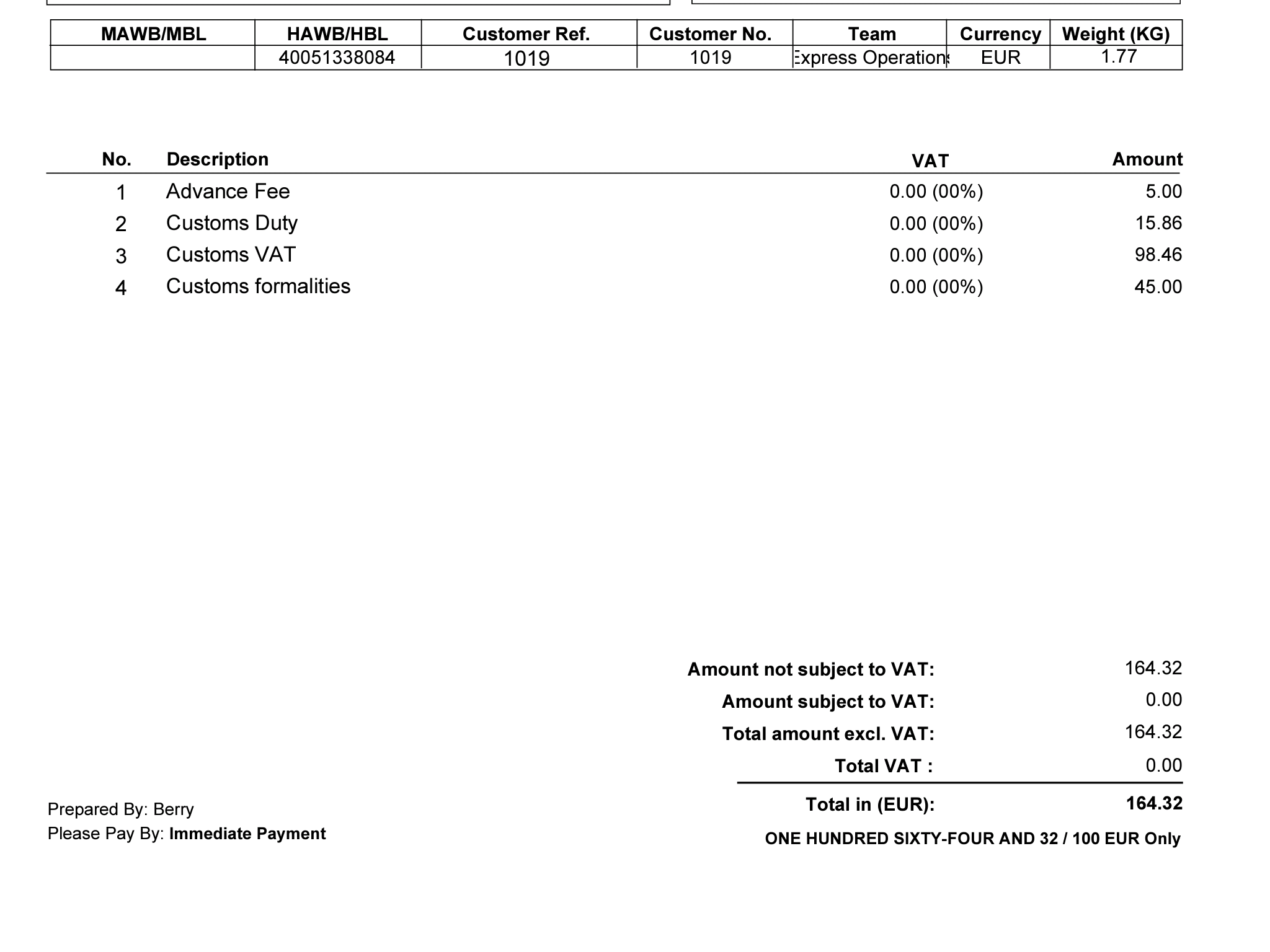

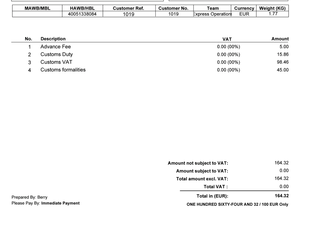

My experience on the shipping. USPS is by far the cheapest. FedEx, UPS, DHL, Aramex etc are all much more expansive. They all charge admin fees and customs charges where USPS doesn't.
I find shipping is often more than the parts and I have to pay 21% on parts, shipping and fees. See screenshot. Those prices are only fees and taxes. Cost of parts and shipping are mentioned.
Rockauto is great. They have been fast, easy to make purchase/payment and answered my questions when asked. I have used them a lot, but can be a problem when ordering more parts in one order. Parts can come from different warehouses and then the shipping, fees and taxes really take off.
To get around it, I have ordered parts and sent them to a forum member (both of them have not been online for a while now) and they send it through to me using USPS.
