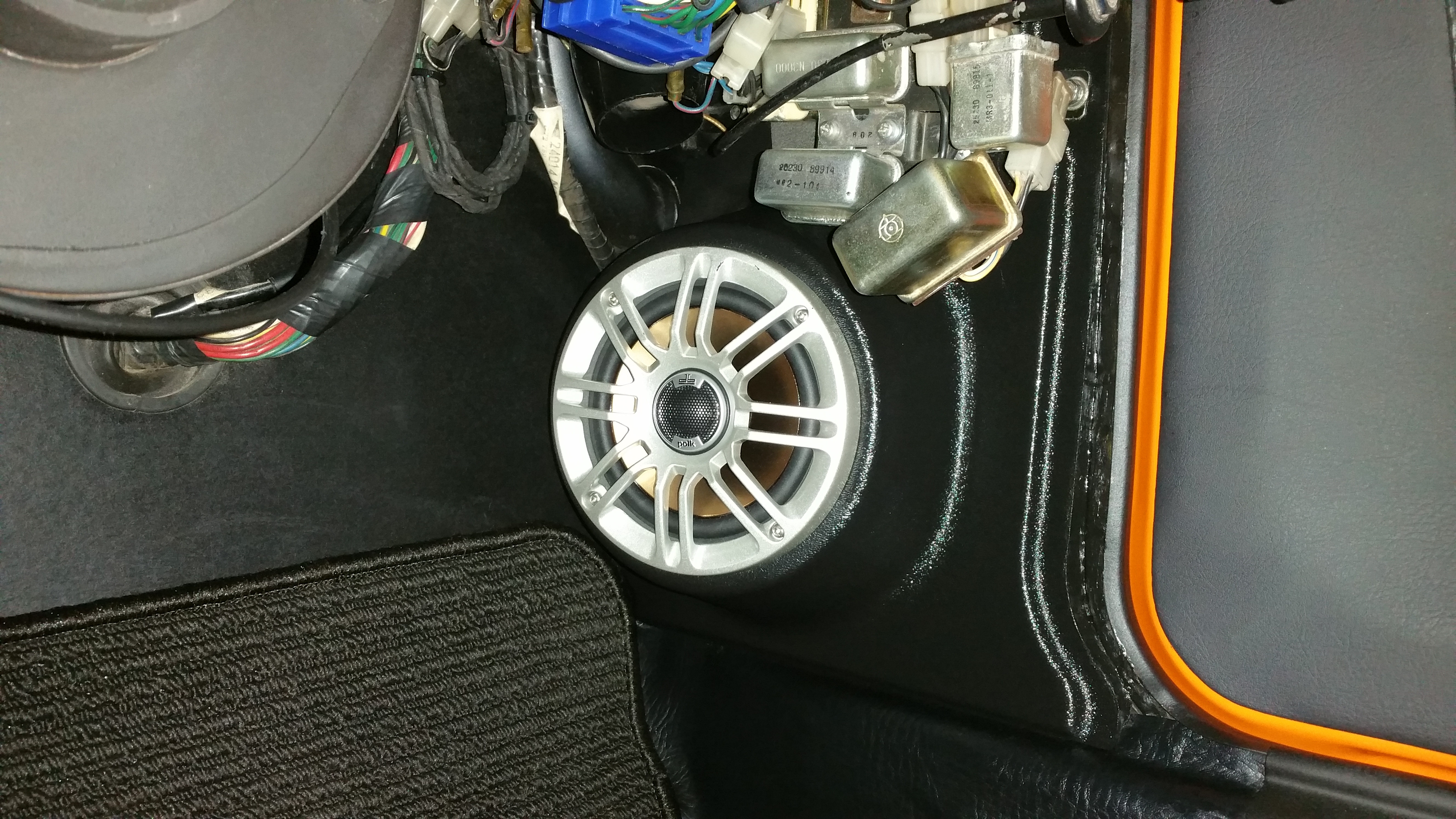

1 hour ago, ted66 said:
I also had painfully slow wipers. Don't Drive in the rain, so I didn't worry about it.  I replaced all my old looking relays with some nicer ones, including the wiper relay. My Wipers work great now- just a thought.
Impressive!  Any more details on what I'm looking at there?
