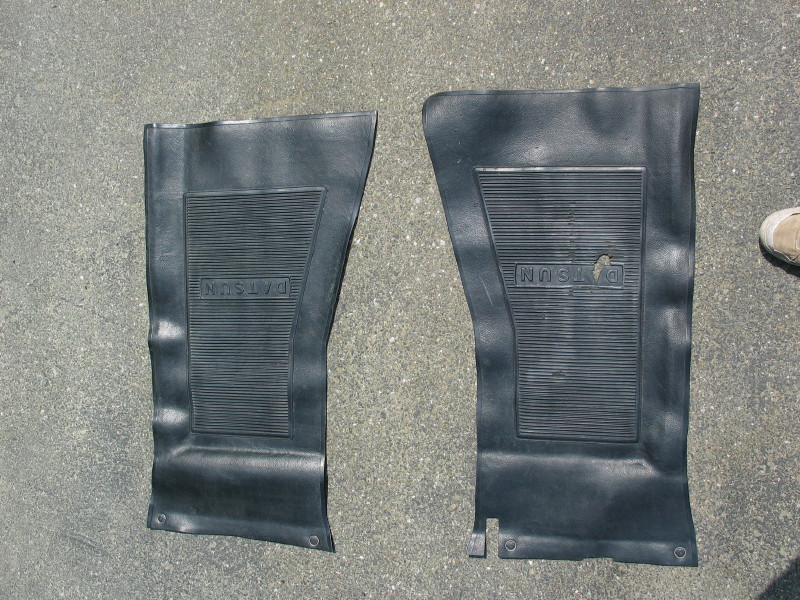

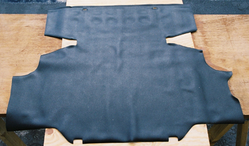

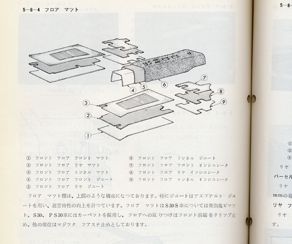

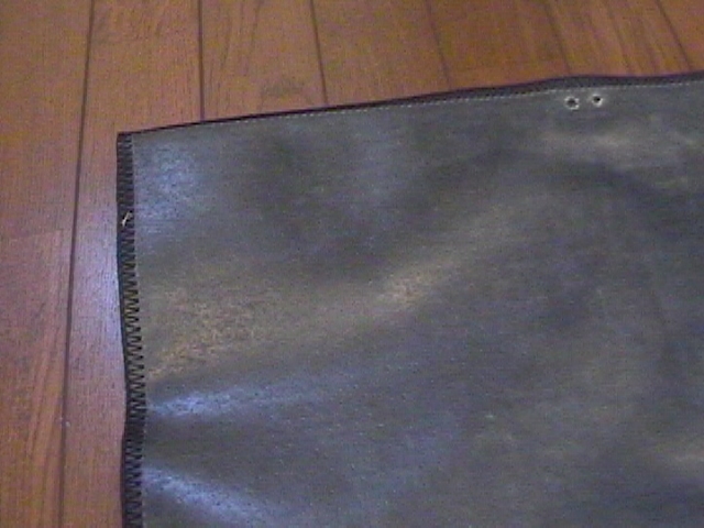

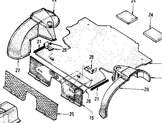

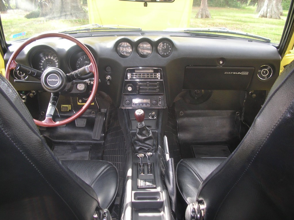

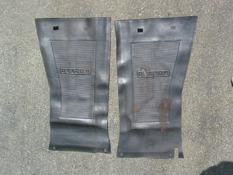

Some Pics I found of Rubber Floor Thingies
Figure 1.Ā  Rubber Floor Thingy Corner

Figure 2.Ā  Rubber Floor Thingy Location (Technical Drawing)

Figure 3.Ā  Two Rubber Floor Thingies.
Ā
Figure 4.Ā  Rubber Floor Thingies (Reverse Side)

Figure 5.Ā  Rubber Floor Thingies (In Situ)

Figure 7.Ā  Rubber Floor Thingy Location (Technical Drawing)
Ok, I have some time to write about this subject.
The very early imported cars (HLS30U, HLS30UV, and probably the Canada HLS30UN) arrived in rubber mat flooring spec, similar to the base standard S30 specification for domestic models.Ā  From what I understand, Chester and Harod supplied carpeting to port-of-entry service and distribution because Datsun USA chose to sell the cars with carpeting and I don't know why they didn't come from Japan that way.Ā  The S30-S Fairlady ZL came with carpeting.Ā  In the case of my cars, carpeting was most probably installed at the dealer along with hubcaps and other items shipped with the car in bags and boxes.Ā  The door panels and dogleg panels were typically shipped covered in a light "visqueen" clear plastic which was removed at the dealer.Ā  Seat belts came covered in a plastic bag.Ā  My original bill of sale lists carpets as standard specification.

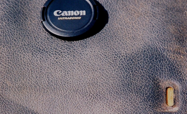

In 2007, a couple of guys with very low VINs bought some sixteen carpet sets at one time for their cars.Ā  I have two sets.Ā  I also have most of the original rubber mat.Ā  The picture of the mat with the lens cap is mine.Ā  The pictures of the foot well mats are correct.Ā  Notice the snap fittings for the firewall and the Velcro tabs for under the seats.Ā  The Chester and Herod carpets come that way.Ā  We discussed the "rubberized' clear backing to the loop weave when we bought the sets and decided that we wanted the backing for durability purposes.Ā  And that is what you see in another one of the pictures above.Ā  My sets came with cutouts for the luggage strap hardware on the rear deck carpet.Ā  I seem to recall some sort of edge binding conversation when the sixteen sets were ordered and that it was duplicated from somebody's "original" set.
I'm not pleased with the fiber insulation mat that I got.Ā  It is not anywhere close to the photos I have of stock insulation.Ā  But frankly, if you don't lift up the carpeting, no one will ever see it.
Let me know if you find a source to replicate the original rubber floor mats.Ā  I would be in for two sets.
