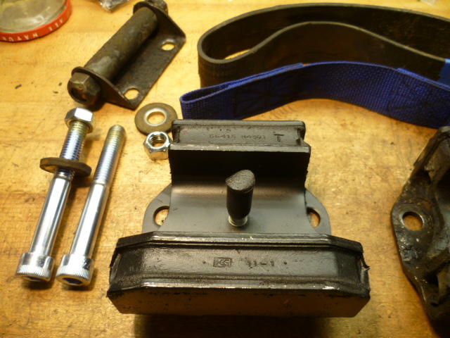

When it came time to put my new mount in, I changed the mounting hardware scheme to socket head cap screws instead of the original hex head bolts. I don't know if this is old hat or not, but my custom hardware looks like this. Socket head cap screws on the left in this pic:

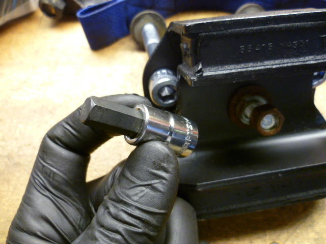

So what's the big deal about using SHCS there instead of hex head bolts? The SHCS allowed me to use a hex driver on my ratchet like this:

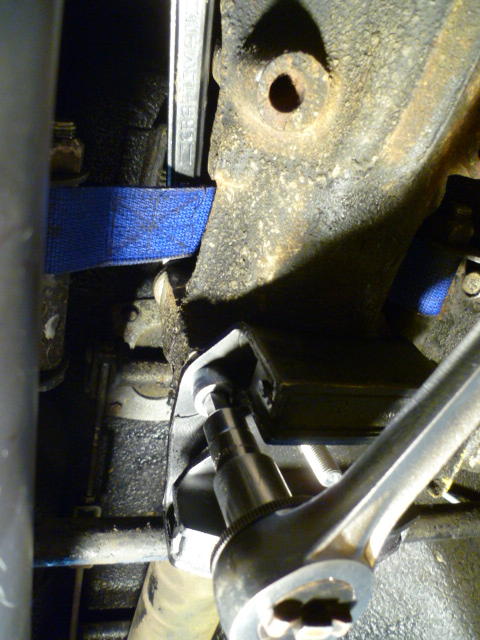

And tighten the bolts from the bottom like this. The hex driver clears the bottom plate on the mount so you don't have to deal with the original hardware anymore. If I ever have to mess with this thing in the future, it will be much easier to R&R. Box end wrench braced against the diff body to hold the nut on top and hex drive to tighten from the bottom, I found this much easier to work with than the original hardware scheme.
(Edit for new info) Only update I would make to the original procedure is that I would use a grinder to notch the diff mount plate a little bit to clear the heads of the socket head cap screws. The reason for that is the heads of the SHCS are taller than the original hex head hardware and even though I don't think I'm having a problem on my car, I can see the possibility that the lower plate of the diff mount may hit the heads of the screws if the mount is twisted enough. So just to be sure, I would take a little metal off the diff mount to clear the new screw heads.
But in any event, here's how easy it is to access the SHCS heads with the modified design:

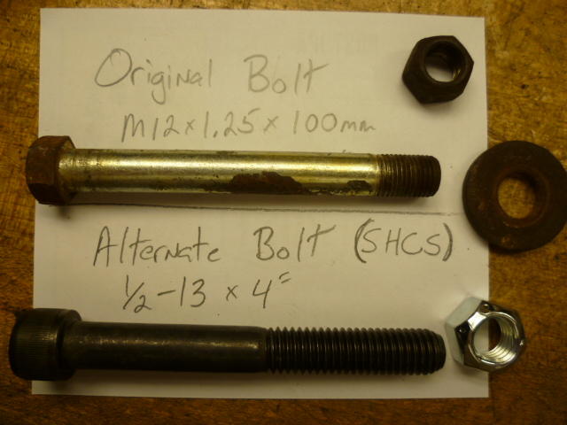

I used 1/2-13 x 4 inch long socket headed cap screws. You could also use M12 SHCS if you can't deal with the English hardware on the Metric car, but since the English stuff is so much more prevalent and cheaper for me, I used Engilsh. I used the black oxide hardware below to test fit, but for my final install, I bought some new zinc plated hardware for corrosion protection. This pic was before I had the zinc plated parts bolts on hand:
