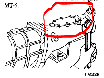

I think it's early.  It has ' Two muffler hanging tangs + short shifter mount ears = 77-78 280z '.  It also has the cover with 6 bolts near the back.  I tried turning the input and that had no effect.  It's like it hits a hard stop when you go towards 5th.
pictures will be better
