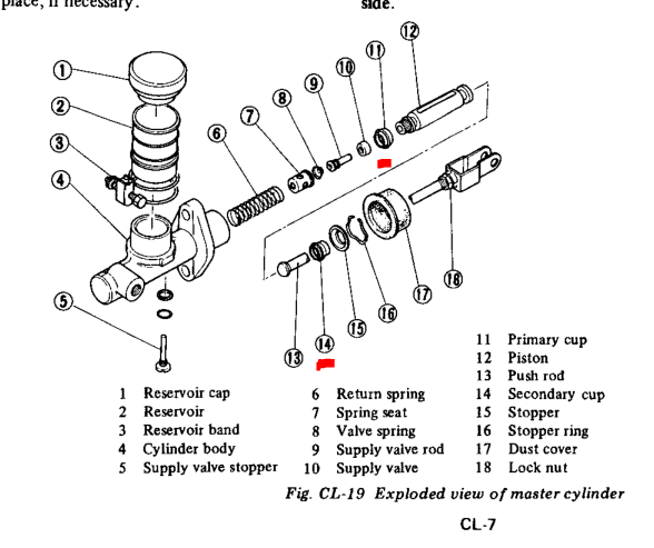

August 26, 20168 yr comment_501820 39 minutes ago, Gary L said: Sorry about that -- what I mean is that the pedal is up but when I press it it goes to the floor with no resistance and doesn't activate the cylinder. It does come back up but I have to pump it many times to get it to work correctly, which is does after that. There doesn't seem to be any leaks and the fluid level is fine. MOst of the time it will work fine for months, but now and then it will act as above. There are actually two seals in the master cylinders - one to push the fluid and another to keep the fluid in the bore after the pusher seal passes the reservoir port. Sounds like your pushing seal doesn't have tight contact with the bore and is shrinking/relaxing to smaller diameter in the bore when there's no activity to create back pressure. I bet a new seal or new MC would fix the problem. I think that there's a variety of seals and cylinders out there though and the remans might use a bigger seal. Best bet might just be a new MC. Link to comment https://www.classiczcars.com/forums/topic/56048-clutch-pedal-adjustment-questions/#findComment-501820 Share on other sites More sharing options...
August 26, 20168 yr Author comment_501826 Thanks again Zed H. So if I get another MC, would you recommend a new OEM, new aftermarket, or re-manufactured? I see NAPA for example has some that aren't to costly. If I remember correctly tho, it was a real pain getting that pin back in the clevis due to the tight spaces. Link to comment https://www.classiczcars.com/forums/topic/56048-clutch-pedal-adjustment-questions/#findComment-501826 Share on other sites More sharing options...
