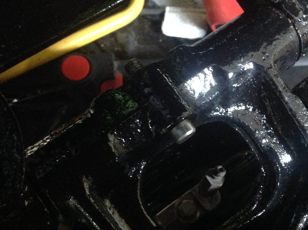

Hi, I'm putting my rear suspension back together after changing bushings and struts.
I can't find a picture in my file or on the net that shows how far you drive in the spindle pin lock bolt. Does it get driven in flush with the top of the hole? I thought maybe the torque setting would be enoug to draw it down to the right level, but the torque is lnly listed as 7-9 ft/lbs.

The ones I have taken apart the top of the head was flush or close to it but I would go whacking it until it was flush. A few taps and torque it should do the job.
The spindle pin has to rotate so that the slot surface is parallel with the flat on the bolt.  If it's a tight spindle pin you night have to help it.  Rotate the pin back and forth while tapping the lock bolt.  Nissan instructions assume that everything is shiny and new.
