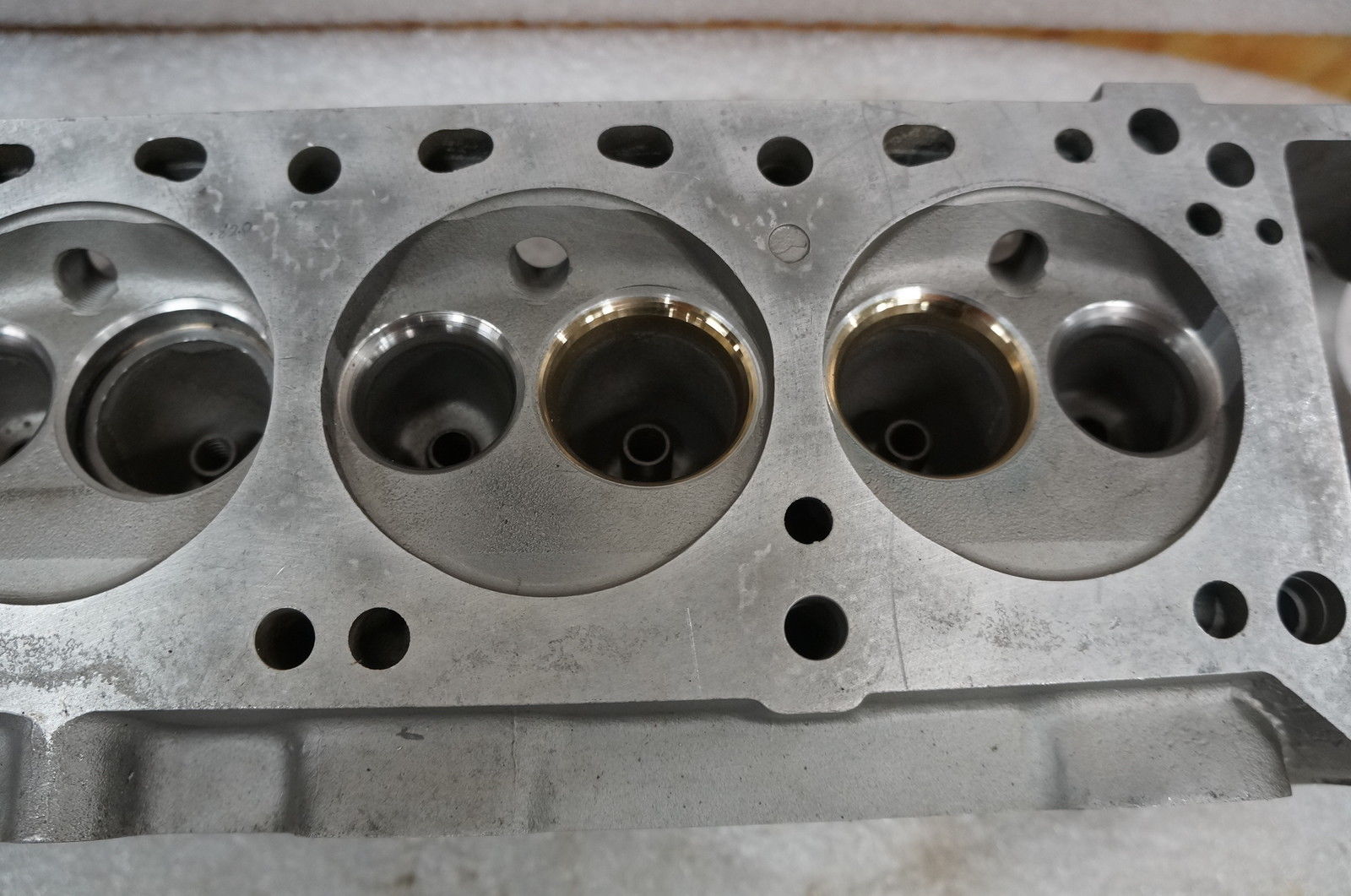

September 14, 20168 yr Author comment_503159 Anyone who know what year this E88 head is? I searched but there's so many different opinions. This one looks like a 72 head but it doesn't have that square spark plug area like many other early E88s... I'm searching for any high compression heads except late E88s. Is it worth trying to buy a E31? There's not much heads for sale in U.S. any advice is welcomed. Link to comment https://www.classiczcars.com/forums/topic/56173-l28-rebuild-needs-advice/#findComment-503159 Share on other sites More sharing options...

September 14, 20168 yr comment_503165 3 hours ago, RS02 said: Anyone who know what year this E88 head is? You could measure combustion chamber volume. It's easier than it seems, the hardest part is finding something that is graduated in cc's (Edit - actually, you can always convert any volume to cc's., So any fairly accurate liquid measuring device will work). For what you're doing you don't really need 1/10 cc'.s, 1/2's will work. Edited September 14, 20168 yr by Zed Head Link to comment https://www.classiczcars.com/forums/topic/56173-l28-rebuild-needs-advice/#findComment-503165 Share on other sites More sharing options...

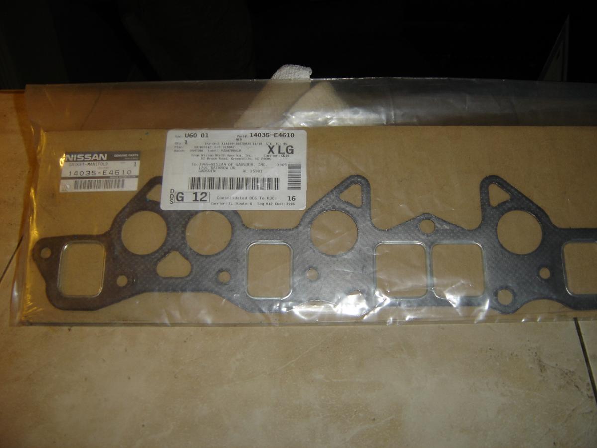

September 14, 20168 yr comment_503177 If you put new steel valve seats in that head and the larger valves, do some port grinding to match a Nissan head gasket and unshrouding the valves that head would be a good one. Get some flat tops out of a ZX motor and you'd have a good compression ratio. Those gaskets are still available from Nissan. Link to comment https://www.classiczcars.com/forums/topic/56173-l28-rebuild-needs-advice/#findComment-503177 Share on other sites More sharing options...
September 15, 20168 yr comment_503192 Like Cliff said in the post above^ If you change the seats and valves (as you mentioned) and just clean the ports to match the gasket its not a bad head to use. I have that head on my engine with those changes done to it. After you have changed the seats and valves you should measure your chambers, bigger valves increase the volume, at least mine did. I had 49cc if I remember correct. I had the head shaved to reach 44cc to get to the cr I wanted. But if you run stock camshaft keep it below 10 cr. Edited September 15, 20168 yr by moelk Link to comment https://www.classiczcars.com/forums/topic/56173-l28-rebuild-needs-advice/#findComment-503192 Share on other sites More sharing options...
September 15, 20168 yr Author comment_503209 9 hours ago, moelk said: Like Cliff said in the post above^ If you change the seats and valves (as you mentioned) and just clean the ports to match the gasket its not a bad head to use. I have that head on my engine with those changes done to it. After you have changed the seats and valves you should measure your chambers, bigger valves increase the volume, at least mine did. I had 49cc if I remember correct. I had the head shaved to reach 44cc to get to the cr I wanted. But if you run stock camshaft keep it below 10 cr. 17 hours ago, siteunseen said: If you put new steel valve seats in that head and the larger valves, do some port grinding to match a Nissan head gasket and unshrouding the valves that head would be a good one. Get some flat tops out of a ZX motor and you'd have a good compression ratio. Those gaskets are still available from Nissan. Thanks man. I did want to use this head but people kept telling me that the chamber design of late model E88s are just not good for proformance. Now I'm not sure if I want to find another one or just use this. I will get my old camshaft regrinded to a more aggresive one and that might actually work... Link to comment https://www.classiczcars.com/forums/topic/56173-l28-rebuild-needs-advice/#findComment-503209 Share on other sites More sharing options...
