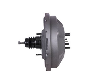

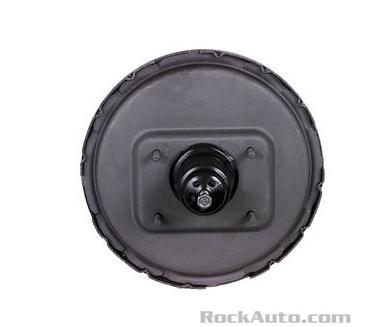

Zedhead, I spent a couple cycles looking for an alternate booster from a different car that I could adapt to the Z, but I was pressed for time and didn't spend a lot of effort on it. The first big hurdle I encountered was that the booster for the Z does not have the input shaft location centered between the mounting stud locations. It's closer to the bottom than the top and seems to be unusual due to that.
Things like the size and location of the vacuum port is no problem, but the mounting to the firewall is more difficult to deal with.

2 hours ago, Captain Obvious said:
 The first big hurdle I encountered was that the booster for the Z does not have the input shaft location centered between the mounting stud locations. It's closer to the top than the bottom and seems to be unusual due to that.
I see.  Some of the Rockauto pictures seem to be true to the part, where you can see the offset.  Here's the Prior brand image. Out of Stock, of course.  Edit - one more picture.

I didn't consider the 81ZX booster as I didn't see much of an advantage replacing one difficult to find booster with another difficult to find similar priced booster. The real trick, as Zedhead suggested, is to find a booster with the same firewall bolt pattern and the rest can probably be made to work. That's what I spent a little time on, but didn't turn up anything.
I don't even think it needs to be the same diameter. The stock booster on my 280 was the 8 1/2 inch version and I think an inch or two smaller would be fine. I might actually even prefer it. An inch or two larger (as evidenced by the ZX booster "upgrades") works as well. Just a softer pedal I assume.
I'm pretty much positive that there is a good alternative out there, but finding it without dimensioned drawings from the manufacturers is hunt and peck.
I'd be happy to be part of the team that does the investigative work into an alternative and so far, the asymmetric input shaft compared to the mounting holes has been a non-starter for me.
