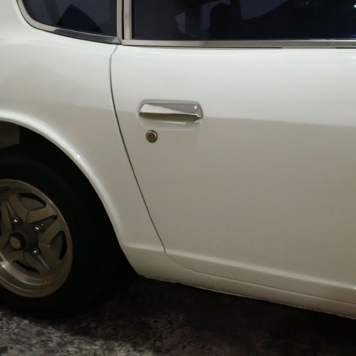

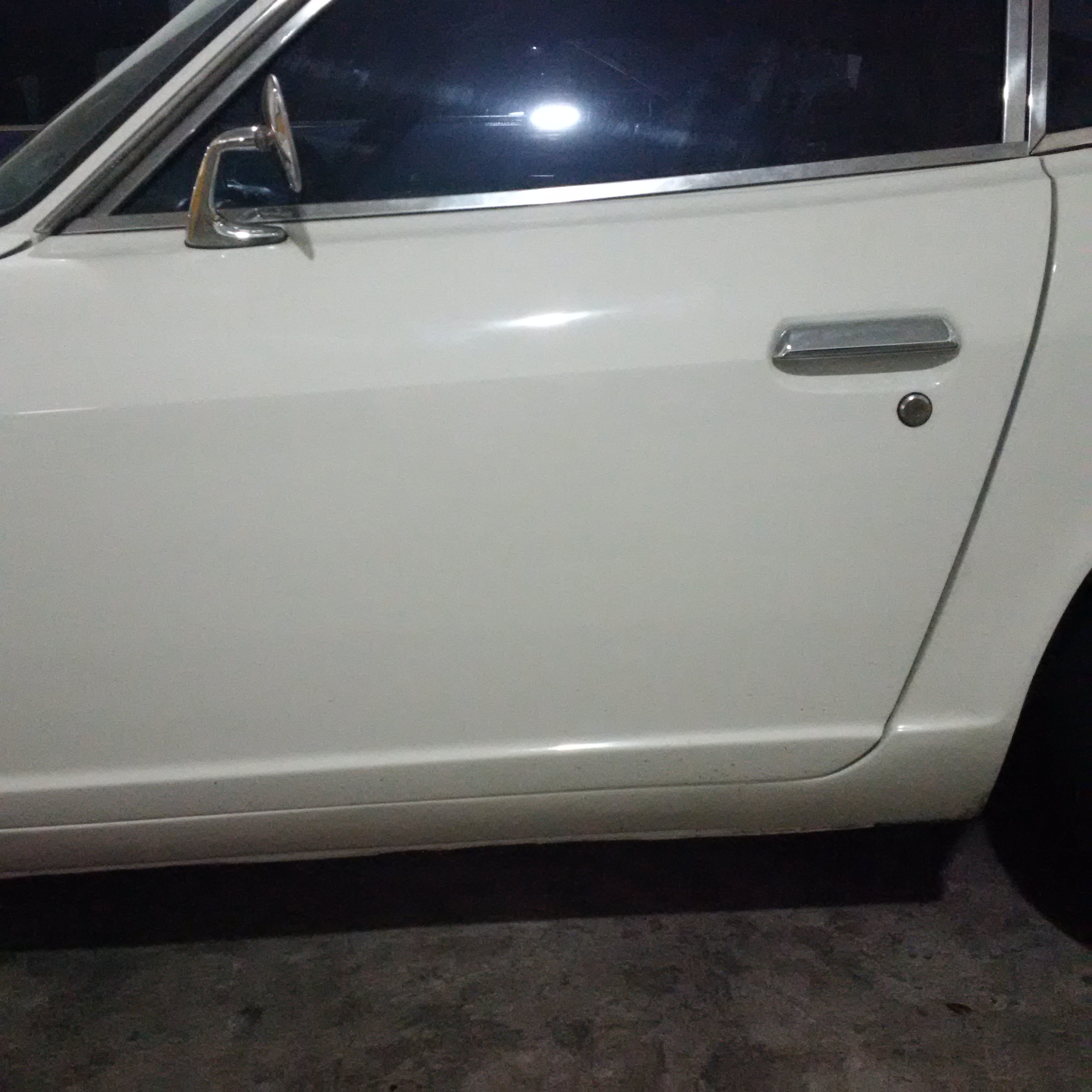

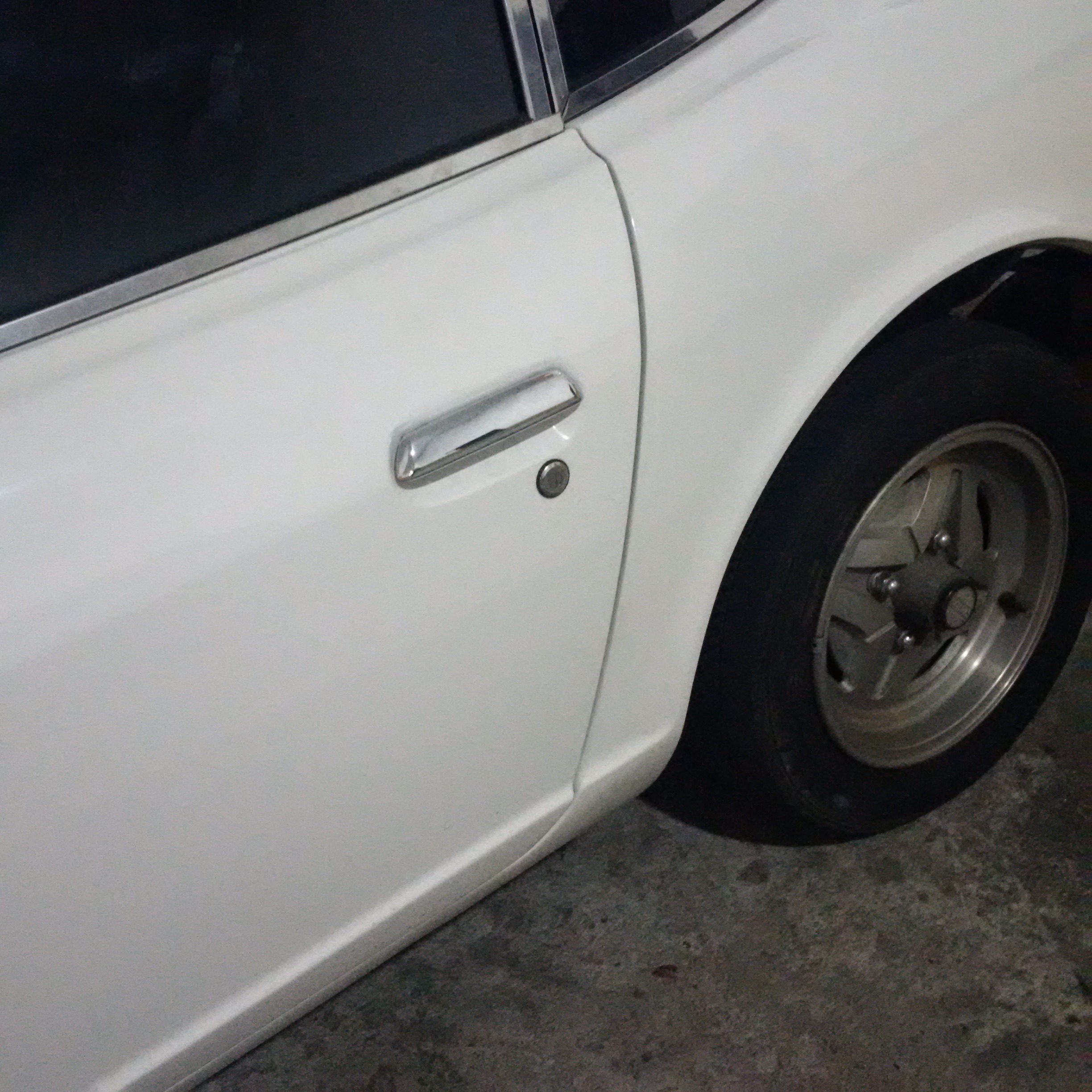

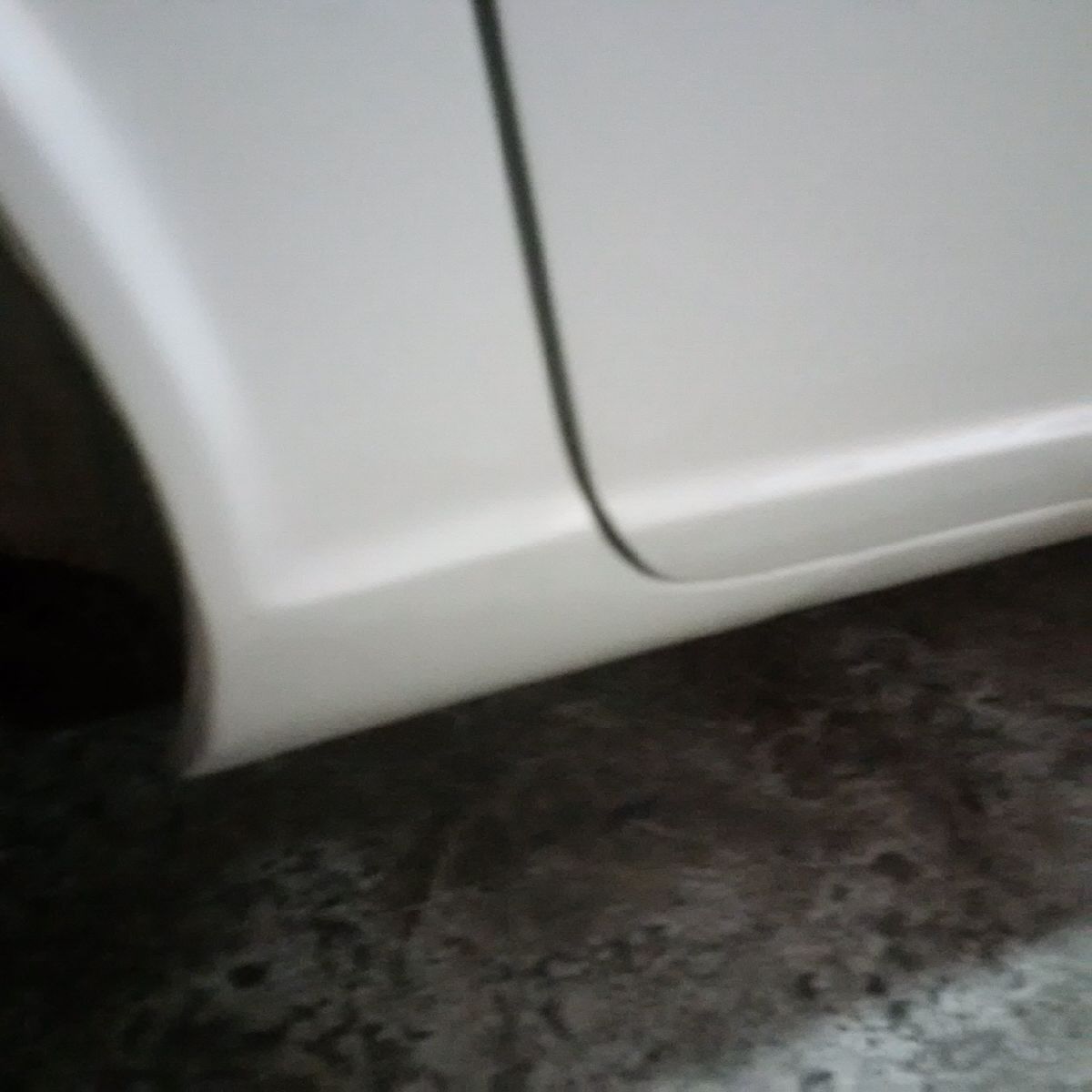

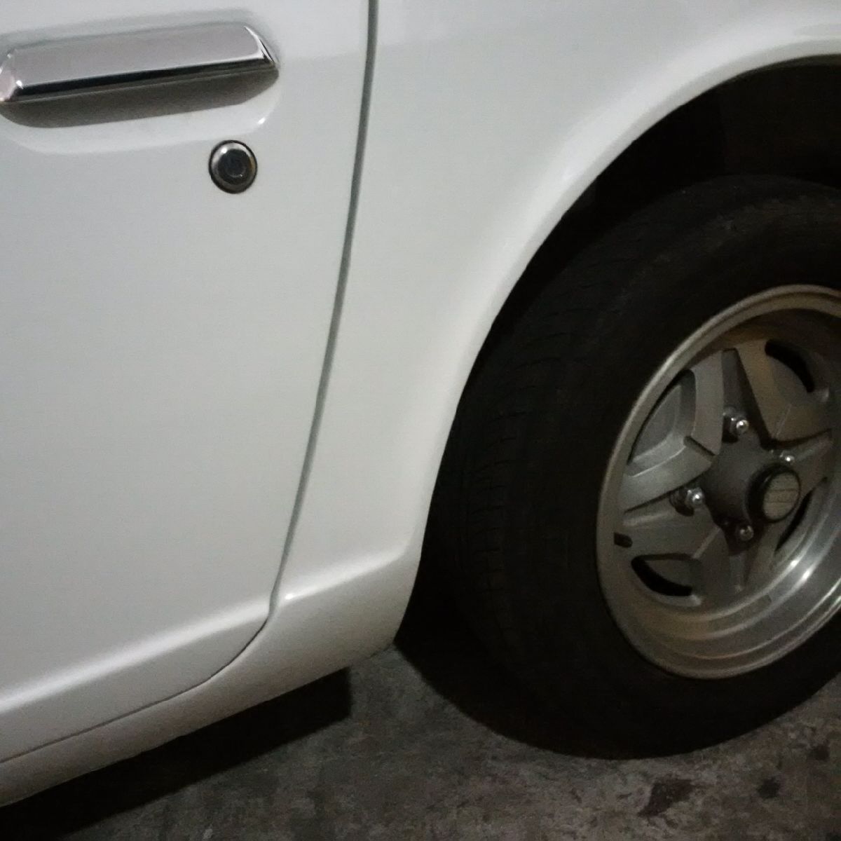

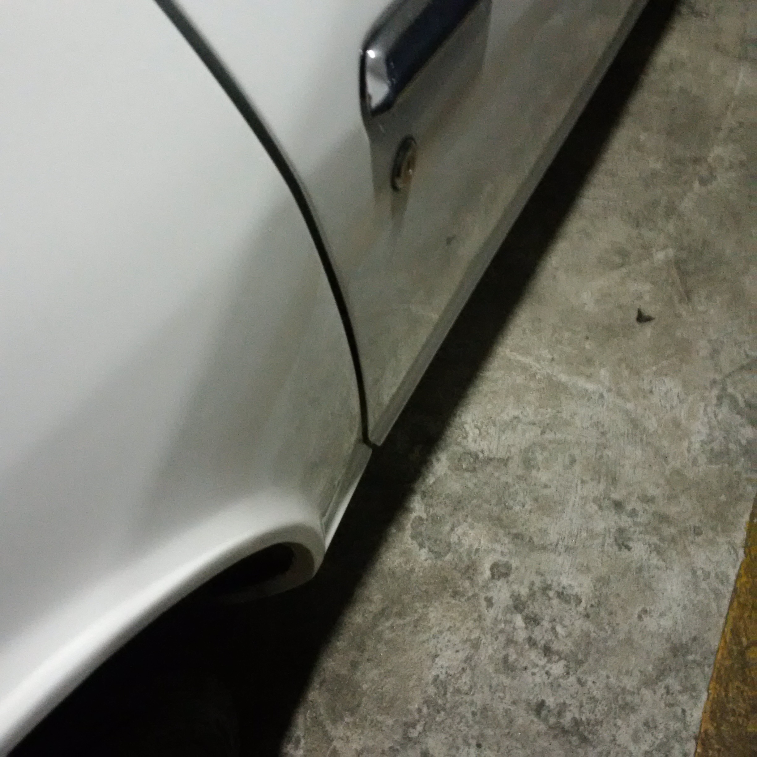

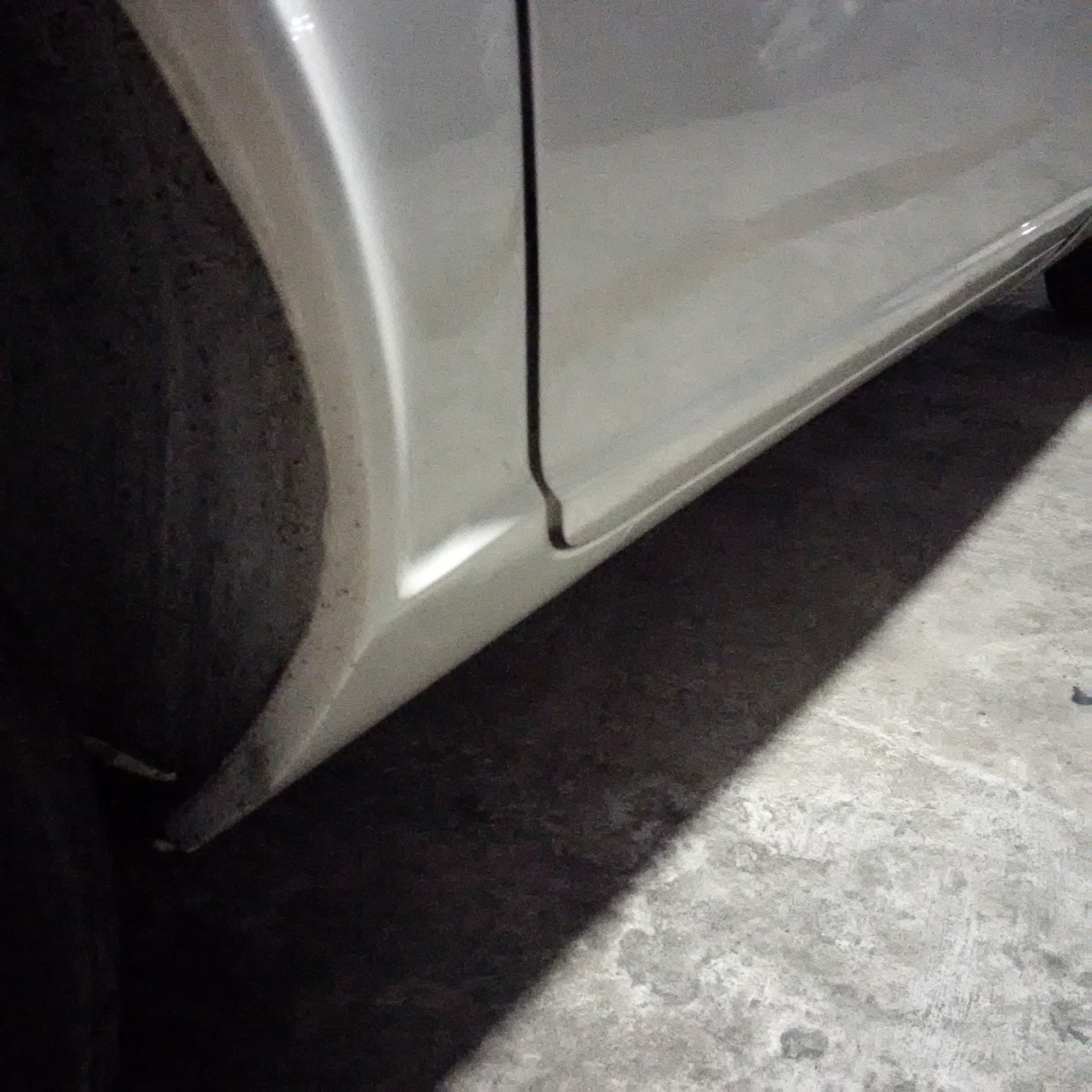

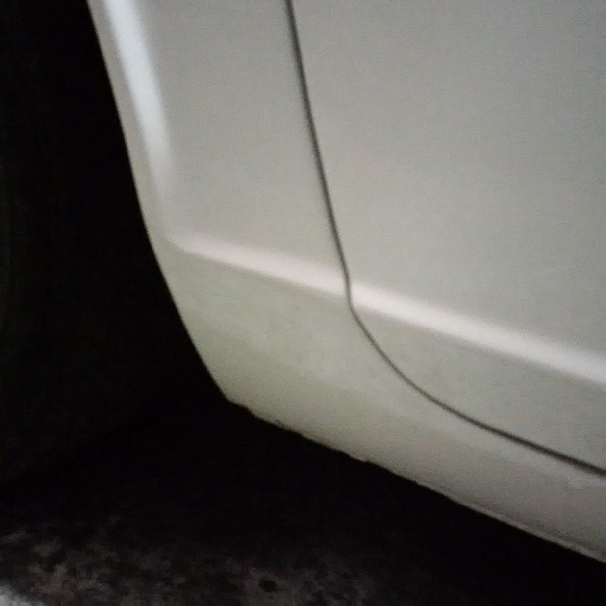

Posted September 15, 20168 yr comment_503261 Recently noticed the Paint shop that charged me US$4,750 for restoring my car did not aligned the rear fenders with the doors. They are arguing that they were aligned before installing the doors seals. I have a 6 month guarantee on the job done but unfortunately the owner of the shop died two weeks after my car was delivered and now they do not want to answer phone calls and honor the guarantee. In this sense, i will proceed legally against them and ask them to appear for a citation at the consumers protection board. Anyway, i still need to fix my car and have posted the pictures to see if someone can instruct me on how to get this straight. will i need to cut and solder back both fenders? Link to comment https://www.classiczcars.com/forums/topic/56190-rh-and-lh-rear-fenders-not-aligned-with-doors-on-my-72-240z/ Share on other sites More sharing options...

September 16, 20168 yr comment_503352 Remove the weatherstrip from that door and close the door and hold it in position so that as much as the door is aligned with the front and rear fender, then see if it fits differently/better. This will give you an un-biased indication if the door fits the opening or if the weatherstrip is in fact holding it away. The fit overall is pretty good, I would not be suing the shop just yet. You can tap the pinch weld where the weatherstrip sits and bend it back into the car a bit to adjust how close  the weatherstrio comes to the door. Also after a few months the weatherstrip will compress and the door will likely fit better. You cna then tap the pinchweld back into alignment. This is normal body fitment work. They didn't do anything "wrong". Link to comment https://www.classiczcars.com/forums/topic/56190-rh-and-lh-rear-fenders-not-aligned-with-doors-on-my-72-240z/#findComment-503352 Share on other sites More sharing options...
September 16, 20168 yr Author comment_503369 please look at the RH rear fender. Isnt it bent and not aligned? I think it should be straightened so it aligns with the door. Link to comment https://www.classiczcars.com/forums/topic/56190-rh-and-lh-rear-fenders-not-aligned-with-doors-on-my-72-240z/#findComment-503369 Share on other sites More sharing options...
September 16, 20168 yr comment_503371 In the lower picture I believe the door sits out from the chassis a little. The door is what needs adjustment. Start with the weatherstrips the way Zkars suggest. If you won't take good advise the help dries up... Link to comment https://www.classiczcars.com/forums/topic/56190-rh-and-lh-rear-fenders-not-aligned-with-doors-on-my-72-240z/#findComment-503371 Share on other sites More sharing options...

September 17, 20168 yr comment_503412 Â No, you shouldn't need to modify the quarter panels. I believe the body shop said all was well before the weatherstrip went in. If that's true, the problem is the weatherstrip. As I stated previously, if you search using the term weatherstrip, you'll find plenty of folks who have had this same problem and have some creative methods to solve it. It's possible the body shop had to adjust the door latches to allow the doors to close and latch. Link to comment https://www.classiczcars.com/forums/topic/56190-rh-and-lh-rear-fenders-not-aligned-with-doors-on-my-72-240z/#findComment-503412 Share on other sites More sharing options...
