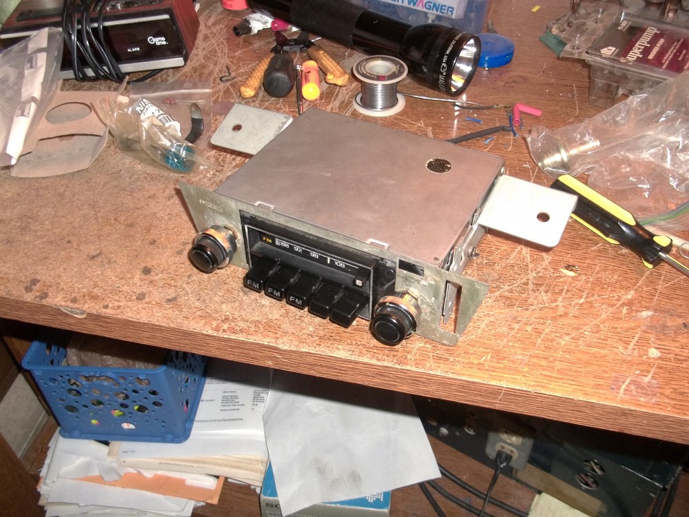

October 2, 20168 yr Author comment_504180 I am almost there, looking to Blue for a faceplate, and a local to me member for the switch. I just installed the mounts, and the metal face plate that backs up the plastic. I made up a harness adapter that takes the 6 pin 75 plug and adapts to the larger plugs used on the 2501-B. Will be a simple matter to hook up. Link to comment https://www.classiczcars.com/forums/topic/56191-1977-oe-hitachi-radio-mounts/?&page=2#findComment-504180 Share on other sites More sharing options...
October 2, 20168 yr Author comment_504181 here is where I am now Link to comment https://www.classiczcars.com/forums/topic/56191-1977-oe-hitachi-radio-mounts/?&page=2#findComment-504181 Share on other sites More sharing options...
