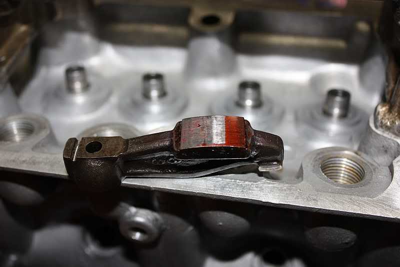

Fig.1 Measuring

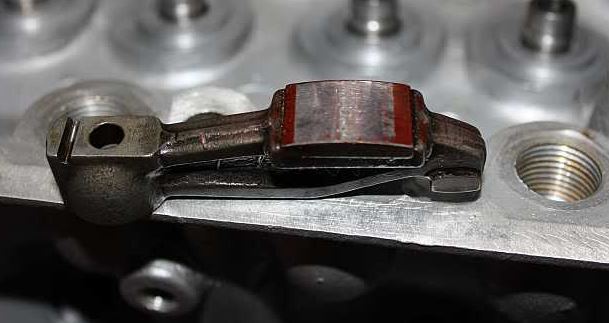

Fig. 2 Good Wipe

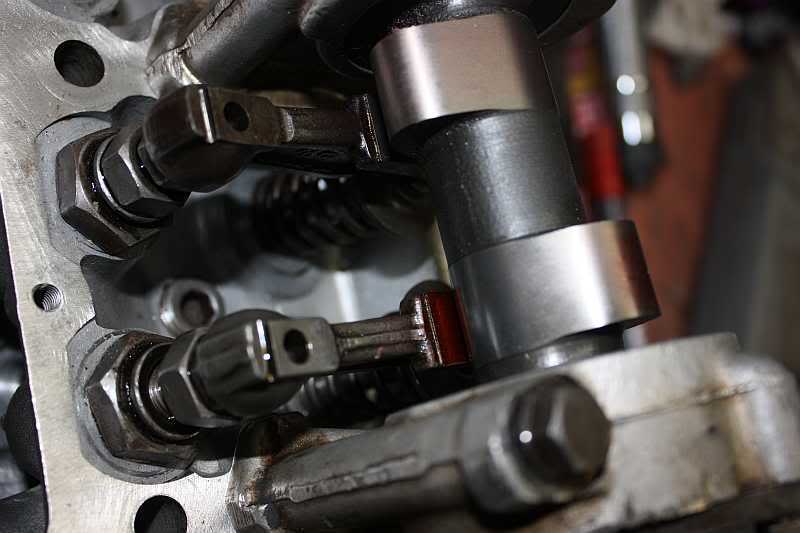

Fig3. Bad Wipe
