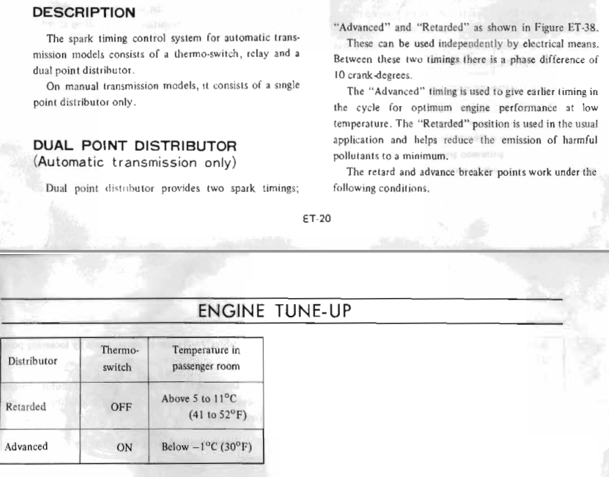

The only reference to a switch for the EGR system in the FSM seems to be one that resides in the cabin of the car and actuates at about 30 - 52 F.  Are you sure it's not for the second set of points, on a dual point distributor?

Interesting that, as Zedhead suggested, the documentation indicates the location of that switch to be at the passengers feet in 73. In 74 they supposedly moved it to the thermostat housing, but prior to that time, it's supposed to be inside the interior. Appears that the documentation is wrong.

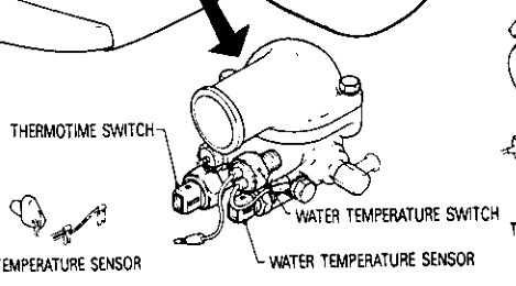

I have a 1976 280Z and the ignition system control switch is the two wire type, but with a loop that grounds through a bolt head instead of a bullet.  The wire usually breaks off and the switch becomes worthless.  The're a fairly decent picture in the Emissions chapter.  Included below.
I found a similar picture of a 1972 thermo housing.  But they only show the sender.  Pyros2, does the part you're trying to replace look like the picture you posted or are you assuming that ti does?

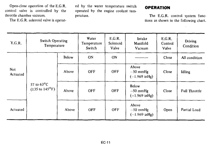

You might be able to use the later EFI temp switch.  The systems all seem to run both the EGR and the dual ignition, using a relay.  The FSM range is close though, 57 - 63 F.  "Warmer than cold" seems to be the goal.

I'll take a look but the part I posted in the one I need.  Mine is the same except no wires.  There isn't enough room or good wire to connect new leads to it.  A lot of the Datsun wiring is speaker wire level and not very impressive.

I was suggesting that the the 280Z switch would perform the same function, just using a different ground point.  Or you could replace the loop with a bullet and have the same connections.  If you can find one.  Good luck.
