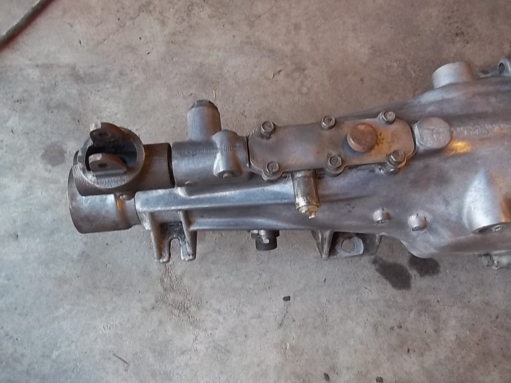

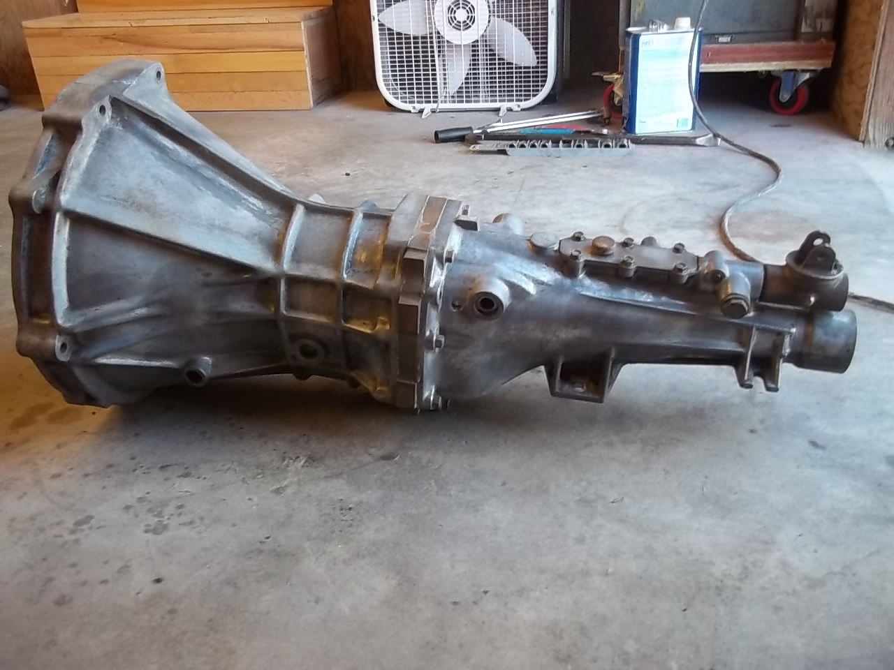

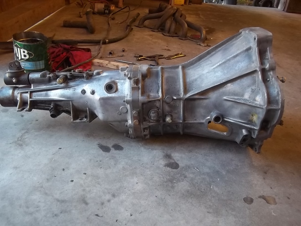

Posted September 29, 20168 yr comment_504052 yes guys, i did a search. i would like to get new input and output shaft seals for this transmission. i think this is the stock 72 trans but i would like to make sure before i order the parts. thanks for the help sb Link to comment https://www.classiczcars.com/forums/topic/56261-original-trans/ Share on other sites More sharing options...
September 29, 20168 yr comment_504060 Front oil seal is the same as the 5 speed with part number: 32114-Y4000. $5.09 at Courtesy Nissan. Nissan supplieed me a NOK. Type: AH1679G. Size: 30/45x8mm. Not sure if the rear is the same as the 5 speed. The shaft diameter is the same, but Im not sure about the outer seal diameter. I have a 280Z 5 speed seal and the dimenssions. It also fits the 71C transmissions. The part number is 32136-U010A. You could check your outer diameter. The 5 speed has a NOK Type: 400402N. Size: 35/50x11mm. Edited September 29, 20168 yr by EuroDat Link to comment https://www.classiczcars.com/forums/topic/56261-original-trans/#findComment-504060 Share on other sites More sharing options...
