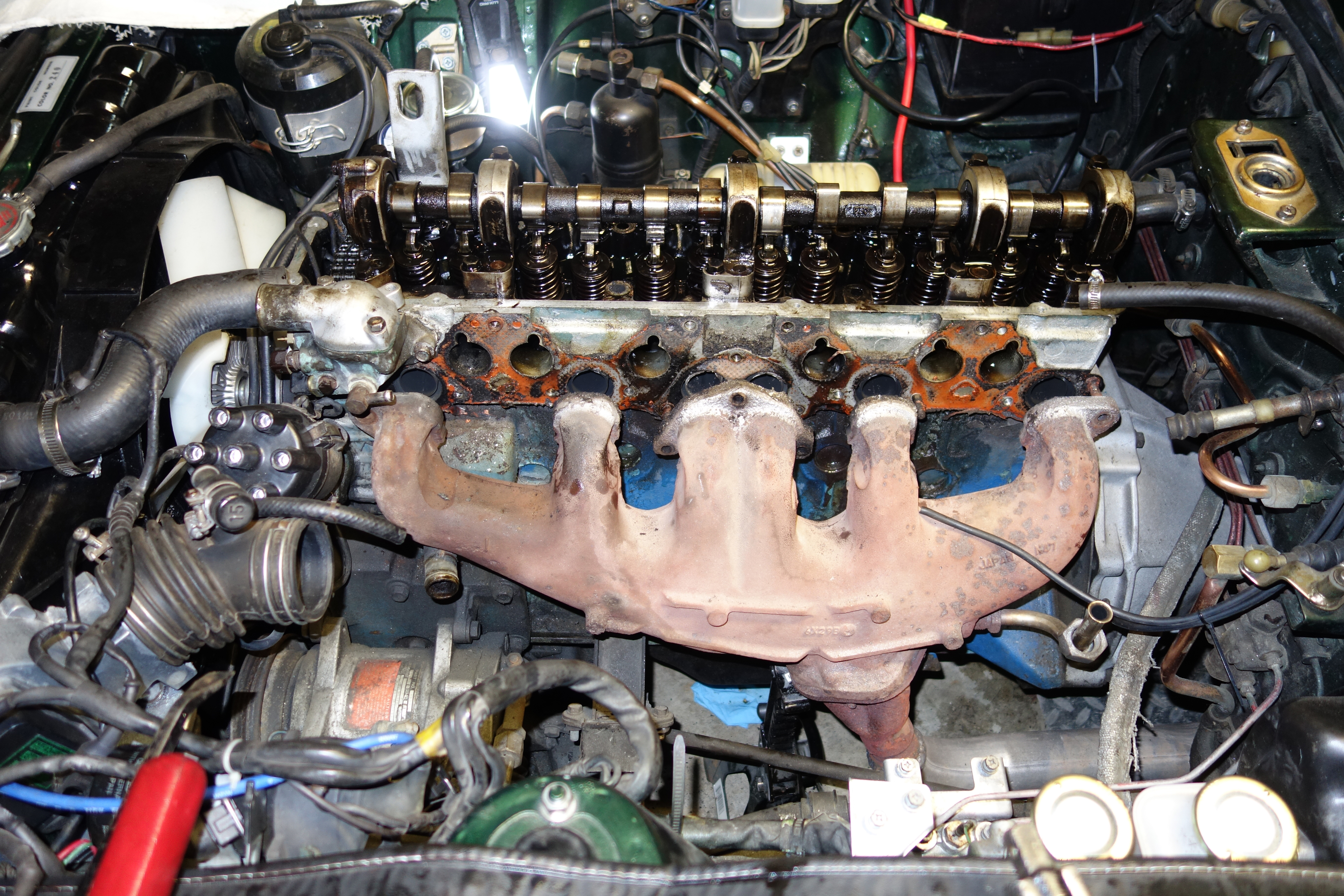

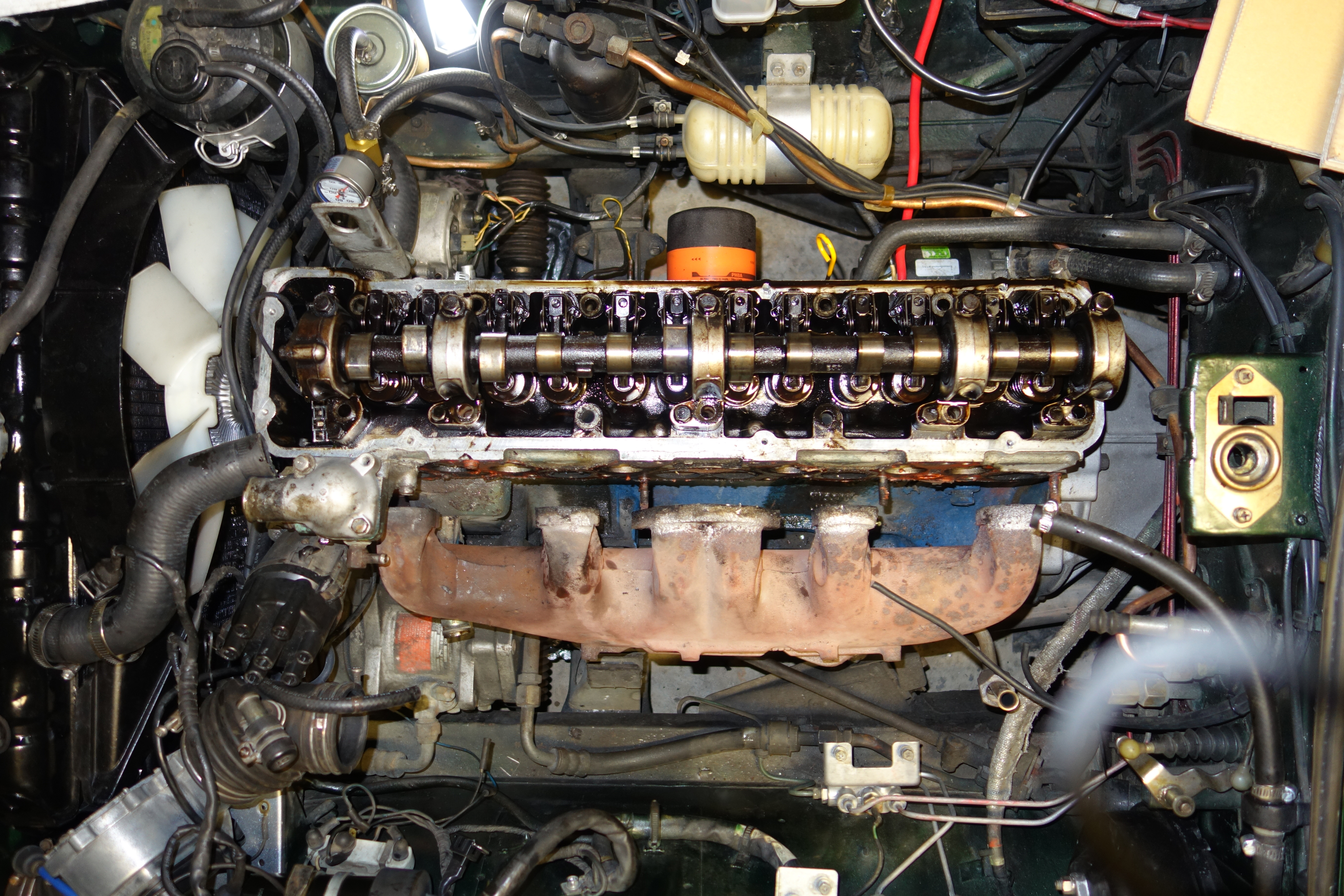

I'm in the process of replacing the head gasket on my 77' 280.  I've disconnected everything touching the head, pulled the exhaust an intake manifolds, got the wood shim on the timing chain placed, cam sprocket if off, removed the 14 head bolts in the proper order along with the two front 10mm bolts. The head won't budge.   I've tried putting a breaker bar in the intake and no luck.  I'm trying not to go neanderthal.  Is there something I'm missing?
Let me add that there is evidence of prior work done with the exhaust manifold judging by the amount of red sealant and mismatched bolts holding it on (that's another story).  So I think it is safe to say the head has been off before.

Is it just an optical illusion that the passenger side head bolts appear to still be in place?  I know you said you removed them, but I swear I see them in the second pic.
Edit:  Nevermind... I put on my glasses and can now see for sure that they are out.  :rolleyes:
I've had them stick, but never to the extent that I couldn't get it off without a good yank by hand.  The front small bolts are usually the culprit, but you said you got them.
