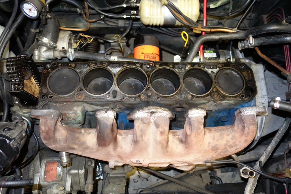

7 hours ago, siteunseen said:
Get a 2x4 the right length on that overhang on the passenger's side, use a floor jack and come up from the bottom?
I'd tap a putty knife in all around the head gasket to break the seal.
Thanks Cliff.  Doing it that way has opened about a 1/8" gap so far.  I'm a little hesitant about diggin' in with a putty knife just yet. I'll spray a little solvent in there and let it sit overnight.
I'm really curious to find out what is holding it down like that.

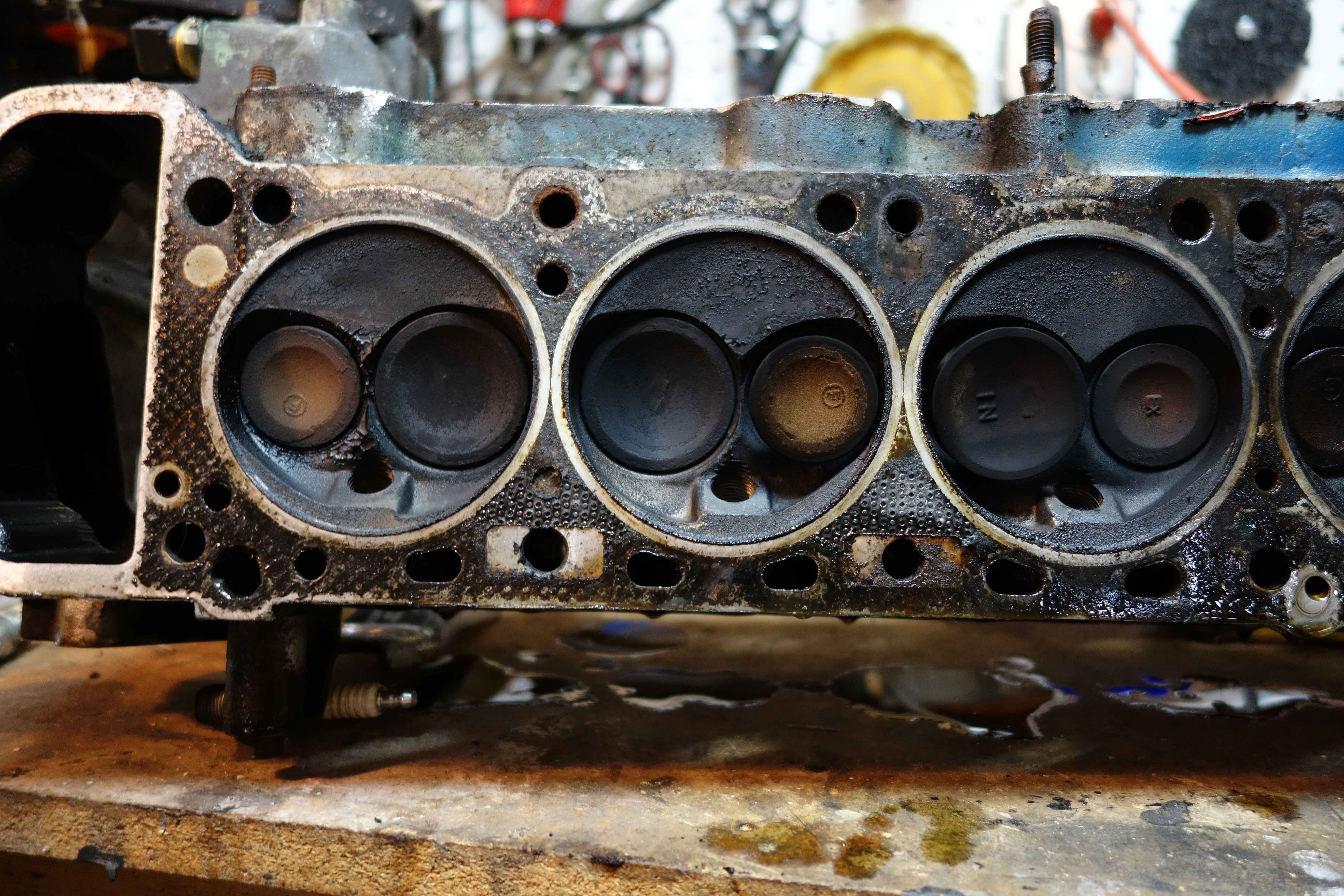

Sometimes you get lucky with head bolts.  Once the head is off, they sometimes back right out.  Soak it with penetrating oil and then drill and extract.  A good welder can tack weld a small bolt to the broken piece for removal too.
On 10/4/2016 at 10:22 PM, Dave WM said:
Scary stuff, I hope I never have to pull the heads. What do you do about the snapped bolts?
I hired the services of a local specialist.  Their only business is extracting snapped off fasteners.  Primary clientele are dealer service departments.  Apparently, there are chronic, high-dollar fastener failures on certain premium vehicles to support this kind of trade.  The tech showed up at my home with a roll-in cabinet filled with specialty tools.  Job was done in 15 minutes.  Cost:  about $150.  For me, that was money well spent, as it allowed me to move on to more rewarding steps in my restoration project.
i think im in the wrong trade.......$10 a minute
reading up I see some suggest filing the bolt flat and then using a center punch and small guide drill bit then workup to larger until just the threads are left or an extractor can work.
 think I like the others that said to file flat 1st then reinstall the head, and use a series of bushing fitted into the hole in the head as guide bushings for a series of ever increasing dia drill bits, up to a bit that will leave only the threads of the old nut. Then pick out some of the old threads with a sharp awe and then start a tap.
I suppose the key to that is to have a good supply of bushings and bits for what ever you may run up against.
I knew you'd figure something out, 2x4 wasn't too good an example, an old shovel handle or piece of pipe fits in between everything.
I'm guessing it's the locating dowels holding it.  If you do use a putty knife make sure and go under the gasket against the cast iron block.
