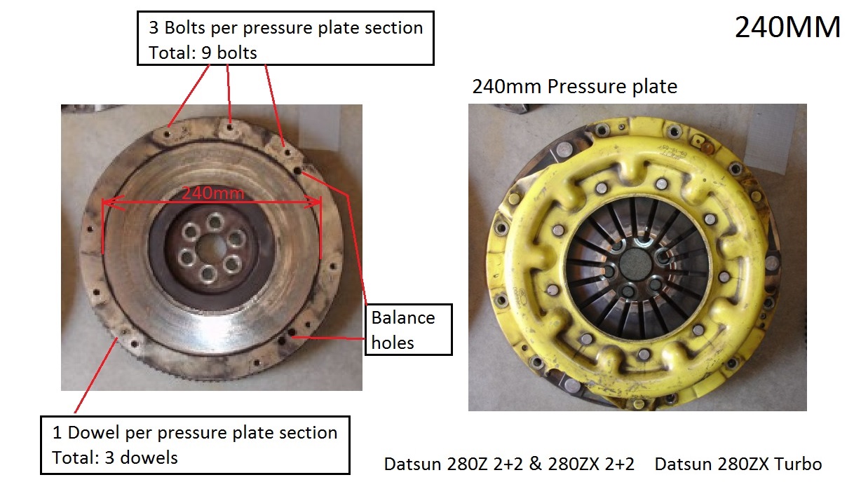

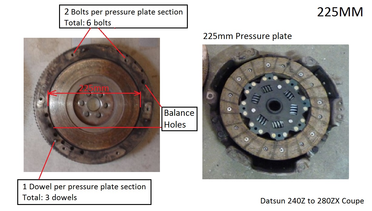

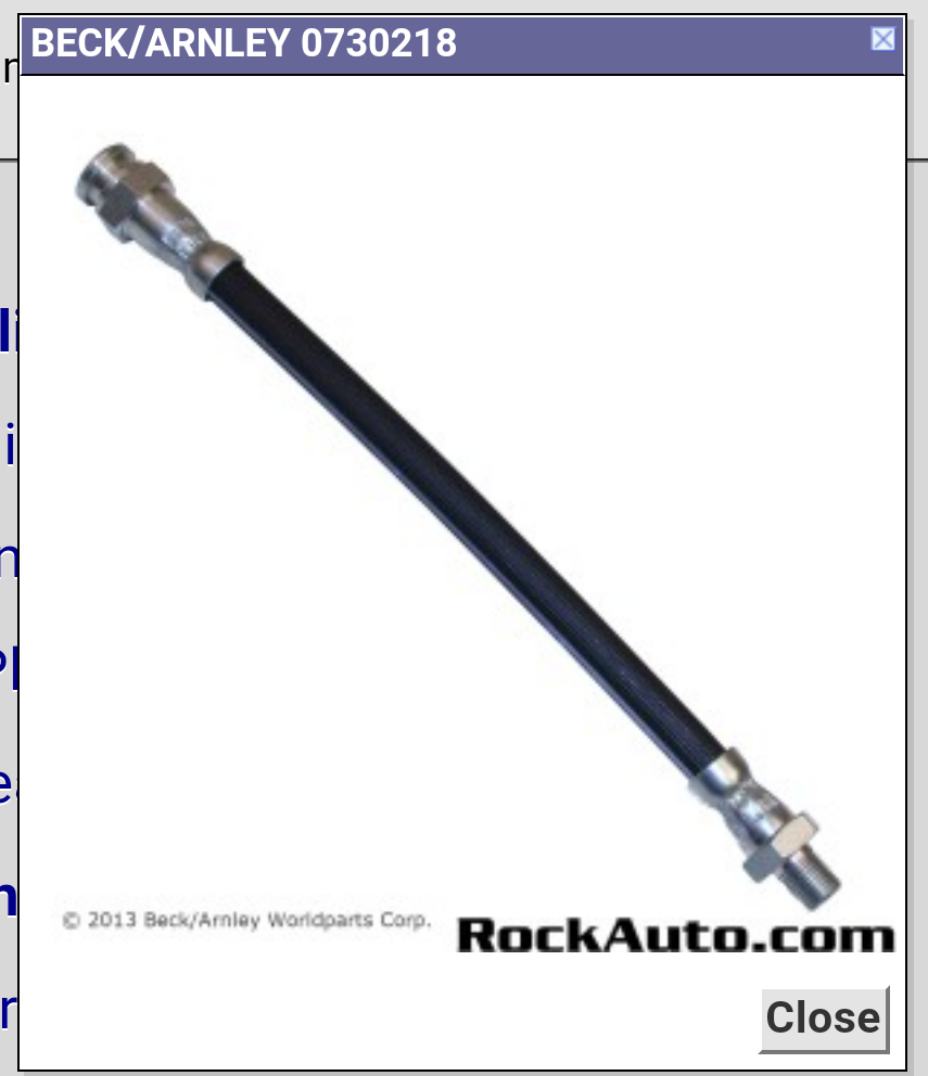

October 8, 20168 yr comment_504552 I just ordered a set including the hose from RockAuto. That was 5 years ago and never had any problems with them. I strongly recommend dismantling both and cleaning them before using, even if new. Mine still had machining grit inside which would have damaged the rubbers and reduced the service life. My clutch is a new standard 280Z 2+2 clutch with a lightened flywheel. It works great and designed for the heavier 2+2and Turbo 280ZX. I like it because it has the light feel and still really good grip behind an L28 in a standard 280Z. You will need the 9 bolt 240mm flywheel. The 225mm has 6 bolts. A lot of aftermarket flywheels are setup for both. I had the flywheel lightened myself from a drawing which I can post if you want. I think the drawing was posted by @Blue and I downloaded it. The machine shop changed a couple of radius' because they would make it (what we thought would be) too thin in places. The main reason for me lightening the flywheel was to compensate for the heavier pressure plate. Its about 2,5lbs heavier and the disc is also a fraction heavier. The lightened flywheel makes it snappy of the line and help it accelerate better. My wife had a little trouble with stalling it the first time she drove it, but only in the begin. Setup: Flywheel: 240mm out of 280ZX 2+2 lightened to about 15lbs if I recall correctly. (Can check when I get back home) Pressure plate: Standard unit via the Nissan dealer here in NL. Clutch disc: Standard unit from Nissan. Throw out bearing collar: My original 280Z collar. New (Rock Auto) I think Beck/Arnley brand Master cylinder New (Rock Auto) Slave cylinder and haydraulic hose. Self adjusting type, (no adjustable push rod). Ofcourse you can source others brands that are just as good. My experience up to now is positive. Link to comment https://www.classiczcars.com/forums/topic/56298-too-much-power-for-current-clutch/?&page=3#findComment-504552 Share on other sites More sharing options...

October 8, 20168 yr comment_504555 As long as everything is matched, like Chas did with the turbo clutch & flywheel in his 280, there should be no problem. Stock 240 / 280 clutches are the same, the beefier turbo has the larger 240mm surface area and you need the bigger disc & pressure plate to utilize it. Link to comment https://www.classiczcars.com/forums/topic/56298-too-much-power-for-current-clutch/?&page=3#findComment-504555 Share on other sites More sharing options...

October 8, 20168 yr comment_504561 Here is the sketch with the alterations we made and a couple of files showing the difference between 225mm and 240mm. I have it in Acad at work somewhere and it drop about 2.8kg which comes out just over 6lbs. The Fidanza Aluminium flywheel is 4.85kg (10.7lbs) Fidanza P/N: 143281 and fits all 240Z, 260Z 280Z & 280ZX. Thats like over 50% reduction in weight. I think for street use its a bit of overkill. I have read about people having problems with the Fidanza flywheel midlle bolt not lining up on the 3 bolt sections, but never seen one to comfirm it. I have seen one car with a Fidanza flywheel (it was a 280ZX) and it wasn't real easy to drive from a standing start. I can remember when we turned it off and the engine just stopped dead like it had a hydraulic lock or something. It didn't idle all that smooth either. Link to comment https://www.classiczcars.com/forums/topic/56298-too-much-power-for-current-clutch/?&page=3#findComment-504561 Share on other sites More sharing options...

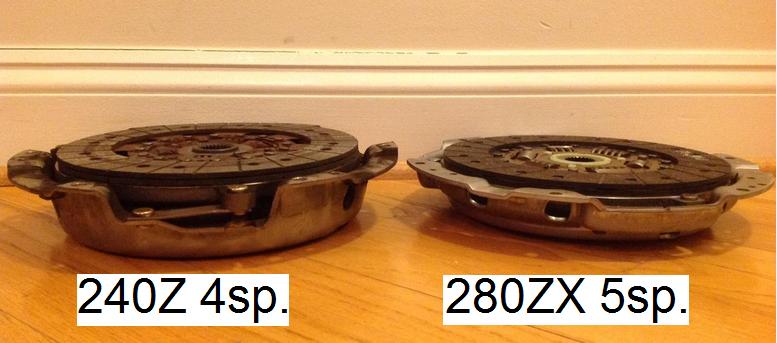

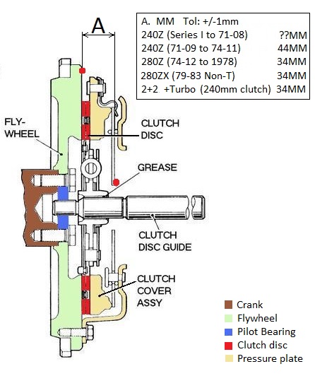

October 8, 20168 yr comment_504574 7 hours ago, siteunseen said: I used an Exedy clutch kit and Beck Arnley slave cylinder and hose on both my 280 and 240 with a five speed swap. I can't figure out why a kit for a 280 won't work on a 240? What's different about them besides the shorter collar which isn't part of the kit? Here's the one I have in both cars and so far they are working fantastic. https://www.amazon.com/EXEDY-06009-OEM-Replacement-Clutch/dp/B001B5D7TE Hi Cliff, It might be because the 240Z has a different pressureplate height than the later 280Z and 280ZX. A lot of people just simply buy the 280ZX with the collar and be done with it. I think that will be eventually the only option available, due the demand reasons. There is just a lot more 280Z and 280ZX's out there. Your 240Z might already have had a replacement 280Z pressure plate when you changed it. If its still original, then you only need the collar from a 280Z or ZX and it will work perfectly. The sketch and photo might help clear it up a bit. Im not ure if the sketch is 100% correct. I only know the 280Z, 280ZX non-turbo and the 2+2 & Turbo is correct because I have both in the garage somewhere. Btw, The photo is not mine, I think I found it here. Someone here might be the owner, so thanks Edited October 8, 20168 yr by EuroDat Link to comment https://www.classiczcars.com/forums/topic/56298-too-much-power-for-current-clutch/?&page=3#findComment-504574 Share on other sites More sharing options...

October 8, 20168 yr comment_504578 Thanks Chas! I see now why the 240 assembly kit is much more expensive than the 280. There's a lot more material on the 240s. The 240s 4 speed is shorter so I guess that's why the heights are different. Learn something every time I use this forum. Link to comment https://www.classiczcars.com/forums/topic/56298-too-much-power-for-current-clutch/?&page=3#findComment-504578 Share on other sites More sharing options...
October 8, 20168 yr comment_504580 1 hour ago, siteunseen said: Thanks Chas! I see now why the 240 assembly kit is much more expensive than the 280. There's a lot more material on the 240s. The 240s 4 speed is shorter so I guess that's why the heights are different. Learn something every time I use this forum. Not true.....The 240Z 4 speed (early and late) trannies, the 280 and 280ZX 4 speed and 5 speed trannies......all are exactly the same dimensions. You can use either the 240Z clutch or 280Z in any of them. The important thing to remember is if you use a 240 Z clutch, use a 240Z collar and if you use the 280Z clutch use the 280Z collar. This is because the 280 pressure plate is narrower than the 240. I use the 240 Z clutch arm (with the hole) with the 240Z clutch and the 280Z clutch arm (for the self adjusting slave cylinder) with the 280Z clutch, but that's probably not necessary.......you can probably use the self adjusting slave cylinder and arm with either clutch....just not sure. All of my 5 Z's are F54 blocks and some 240Z trannies and some 280ZX trannies, but all use 240 Z clutches, 240 Z collars, early arms and adjustable slave cylinders...... Link to comment https://www.classiczcars.com/forums/topic/56298-too-much-power-for-current-clutch/?&page=3#findComment-504580 Share on other sites More sharing options...
