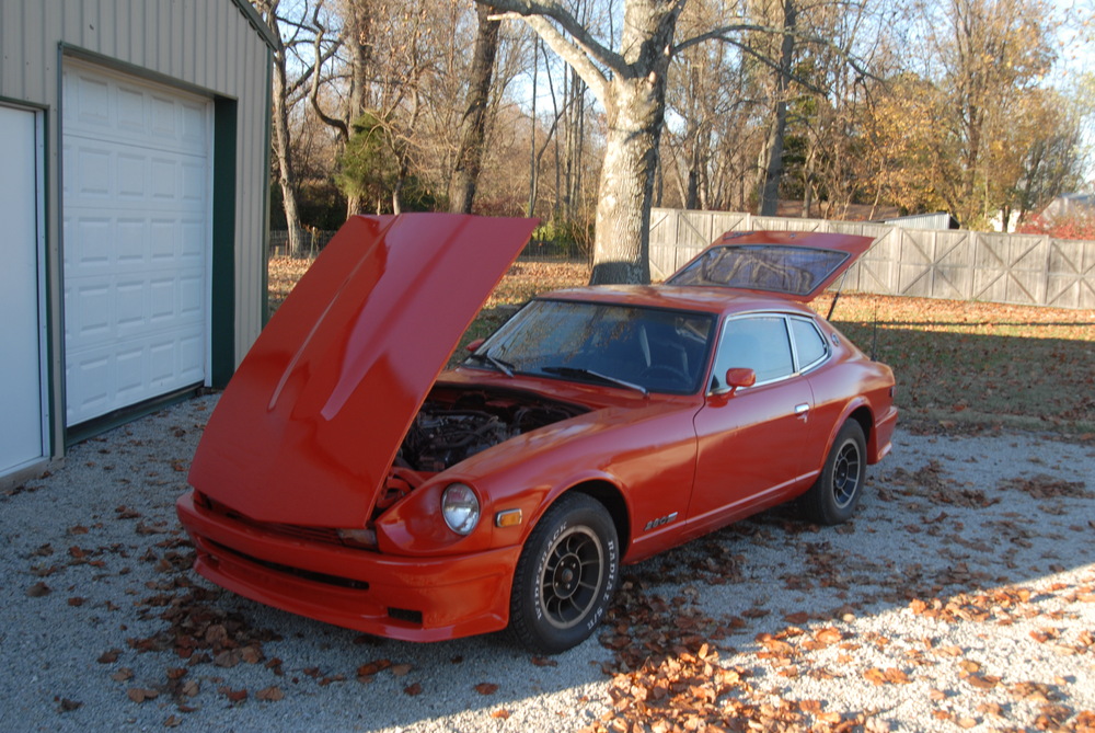

Posted October 6, 20168 yr comment_504457 I recently had my 280Z painted. I would say an average paint job at best but the intent of the car is to drive often and not really looking for top notch show quality. With this said I would like for the paint job to have a little better shine. If that is the proper term. Sorry just not a paint guy. I am pretty sure that not much was done after the final coat of paint was applied. This was a single stage paint. Not sue exactly how many coats were applied or what process was used between coats. I did apply some compound by hand and that helped a little. It does have some shine but not as much as I would like. Maybe to late to really do anything here but any thoughts would be appreciated. When I say recently it has been over a year but the car has not been driven much during that time and kept inside. House of Kolor paint was used. Thanks Link to comment https://www.classiczcars.com/forums/topic/56303-new-paint-job-a-little-dull/ Share on other sites More sharing options...
October 6, 20168 yr comment_504460 Did you happen to ask the paint shop why it doesn't have a little more shine/depth/reflection? As you mentioned, rubbing compound will help, but be careful about rubbing through on edges and hard lines. Nice color, however. Dennis Link to comment https://www.classiczcars.com/forums/topic/56303-new-paint-job-a-little-dull/#findComment-504460 Share on other sites More sharing options...
October 6, 20168 yr comment_504462 Might try color sand and buff in a area down low. Buffer and 1500 grit can do wonders , but caution is needed. Maybe find someone that is experienced at that. Sent from my iPhone using Classic Zcar Club Link to comment https://www.classiczcars.com/forums/topic/56303-new-paint-job-a-little-dull/#findComment-504462 Share on other sites More sharing options...
October 6, 20168 yr comment_504463 Almost every paint job has to be buffed out to raise the gloss factor as well as reduce or eliminate any eggshell texture. First - avoid rubbing compounds! They are way too aggressive for a fresh coat of paint. Go back to your painter and ask him if it was buffed out. A special liquid product is used for that process. Link to comment https://www.classiczcars.com/forums/topic/56303-new-paint-job-a-little-dull/#findComment-504463 Share on other sites More sharing options...
October 6, 20168 yr comment_504464 Most new cars today have a clear coat on top of the color coat. It adds a lot of depth and shine and holds it even as it gets dirty. So if you're comparing yours to a new car's paint job, a single coat can't really compete. A clear coat on top of what you have would help, and might not cost much. Stick a piece of clear packing tape on to a hidden spot and you'll see the effect. Hidden, just in case you can't get it off. Link to comment https://www.classiczcars.com/forums/topic/56303-new-paint-job-a-little-dull/#findComment-504464 Share on other sites More sharing options...
October 7, 20168 yr comment_504467 Single stage paint is hard to get real glossy. Part of the problem is as single stage paint cures all the UV protection rises to the top and cures making it shiny and protecting the color. When you wet sand you cut that protection off. It's hard to know how much you can cut because you don't know how thick the paint is and you don't know how much protection you are removing. It's a pretty color but it's prone to fade, so too much buffing hurts you long term. Base coat clear coat allows you to stack extra clear then cut off the orange peel and the flaws. Another possibility is the underlying primer base was not real smooth, so the paint they shot over it didn't come out smooth either. If it was mine, I would go back to the original shop and ask them what can be done. If they cut through the paint or burn a panel then it's not on you and they should fix it my 2 cents... Link to comment https://www.classiczcars.com/forums/topic/56303-new-paint-job-a-little-dull/#findComment-504467 Share on other sites More sharing options...
