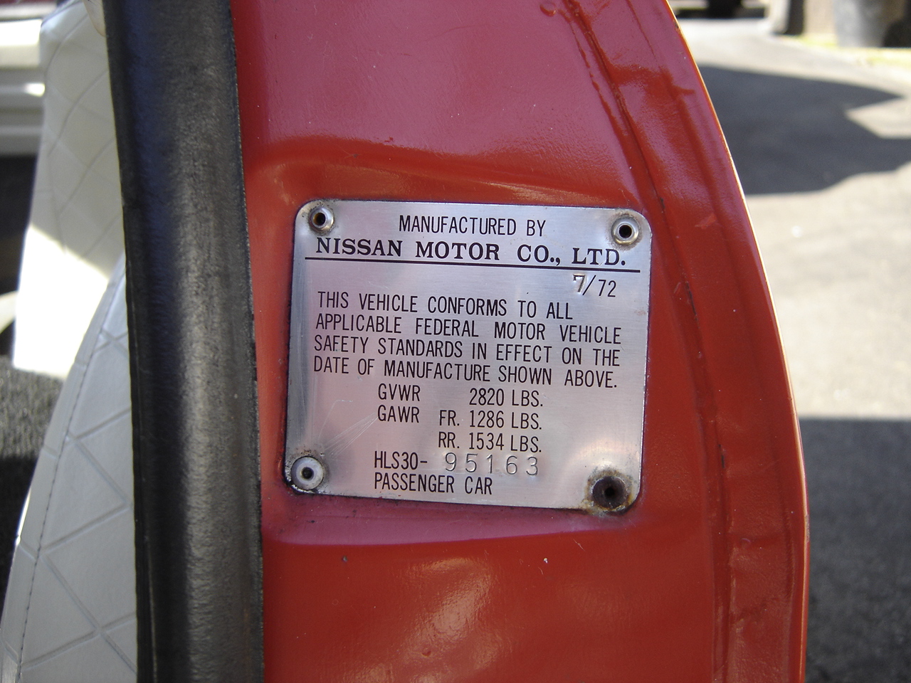

I have had numerous people recommend the clutch kit from Exedy. I was wondering if this kit (# 06029) will definitely fit my 1972 240z l24 w/ 4-speed transmission, r200 swap, MSA cam/springs, 6-1 header, and 2.5 exhaust. Also, should I replace anything else while I am down there (ARP bolts all around, collar...etc)? Any help would be appreciated. My clutch seems to be slipping once I hit my max torque range. My clutch feels very light, I have not adjusted my clutch yet, though, I have a sneaking suspicion it is the clutch altogether. The only reason I am hesitant is that I am not sure since the clutch does slip in 1st, only 2-4th when I hammer down. I plan on buying the Exedy master cylinder also. Has anyone had any experience using an aftermarket flywheel with their Exedy clutch setup, if so, which brand would you recommend? Looking on the Exedy website, it has two different sizes for the slave cylinder based on production date I believe, where do I check to find when mine was made? Thanks gents, still trying to learn everything about the car as fast as I can before I start taking her apart, cheers.

The date of manufacture is inside the driver's door frame above the latch.  Pay a few dollars and have the throw-out bearing pressed on at a machine shop.  I hammered on my first one and it whines.  The second one I had pressed on, quiet as a mouse.
