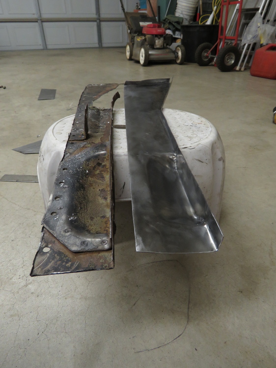

Brent, can you describe how you got the indent on your replacement panel in this pic? It looks like it was pressed in, I have to recreate that same indent for both sides on my car.
Thanks

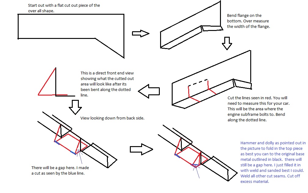

Made a quick guide.  This was how I did it.  Took the easy way out by cutting and welding, didnt want to fiddle around forever.  Probably better ways of doing it, feel free to chime in anyone, Id like to learn other ways too.

Depending on how original you want to make it to the stock piece, you could probably make a male and female mold out of wood (hard wood of some sort)/maybe cement, or other hard materials able to carve into and using a press, press the sheet metal into shape.  Could also hammer it into shape and use an english wheel to smooth out the hammer indentions, which I didnt have at the time.  Though My english wheel experience and knowledge is still at beginner level.
Hope this helps, let me know what else is needed.
