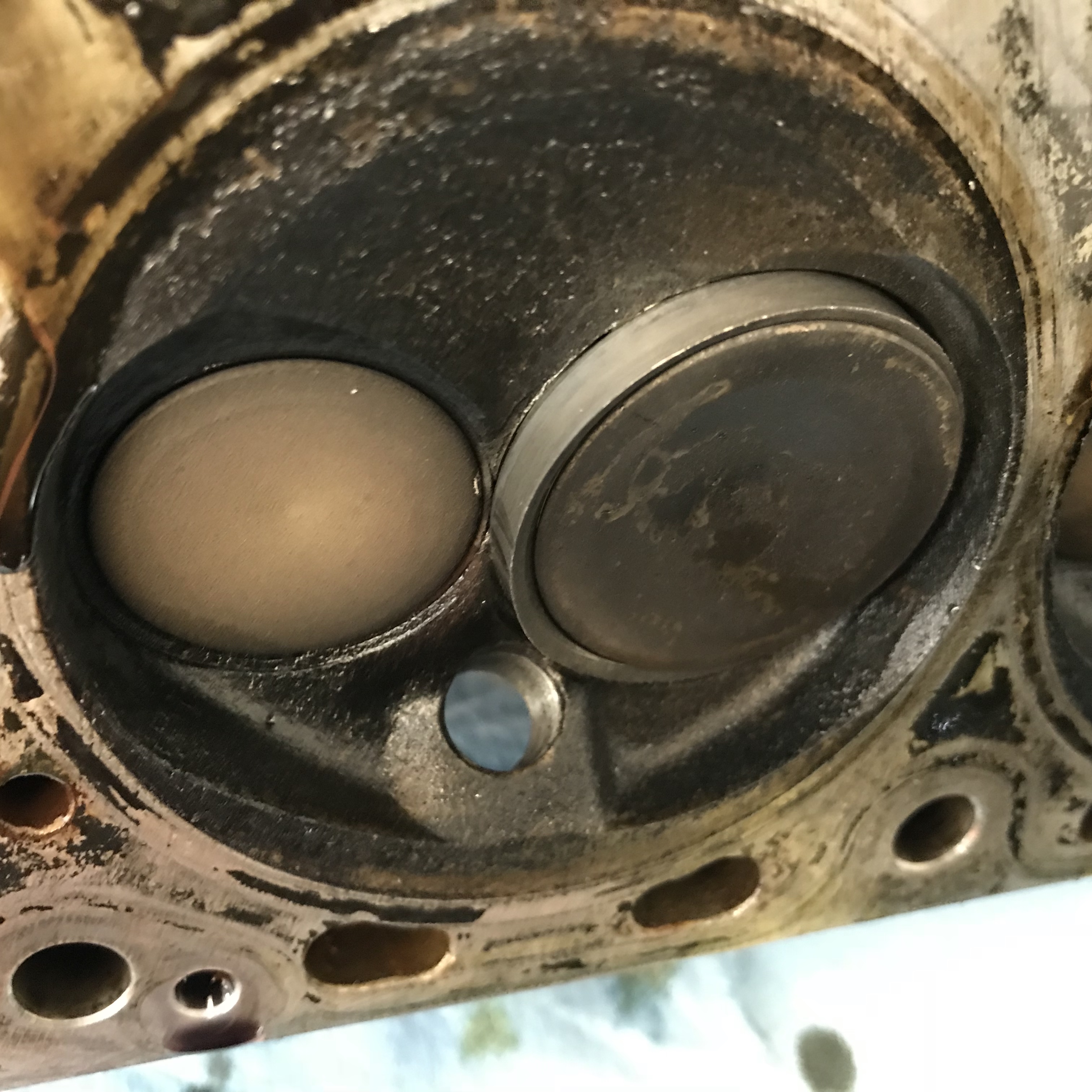

April 1, 20187 yr Author comment_546328 Got the carbs, intake, header and thermostat all removed yesterday. You can clearly see the valve seat dropped down in #4 intake.... Once my chain wedge shows up I’ll get the head off. Link to comment https://www.classiczcars.com/forums/topic/56375-weber-selection-and-initial-jet-tuning/?&page=23#findComment-546328 Share on other sites More sharing options...

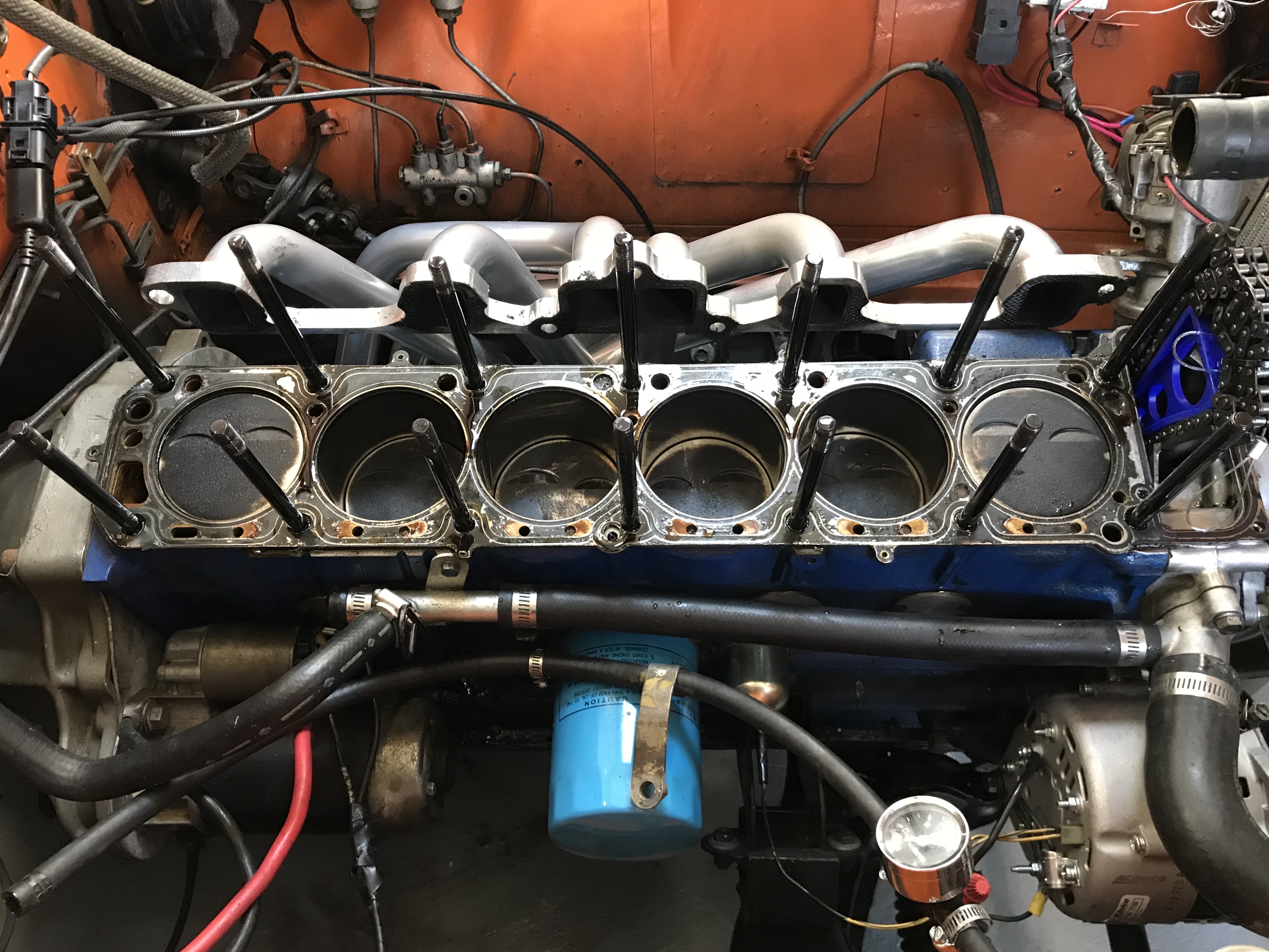

April 2, 20187 yr Author comment_546447 Head is off. On the plus side I found that I do have the larger valves in this E31 Head. Also the bore measures 87.5. So it’s bored out a bit. Link to comment https://www.classiczcars.com/forums/topic/56375-weber-selection-and-initial-jet-tuning/?&page=23#findComment-546447 Share on other sites More sharing options...
April 2, 20187 yr comment_546450 Well there's your problem! Whoever did that head work screwed something up. It's really a shame that the valve missed the relief in the piston. I wonder if that's because of the larger valves? The stock valves were smaller? And might not have hit the piston? Nice metal head gasket. Looks like it was sealing well. And head studs/nuts instead of head bolts. Clearly someone made a lot of changes in there. Too bad they weren't all done correctly! Link to comment https://www.classiczcars.com/forums/topic/56375-weber-selection-and-initial-jet-tuning/?&page=23#findComment-546450 Share on other sites More sharing options...
April 3, 20187 yr Author comment_546508 I think the seat hit the piston...thus the wider diameter that hit. Missed it by that much. Piston damage is actually very minimal. Yeah, the motor was built with all the right stuff......but the dude was asleep at the wheel when he installed that particular seat. I'll hand it off in the next week or so and then we'll go from there. Honestly...I'm just glad to have found the problem and will rest assured that it will all be good from here. Heck, we might even get this thread back to being about tuning carbs sometime. Link to comment https://www.classiczcars.com/forums/topic/56375-weber-selection-and-initial-jet-tuning/?&page=23#findComment-546508 Share on other sites More sharing options...

April 3, 20187 yr comment_546515 Wow that exhaust valve sure does look to sit deep into its seat but I am no head expert for sure. Just never saw one ground like that assuming new valves and seats. An old stock head with a couple past valve jobs, then yes. The valve seats look to be so tight fit that there is no interference fit between them. See what the head experts say. Link to comment https://www.classiczcars.com/forums/topic/56375-weber-selection-and-initial-jet-tuning/?&page=23#findComment-546515 Share on other sites More sharing options...

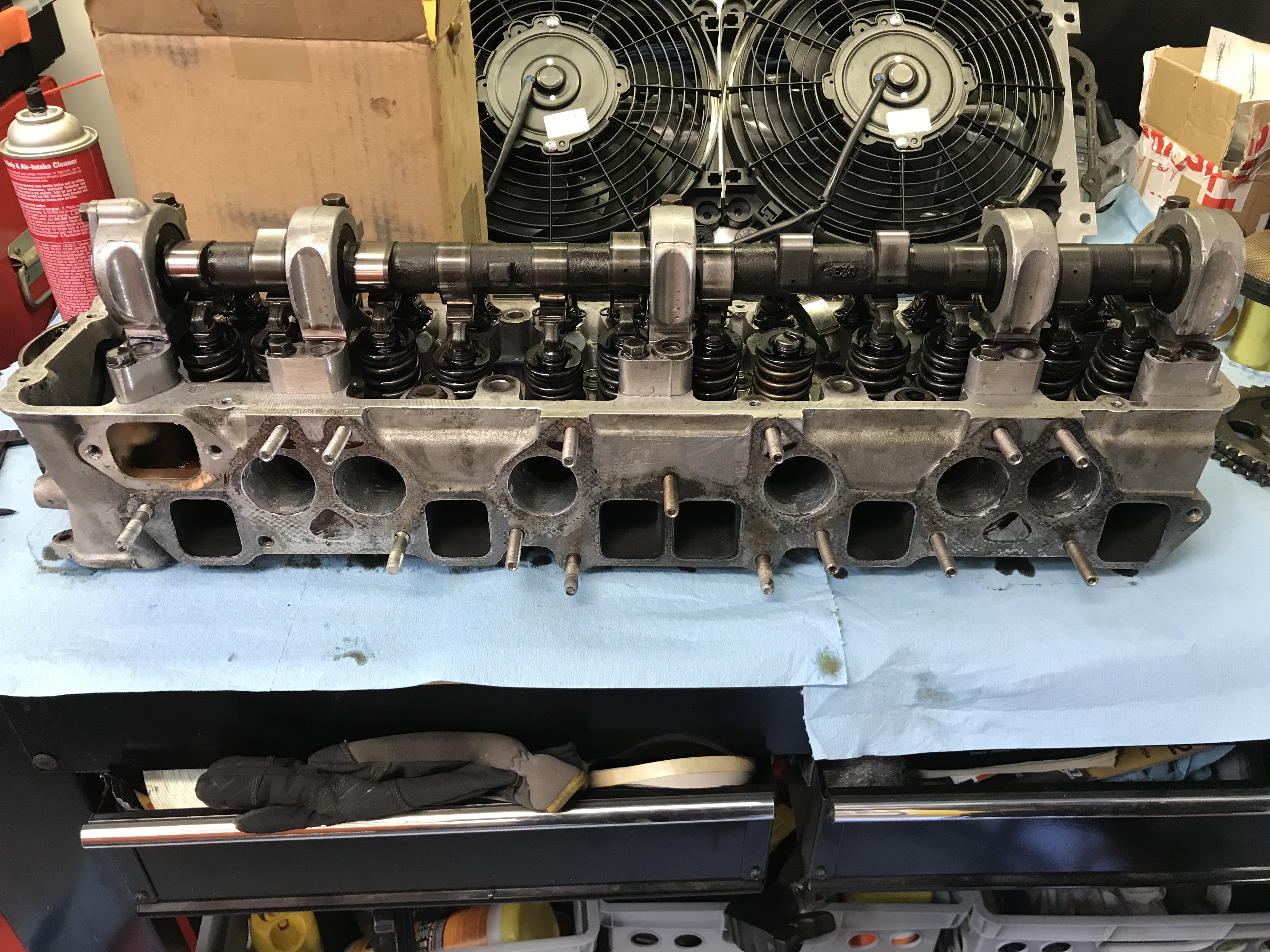

April 10, 20186 yr Author comment_547047 Head has been dismantled, inspected and a new valve and seat have been ordered. My mechanic thinks that the seat may have gotten installed slightly off and was eventually just knocked loose by the valve. Should have it back within a couple weeks and install. Link to comment https://www.classiczcars.com/forums/topic/56375-weber-selection-and-initial-jet-tuning/?&page=23#findComment-547047 Share on other sites More sharing options...

April 23, 20186 yr Author comment_547915 Head is done. New seat and valve installed. Everything else checked out fine. Gotta get it back and install everything once again. Then hopefully we are just back to tuning! Link to comment https://www.classiczcars.com/forums/topic/56375-weber-selection-and-initial-jet-tuning/?&page=23#findComment-547915 Share on other sites More sharing options...
