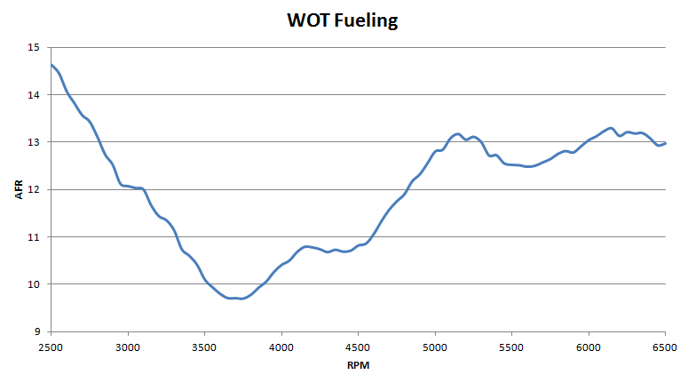

Ill work on the fuel height. I double checked them when I got home...front carb was ~28mm and the rear two were ~30mm.
Here is a pull I did today just fwiw.......F2 140/240 and 65 exhaust jets.........

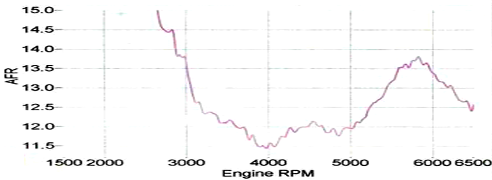

For information: Here is a WOT dyno run for a  Datsun 4 Cylinder with A15 engine and dual 45DCOE with 32mm chokes.  A/F ratio shape from start to 6000 seems similar to yours but with 4.5  point spread.

They did not discuss the a/f on the site. It was a race site so I am surprised to see this wide range of leaner excursions to 14.
The A15 has 32mm chokes. You tested 34mm, 35mm and 36mm with the same shape of wot run so it seems independent of nearly every parameter. Hopefully higher fuel level will help.

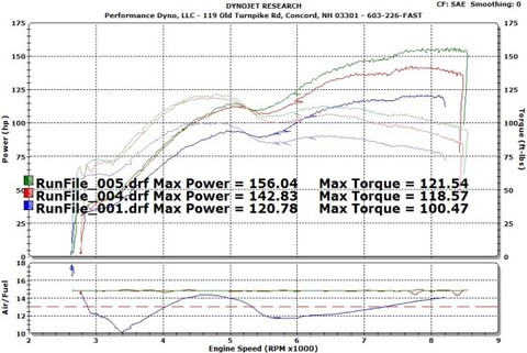

Another one with triple Weber’s..... maybe the dip is “normal”?
Possibly but it does not happen on 40's.

Sorry, the pics didn't post. Full thread I found is here...
http://forums.hybridz.org/topic/123487-compare-your-dyno-sheets-here/
Mainly turbo cars, but the ones I referenced above was the post by "AZGhost623" on page one and "Leon" on page 3.
Thanks! They all have the wonky shape. Even the Stroker with 38mm chokes!
Super rich dip 3k to 4k then leaning on the top end.

So if we kinda say that its "normal" to have that shape to the overall pull (like I've said, the car generally pulls nice and runs great on all these setups...fairly imperceptible to my butt dyno)...the flattest...and closest to the 12.5-13.0 range seems to be either the f16 160/230 combo...
or the F16 155/225 combo.....
I thought about this for an hour before falling asleep.  It is troublesome.  This same shape seems to be independent of E-tubes, choke  size, jet size, fuel level (as I believe Leon runs 25mm and you are running ~29mm) and engine size. It happens on the 2.55litre Equivalent A15 and on >3.0litre Strokers!
