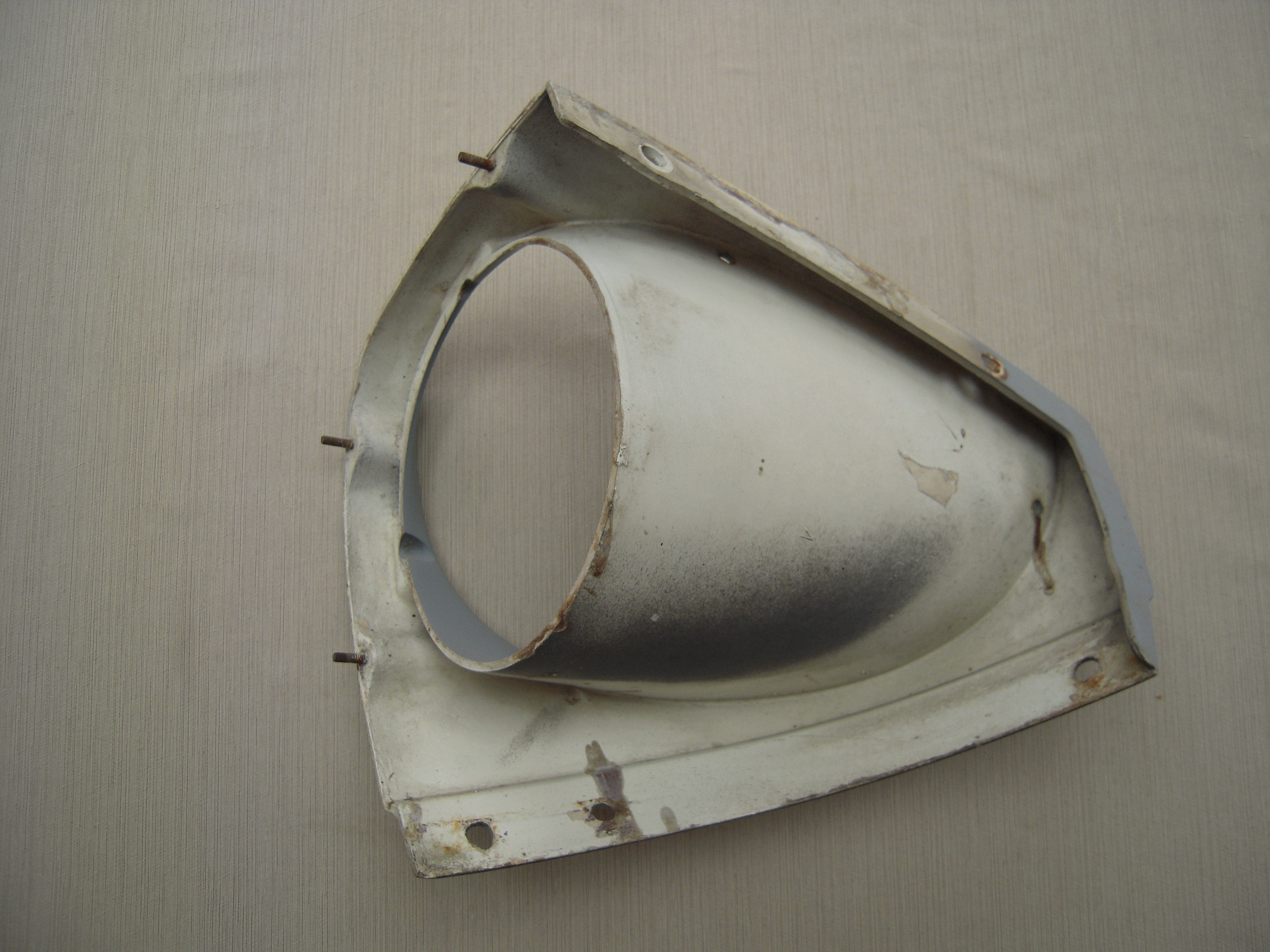

The mounting studs on the fiberglass headlight scoops are very easy to replace if missing.  A machine screw with the proper metric thread is about 20 cents at your local Ace Hardware, Lowes, or Home Depot.  File down two sides of the screw head to make a "T" so it doesn't spin in the hole and epoxy in place.  A bucket without studs is usually easier to find and far less expensive than one with studs intact.  I've fixed a few - quick and easy.

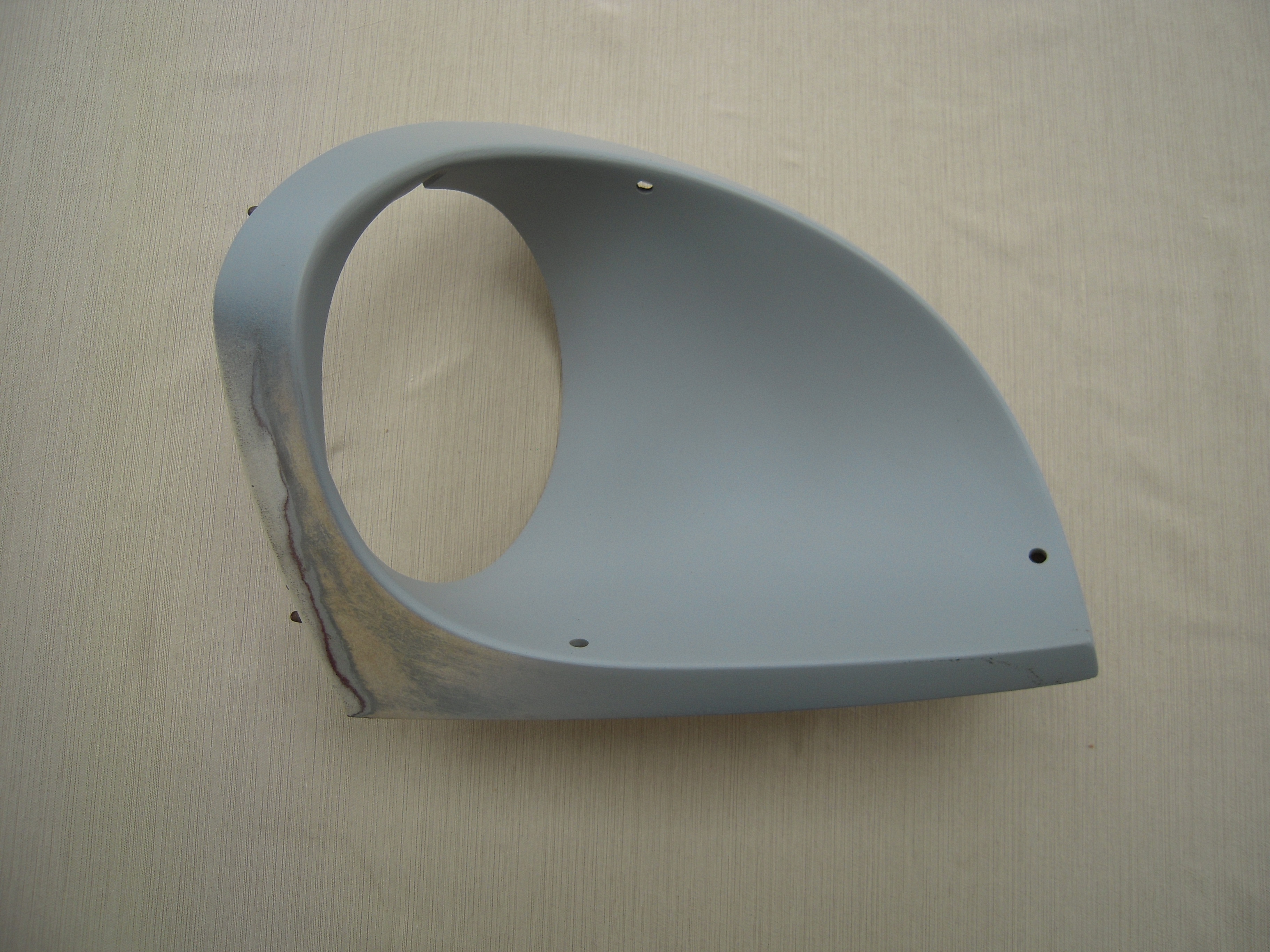

Thank you.  I was hoping for no additional body work (holes).  Mine has a small chunk missing buy the headlight that I could fix, I was just hoping for bolt on and go.

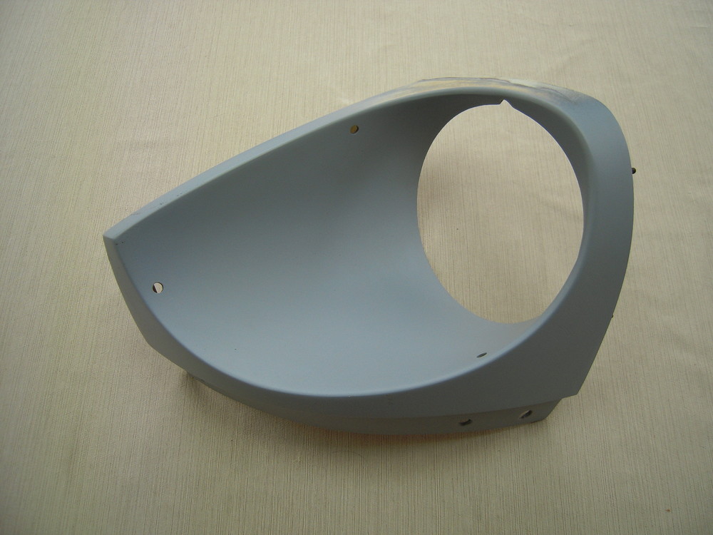

The FRP headlight case 63115 (and 63116) - E4100 was applied to models up to 6/72 and steel (63115 and 6) - N3000 thereafter.  After all the reading I have done, I have concluded that "FRP" (which stands for fiberglass reinforced plastic) and "fiberglass" are one in the same term.  I have seen aftermarket "fiberglass" reproductions and they are obviously fiberglass matt with exposed weave.  Original cases were manufactured using the same process as molded stadium seats.  FRP was chosen as the material for reason of weight and complexity in shaping the case in metal at that time.
