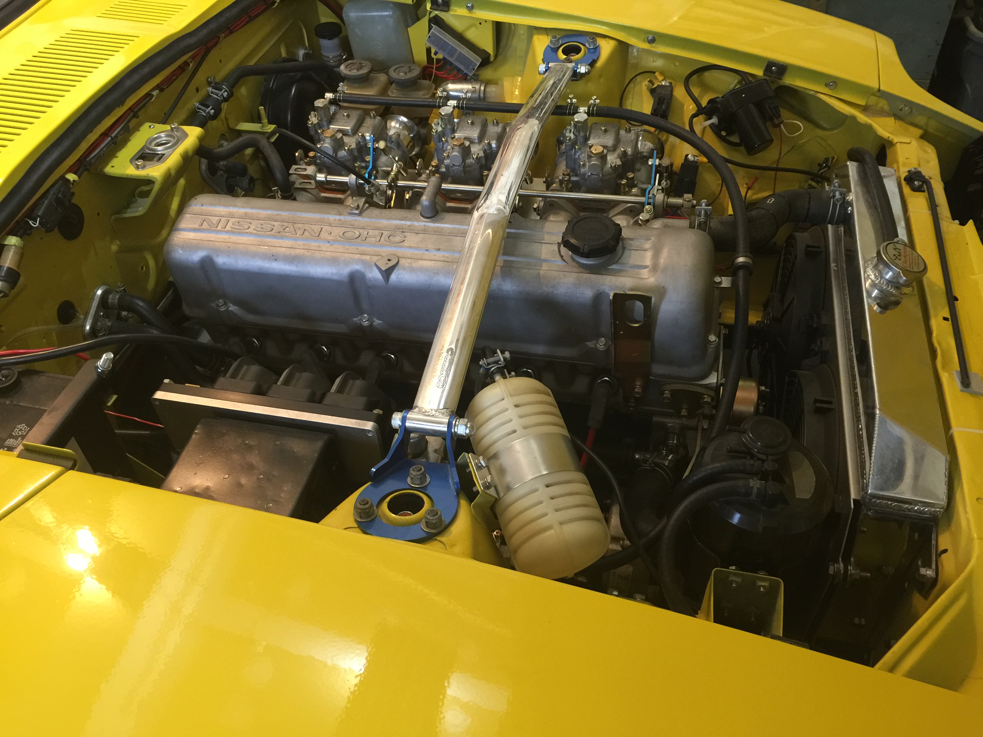

thinking about buying this  http://www.thezstore.com/page/TZS/PROD/classic15c/16-6981
just wanting to know if anyone has this set-up and some feedback
thanks all    sb
https://www.classiczcars.com/forums/topic/56394-msa-radiatorfan-kit/
Looks similar to the one I have.  It works fine but doesn't need both fans.  I took the fuse out of one.  When mounting it, make sure to put some rubber washers between the shroud and radiator.  Otherwise the lip of the shroud will bottom out against the radiator and damage it.

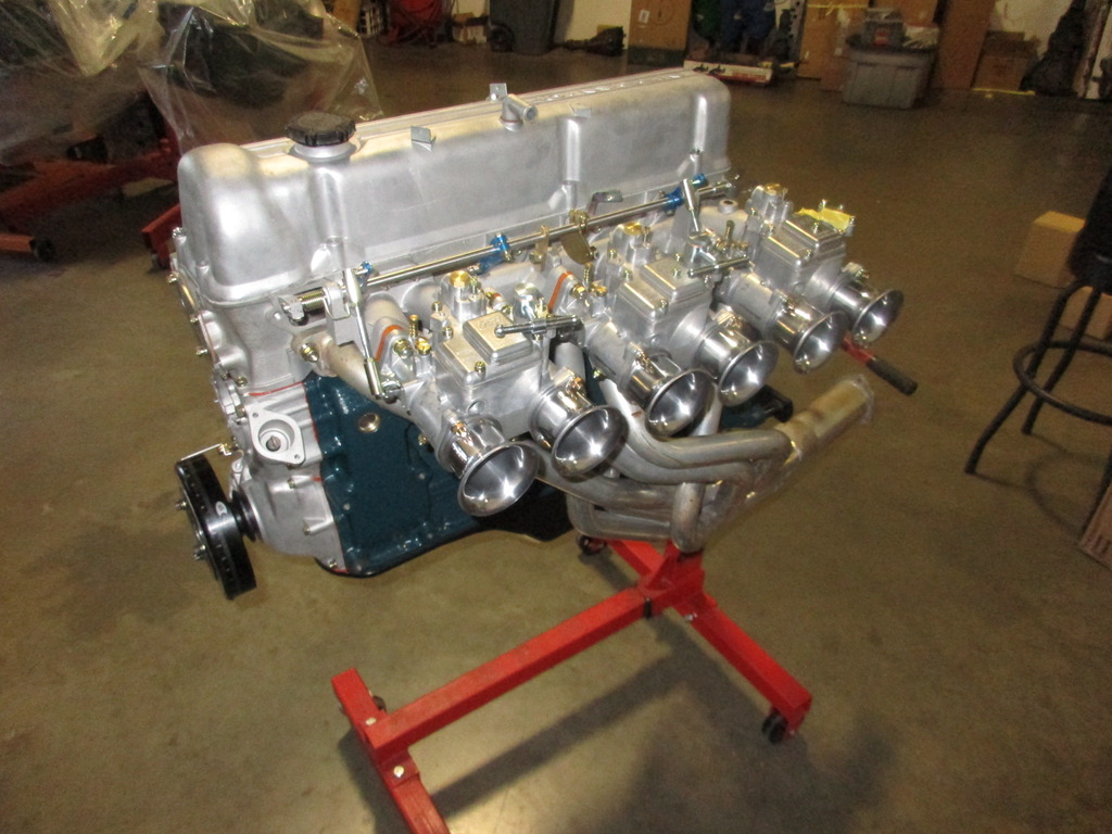

one other question. how much room do you have between the fans and your water pump pulley?
I'll check.  My car has a harmonic damper and a crank trigger wheel installed and there is enough room for that.  The photo shows what I'm talking about.
