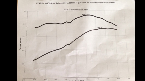

October 24, 20168 yr comment_505483  2 hours ago, LeonV said:  Thanks Andreas! I was very happy with those numbers, considering my stock S2000 made 200whp on the same dyno and much less torque. I was bummed because I didn't have a full set of other e-tubes to test out. I was about to put some F16s in to test but only had 4 on hand. Too bad about your dyno session, time to get back in there! Well i put it on another dyno the week after but the guy who owned that shop don't mess with carbs and did not have much time so well at least I got some numbers. I have less cr than you (around 10) but I made 180whp/240nm with no porting done to the head (and the same mesh filters as yours). I'm happy with does numbers but will do a dyno tuning next spring. Link to comment https://www.classiczcars.com/forums/topic/56402-dyno-day-with-the-260z/#findComment-505483 Share on other sites More sharing options...
October 24, 20168 yr Author comment_505489 26 minutes ago, moelk said:  Well i put it on another dyno the week after but the guy who owned that shop don't mess with carbs and did not have much time so well at least I got some numbers. I have less cr than you (around 10) but I made 180whp/240nm with no porting done to the head (and the same mesh filters as yours). I'm happy with does numbers but will do a dyno tuning next spring. Very nice, I bet it pulls great! Link to comment https://www.classiczcars.com/forums/topic/56402-dyno-day-with-the-260z/#findComment-505489 Share on other sites More sharing options...
