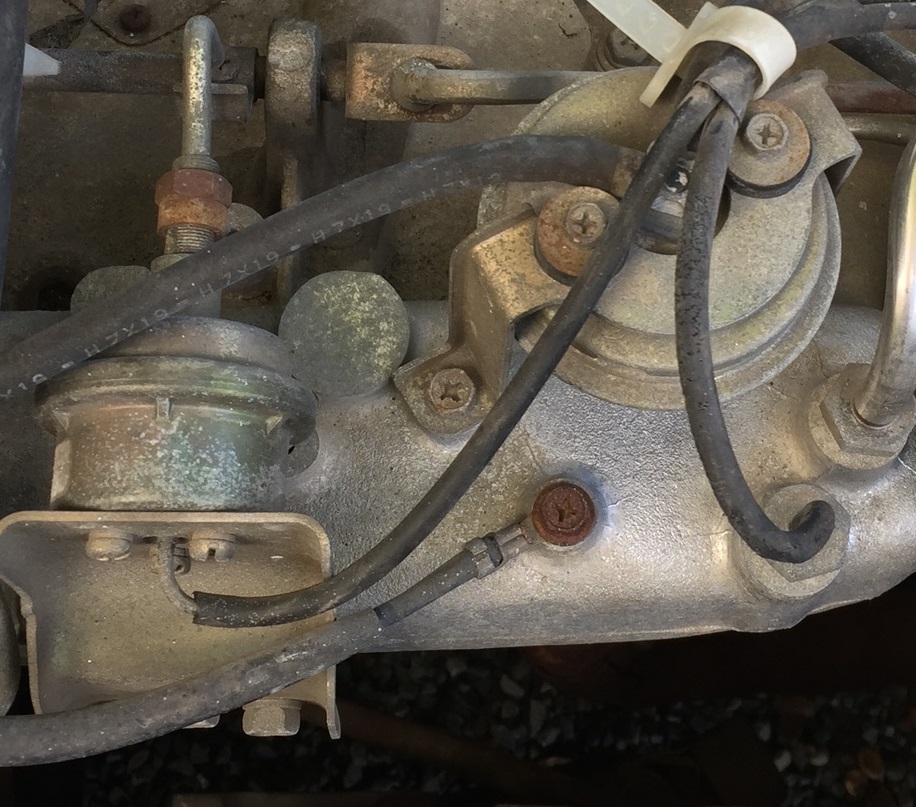

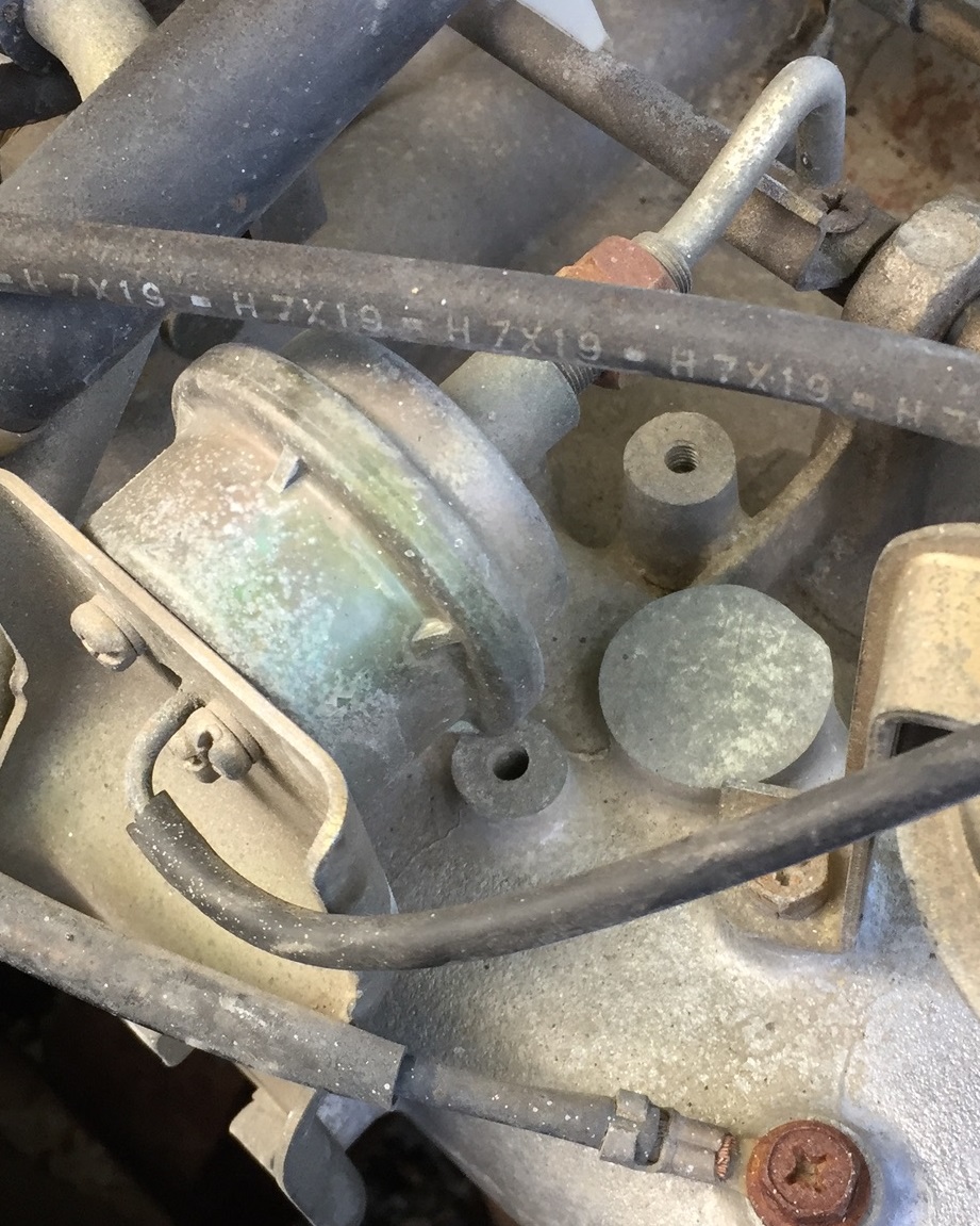

Hello all, Can someone please tell me what this is and what it does?  I was troubleshooting a vacuum line issue with my defroster and stumbled upon this. It has a  line going into it but then nothing coming out of it.   The line going into this doesn't connect to anything either.  It terminates near the vacuum bottle canister on the passenger side.  Any help would be great.  Thanks
https://www.classiczcars.com/forums/topic/56404-1978-280z-engine-component/
It is actuated when the AC compressor is engaged to increase the idle speed.  This compensates for the load the compressor causes.
