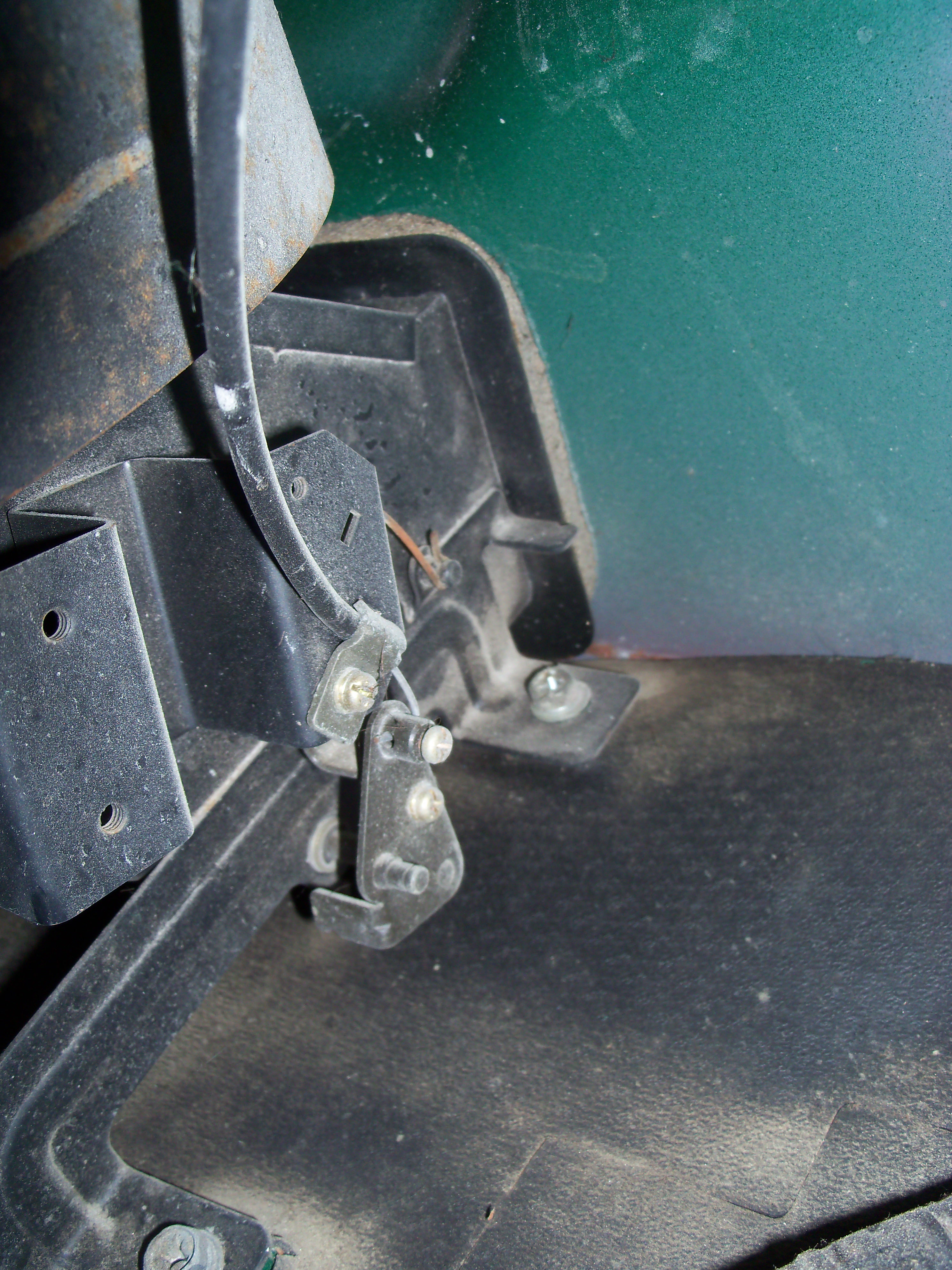

I pulled my heater control panel to fix this problem.  As I was reinstalling it I was making sure the cables and controls operated as expected.  I went to test this and BAM!  It bent again with little effort.  This is the cable that goes on the lower right side of panel to the vent door above the blow motor.  The door opens and closes freely and it has its spring mounted but the pushing action on the cable keeps bending it.  Before I buy any new parts can someone post up the routing of the control cable?  Maybe I am putting too many curves in it causing a build up of pressure.  Thank you!

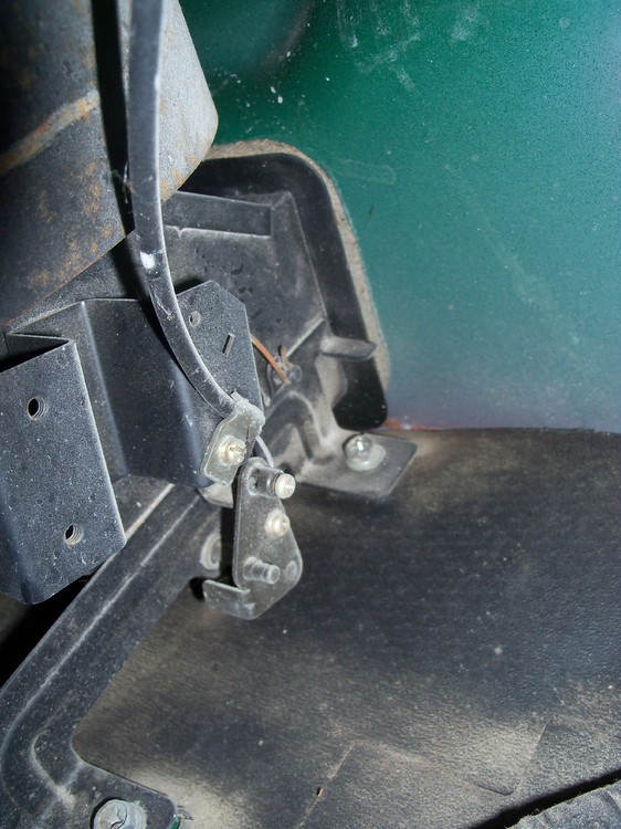

For sure it would be weaker IMO.  I took the liberty of zooming in for a closeup and notice there is metal wear on the lever arm, I wonder if it could be bent away from the frame it is rubbing on if that makes sense?  The lever arm would need to be bent away from the viewer just a little as viewed in your picture.
Edited by Mikes Z car

The cable has been bent before.  This would be the 3rd time I have fixed it.  I see the wear marks and I could try prying the arm away but I don't think that is my problem.  The action of level itself is smooth.  I think I am either routing the cable wrong or just need to buy a new one if it has indeed been weakened.

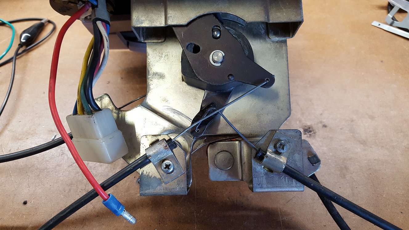

  3. Not sure what vintage of Z you're working on, but be aware that there was an earlier style of heater control mechanism that used thinner-gauge (1.0mm) control wires.  They didn't prove up to the job and tended to bend if there was any extra resistance in the system (due to corrosion, parts, interference or even, perhaps, mis-routing).  The re-designed system used 1.2mm wire (along with loops rather than straight-wire-and-a-pinch-screw used to secure the device end).  Note that the pictures below show the early design with the skinny control cables.

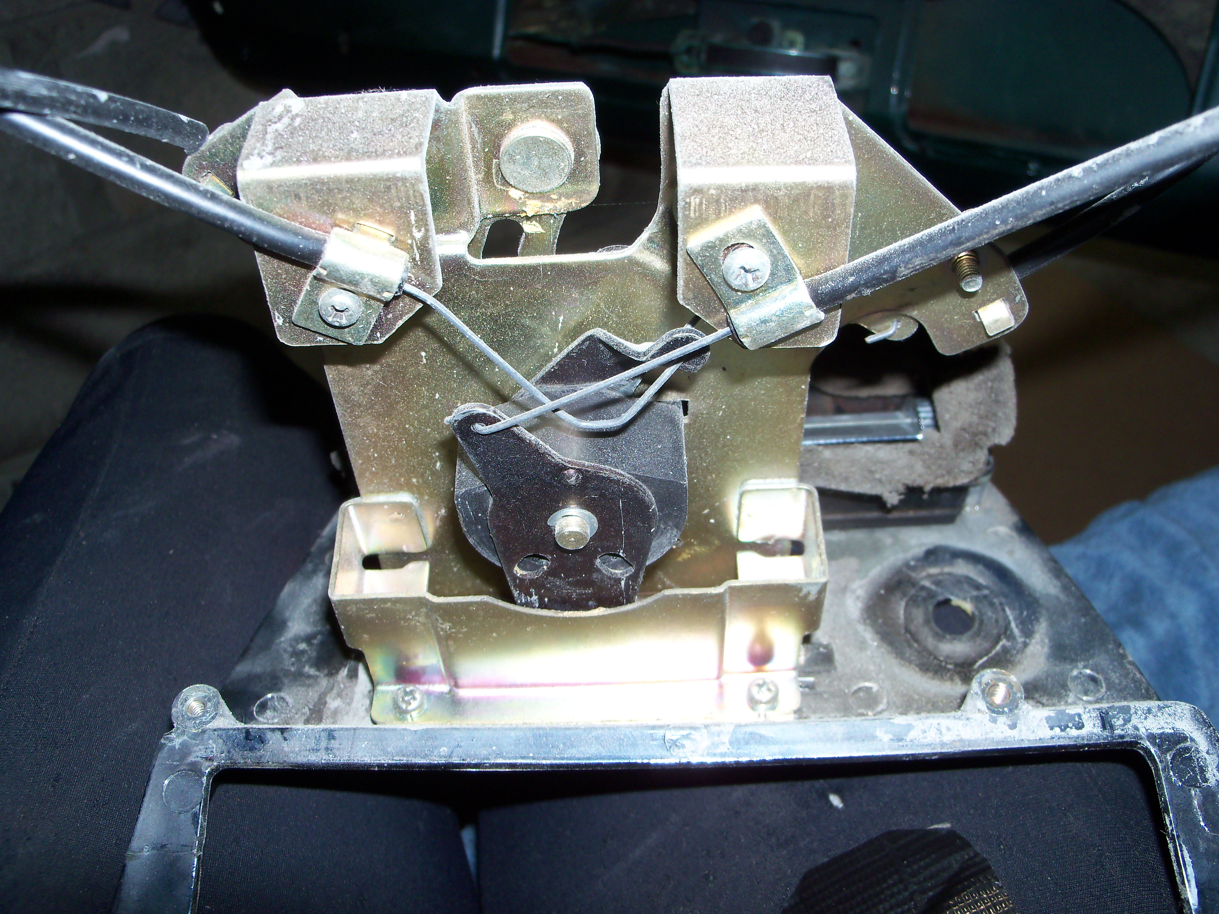

For your possible interest/amusement, here's how my Series 1 assembly looked when I took it out of the car.  The culprit here was a frozen heater control valve (and an impatient driver or passenger who was clearly not happy with the cabin temperature!).

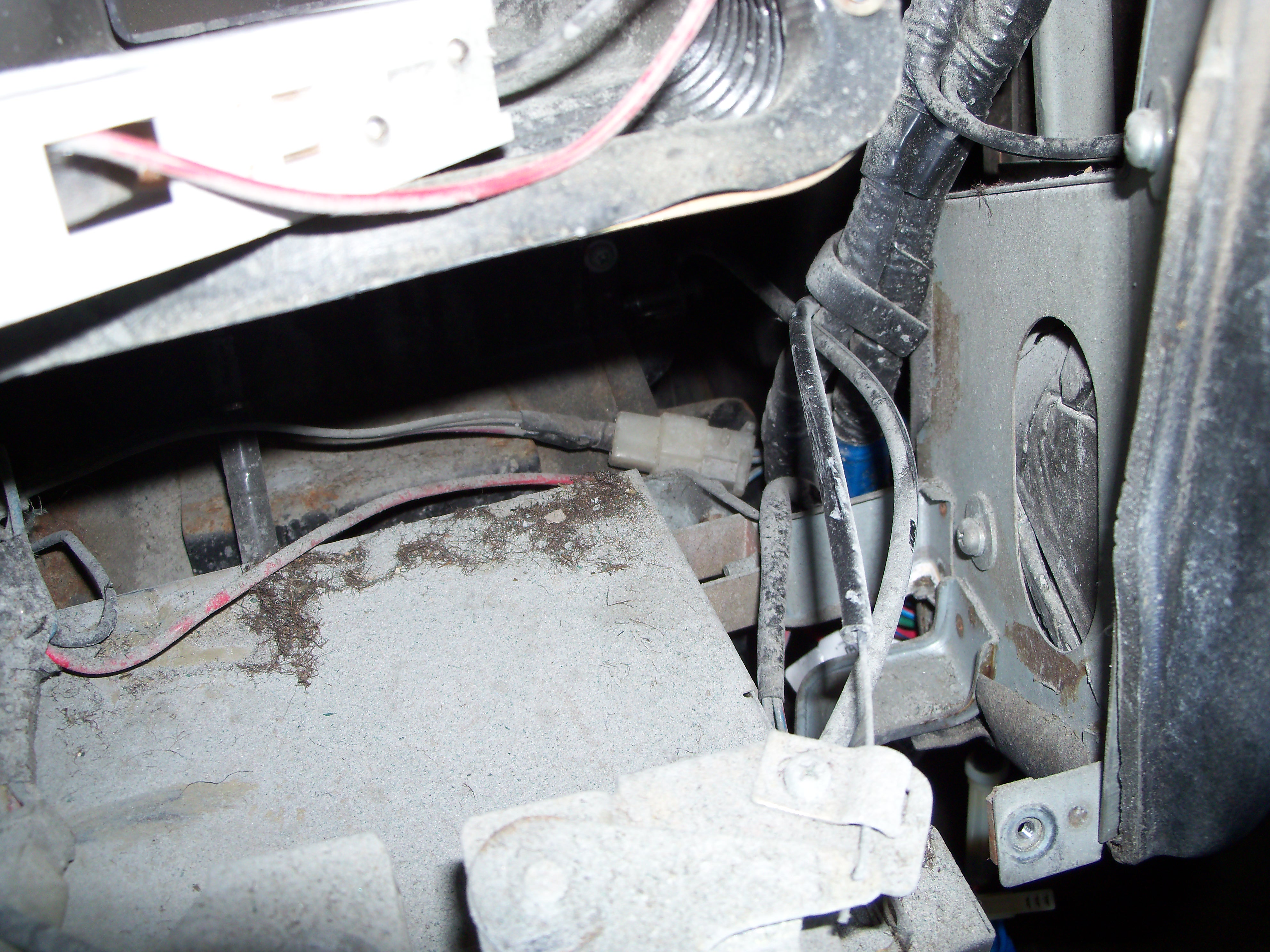

Below are the best pictures I have to show the original routing of the control cables.  These were taken as the assembly was being removed from the car as part of stripping the interior.  Unfortunately, for the cable that you're having trouble with they only show the end sections and not much of the middle part (notice that the device end of the cable where it mounts to the flap lever doesn't look to happy -- which may help to explain why the factory revised the device ends of the cables to a loop-over-peg design).
Looking in ^
Looking up ^

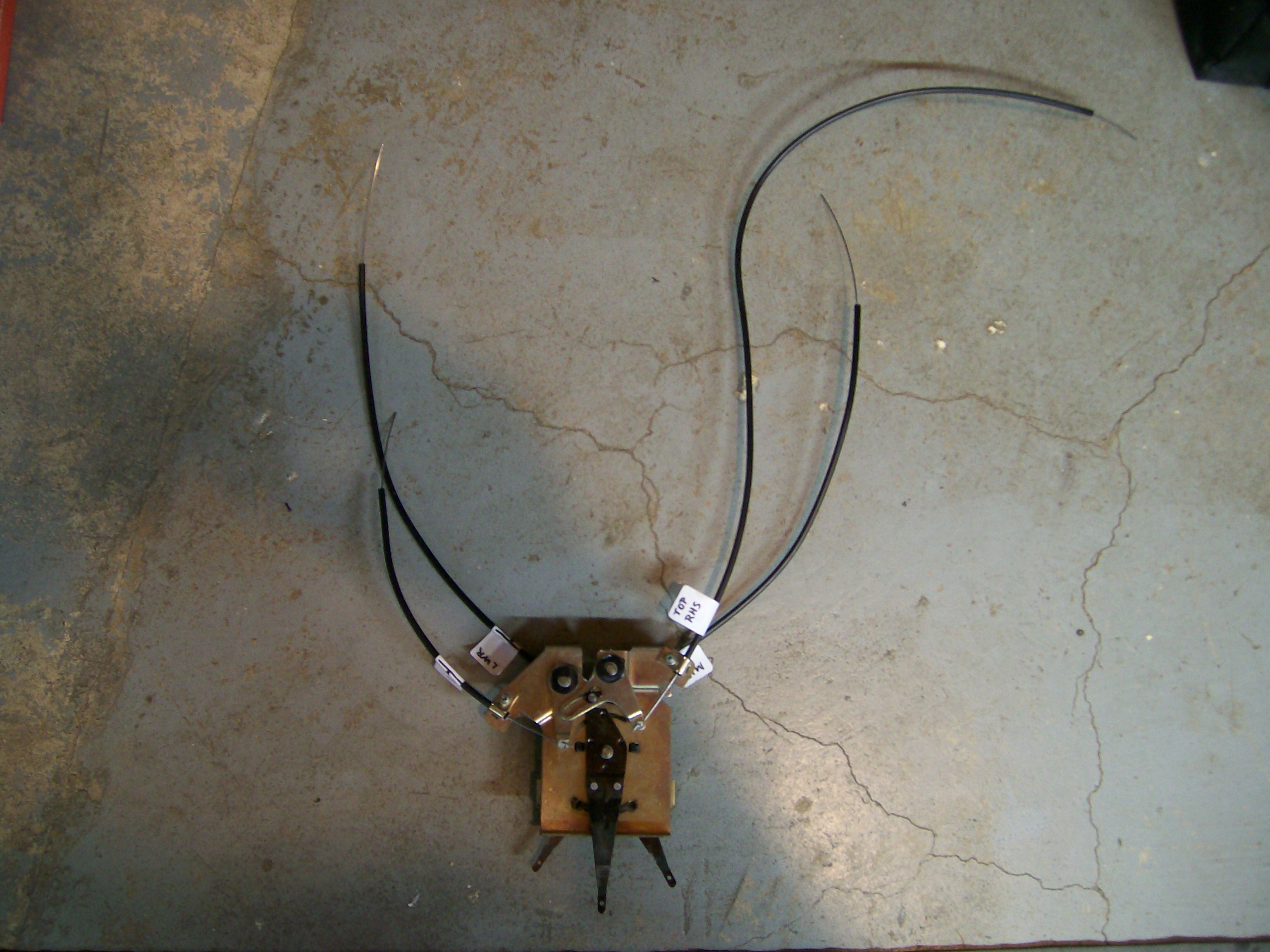

This final picture, showing the complete assembly lying on the floor of my workshop, may give you some additional clues about the cable routing.
Thank you Namerow for all the info and pictures.  My car is a 8/70 build 1971 240z series-1.  When I bought it none of the controls worked right as a previous owner had installed some cables that looked like generic choke cables from the auto parts store.  The current set of cables I have are used.  I picked them up from one of the mass parts sellers on Ebay.  Looking at the last picture you posted, I have my super long cable on the bottom right hand side when the controller is sitting the way yours is.  I thought the top RHS cable went to the hot water valve and the bottom went to the air flap door above the blower.  Is this how yours is set up?
