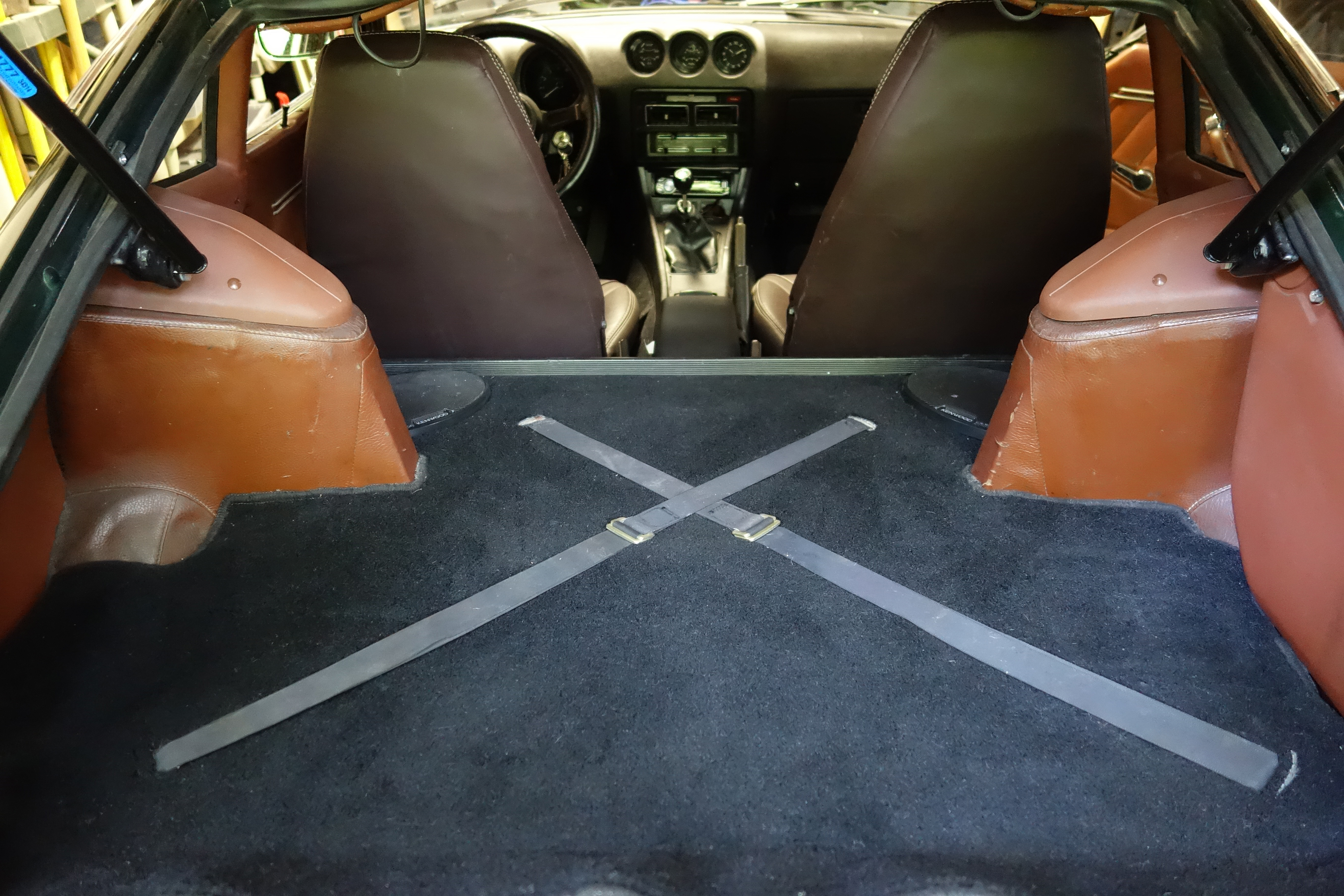

I know this is stupid but after I replaced my carpets, my interior of my '71 was very clean except for those luggage straps.  The sun faded them and/or the years stained them a dull grey brown. Cleaning them didn't help. I wanted to get some fabric dye but I heard the thickness can change the texture of the fabric.  I know the straps are nylon but I am painfully picky. I wasn't willing to take any chance.  I got gutsy and bought a bottle of liquid "Kiwi scuff cover" shoe polish at wal mart. The stuff is watery thin so you cant over apply or under apply.  The straps look new again but not artificially black.

RIT fabric dye is what I used to get my faded straps back to a nice black - no change to the thickness or texture of the material.  Soak the straps in a bucket with the dye and water for about 15 min., stir a few times, let dry, reinstall.
