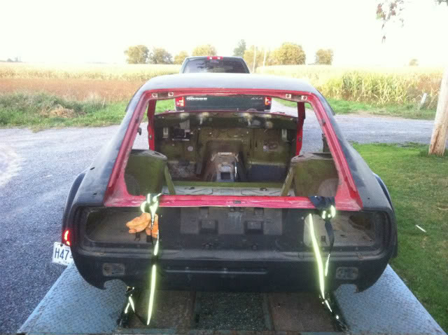

I will soon be making a trip to Oregon to pick up my Z for a 250 mile trailer adventure.  Unfortunately there's snow in the forecast, so, it might not be as soon as I want.  Anyway, I've already found a few threads on this subject, but, nothing explains the proper procedures to do this correctly.  Do any of you have photos or advice for the trip?  I'm planning to rent a U-Haul car-hauler.  Here's one of the threads I found:
I did see a few tips:
  1. Nose first
  2. Use the provided tire-straps in the front
  3. Cross brace the rear end with ratchet tie-downs
I'm a bit concerned there will be some gravel on the road so I'm not too excited about winter towing.  But, if I may not have a choice at this time of year.  Does anyone know if it's a good idea to put a car cover on before making the trip?  I would think the wind would cause some paint scratches.  I'm not too excited about rain, if I run into it along the way.  Appreciate any advice you guys might be able to help me with.  Thanks!

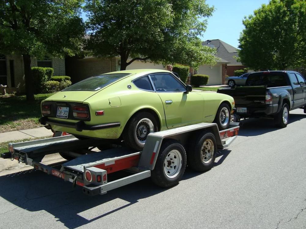

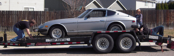

I've done it many times with my race car, buying/moving cars and helping my friend move Zs over the years. You can put some tape on the car like a like of people do for track days. I wouldn't put a cover on it. It'll just flap in the wind and probably do more harm than good. Your first two pics look good but #3 has the car too far forward. I cross brace in the front and rear. What kind of truck are you using to haul it? I've been using a 2006 Dodge Ram Quad Cab Hemi 1500 and it'll do the job with ease if you position the car correctly on the trailer.

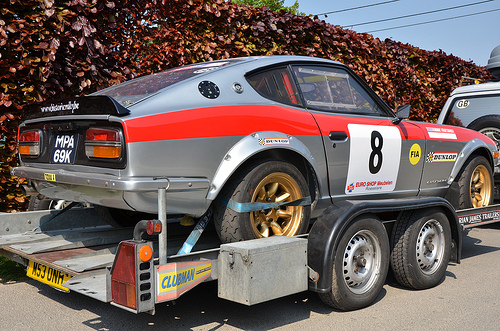

In pic #6 the car is centered because he has a tire rack, wheels/tires and a big storage box at the front. He's also using an SUV so he can't have as much tongue weight. You want the Z a little forward on most open trailers to keep the weight forward just a bit as shown in pics 1&2.

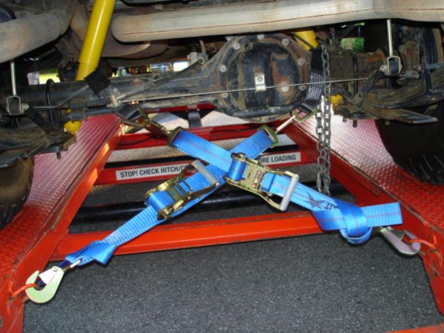

Thanks guys!  I appreciate the help.  I'll leave the cover off and do what I can to put the trailer on a small hill for loading.  I am picking her up from my storage unit so most of the place is flat.  If I have a problem I can probably grab my big jack for the truck and lift up the rear end (if I have clearance problems).  @jfa.series1 and @siteunseen, since you have experience with the U-Haul trailers, do you have any advice on securing the rear end of the Z when it's mounted on the trailer?  I noticed the U-Haul trailer is open in the center so I'm assuming there are going to be mount points where I can use some ratchet straps.

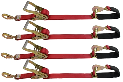

I found something called an axle strap on the Internet, I may look for a set of these for the rear end.
I also found this photo of a possible mounting solution underneath the U-Haul trailer.  I am glad to see they have D-hooks on the center part of the trailer.  Just not sure where to mount these on the Z.  We will see when I get there.

The Lexus should tow it but I'd make sure not to go too heavy on the hitch. I clip the front straps into the holes in the Z's front crossmember and use straps that pass through the rear wheels. Both sets are crossed in an X pattern like in your pic. I put the car in gear and pull the hand brake on tight before strapping it down. Instead of parking on a hill you can just crank up the front of the trailer to change the angle. My race car has maybe 3-4" of clearance at most and I've never scraped in the ramp/bed transition. But I often have the air dam scrape on the ramps. I doubt if a Z at stock height would rub. Don't drive too fast. I think the speed limit is 55 or 65 in CA when pulling a trailer.
