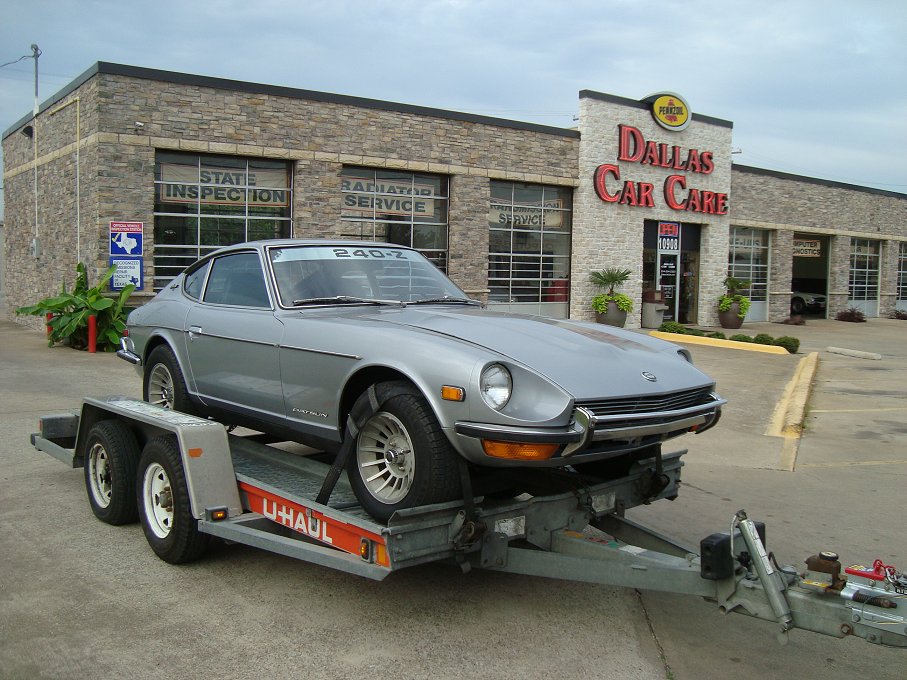

I saw this thread and wanted to add on my personal experience with the U-Haul car haulers.  They really are the best and make moving a Z safe and easy.  The fold down driver side fender is a true blessing,  Here is my 240z on one when I purchased it in June 2014.

what is a fold down driver side fender?

On the driver side of the trailer the fender is hinged and folds down so you can open the door of the car.  This way it is easier to get in and out of the car when it is on the trailer.  There are two rubber T handles that you simply pull up out of their attachment points and the fender simply folds down.

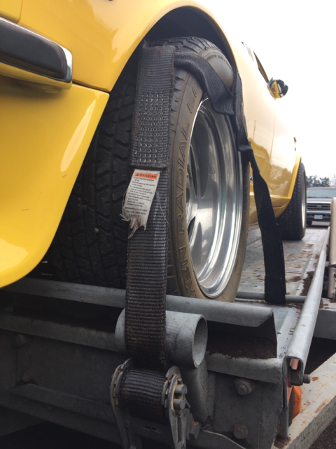

Glad the trip worked out as planned. My only comment is that I thought you were supposed to have the strap centered down the middle of the tire. The lower ratchet point moves inboard and out to allow for adjustment, and I think centered is desired. I know it doesn't matter for you now, but maybe for the next guy?
I'm no expert on the use of those trailers, but maybe someone else more experienced can confirm / deny?

Thanks Captain, I just now noticed the ratchets could be slid to the center of the tire! As you pointed out, mine were a bit to the outside. If anyone rents one of these trailers, I highly suggest bringing a can of WD40 to lube up the ratchets. Mine were pretty stiff and (if I had noticed the slide adjustments) it would have been extra difficult to adjust them to center. Not to mention it was 30 degrees in the morning so things were extra stiff.
