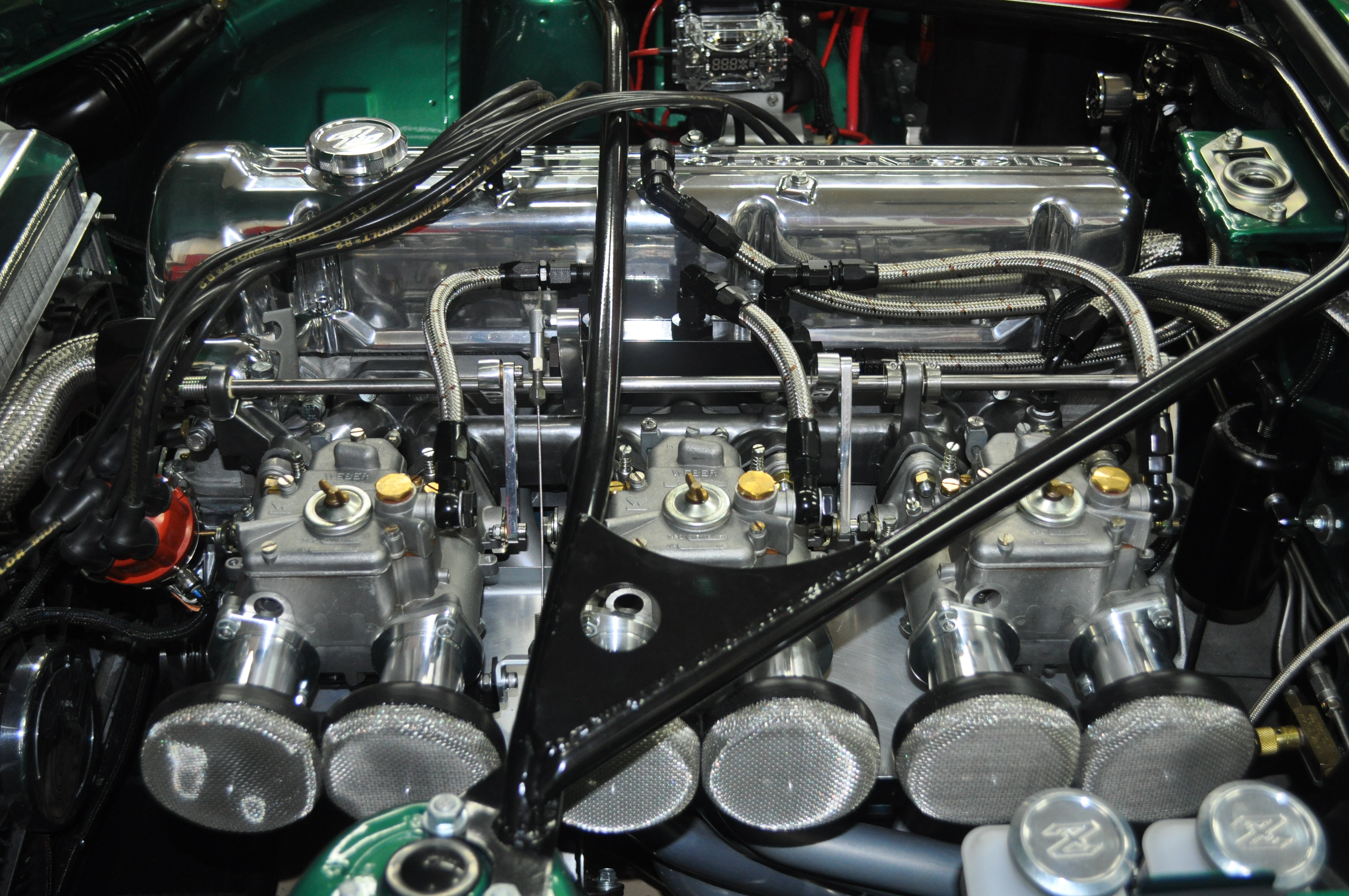

I have triple Webers on my car and by that measure I am partial to Weber as opposed to Mikuni.  Having said that I know numerous Z owners with Mikunis who are quite happy with them.  In my opinion however, the Webers along with repair parts and jetting options are much more readily available than the Mikunis, which tilts the balance in favor of Webers.  Just my 2 cents.
Hope that helps.
Mike.
Functional differences are small between them. Most street users will never know the difference.
As Mike W says, the real difference is availability and parts access. Webers win hands down.  Mikuni prices are going a bit crazy too. Like stroker cranks and S1 console fuse box covers, they are better investments than any stock I've seen lately
Comparing my Mikunis to my friends Webers I noticed that some adjustments were easier for me. My 40's allow for a external adjustment of the float . Very accurate too. I believe acceleration pumps are also more accessible on the Mikunis- but can't say for sure of all Weber models .
I think Mikunis are more desirable but also more $$.

There you have it.. Webers for accessibility and ease of finding parts.  I highly recommend them.  They are a simple design that has many decades of experience available to you on this board to help out.  Weber junkies like to help each other. Soon you will be talking emulsion tubes and idle jets and air correctors like a pro
