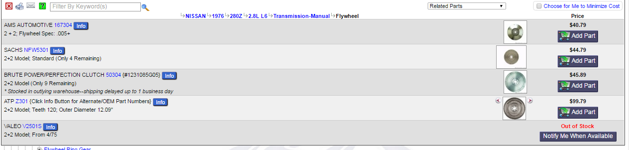

I think that the flywheels you showed in the image are all 240 mm.  Not clear why you think that they're 225 mm.  The 225 mm is essentially NLA, very difficult to find.
Here's the image for 1976 280Z.  Rockauto only shows the 2+2 as available and the numbers match what you showed.
I have no clue why I thought it would be a different size :D Thanks for the the hint! So I get everything I need for the 240z 4spd trans if I buy the 240mm flywheel and this 240mm(?) clutch Link? Is the bearing enough for the swap? Thanks guys!
