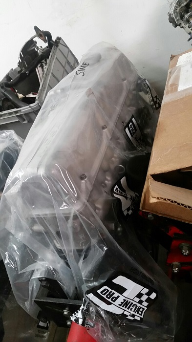

December 15, 20168 yr Author comment_508133 Here's the motor as it sits now at Rebello Racing. Link to comment https://www.classiczcars.com/forums/topic/56686-just-another-damned-project-thread/#findComment-508133 Share on other sites More sharing options...
December 15, 20168 yr comment_508134 Very nice! Sounds like a respectable combination of parts for driveability and power! Link to comment https://www.classiczcars.com/forums/topic/56686-just-another-damned-project-thread/#findComment-508134 Share on other sites More sharing options...
