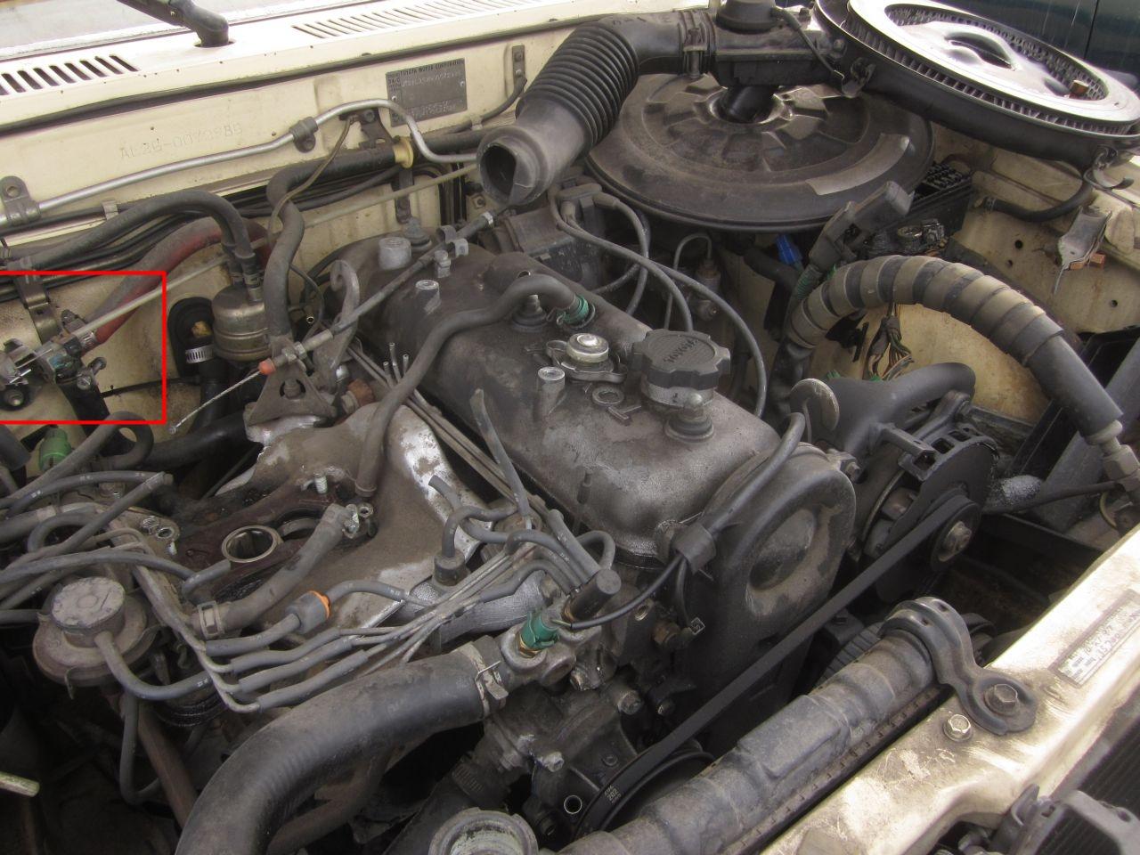

July 5, 20186 yr Author comment_552414 Site, I've got two valves up in the engine compartment. One of them is cable controlled by the temp slider on the dash, and the other is a small PEX brass ball valve from the big home improvement store. I closed it about halfway and then took the handle off. I put that one in because the core got hotter than I really needed and I found that I only used the bottom 1/4 of the temp slider adjustment. With that additional (fixed) restriction in series with the temp control valve, I now use about 3/4 of the adjustment range. Which valve are you looking for pics? BTW - The temp slider valve was documented in a thread, but of course, the pics are gone because Photobucket extorted them out of existence:https://www.classiczcars.com/forums/topic/44009-heater-water-****-valve-relocation-project/ Link to comment https://www.classiczcars.com/forums/topic/56726-heater-core-alternative-escort-core-into-260280/?&page=7#findComment-552414 Share on other sites More sharing options...
July 5, 20186 yr comment_552415 My old toyota tercel wagon (breaking bad) had the water valve in the engine compartment. I learned to lubricate it if I wanted heat. Link to comment https://www.classiczcars.com/forums/topic/56726-heater-core-alternative-escort-core-into-260280/?&page=7#findComment-552415 Share on other sites More sharing options...
July 5, 20186 yr comment_552430 10 hours ago, Captain Obvious said: Site, I've got two valves up in the engine compartment. One of them is cable controlled by the temp slider on the dash, and the other is a small PEX brass ball valve from the big home improvement store. I closed it about halfway and then took the handle off. I put that one in because the core got hotter than I really needed and I found that I only used the bottom 1/4 of the temp slider adjustment. With that additional (fixed) restriction in series with the temp control valve, I now use about 3/4 of the adjustment range. Which valve are you looking for pics? BTW - The temp slider valve was documented in a thread, but of course, the pics are gone because Photobucket extorted them out of existence:https://www.classiczcars.com/forums/topic/44009-heater-water-****-valve-relocation-project/ Here's what I need your expertise on. I found the thread but need more specific answer like yes or no on my idea that putting a valve off the head is the same as closing the OEwater coc... Link to comment https://www.classiczcars.com/forums/topic/56726-heater-core-alternative-escort-core-into-260280/?&page=7#findComment-552430 Share on other sites More sharing options...
July 5, 20186 yr Author comment_552439 Yes. Plugging the elbow nipple on the back corner of the head is the same thing as closing the water temperature control cocck. And if you are putting in a manually (hand) controlled ball valve, it doesn't matter which side of the core it goes on. Link to comment https://www.classiczcars.com/forums/topic/56726-heater-core-alternative-escort-core-into-260280/?&page=7#findComment-552439 Share on other sites More sharing options...
