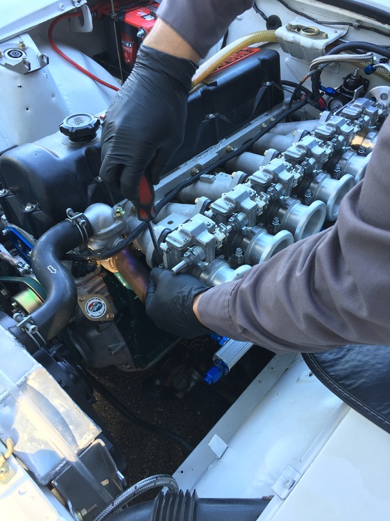

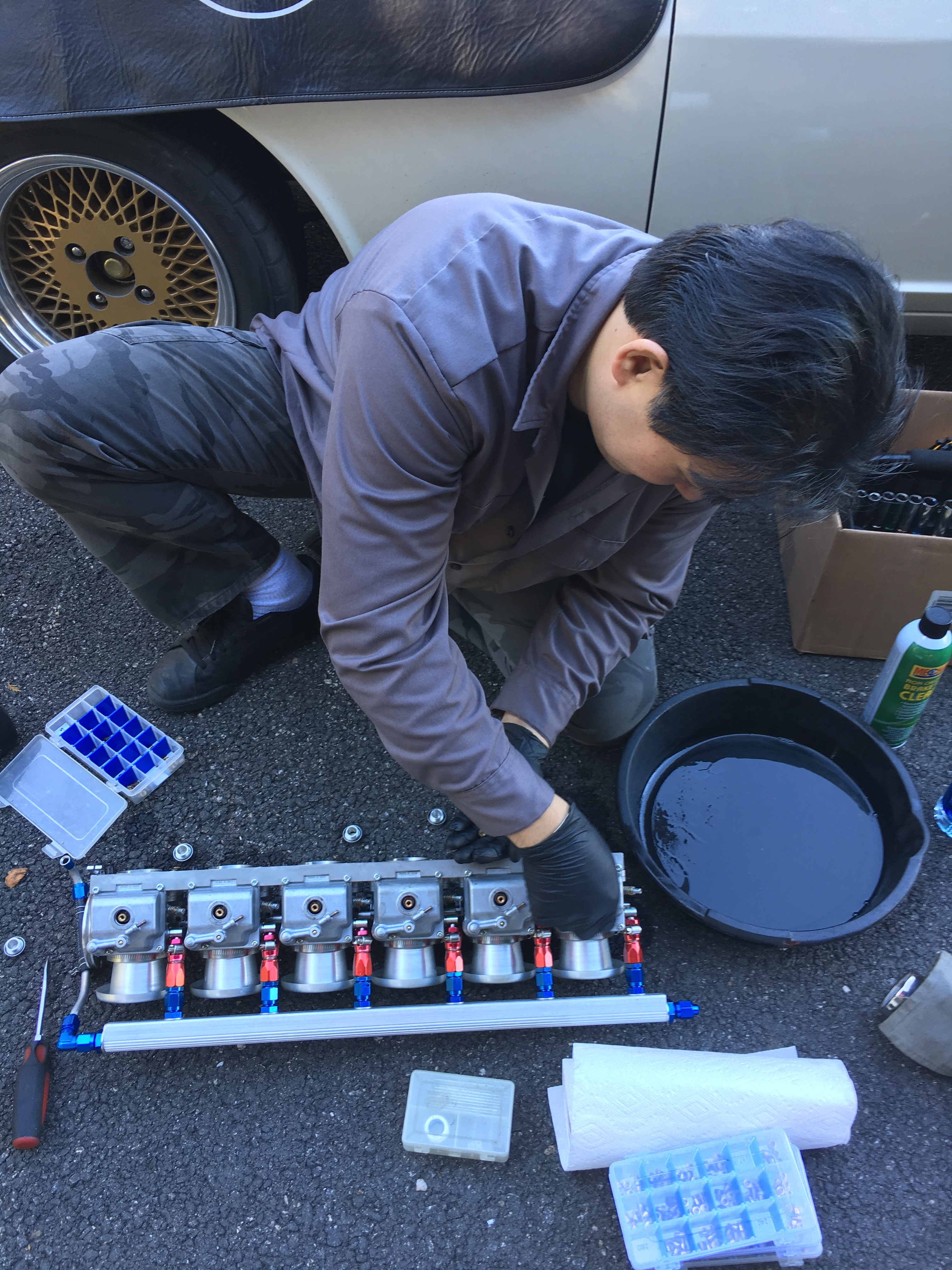

January 2, 20178 yr comment_509402 Some pics I took of Eiji's stroker......crank fire ignition. Link to comment https://www.classiczcars.com/forums/topic/56751-l28-stroker-build-i-need-your-advice/?&page=3#findComment-509402 Share on other sites More sharing options...
