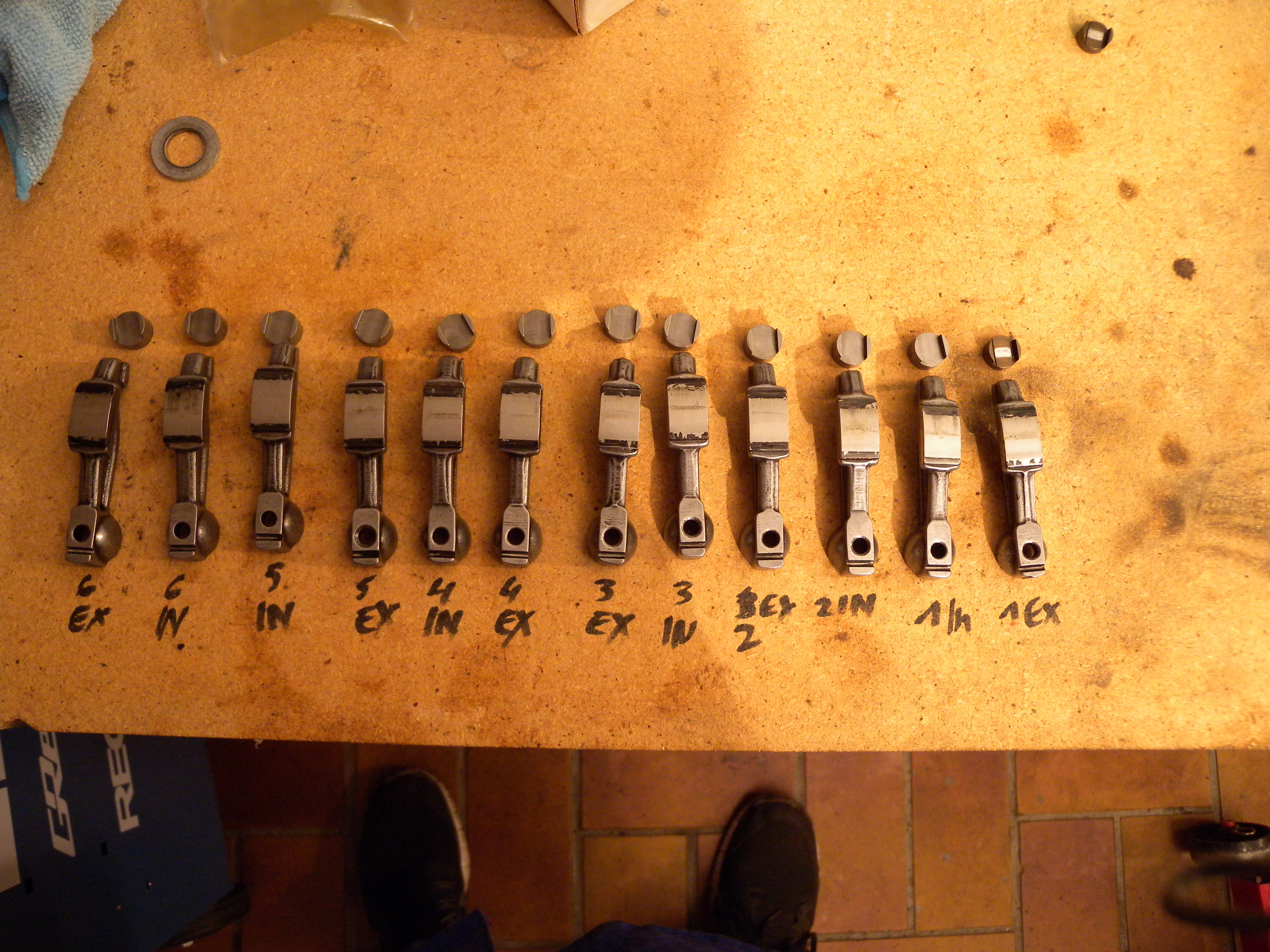

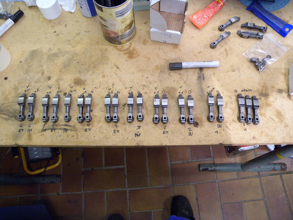

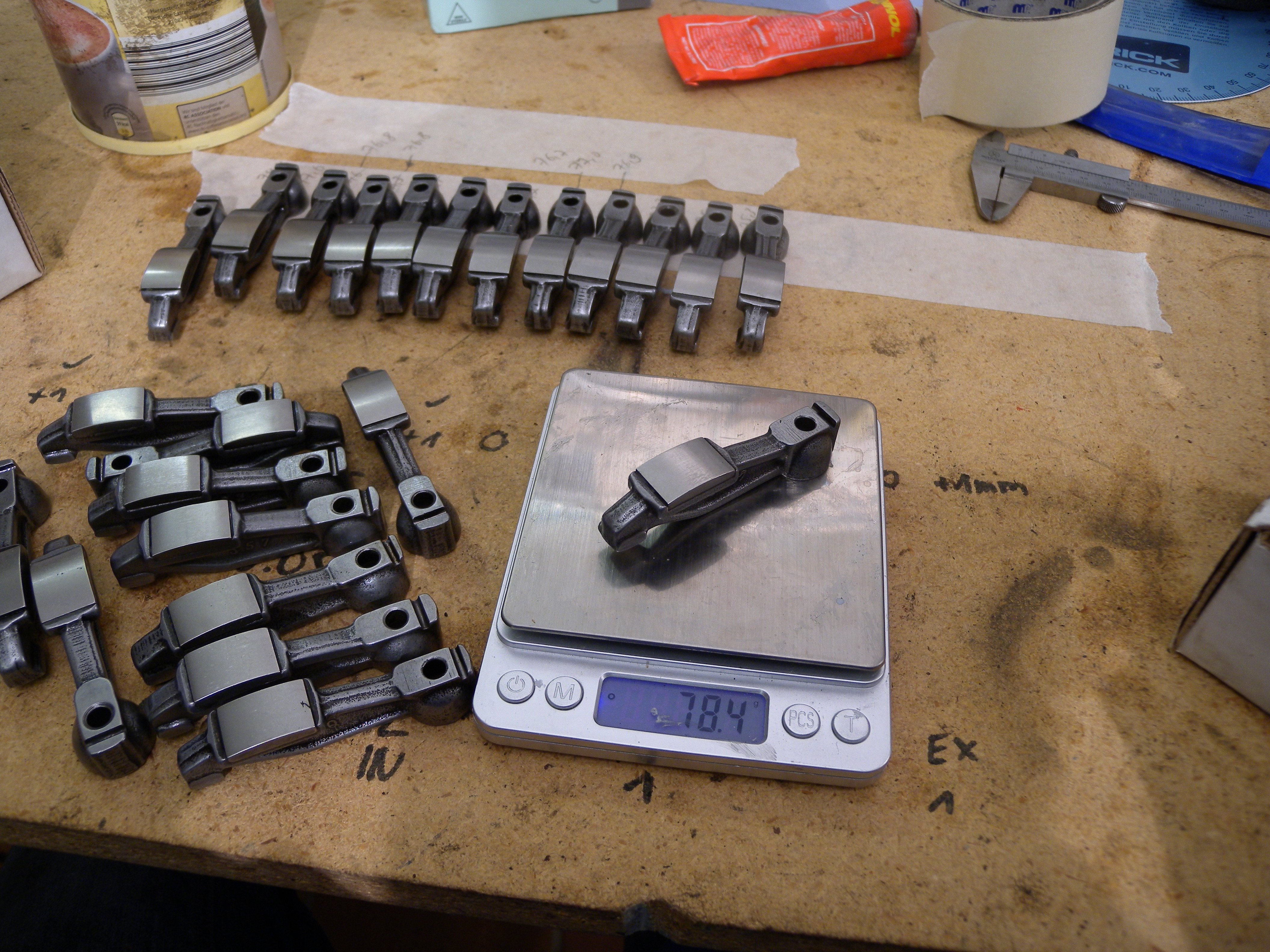

Today I weight matched a rocker arm set. Now all rockers are within 5g.

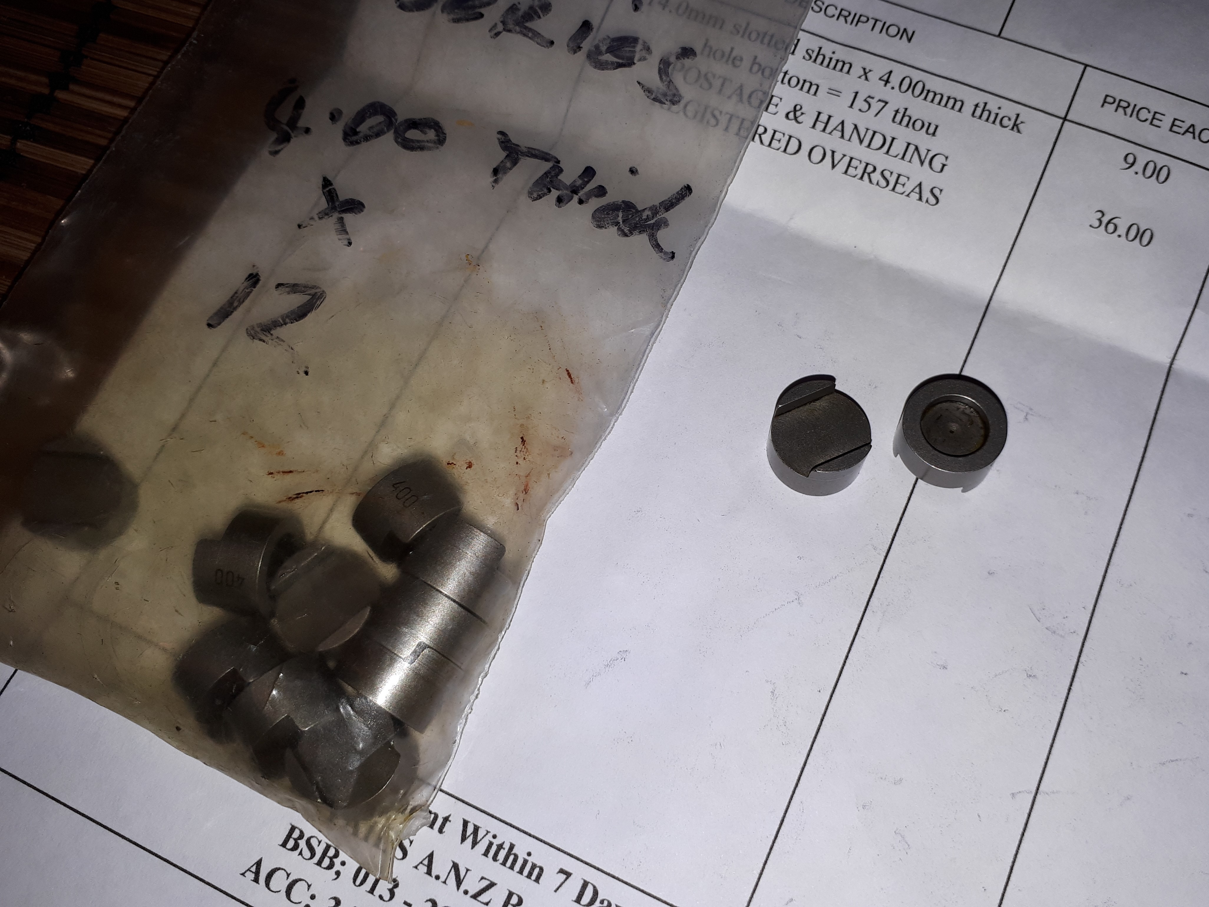

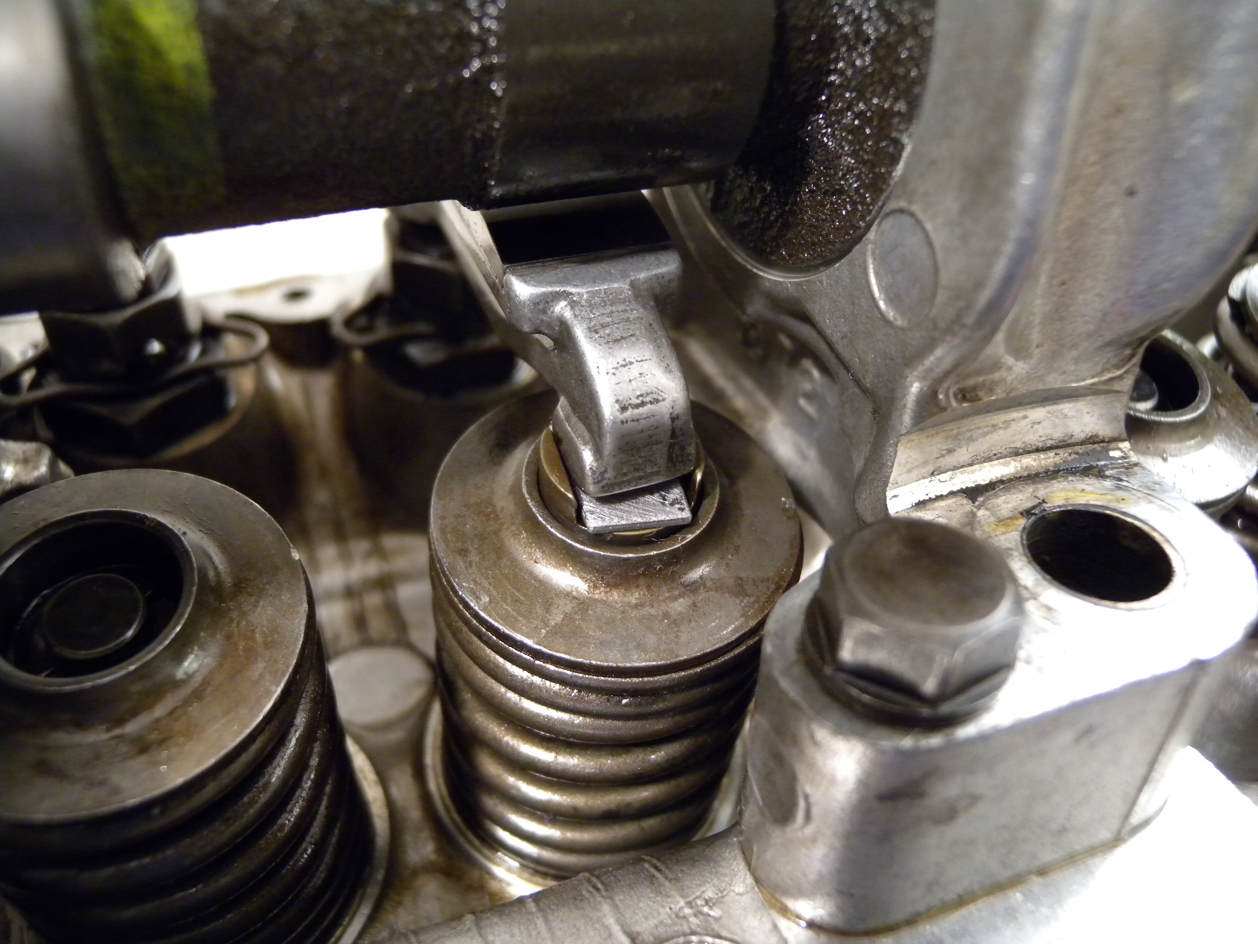

This how I found out that I need 4mm lash pads - added a 1mm metal strip, wipe pattern was perfectly centered then:
Checked all valves with stock pad and stock pad+1mm
Rechecked it with the new lash pads (top quality - got them from precision shims australia)

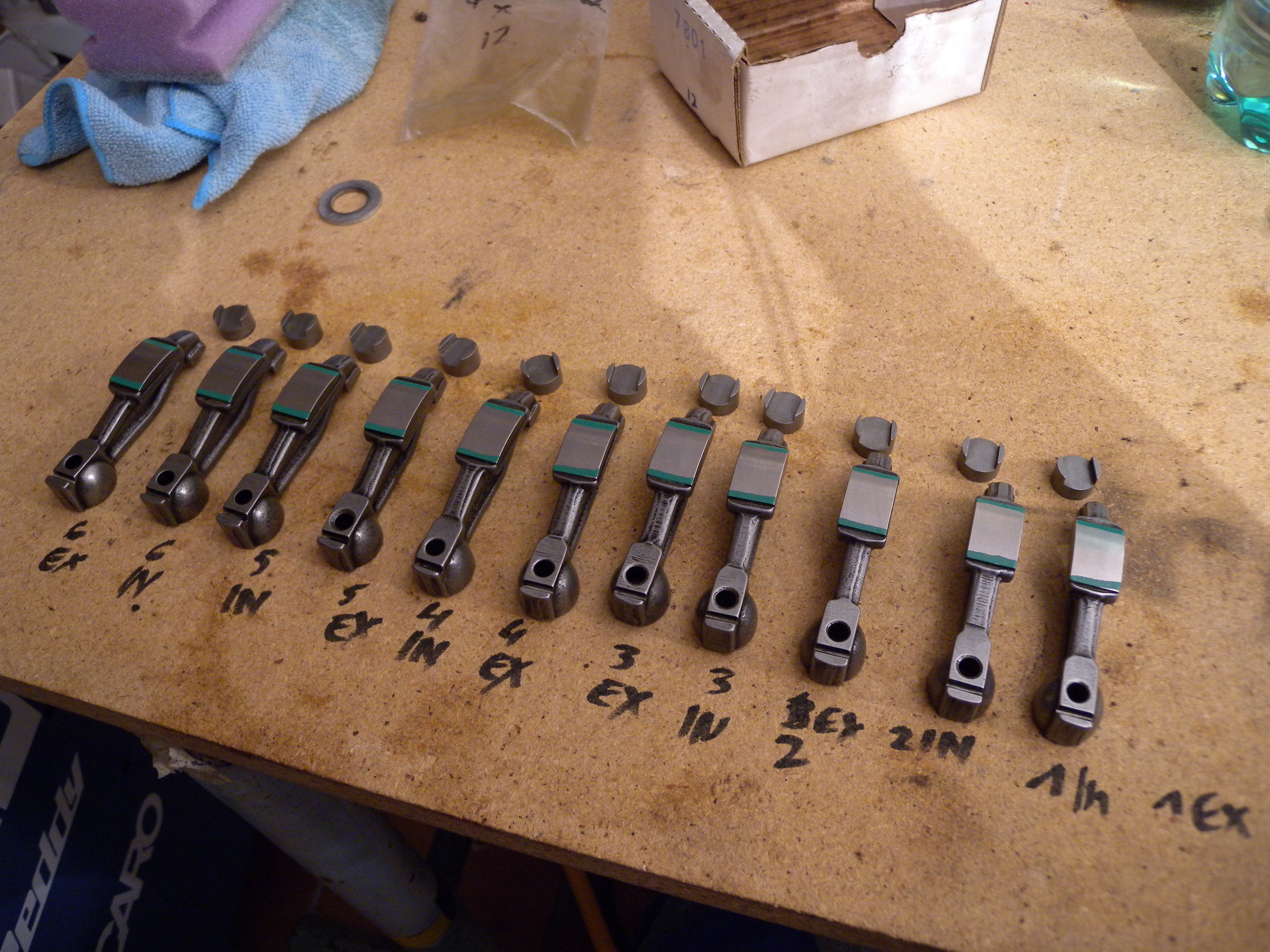

Finally, I added a green line of permanent paint marker to each rocker - it will last for some hours of engine running and allows to easily check if everything is still working like it should
Setting valve lash

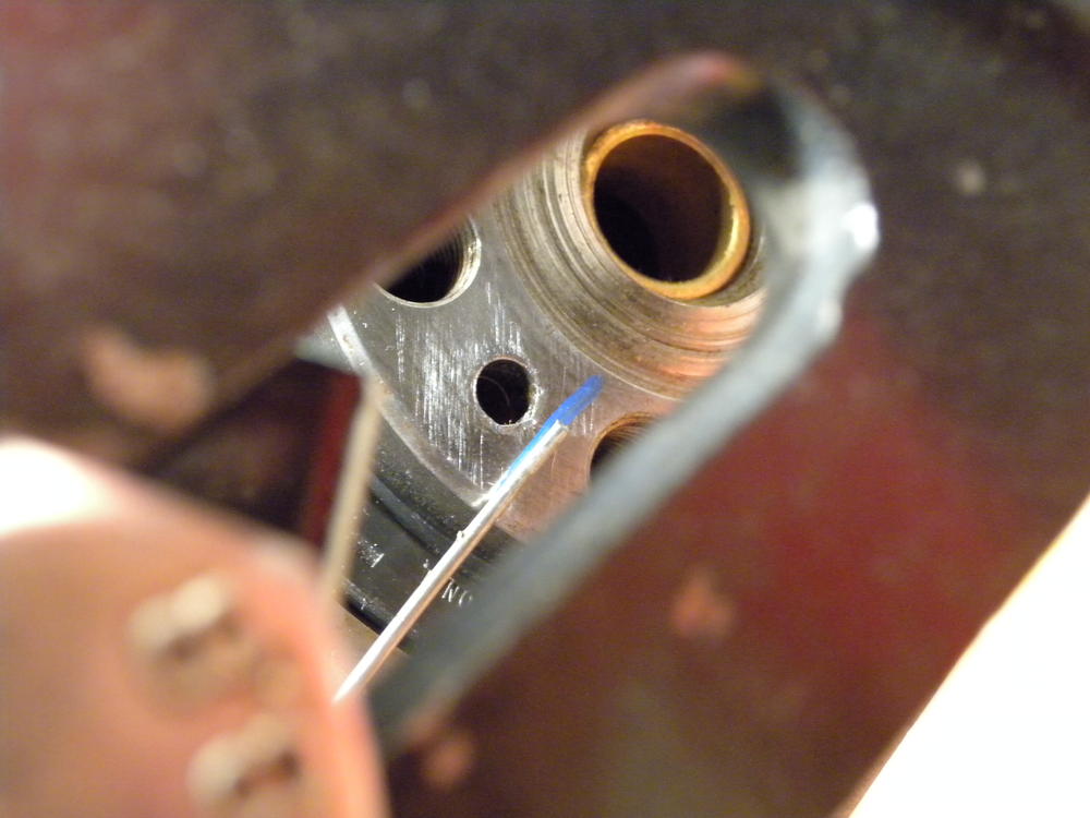

Finding true TDC
Set a marking at the backside of the crank. That way I can easily check the accuracy of the ignition timing pointer!

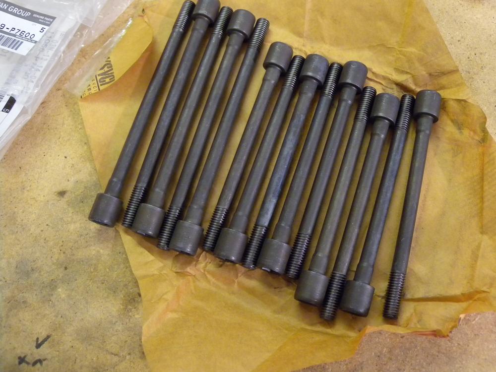

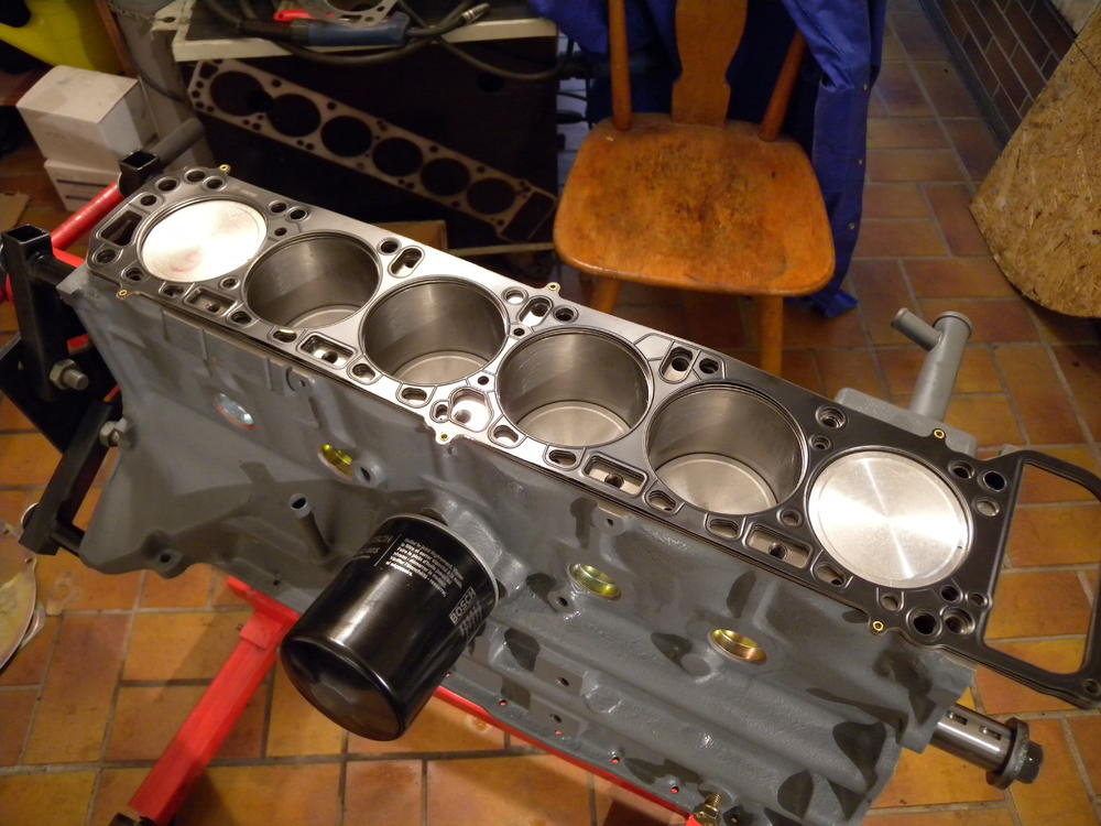

COMETIC multi layer steel gasket (2mm)
280ZX Turbo head bolts, new OEM

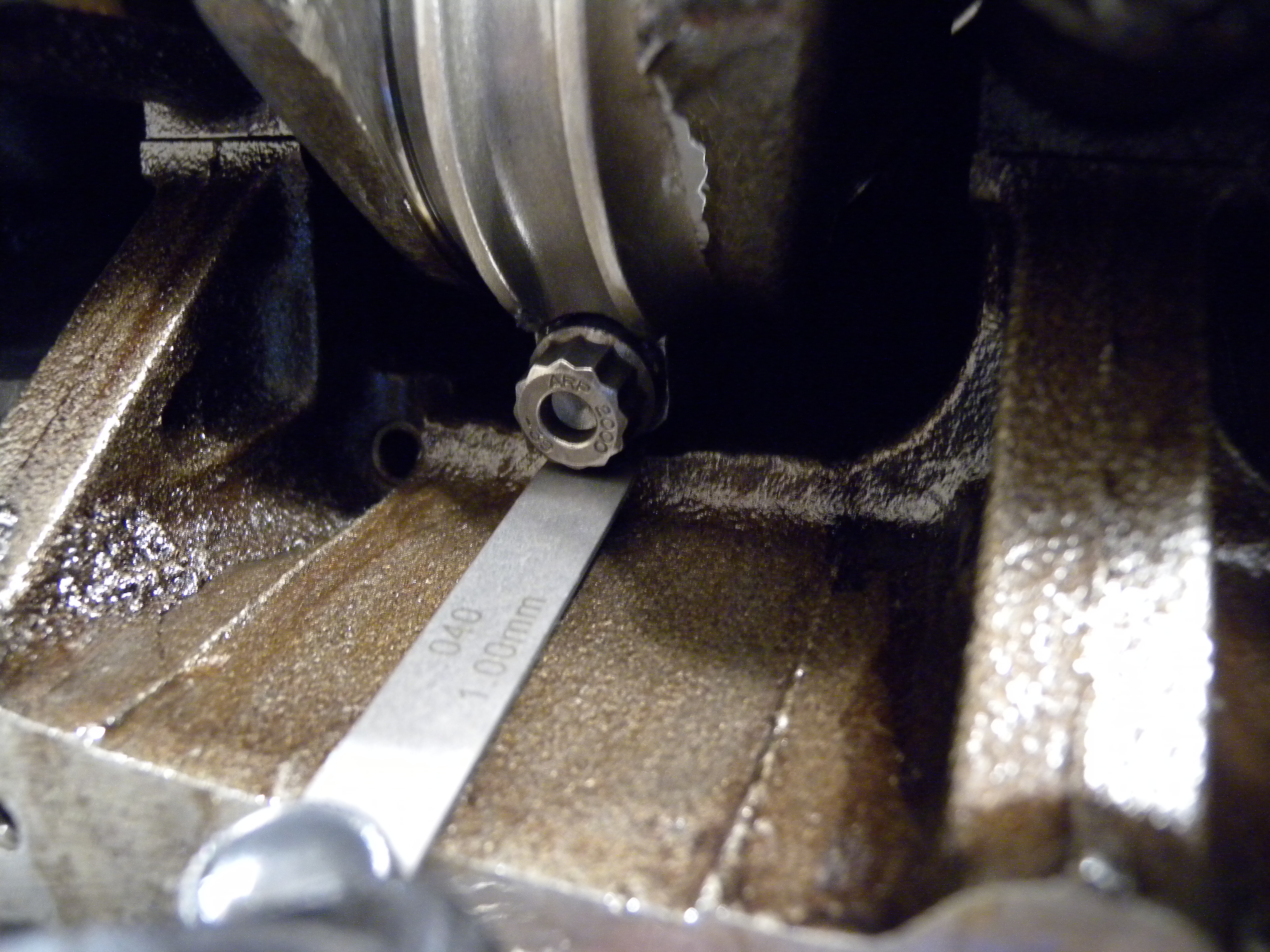

Double checked conrod-crankcase clearance (had a bad feeling). 1mm (0.04"), pretty tight, but should work. I don't want to remove any more material as it weakens the main oil gallery (not sure about the wall thickness!)
But now a real show stopper: I got the wrong timing chain. Ordered the right one, but received a different kit wit 44 instead of 42 links between the bright marks. So engine work is on hold until the new kit arrives (probably around mid december). For now I put the valve cover on.

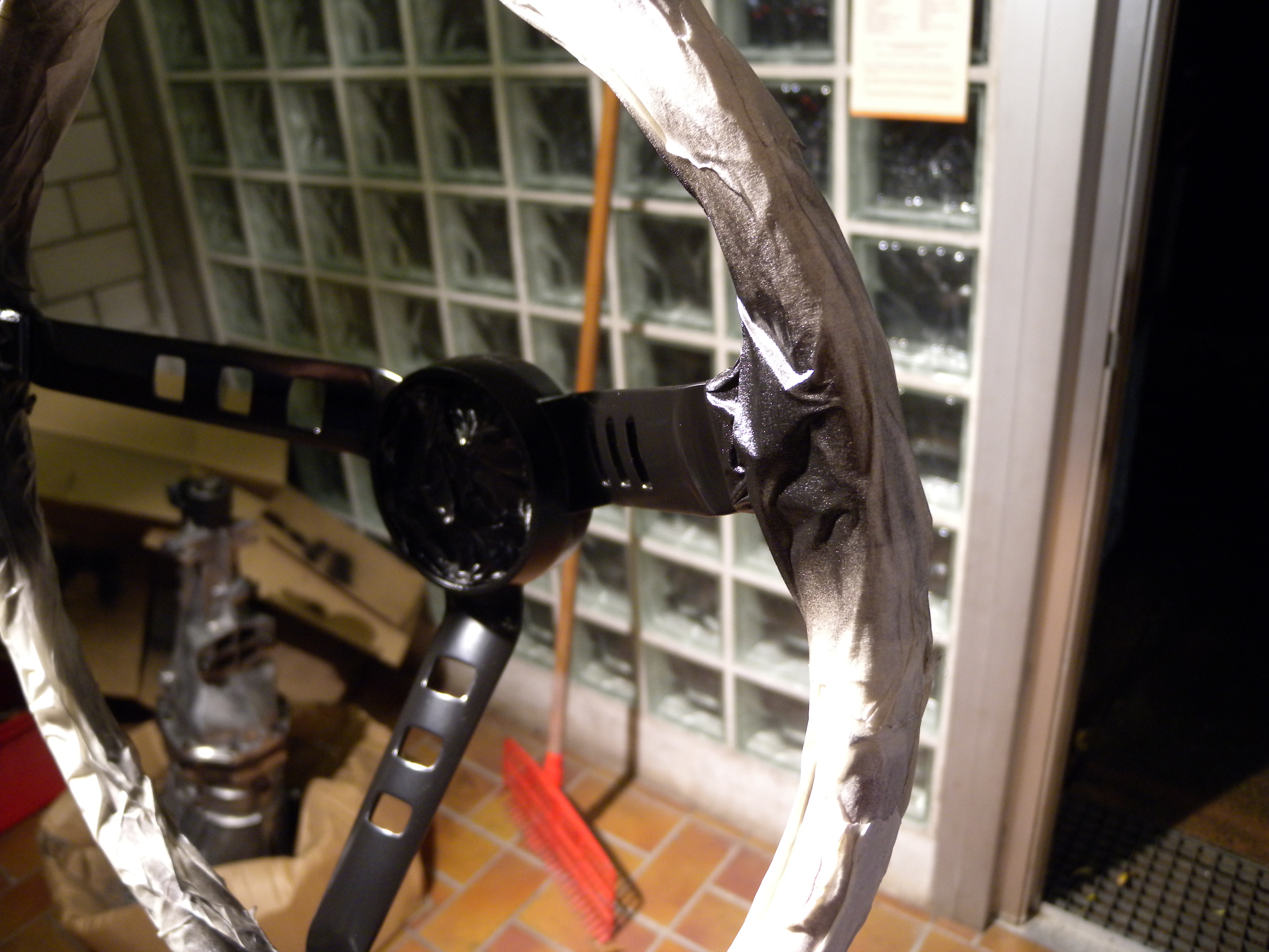

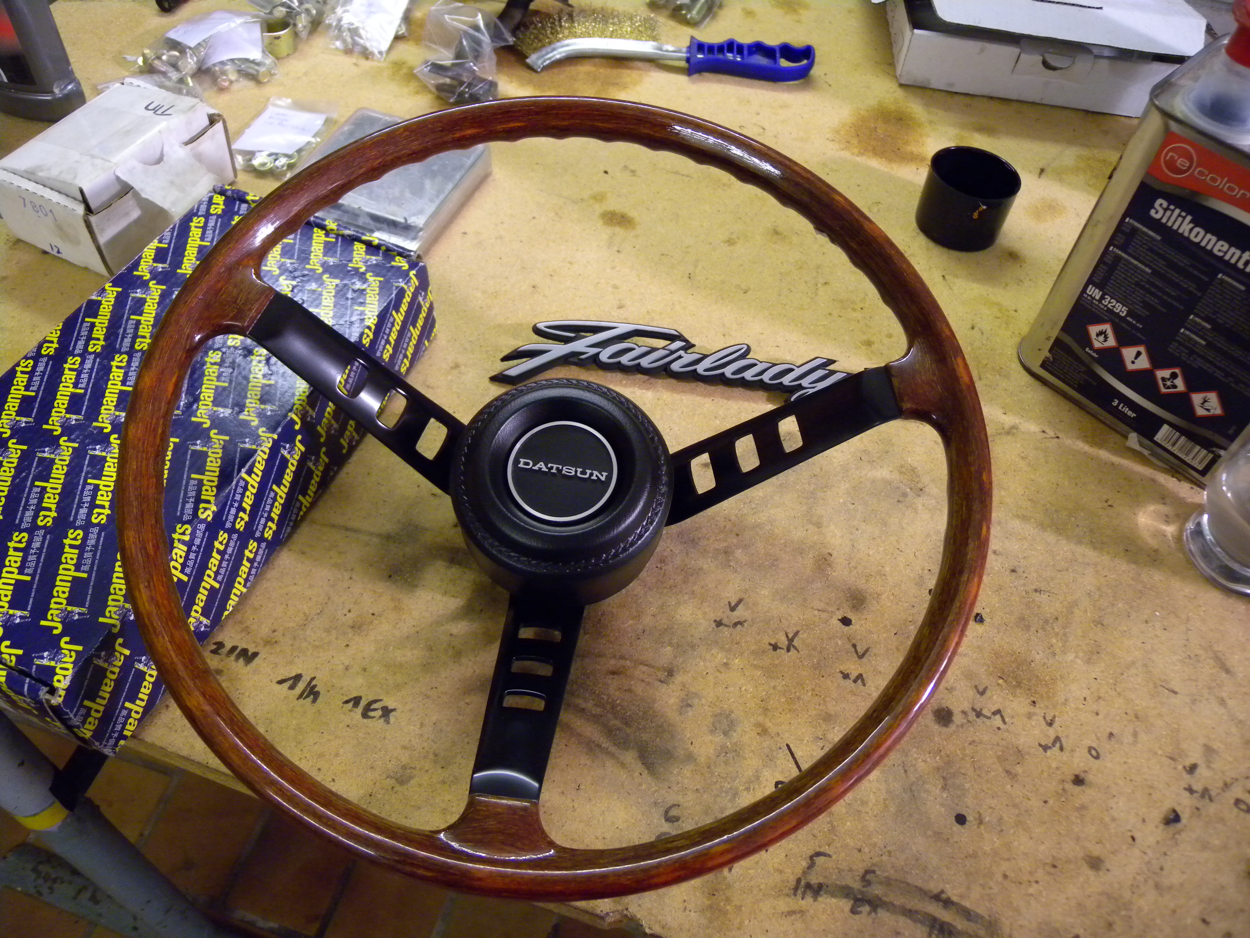

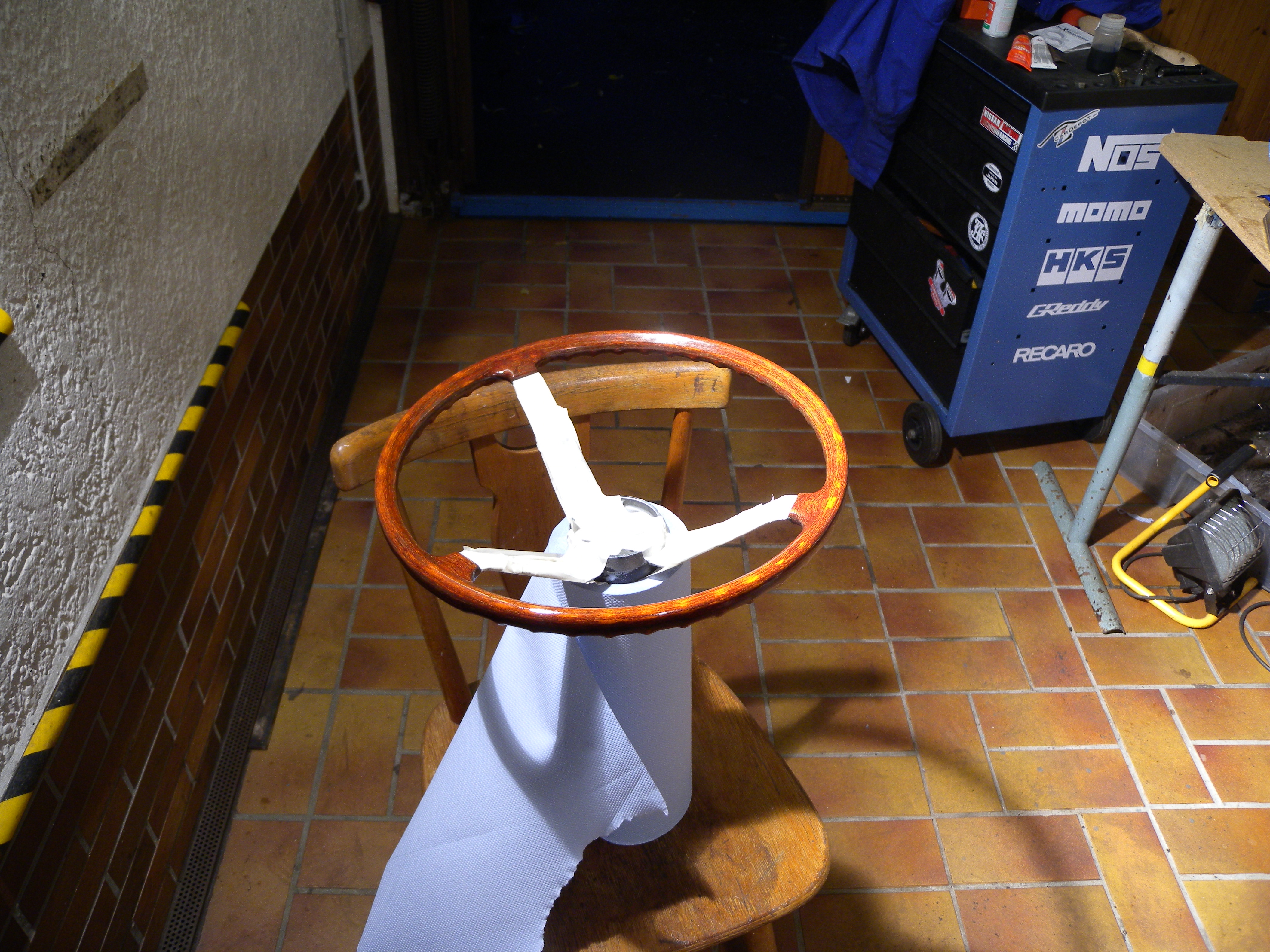

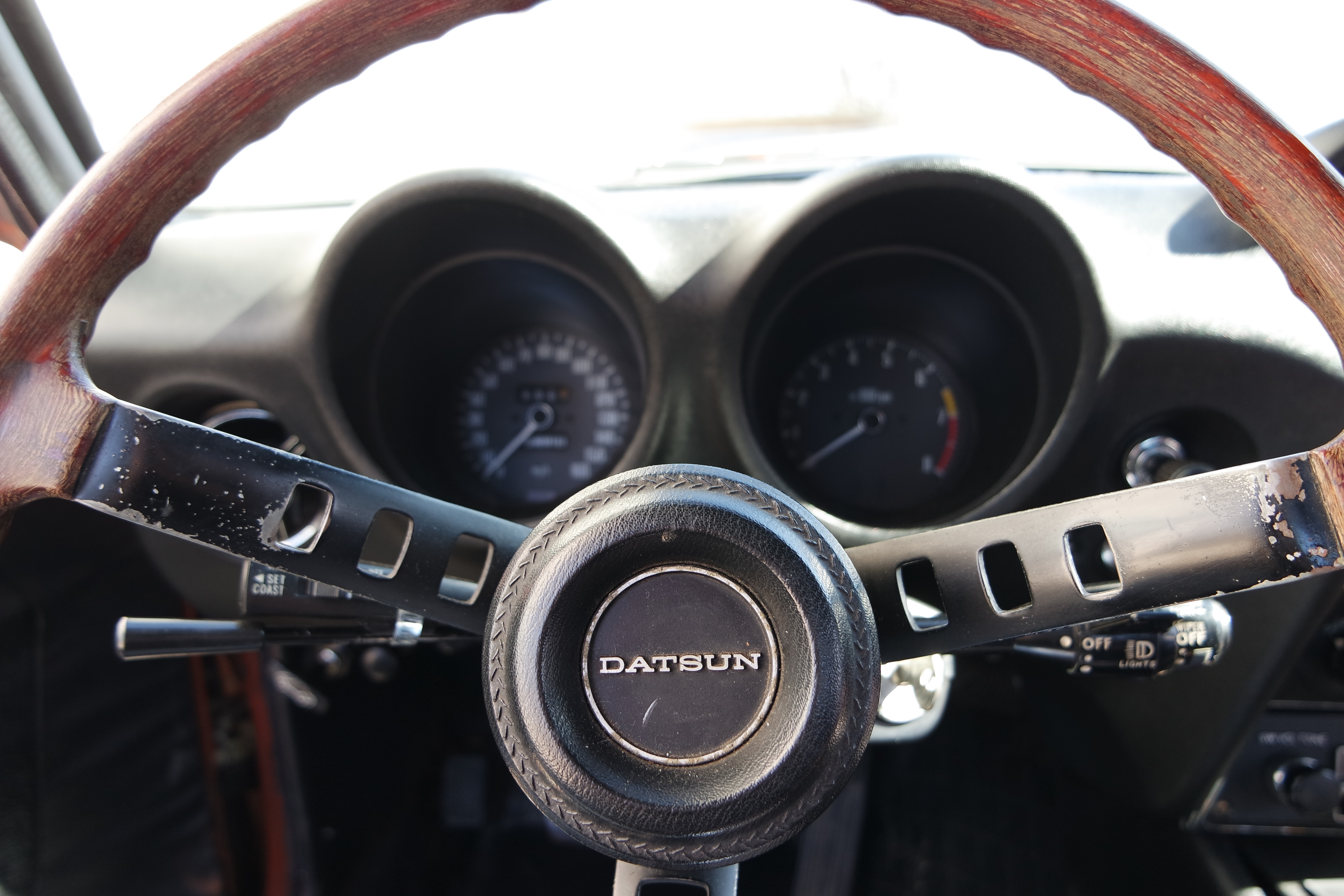

And worked on the steering wheel :)
Before:
During refurbishment:
After:
Looks much better than on the picture! Deep gloss, glass like finish :)

16 hours ago, siteunseen said:
Looks great.  Nice detail touch.
What would you say the lash pads are in inches I guess, .150s, .175s, .190s?
I'm doing this soon and my cam kit came with .190s.  I'm worried how much I'll have to shave off for my .490 reground cam from Schneider.  Thanks, Cliff.
Eiji built my head with a Schneider .495 lift cam....he used .220 lash pads....centered perfect. .160’s should be about right for a .460 Cam. Trial and error, since the valve stem height can be different on machined heads depending on how much the seats are ground. Try the .190’s......might work. German240....I like the permanent green dye idea......
Fingers crossed. :)
You have those P79s decked .030 so maybe, hopefully, for a change something might be easy.
.220 - .030 =.190  :Yes:
