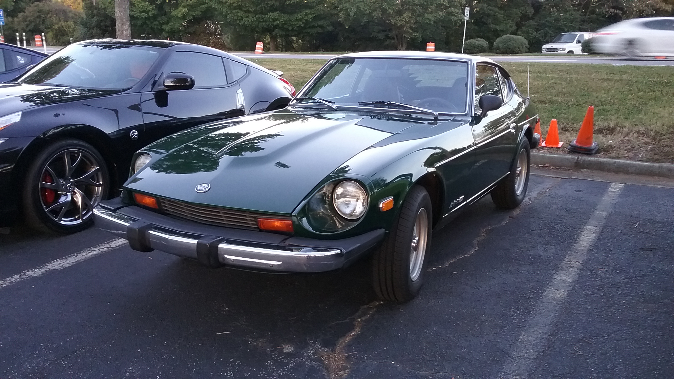

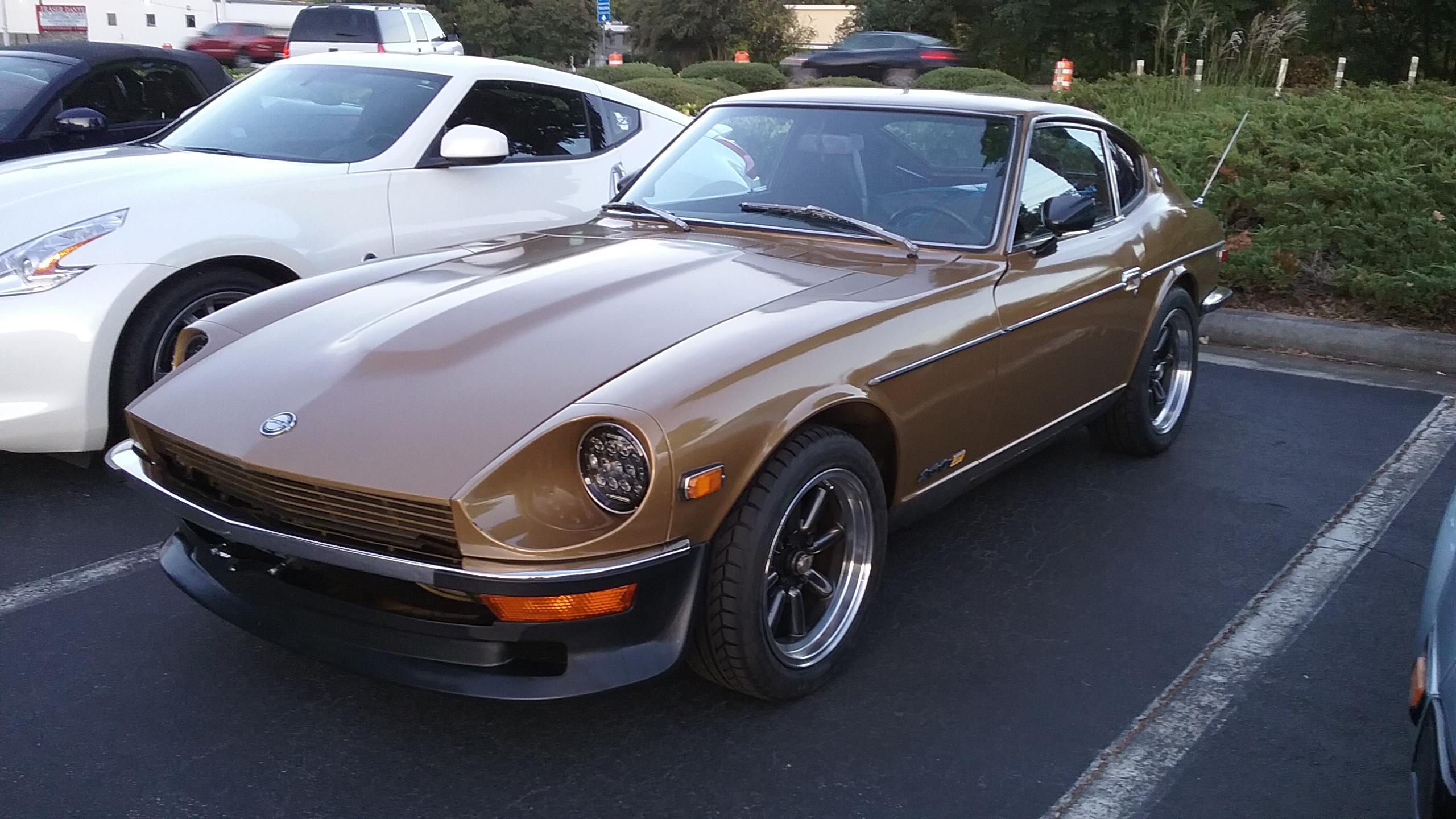

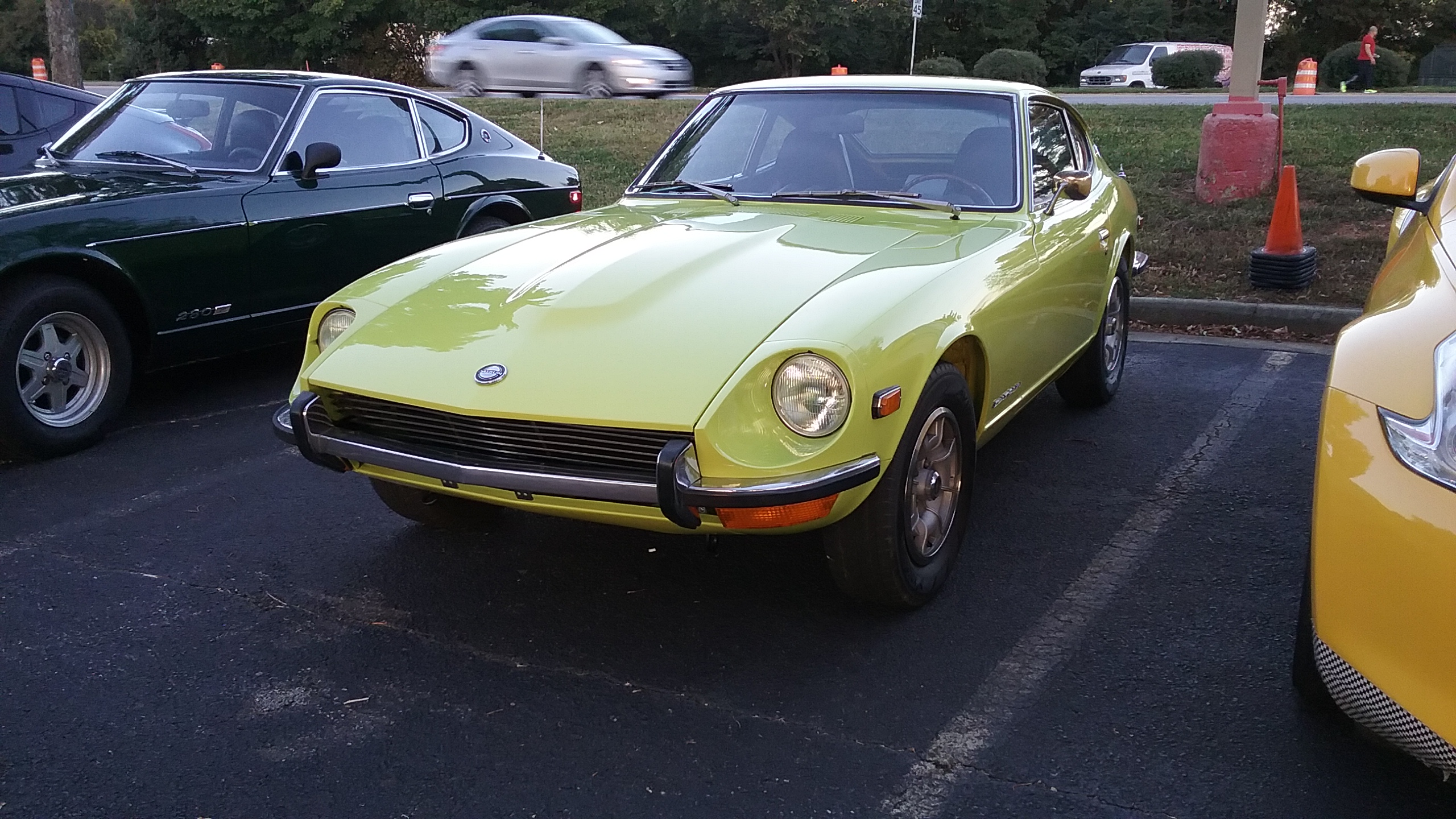

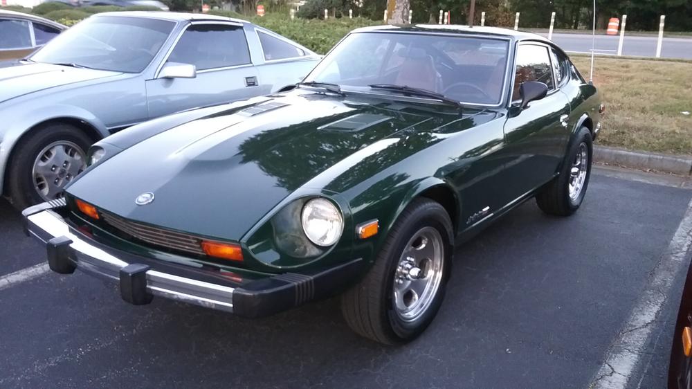

I drove the Z to work today in order to go to the Georgia Z Club meeting afterward. It was a great day to drive the car, too.
Here are the S30s that showed up.

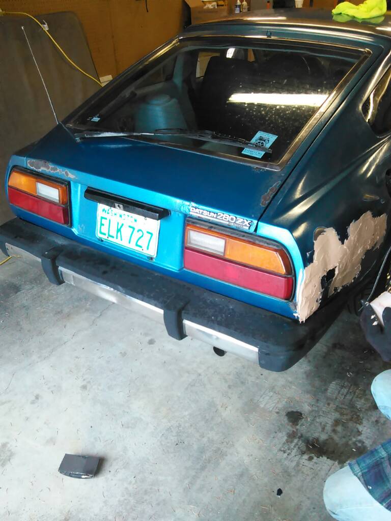

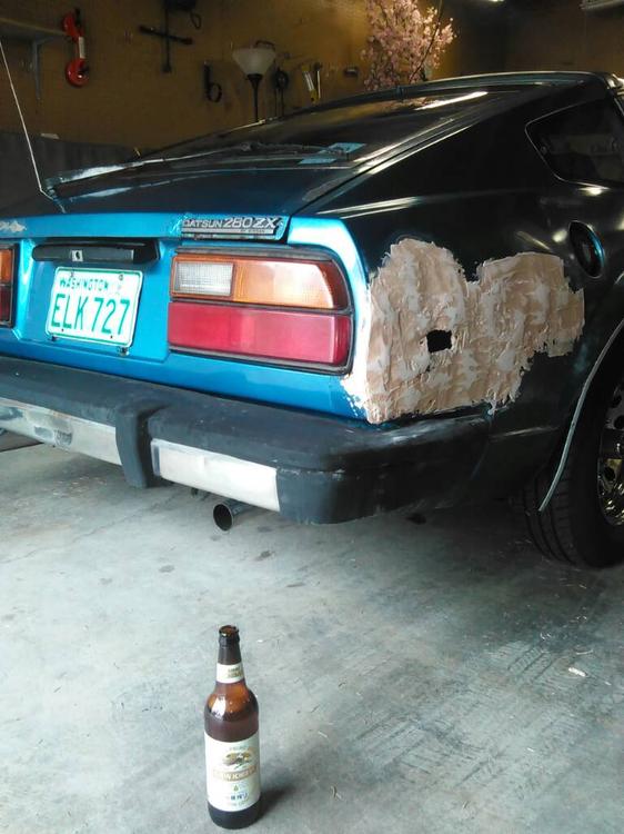

When I bought my car last year, the previous owner somehow managed to dent the rear passenger side by the side indicator light. Been bothering me all this time. So I finally drilled holes and put the slide hammer on it. Now its Bondo time. Its at one build up stage. Next to find some Nissan 307 Pacific Blue Metallic. IMG_20171011_170655.jpg
You really need access to the panel from the interior too. Your repair will last better if your filler is thinner. Hammer and dolly from the inside and outside to get it close. If the metal is stretched, heat it and cool it with a wet rag to shrink it...Close is 1/16th of an inch or less 1/8" absolute max...
Thanks..I lack the bodywork experience one would need to do this job, but I just dove in with a couple of Kirin Ichiban beers and am learning as I go. I appreciate the advice.
