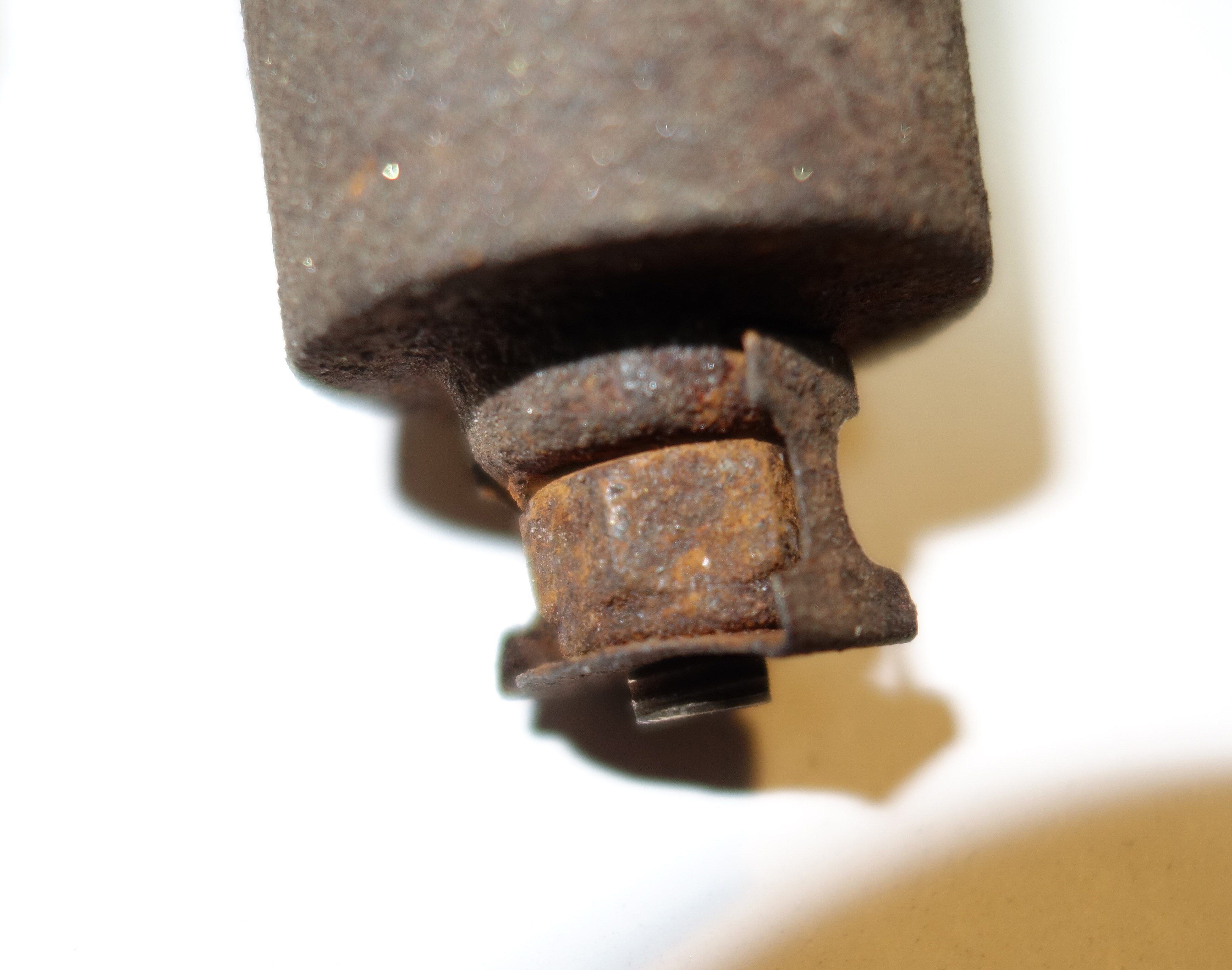

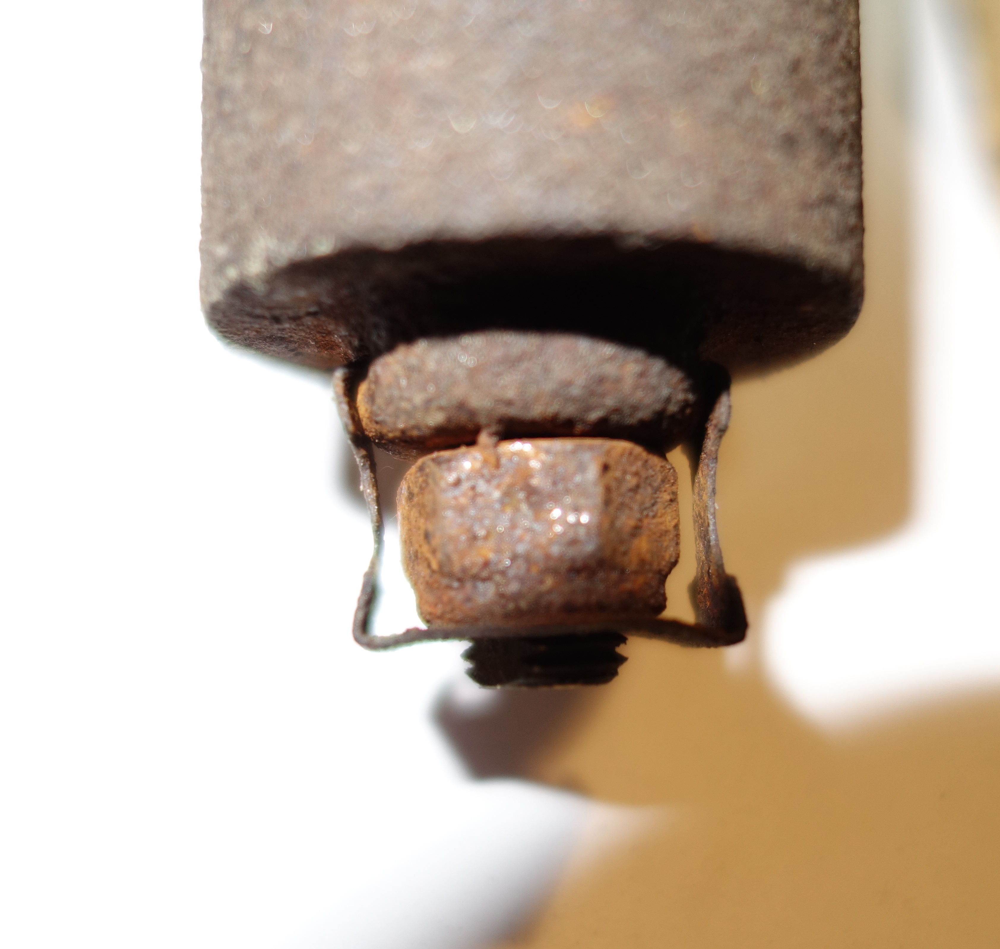

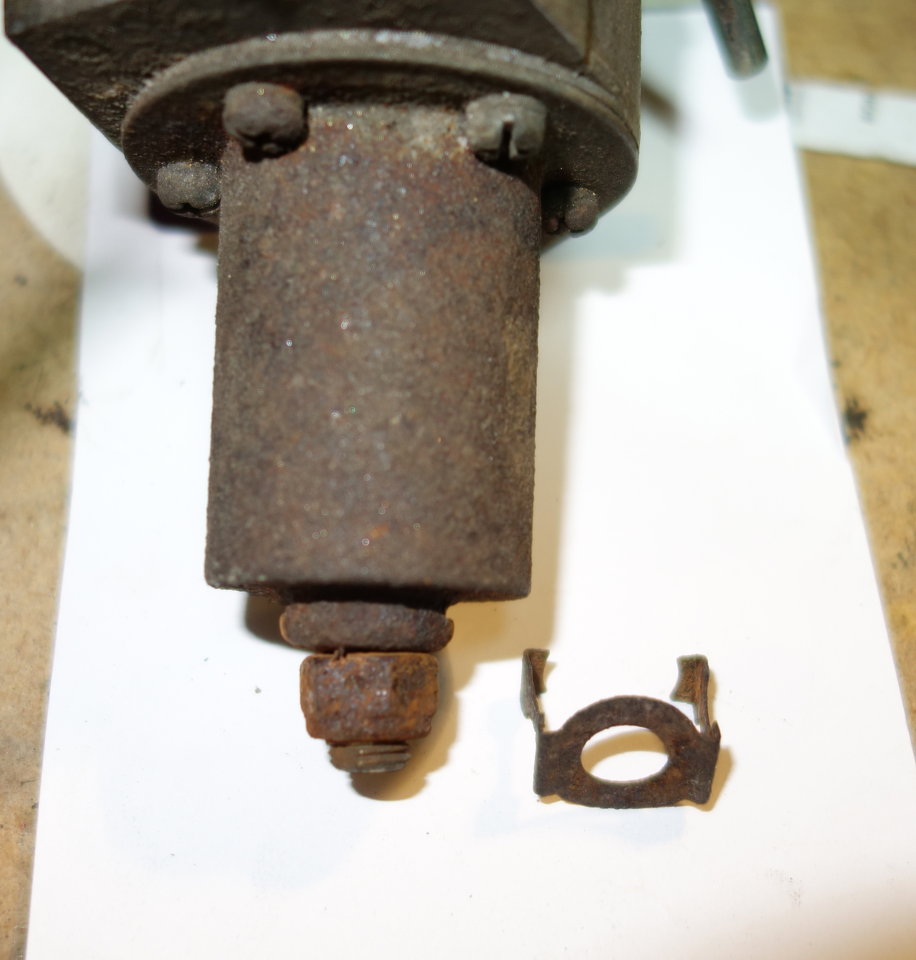

I think that there was likely funny business, Captain.  Then again, the manual states that there is supposed to be a retaining spring of some sort on the bolt which is missing.  Maybe engine vibration slowly backed out the nut (correct adjustment was tightening the nut)?  If it goes back out of adjustment I guess I'll know that's the case.
I don't know if it's stock or a PO mod, but I've got a Nyloc style lock nut on mine. Small open end wrench on the flats of the adjuster screw, back off the lock nut a little, turn the adjuster with the open end wrench, and then retighten the lock nut.
This is what is on my spare. I think it's original.
There you go!  That's what mine has.  Thanks Greg.
I've maxed out my LIKEs for today, I'll have to wait until tomorrow to like you.  That's what I used to say in high school, laying with the unpopular but good looking punk rocker girls. LOL
Edited by siteunseen
Cool. So mine is stock, but my tamper resistant clip has walked off somewhere over the years.
Note that in 78, they changed all that (except for California). In 78 they cheapened up the BCDD and removed the altitude compensating portion off the bottom for everyone except CA. Presumably, either they argued that only CA had enough "in-state" altitude changes to warrant the compensator, or they just decided that it would be more costly to go through all the CA qualifications and certs so they just left that state alone.
Anyway, the whole thing got shorter, and the adjustment screw looks different. I have a non-CA version here if someone wants to see that.
