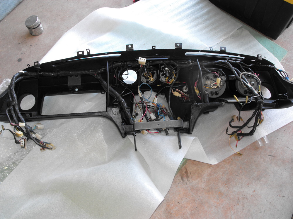

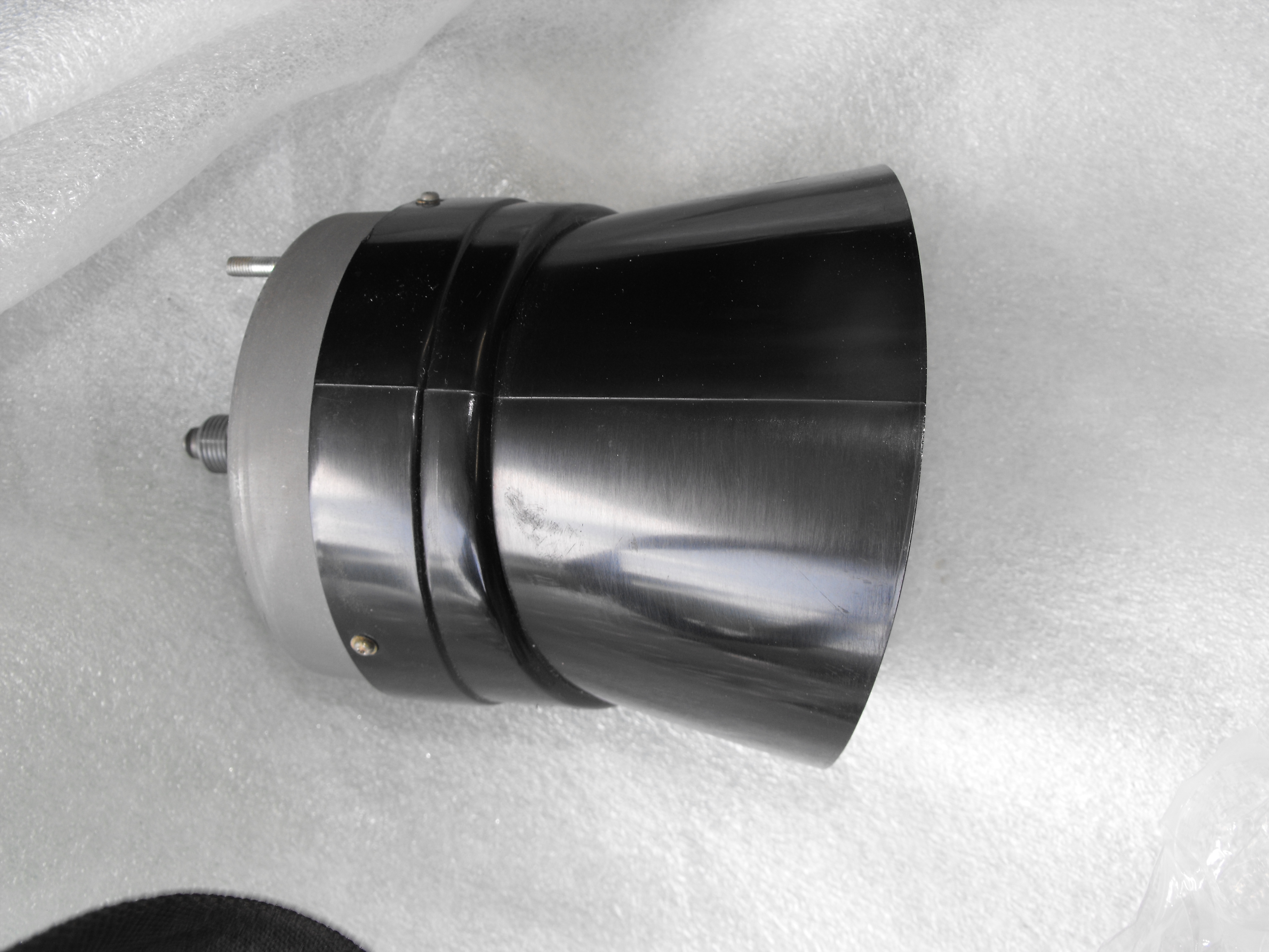

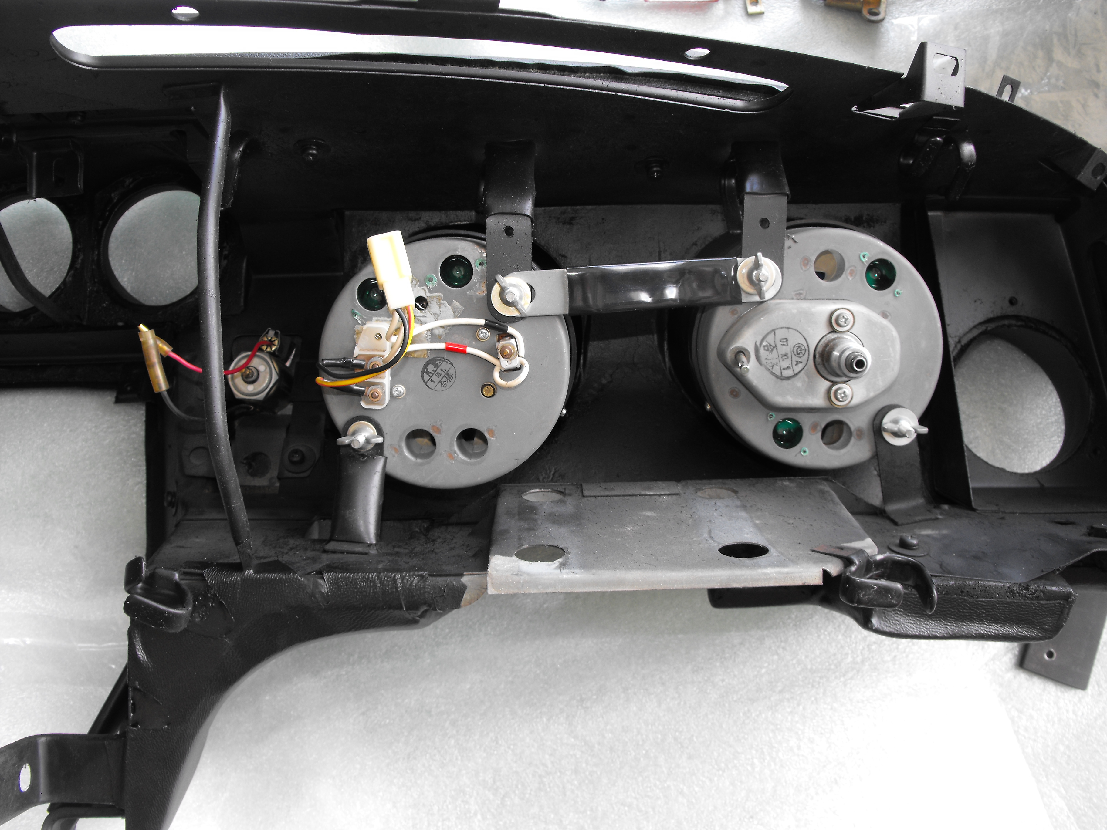

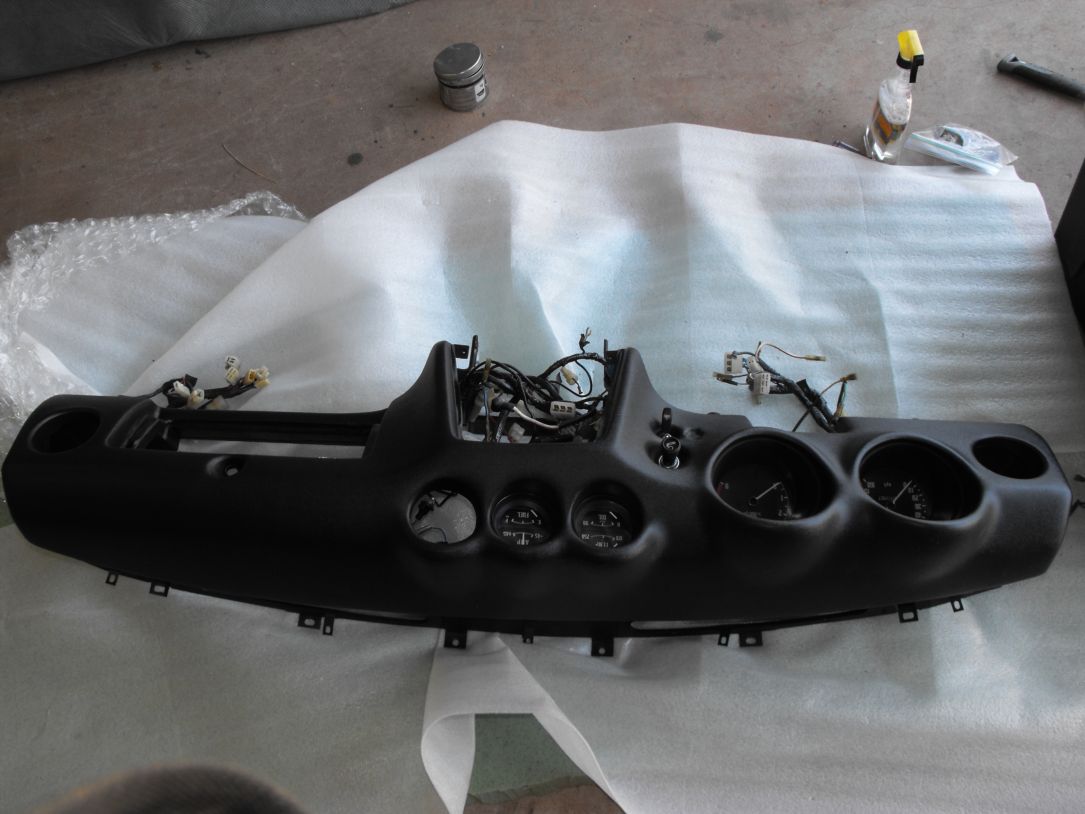

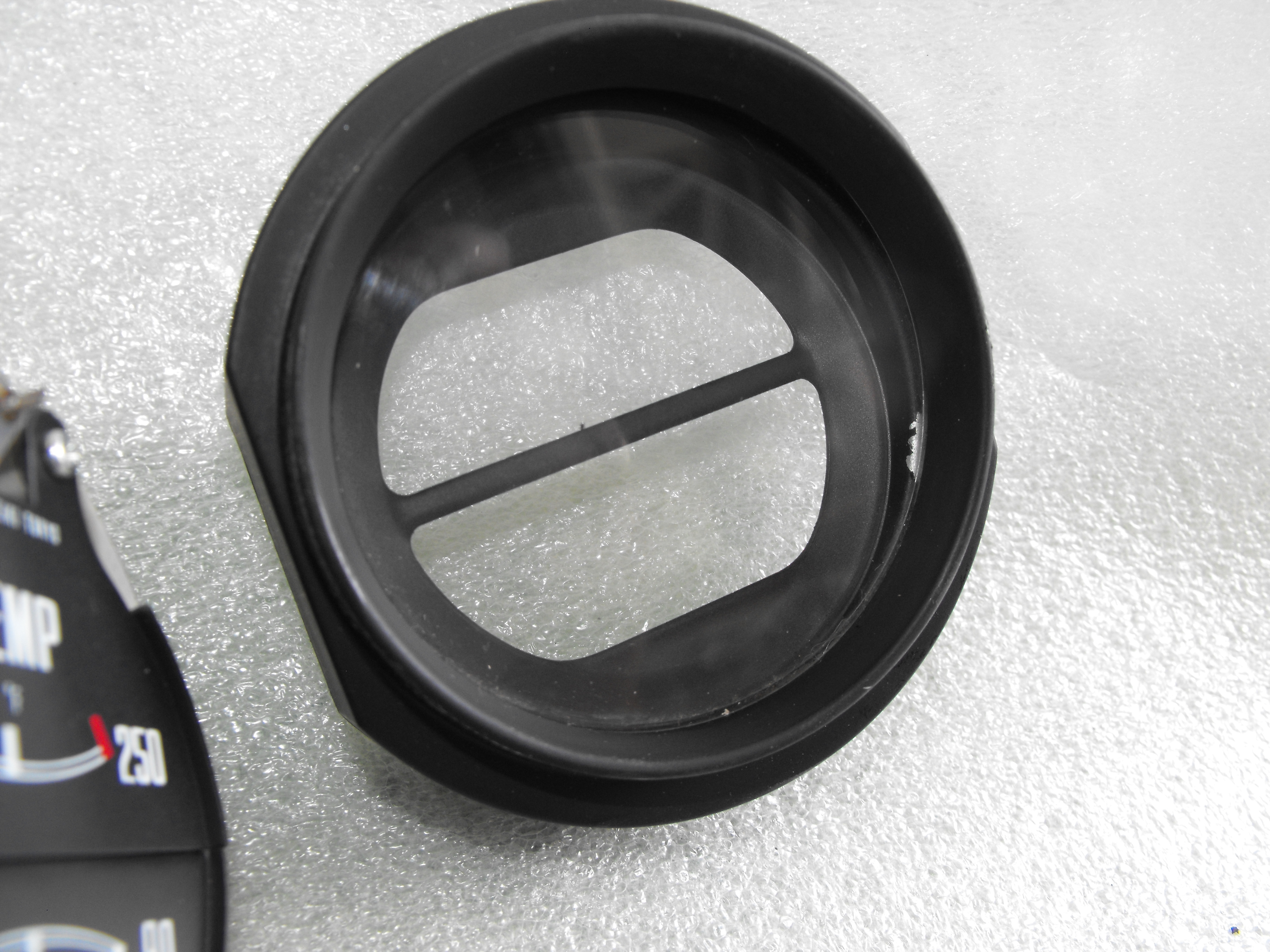

July 17, 20177 yr Author comment_525891 Started putting the dash back back together. Did a a little clean-up on the gauges before installation. Also touched up a some of the chipped and scraped areas on the instruments. Trying to decide what to do about the non-working clock. I think I will send the clock out to this guy and get the quartz mechanism so it will last for a while and be accurate. http://www.zclocks.com/ Although, I am really tempted to try this: https://hyllest.wordpress.com/2014/09/28/quartz-clock-movement-into-a-240z-clock/ That might be worth my time. I have a couple other Z's with clocks that don't work, so could be handy. I installed most of the dash harness and will install the ducts soon. Oh, 'Just Dashes' covered up three of the holes that that should have been open: The dash light dimmer hole, the emergency flasher switch and the odometer reset. So, I drilled those open and installed those item. It was a bit scary drilling into a $1750 dash, but was actually fairly simple as it was just the vinyl I had to go through. I also need to look into the panel lights. I am thinking that there is a better option than the original bulbs but not sure. I will have to look into this more. Anyway, here are the pics so far Edited July 17, 20177 yr by motorman7 Link to comment https://www.classiczcars.com/forums/topic/56833-deja-vu-1971-restoration/?&page=16#findComment-525891 Share on other sites More sharing options...

July 17, 20177 yr Author comment_525950 These look interesting: https://www.superbrightleds.com/vehicle/1972-nissan-240z-instrument-panel-light-bulb?make=55&model=61&scc_id=1364&year=1972 Says they work with the standard dimmer. Also, long lasting. This looks like a good option and could be cheaper than the Motorsport 4 Watt incandescents. PS: the photobucket images are not coming through. Edited July 17, 20177 yr by motorman7 Link to comment https://www.classiczcars.com/forums/topic/56833-deja-vu-1971-restoration/?&page=16#findComment-525950 Share on other sites More sharing options...
July 17, 20177 yr comment_525955 You cannot beat the prices and how long they will last. I am going to go on that site and order. Which one do you think is best? Link to comment https://www.classiczcars.com/forums/topic/56833-deja-vu-1971-restoration/?&page=16#findComment-525955 Share on other sites More sharing options...
July 17, 20177 yr comment_525957 Very nice work on the dash. If you want to stick with incandescent bulbs for the instruments, consider the Eiko A-72. It is a 4W bulb that is a perfect fit. My experience with the MSA offering several years ago was that they were not a good fit unless you were willing to give up the lens over each bulb. I really like the additional brightness from the Eiko's. Link to comment https://www.classiczcars.com/forums/topic/56833-deja-vu-1971-restoration/?&page=16#findComment-525957 Share on other sites More sharing options...
July 17, 20177 yr Author comment_525963 I am leaning towards this one. It is 25 lumens, in cool white with 90 degree beam angle. https://www.superbrightleds.com/moreinfo/instrument-panel-light-bulb/ba9s-led-bulb-4-led-ba9s-retrofit-car-classic-car-bulbs/6/ The Eiko also seems like a good option for incandescent with the 4 Watts. I am leaning toward the brighter LED with the longer life. Pricewise, it is just a bit more, but I like the fact that the LED would be longer lasting and maybe a bit brighter. Link to comment https://www.classiczcars.com/forums/topic/56833-deja-vu-1971-restoration/?&page=16#findComment-525963 Share on other sites More sharing options...
