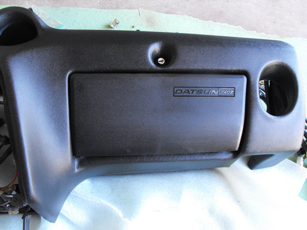

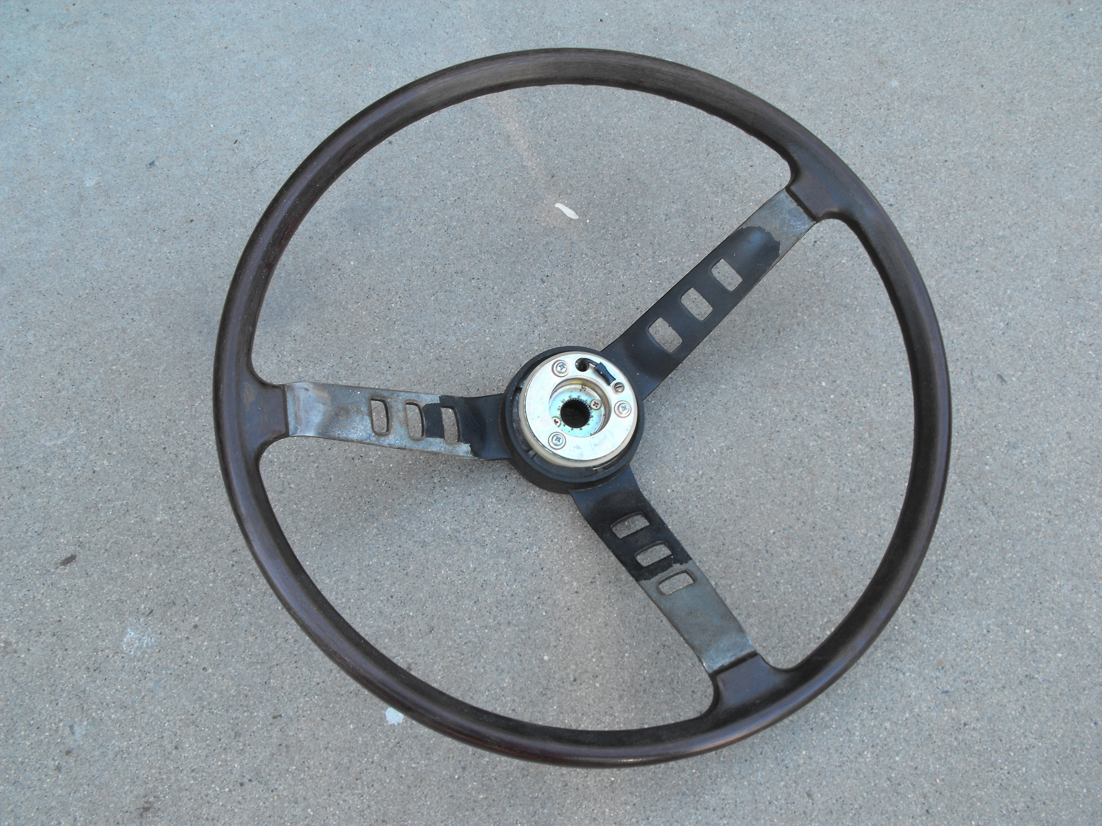

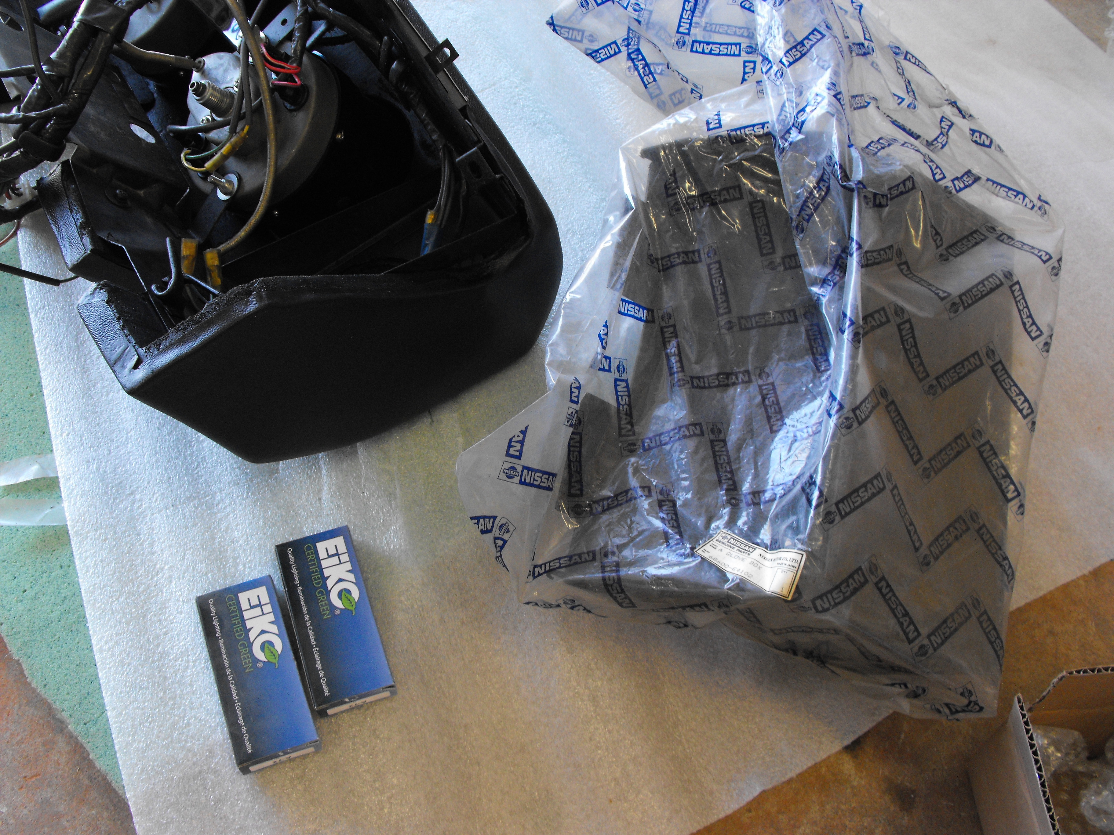

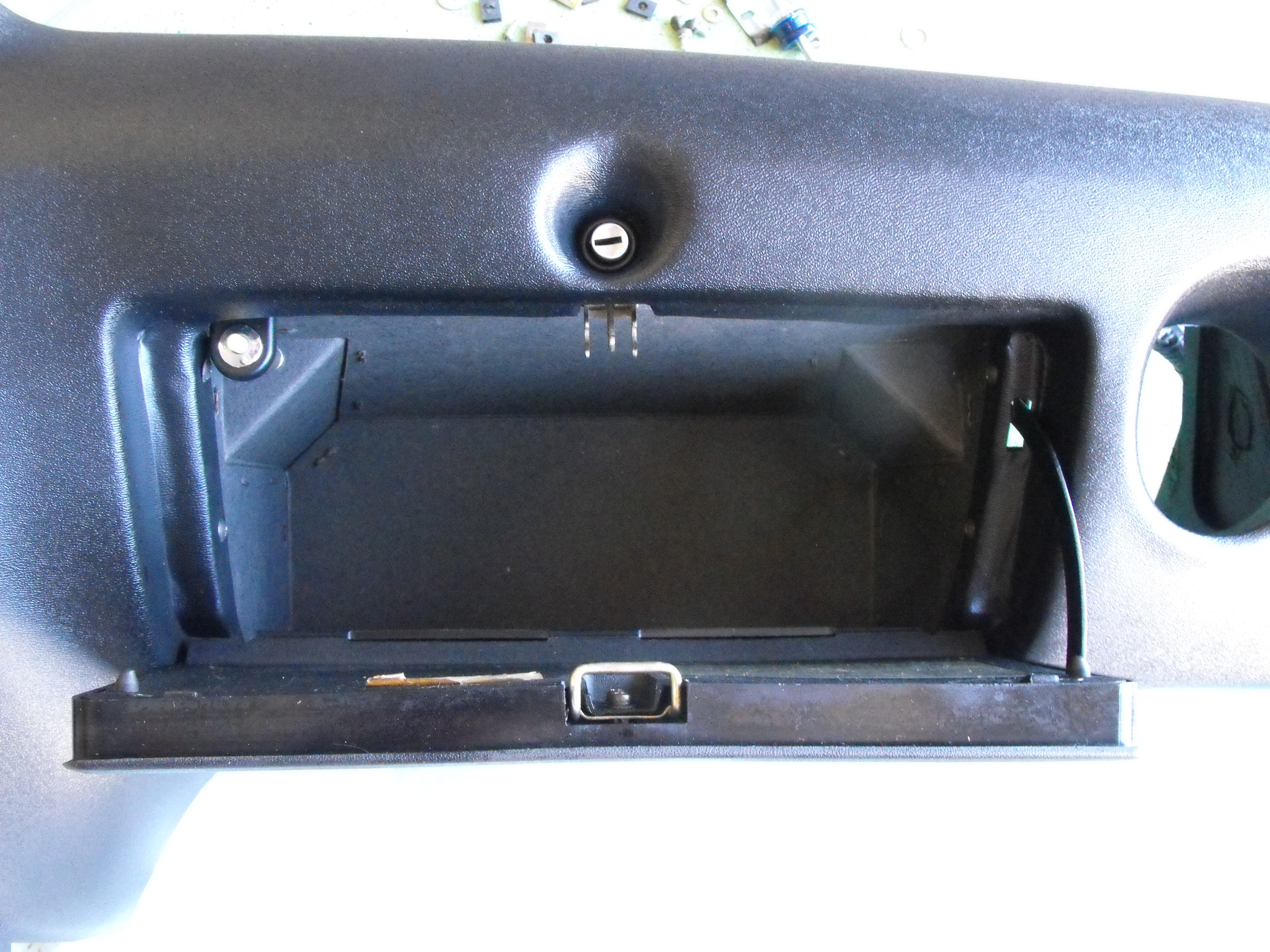

July 24, 20177 yr Author comment_526450 Got the Eiko A-72 4 Watt bulbs. Also got an original Nissan Glove box from the car owner this weekend. I bet there are not too many NOS glove boxes out there. This is the first one I have seen so it was treated with much care. I installed the new bulbs and the glove box, pics are below. I need to fix the glove box emblem. Not sure what to do with the rolled edges on the glove box inside sticker. I may just leave it since it is original. More Z CSI. Looks like some type of work was done with the ammeter/fuel gauge unit. As I was rotating the dash around, one of those little plastic heat stake pieces was on the glass. When I opened it up to remove it, I saw the epoxy fix. Interesting. Started restoration on the steering wheel. The key to doing the steering wheel right is to be very gentle on the 'wood grain'. I sanded the metal with 220 grit today and cleaned the wood 'gunk' with lacquer thinner. The 'gunk' is the black build up on the wheel. I will do a very light sand on the wood portion, then spray with clear enamel. Will spray the metal with satin black. Should have this done in the next couple days. The big news is that the car should be back from the paint shop this weekend. Woo-hoo! Should be picking that up on Saturday. Edited July 24, 20177 yr by motorman7 Link to comment https://www.classiczcars.com/forums/topic/56833-deja-vu-1971-restoration/?&page=17#findComment-526450 Share on other sites More sharing options...

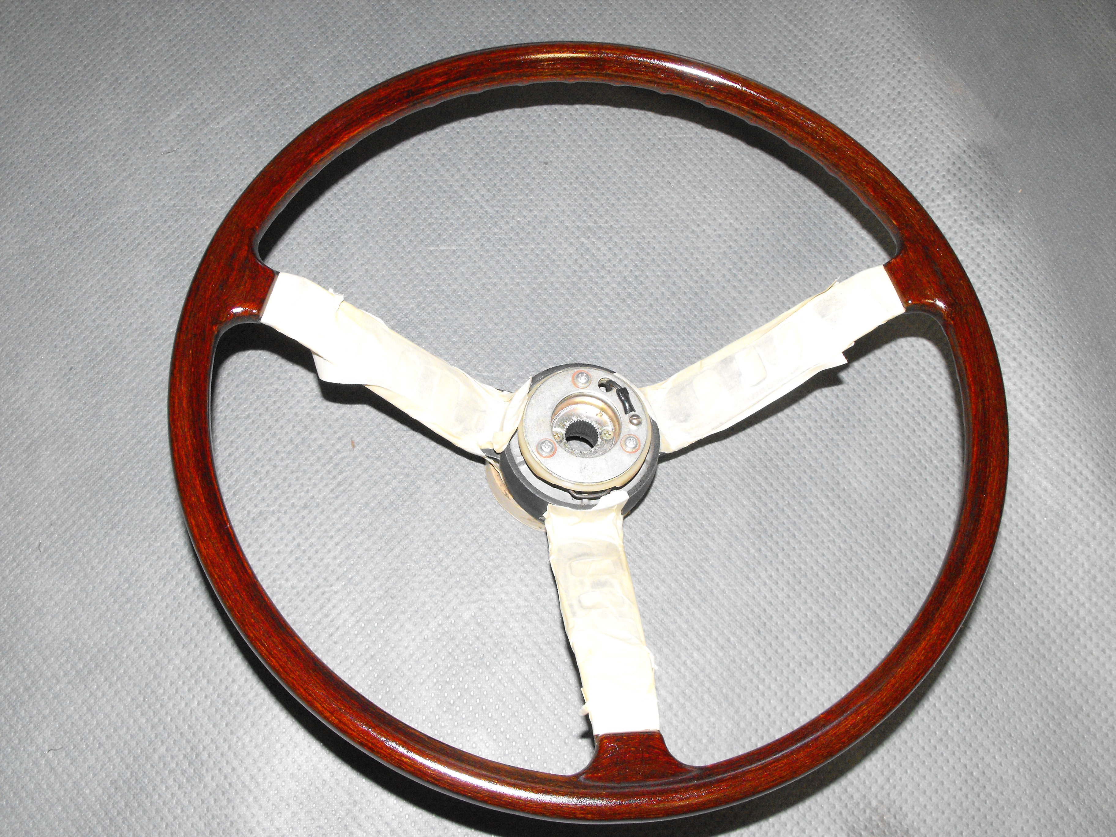

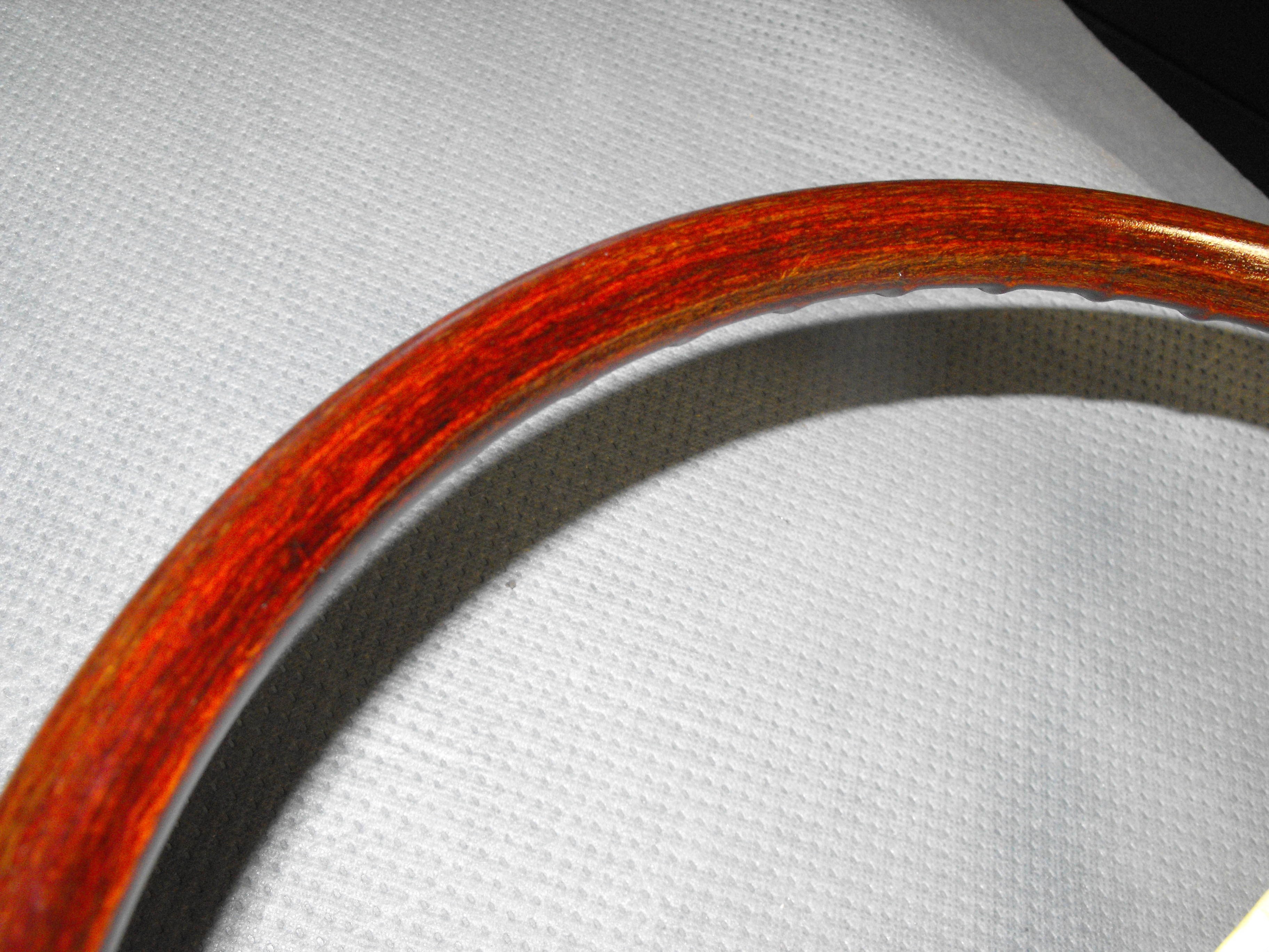

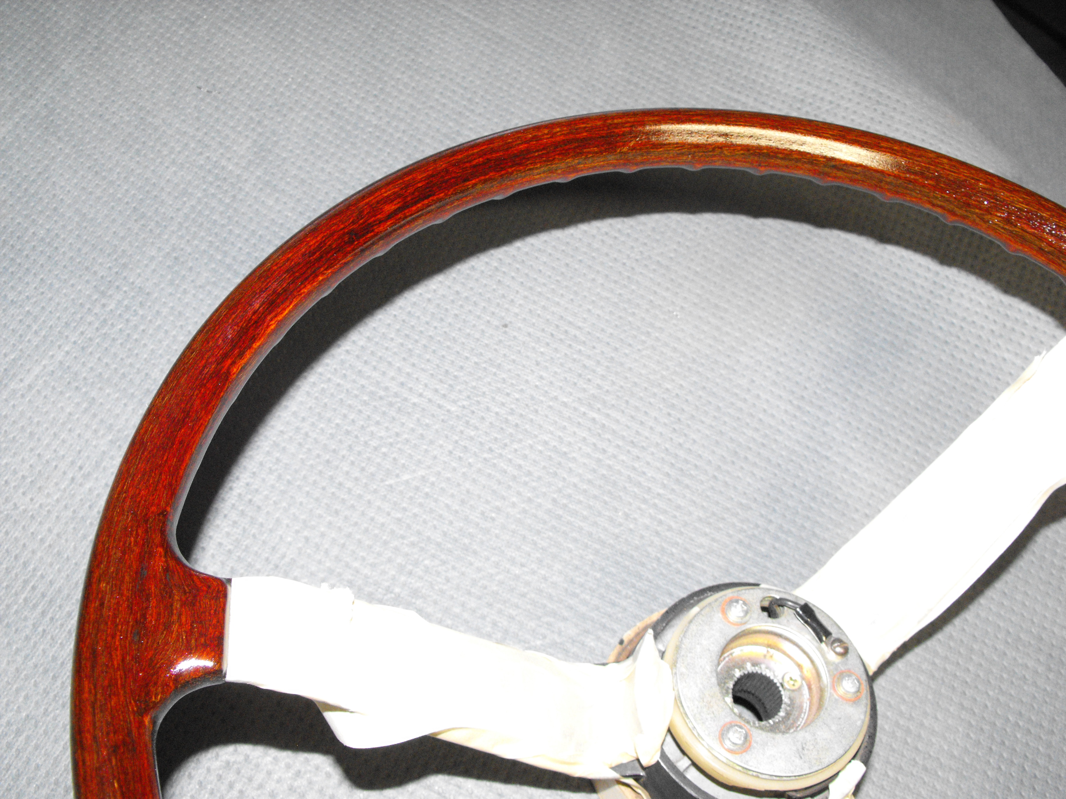

July 26, 20177 yr Author comment_526625 Continued work on the steering wheel. After cleaning the wood grain with lacquer thinner, I gently sanded the wood grain with 220 grit sand paper. I then taped up the spokes and sprayed the wood with clear enamel. The wood came out nice as seen in the pics. That's was the hard part. I will let the clear dry for a day or two and then tape off the wood and spray the spokes with satin black. Pics below with one before pic. Edited July 26, 20177 yr by motorman7 Link to comment https://www.classiczcars.com/forums/topic/56833-deja-vu-1971-restoration/?&page=17#findComment-526625 Share on other sites More sharing options...

July 26, 20177 yr Author comment_526696 1 hour ago, psdenno said: Very nice. You brought out the original wood grain look quite nicely. Thanks, I have learned that the key is to keep the sanding to a minimum. That way there is no need to re-stain. I learned that the hard way. I think they put a thin wood veneer over the a beige plastic steering wheel form. I way over-sanded on a previous steering wheel. Still have that sitting in my garage as a reminder. 1 hour ago, siteunseen said: Now the shift knob. I couldn't get mine exact, the knob is real wood and comes through more yellowish than the cherry or red mahogany of the wheel. I put my knob on an old shift rod and dipped it in Minwax Helmsman satin poly every day for a week. Nice hard finish that covers the plastic shift pattern button as well. It even hid the cracks in the plastic after a few coats. Thanks for the tip on this. The shift knob is worn and the plastic has a small crack. I was thinking that I would most likely replace it, but I think I will attempt to restore using the method you mentioned here. Link to comment https://www.classiczcars.com/forums/topic/56833-deja-vu-1971-restoration/?&page=17#findComment-526696 Share on other sites More sharing options...
July 26, 20177 yr comment_526699 Your's looks fantastic ever how you did it. Personally I used 0000 steel wool. I waded a handful and "steered" the wheel until all the sticky stuff was gone and it was slick as glass. Then sprayed it with a touch up HVLP gun I have. No matter how you got there it looks great! I got all the wobble out of my steering after many Benjamin's and laying on my back work but now holding that skinny wheel while driving the back roads is almost hypnotic. Maybe I won't run off in a ditch! Link to comment https://www.classiczcars.com/forums/topic/56833-deja-vu-1971-restoration/?&page=17#findComment-526699 Share on other sites More sharing options...
July 26, 20177 yr comment_526700 Something else I thought about was the two part clear bar top epoxy for the shift knob but I read it could "possibly" attack the plastic shift pattern button. I didn't want to take that chance. Link to comment https://www.classiczcars.com/forums/topic/56833-deja-vu-1971-restoration/?&page=17#findComment-526700 Share on other sites More sharing options...
July 26, 20177 yr comment_526701 21 minutes ago, siteunseen said: I waded a handful and "steered" the wheel until all the sticky stuff was gone and it was slick as glass. It's pretty gross to think about it but that sticky stuff is basically years of dead skin and oil Link to comment https://www.classiczcars.com/forums/topic/56833-deja-vu-1971-restoration/?&page=17#findComment-526701 Share on other sites More sharing options...
