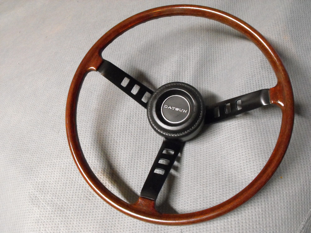

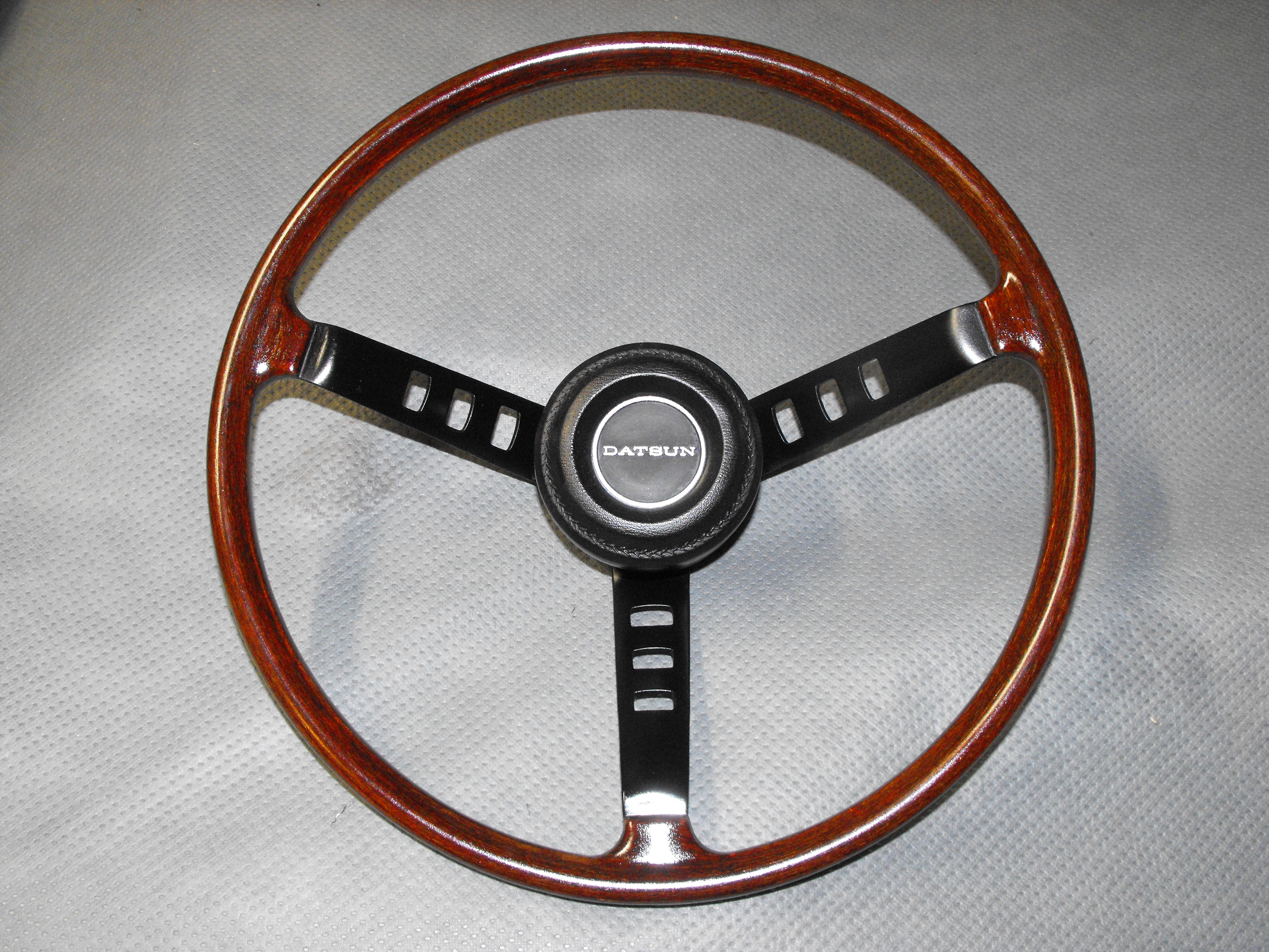

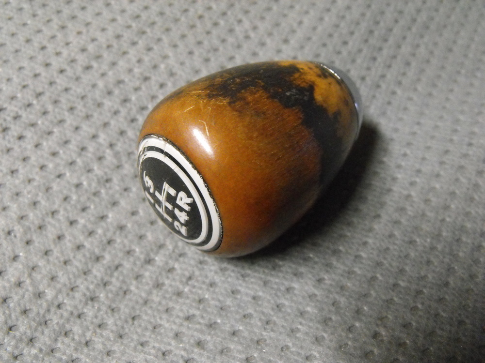

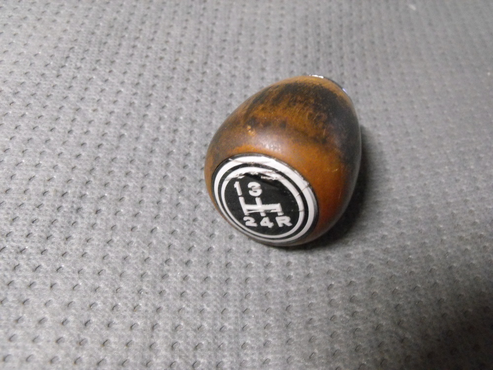

July 27, 20177 yr Author comment_526717 And here are the final pics on the steering wheel. Now for the shift knob. Hopefully I can make this work. Link to comment https://www.classiczcars.com/forums/topic/56833-deja-vu-1971-restoration/?&page=18#findComment-526717 Share on other sites More sharing options...
July 27, 20177 yr comment_526733 I've sectioned an original shift knob into a couple pieces, and after seeing the inside (the part that has never seen the sun), I believe the knobs are made out of the same material and color as the steering wheels. On the inside, they are much more tinted toward red than they are on the outside. Homogeneous throughout, and red. When I get a chance, I'll snap a pic or two. Link to comment https://www.classiczcars.com/forums/topic/56833-deja-vu-1971-restoration/?&page=18#findComment-526733 Share on other sites More sharing options...

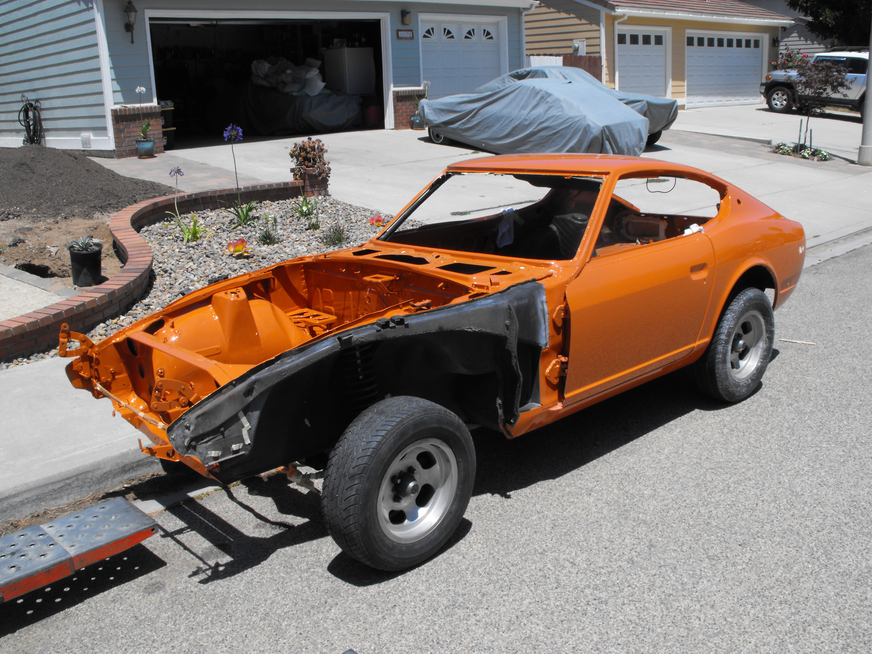

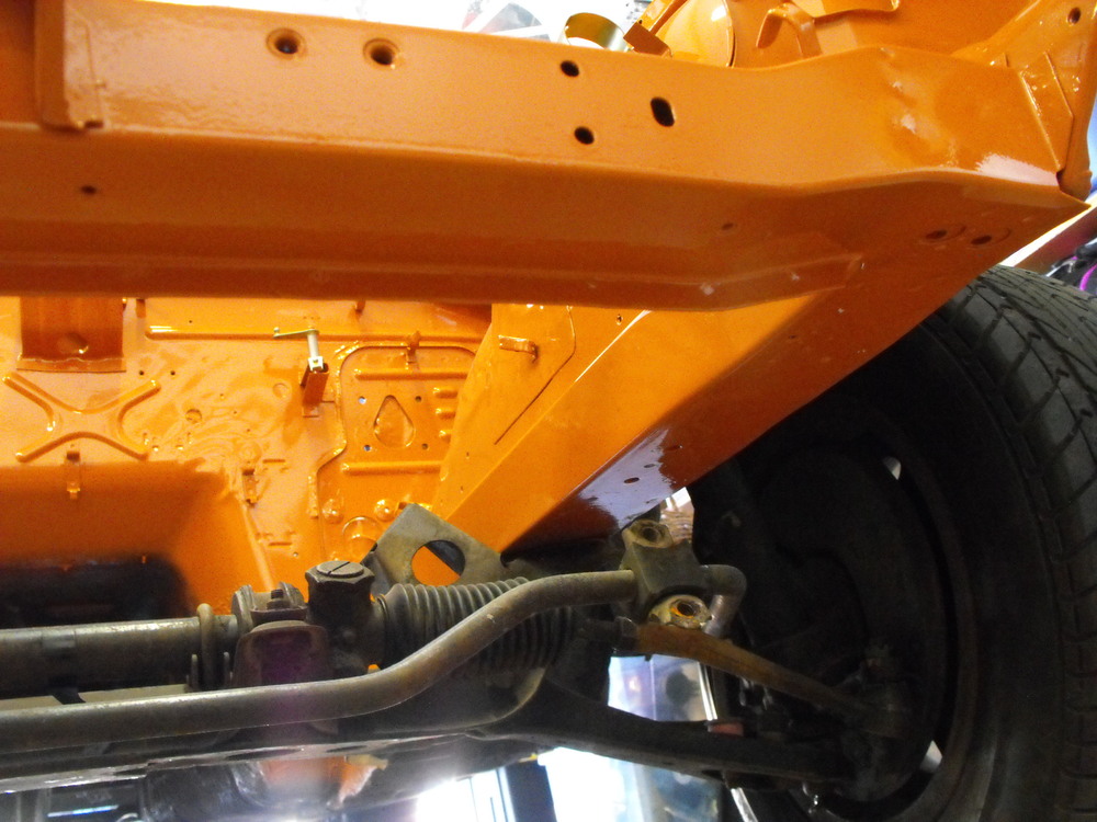

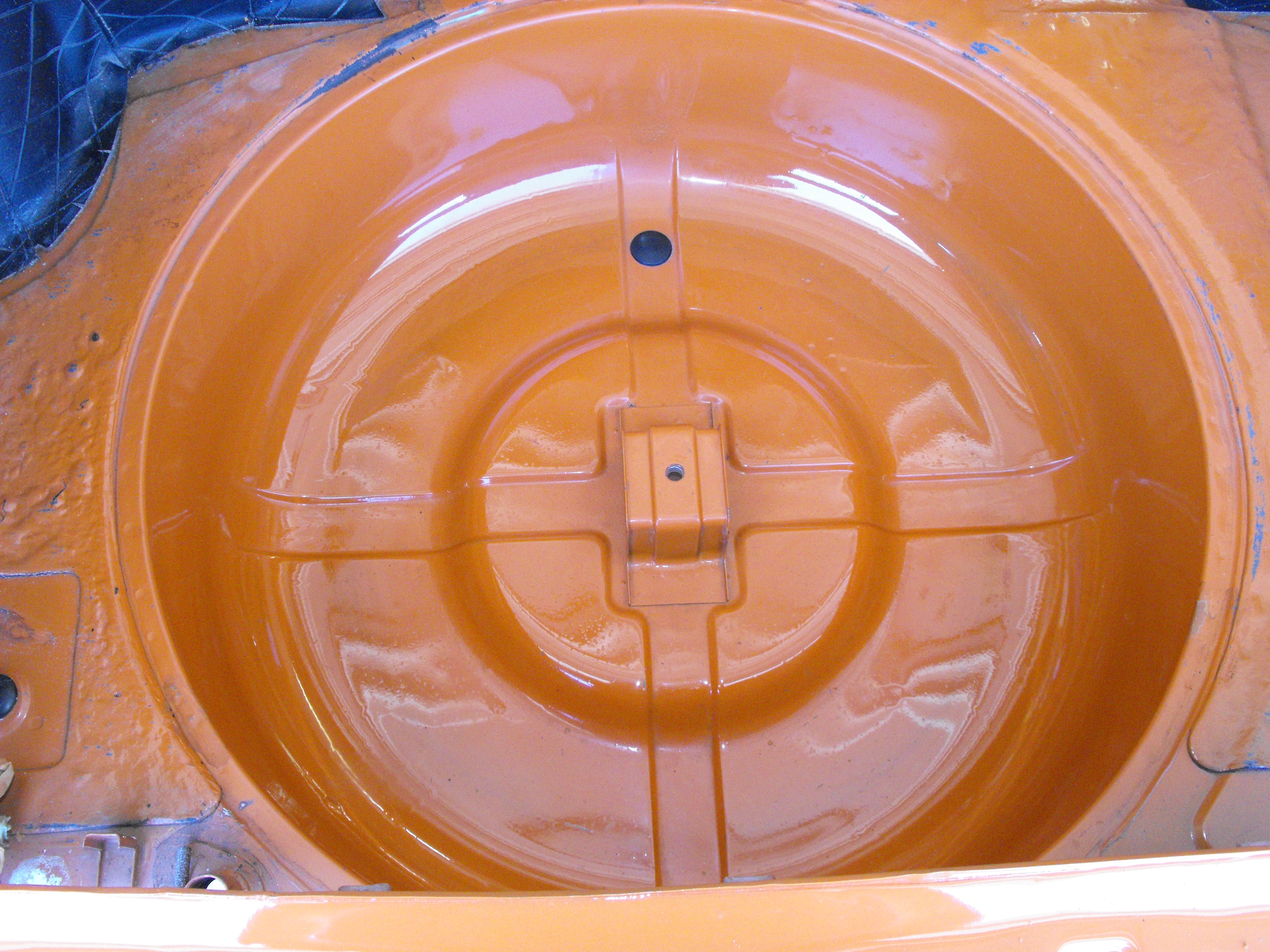

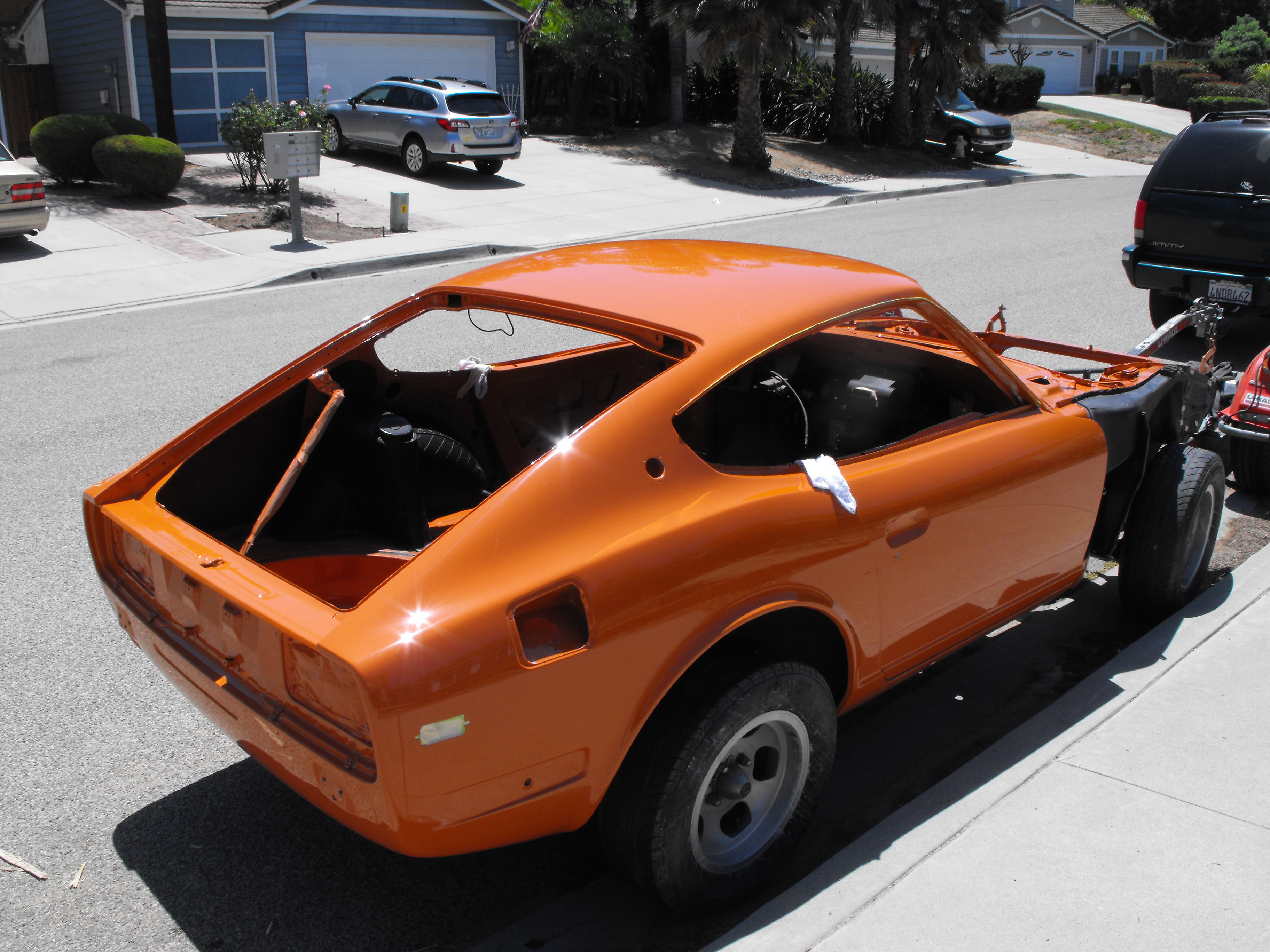

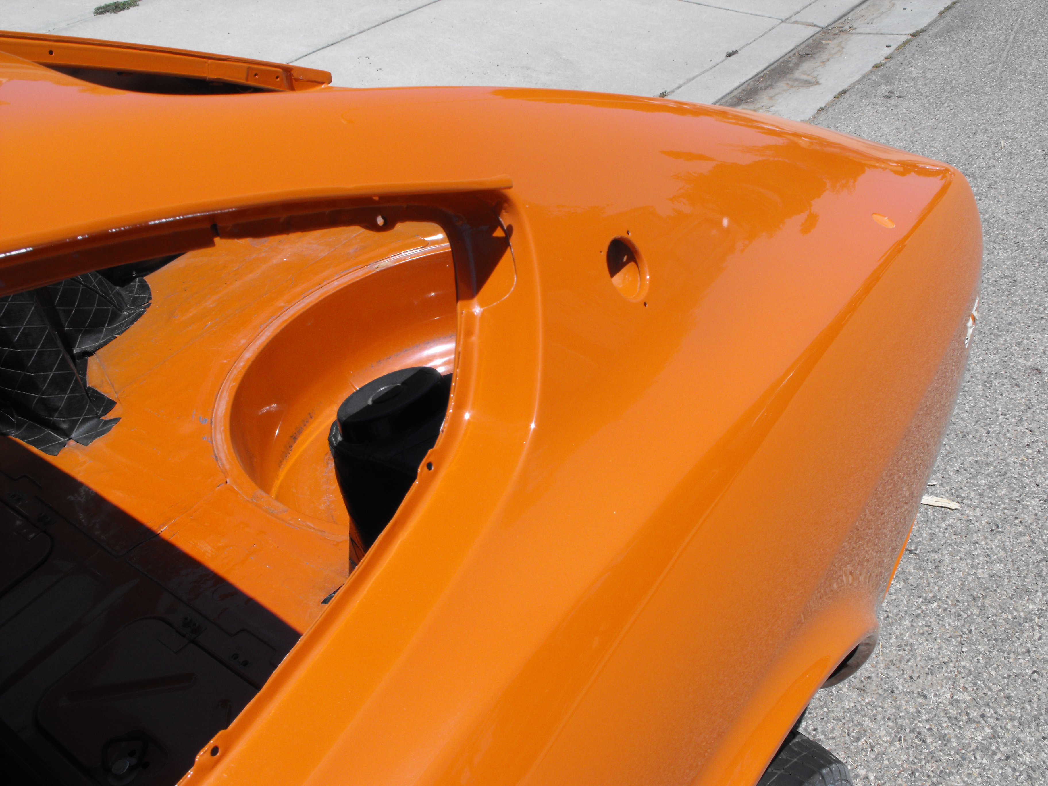

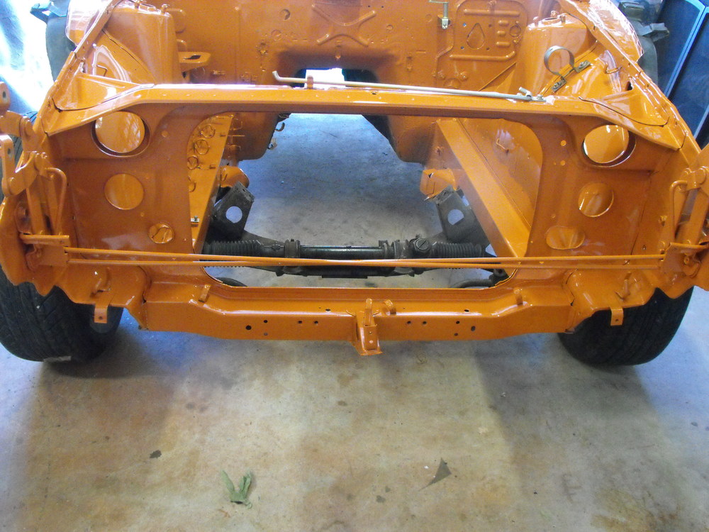

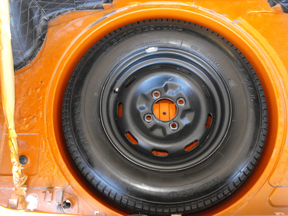

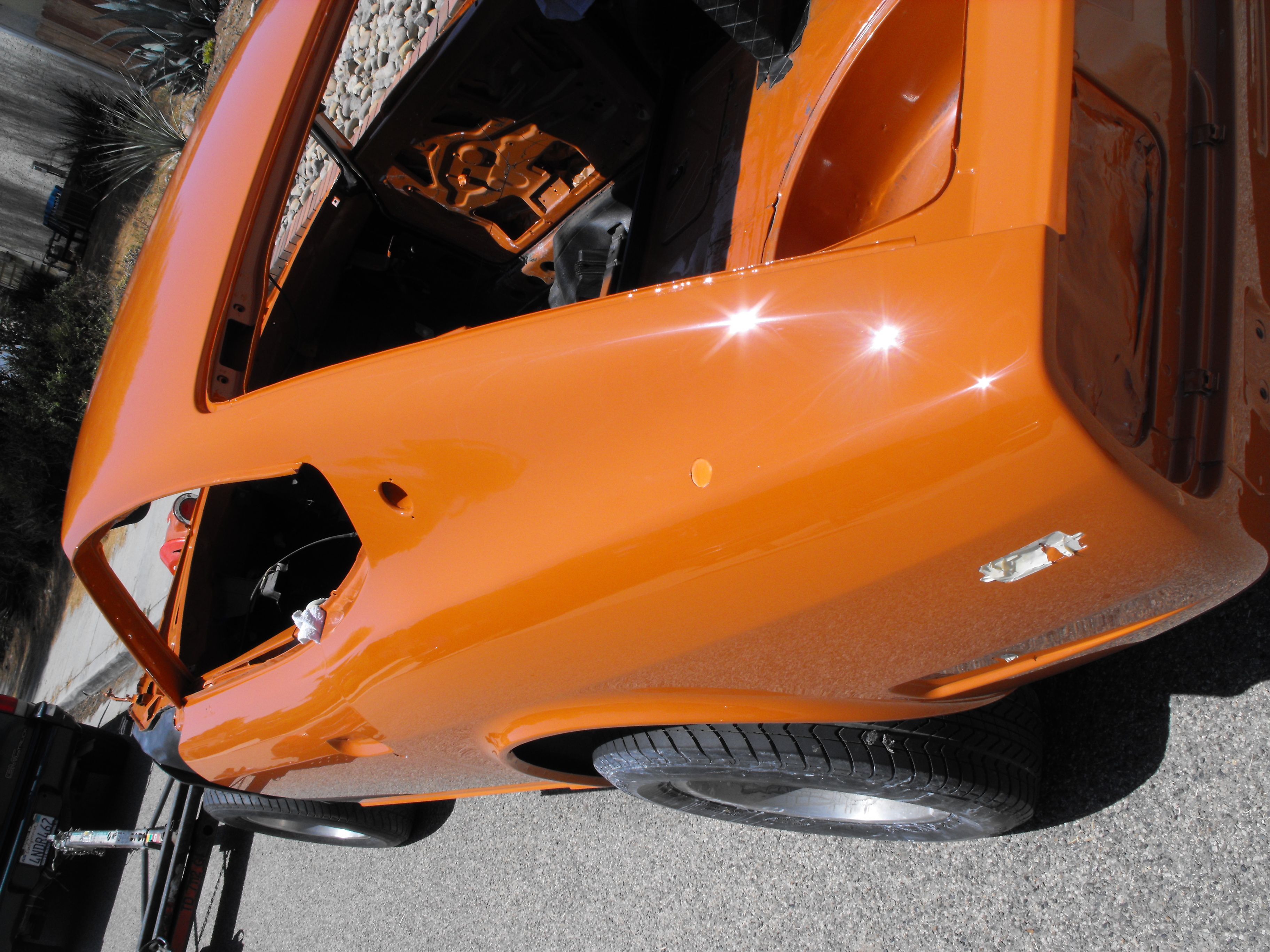

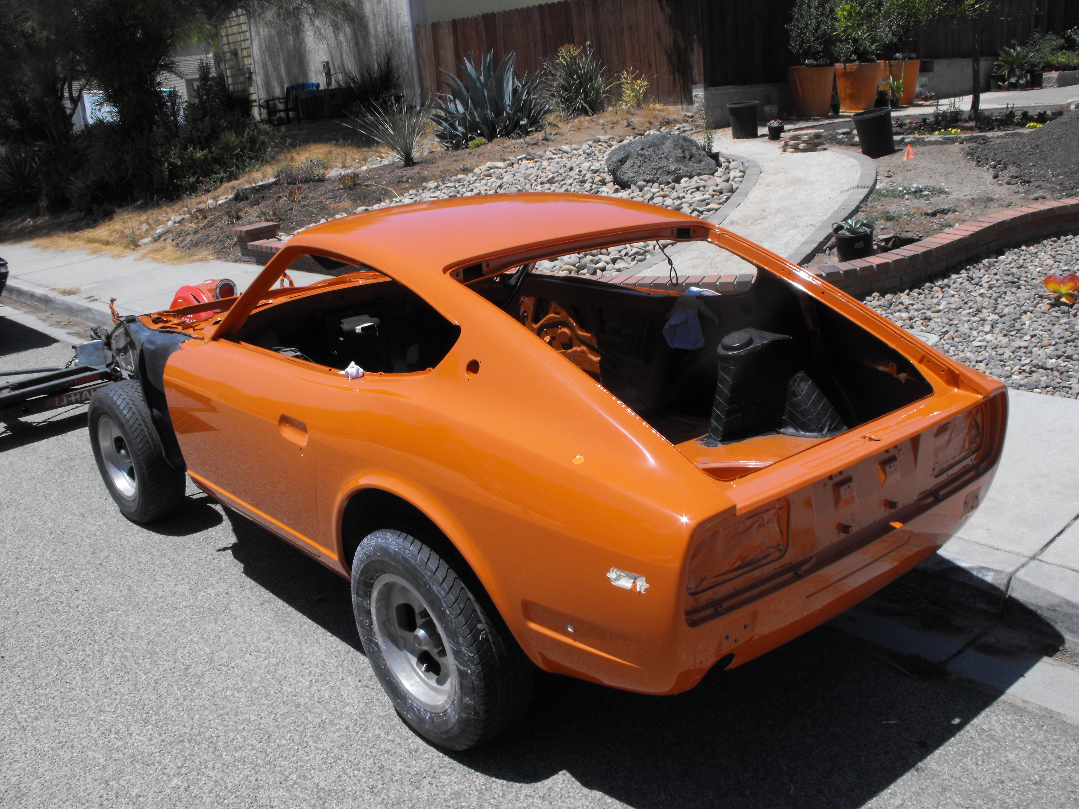

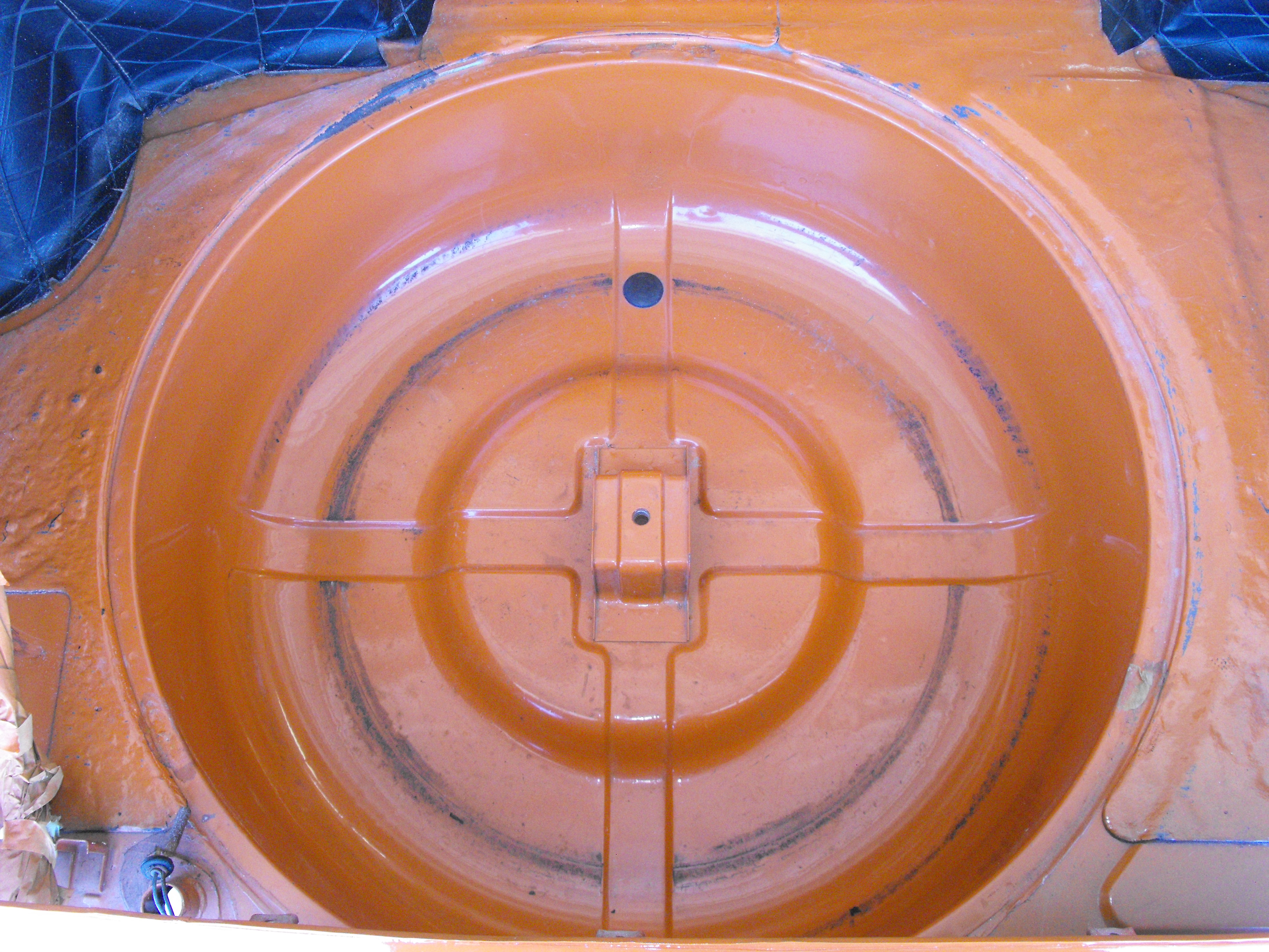

July 31, 20177 yr Author Popular Post comment_527058 I got the rolling chassis back from Miguel today and the paint is just AMAZING, way better than I was anticipating. The clear coat is like smooth glass. Factory paint NEVER looked this good. Anyway, nice to have it back in my garage. I removed the a lot of the protective paper which was like unwrapping presents on Christmas, very enjoyable. I did clean up the spare tire area and put that in. I am now removing the the front suspension. Will have most of the parts powder coated and fasteners zinc plated. I got a new Energy suspension kit to install once the parts are finished. Link to comment https://www.classiczcars.com/forums/topic/56833-deja-vu-1971-restoration/?&page=18#findComment-527058 Share on other sites More sharing options...
July 31, 20177 yr comment_527059 Verrry nice! Link to comment https://www.classiczcars.com/forums/topic/56833-deja-vu-1971-restoration/?&page=18#findComment-527059 Share on other sites More sharing options...
July 31, 20177 yr comment_527065 That's gorgeous! Sent from my SCH-I535 using Classic Zcar Club mobile Link to comment https://www.classiczcars.com/forums/topic/56833-deja-vu-1971-restoration/?&page=18#findComment-527065 Share on other sites More sharing options...

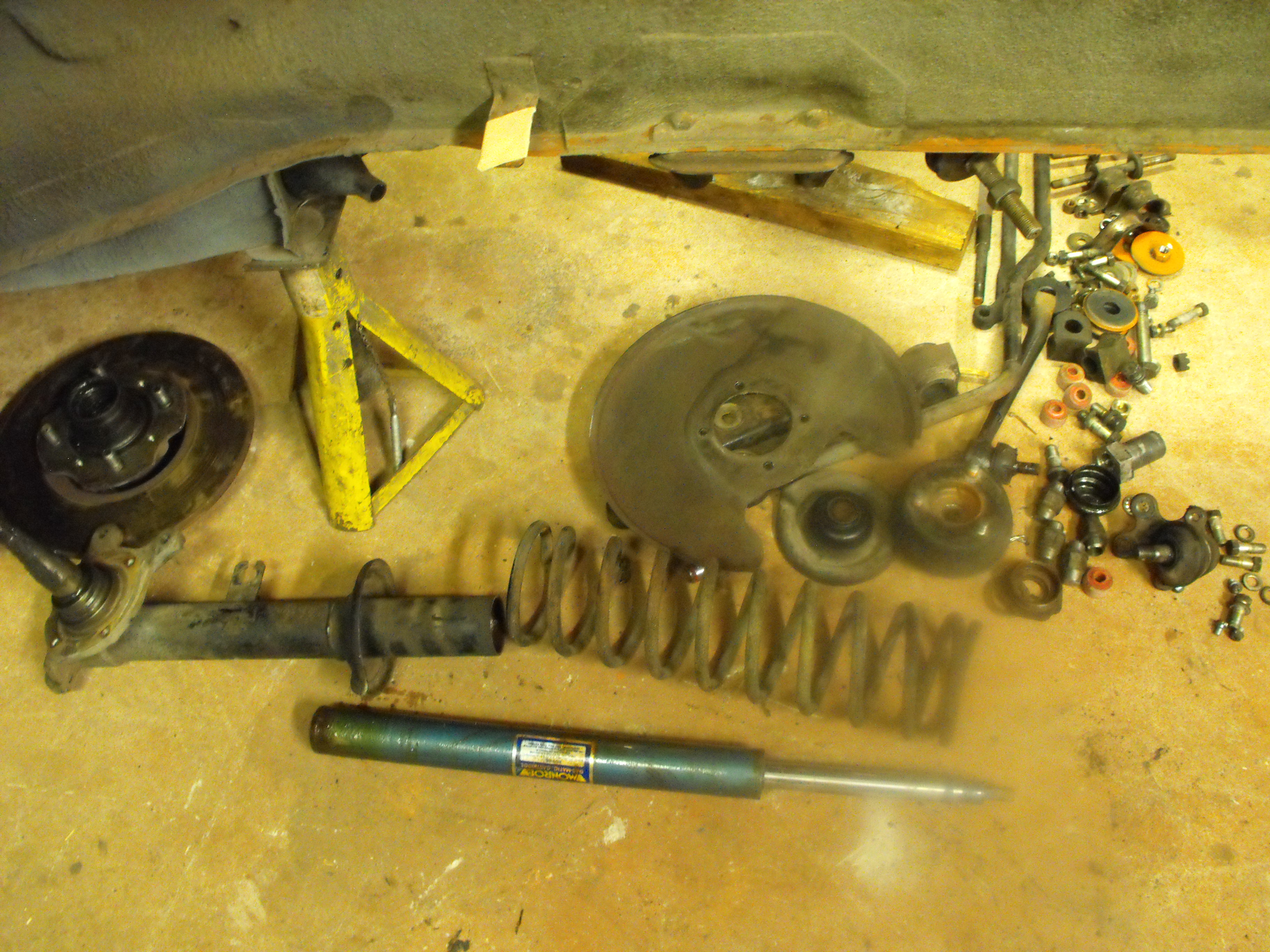

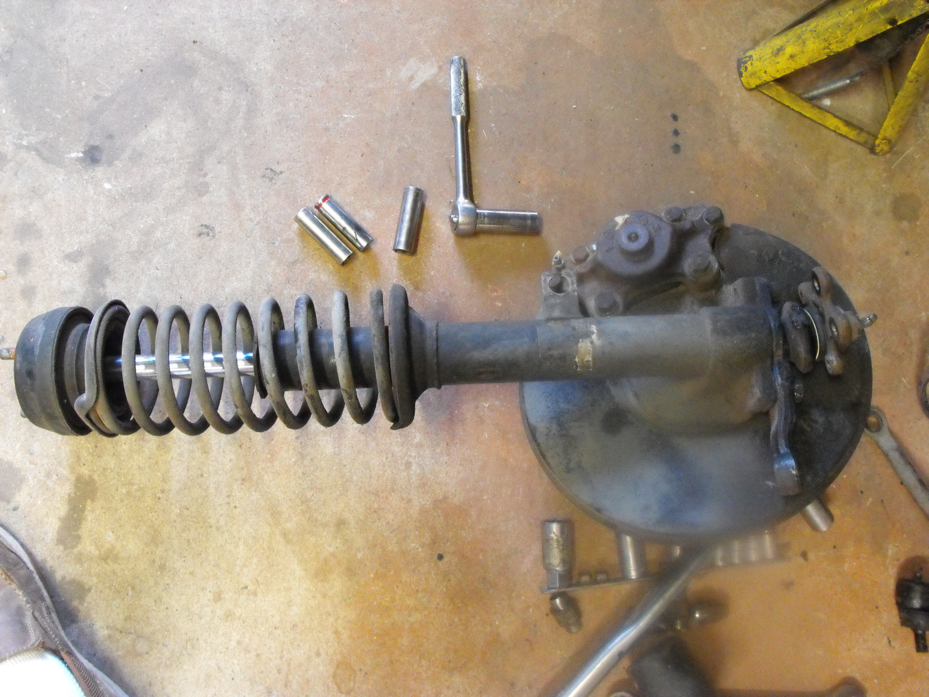

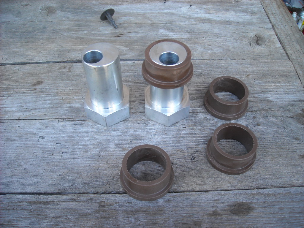

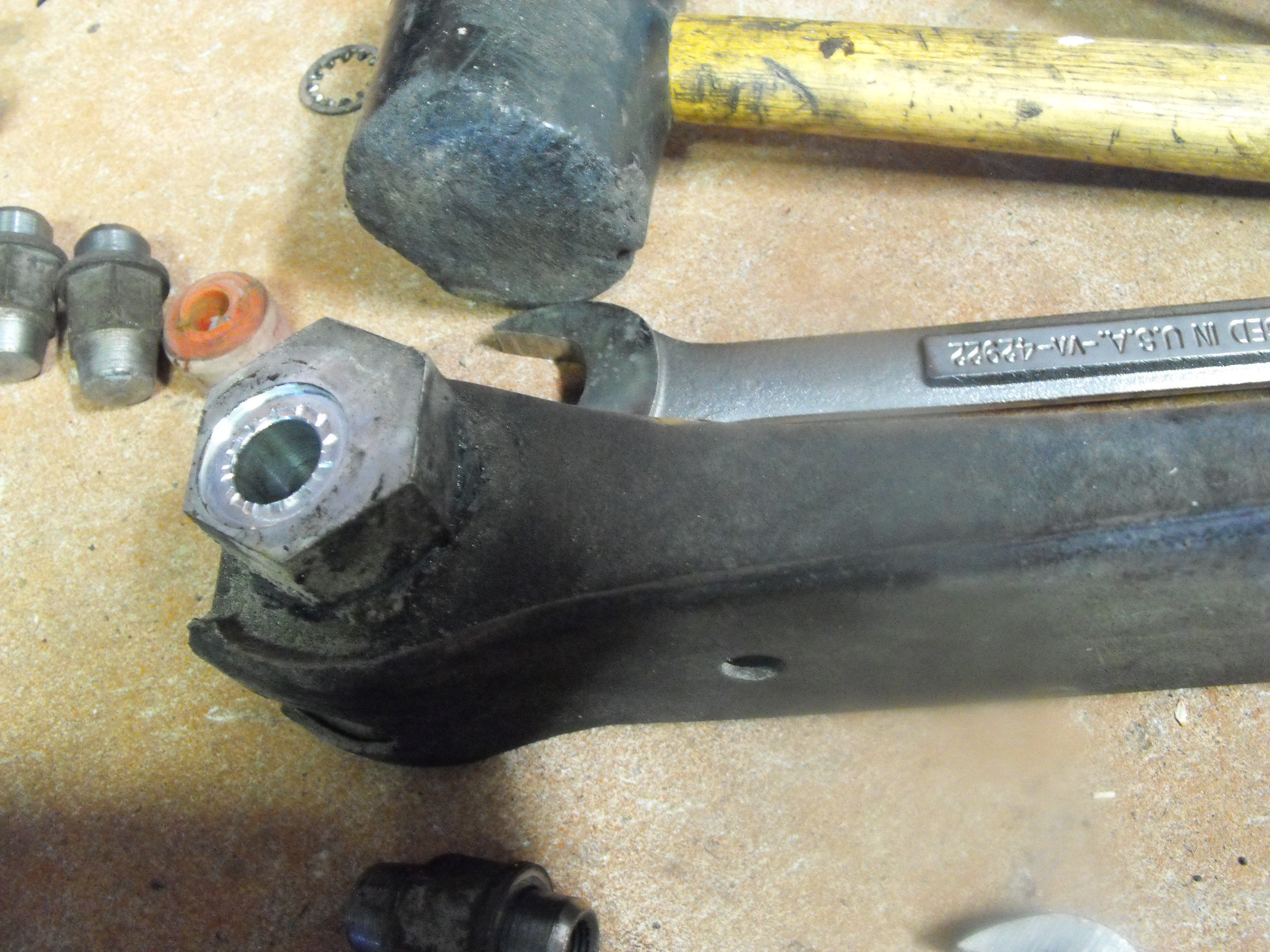

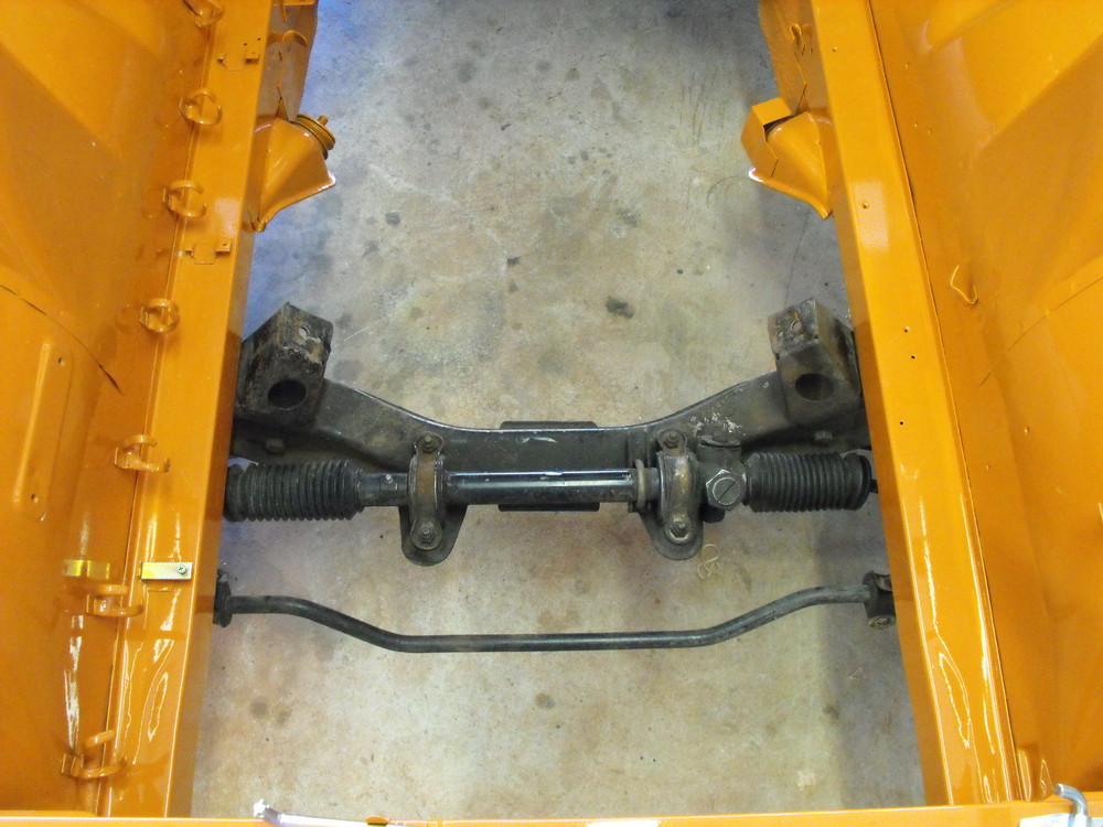

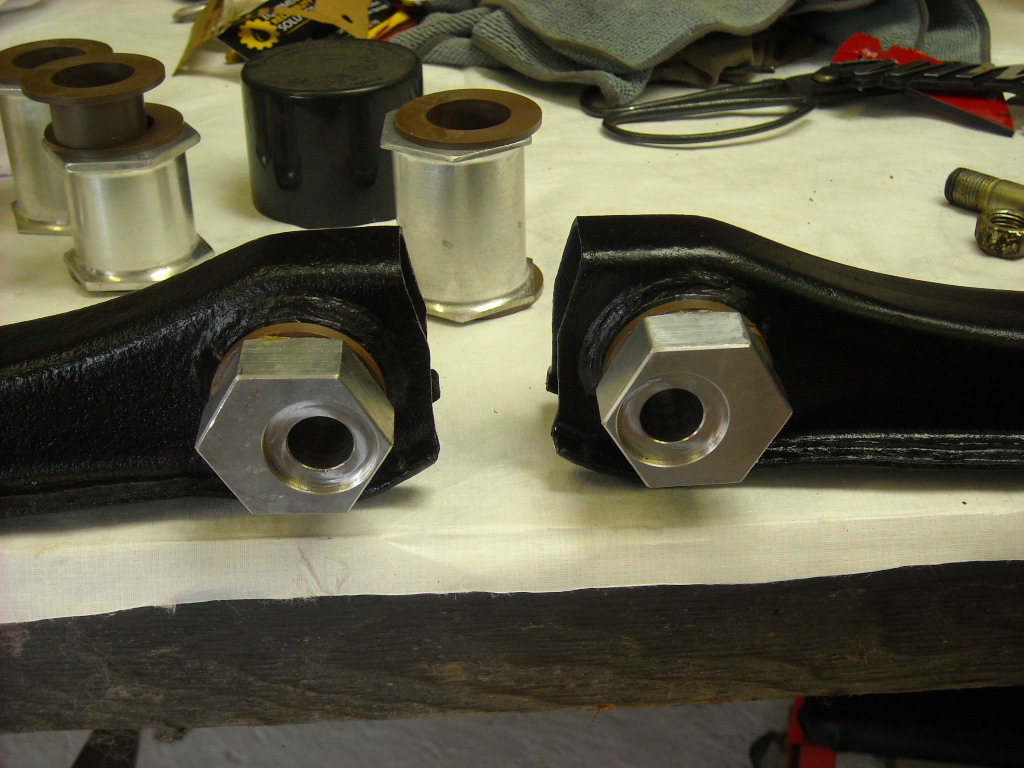

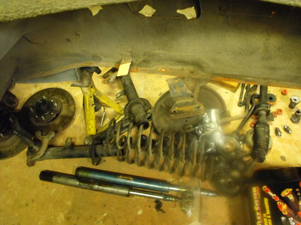

August 1, 20177 yr Author comment_527143 Thanks for the support everyone. Finished taking apart the front steering and suspension. Will get most of these pieces to the powdercoater and the fasteners out to plate. More Z CSI: Looks like we have some adjustable suspension parts on here. The hex fittings with the offset center. I have not seen these before on a Z. I will have to do a little research and find out where these come from...racing parts? Anyway, some are pics below....looks like I had some grease on my lens. Link to comment https://www.classiczcars.com/forums/topic/56833-deja-vu-1971-restoration/?&page=18#findComment-527143 Share on other sites More sharing options...
August 1, 20177 yr comment_527152 Those look like the first version of the g-Force offset bushings, the later version has a Delrin bushing that keeps the aluminum from getting chewed up. Link to comment https://www.classiczcars.com/forums/topic/56833-deja-vu-1971-restoration/?&page=18#findComment-527152 Share on other sites More sharing options...
August 1, 20177 yr Author comment_527158 5 hours ago, grannyknot said: Those look like the first version of the g-Force offset bushings, the later version has a Delrin bushing that keeps the aluminum from getting chewed up. Very interesting. Thanks for the info. I found the Delrin bushing version on the Motorsport website. http://www.thezstore.com/page/TZS/PROD/23-4170 Link to comment https://www.classiczcars.com/forums/topic/56833-deja-vu-1971-restoration/?&page=18#findComment-527158 Share on other sites More sharing options...

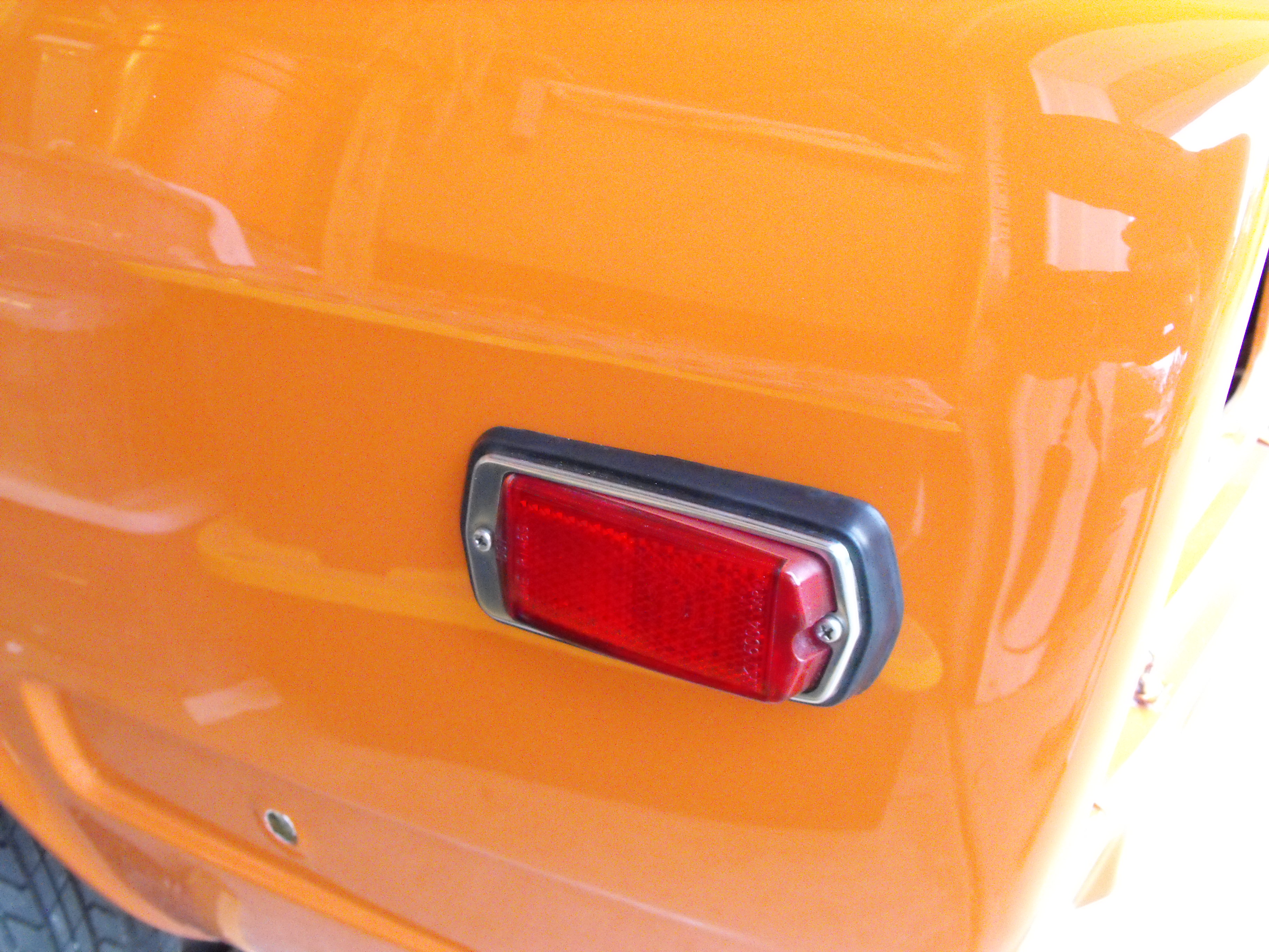

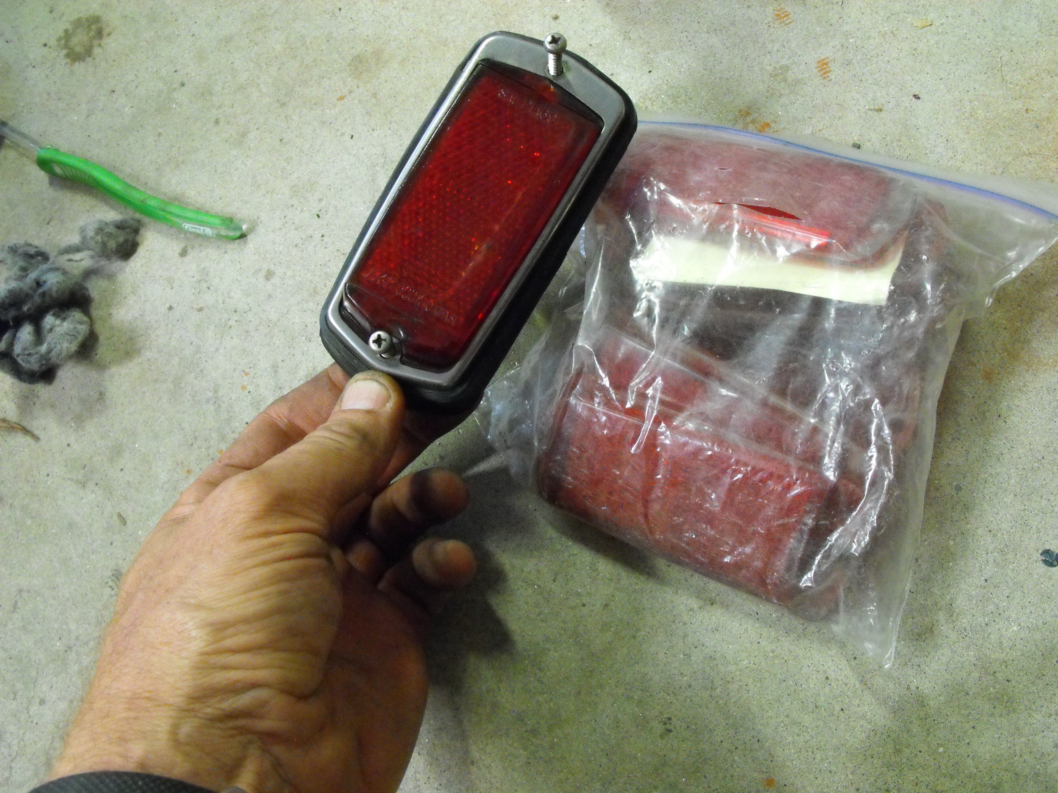

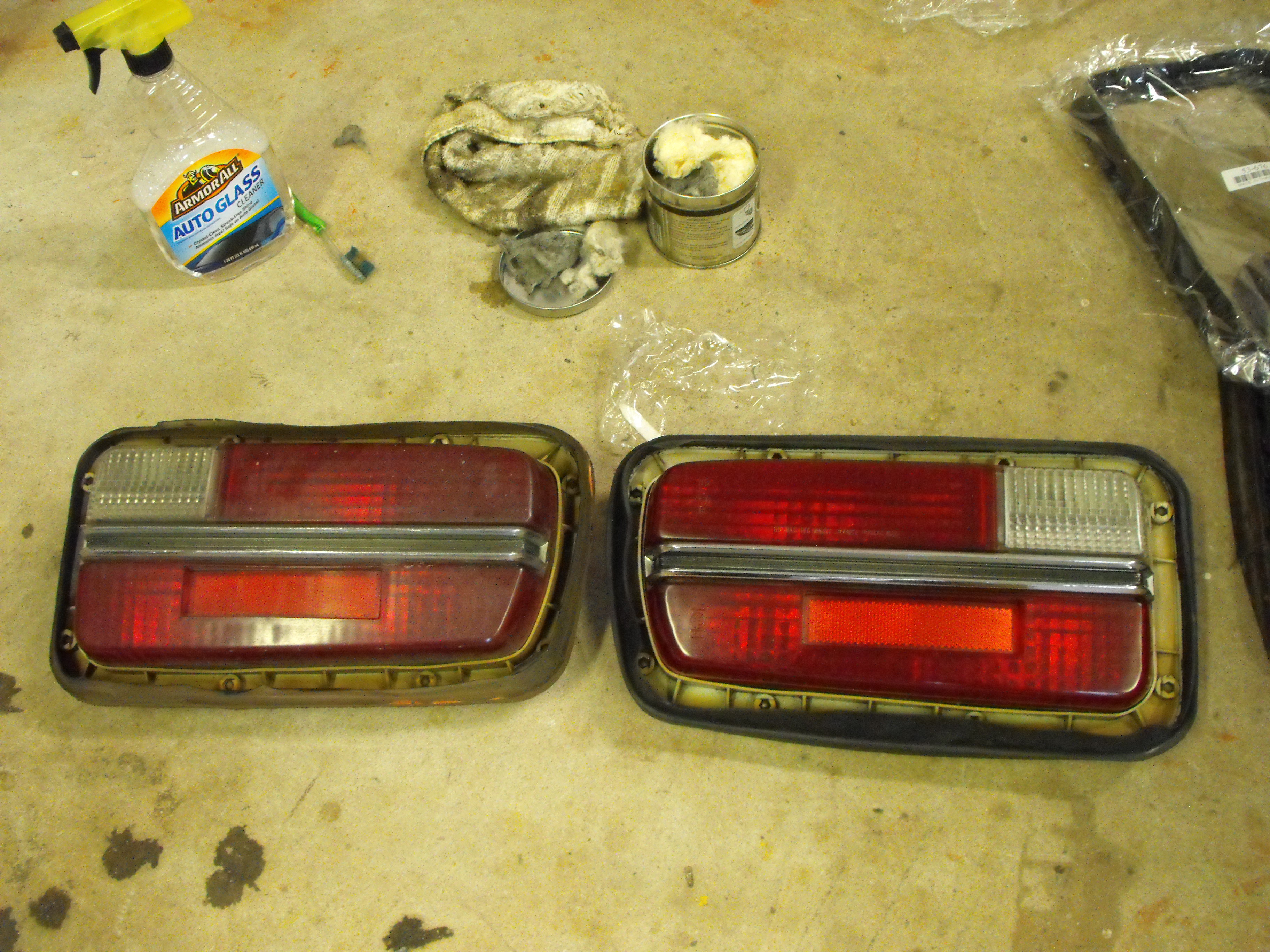

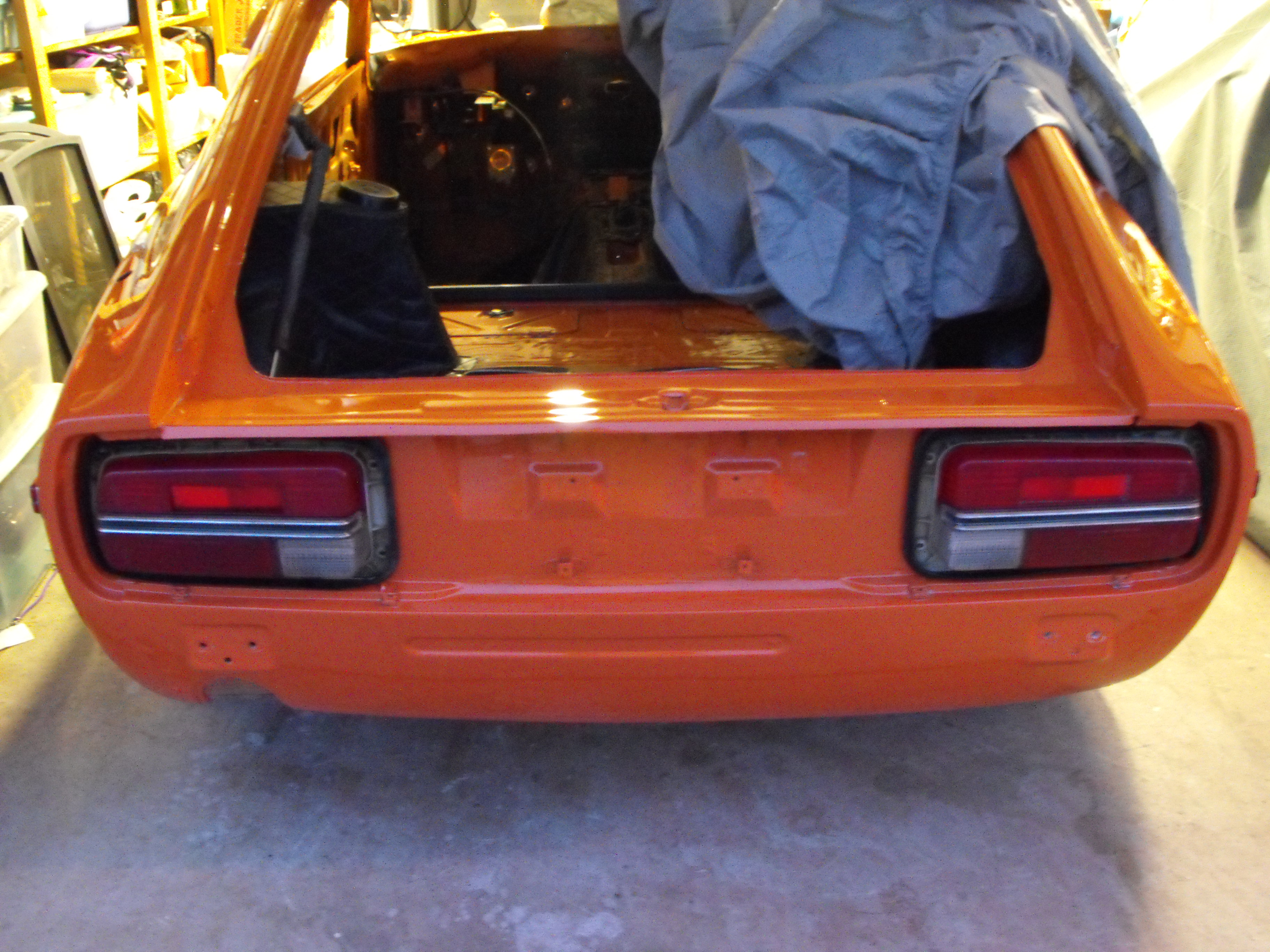

August 3, 20177 yr Author comment_527292 Got some new tail light gaskets. The old ones were cracked and crusty. Cleaned up the tail lights, installed new gaskets and installed them on the car. Also cleaned up the rear side/signal lights and installed them. One of the signal lights had a crack. Fortunately I have a bag of these things so I just swapped it out and installed a nice one. Pics below. Link to comment https://www.classiczcars.com/forums/topic/56833-deja-vu-1971-restoration/?&page=18#findComment-527292 Share on other sites More sharing options...
