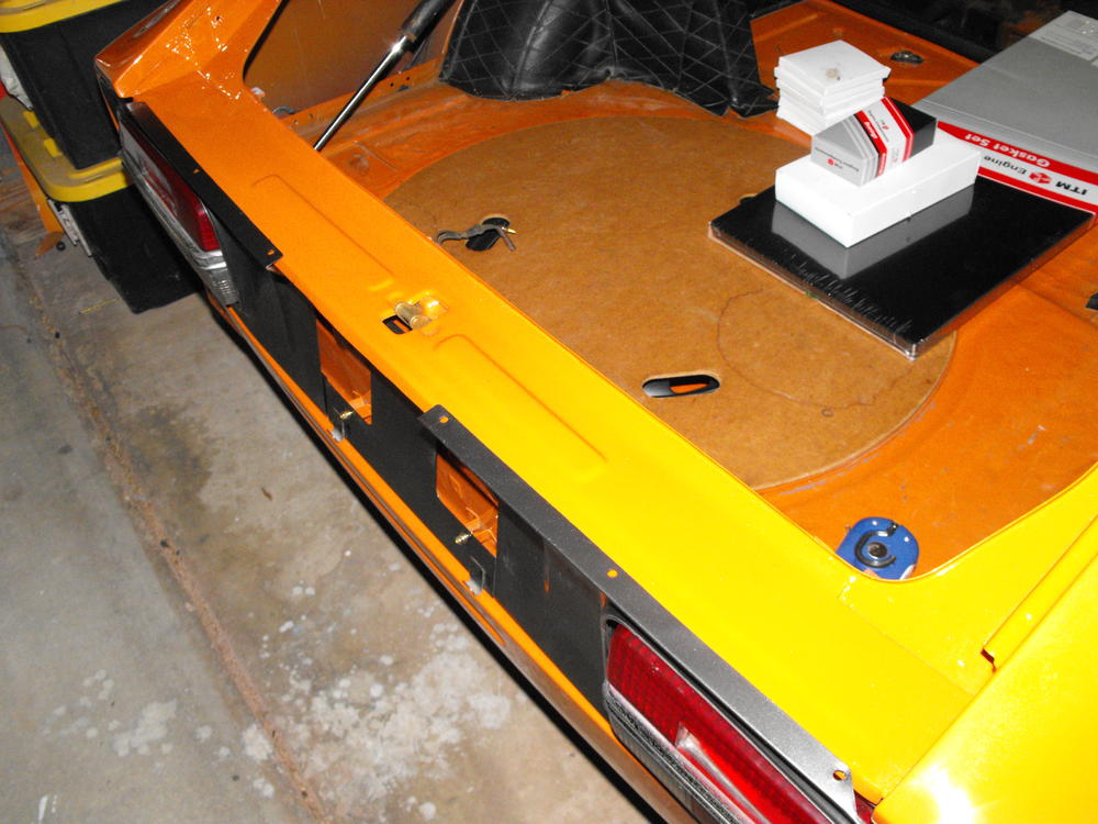

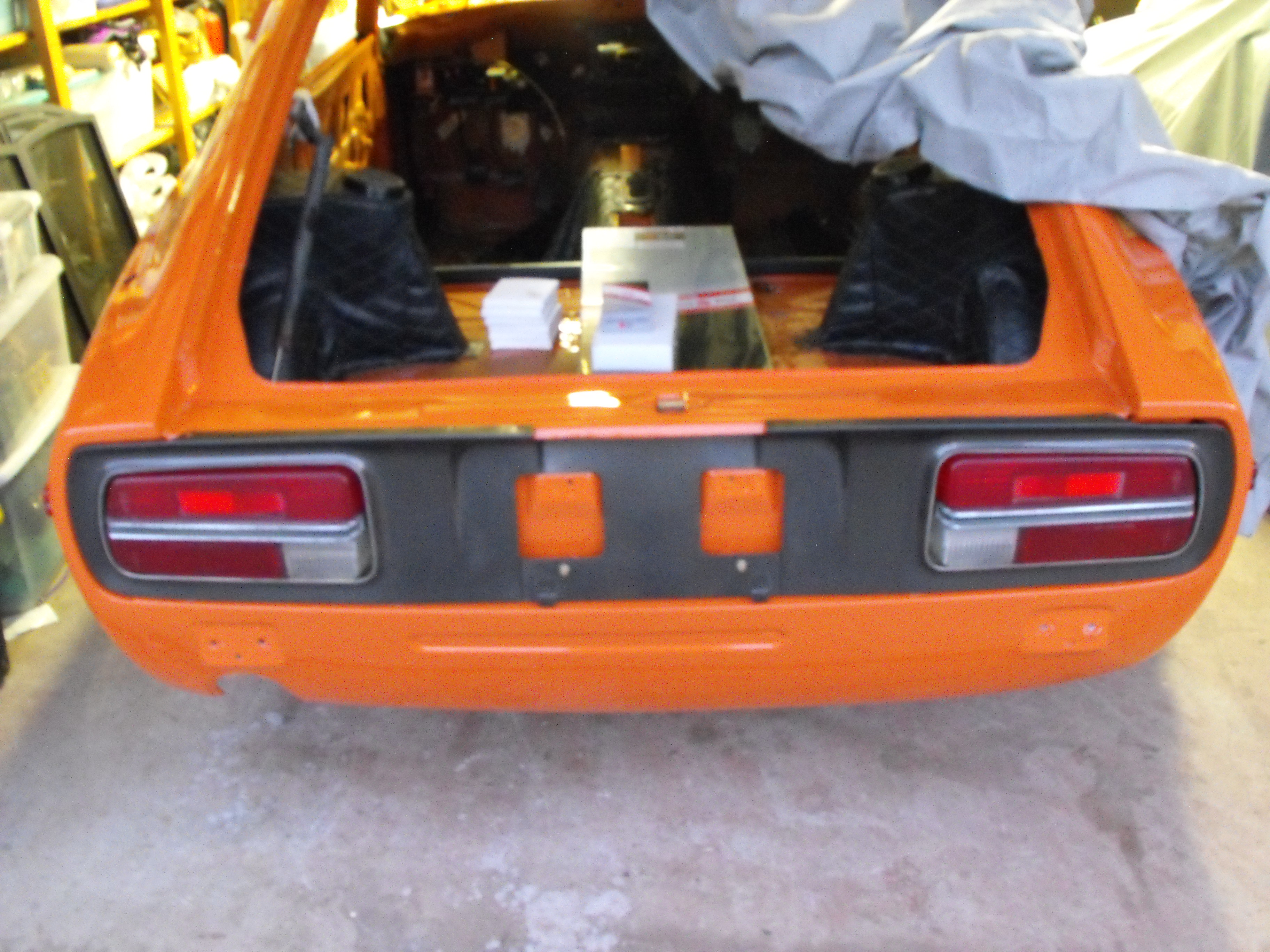

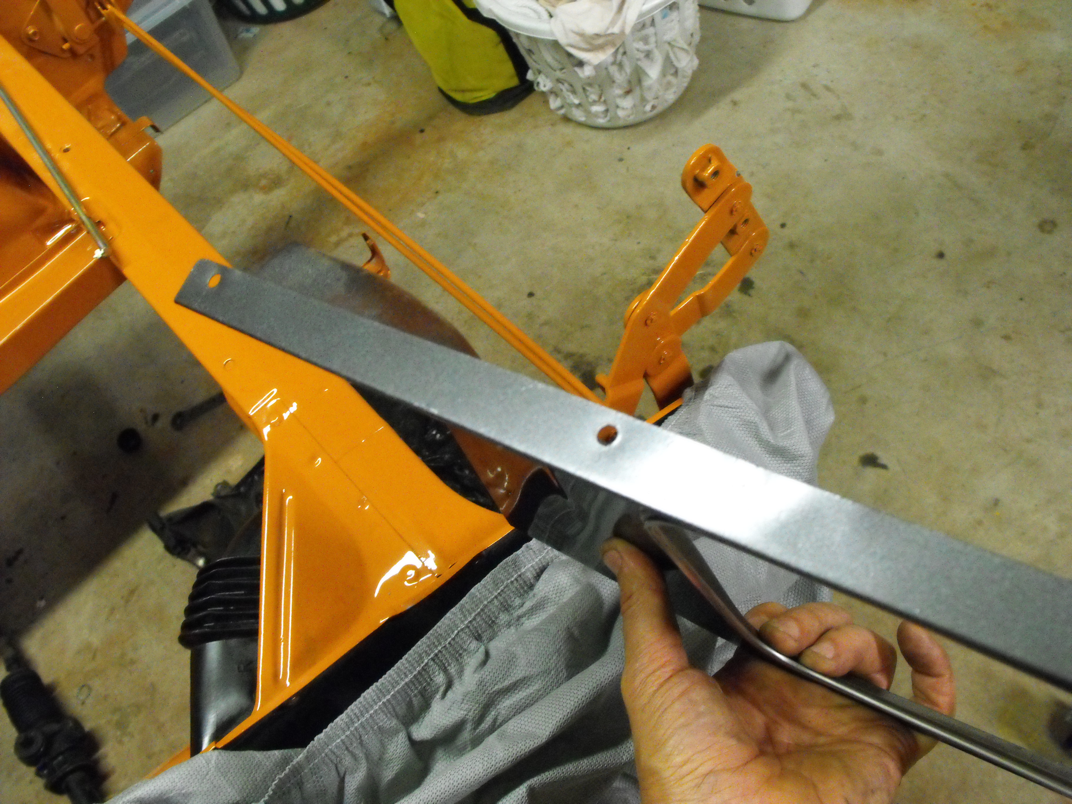

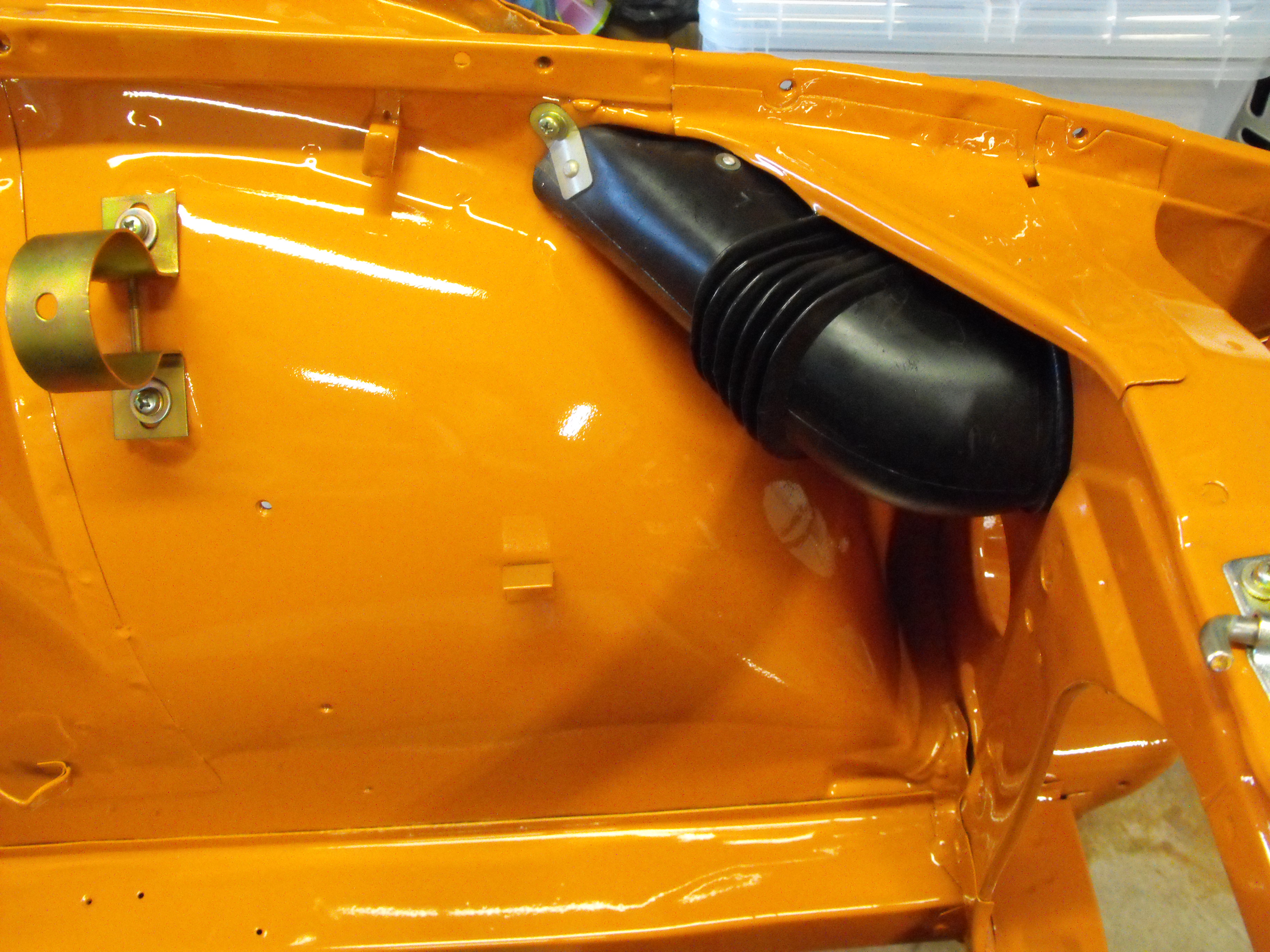

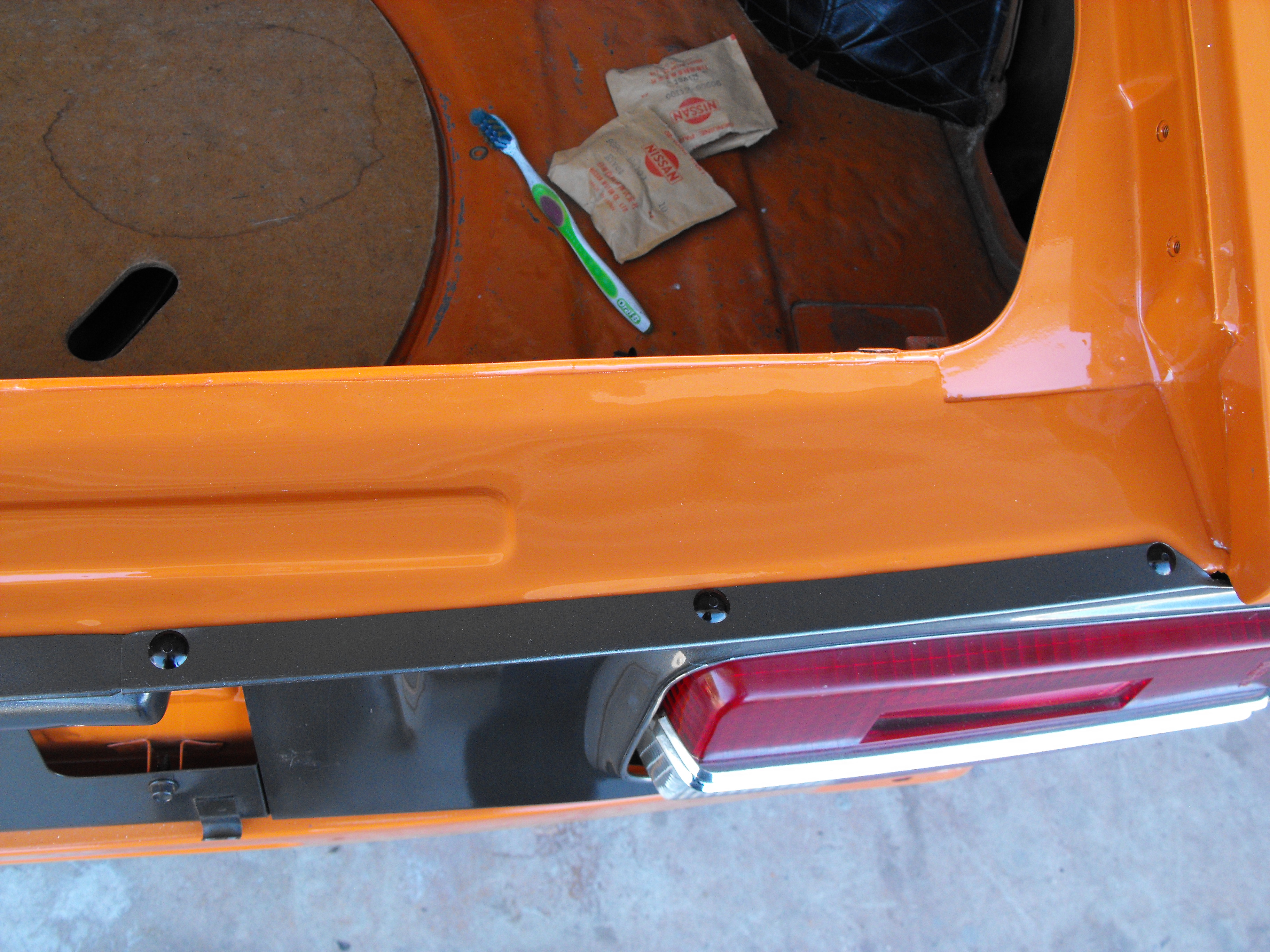

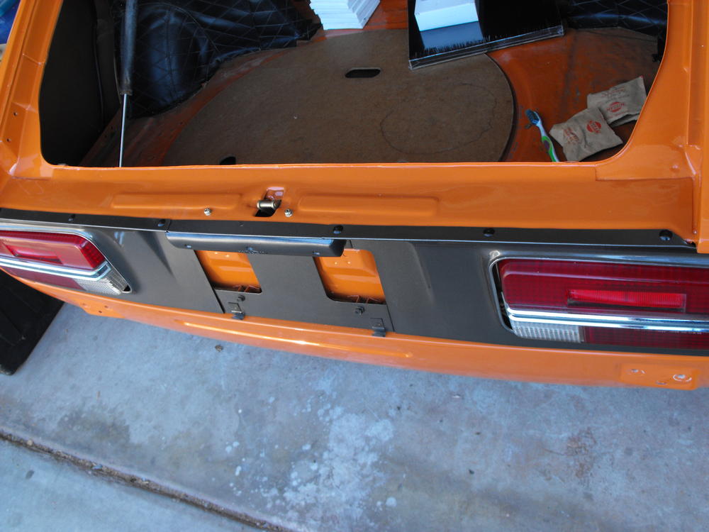

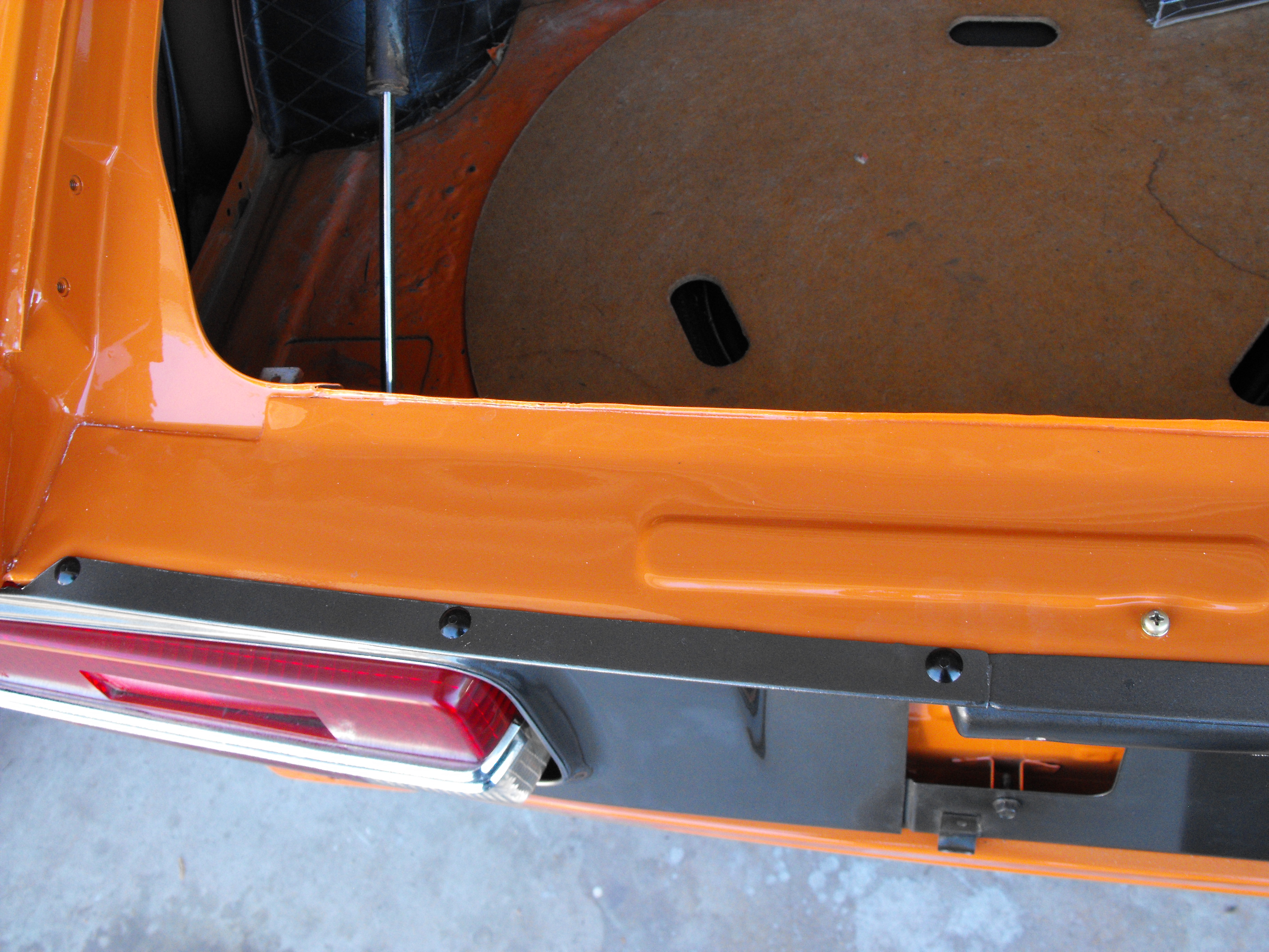

Got a  bunch of little things done today.  Cleaned the front air ducts and installed those.  Touched up scratches on the rear panels and pressed them in place.  I noticed the back hatch panel does not have any holes to attach the gray panels.  I will have to drill that in order to put the rivets through.  I installed the filler tube, flap and gas cap.  i may end up getting a new flap for this.  There are some small cracks on this flap at the edges. Also painted the front grill panel satin black.  Pics below

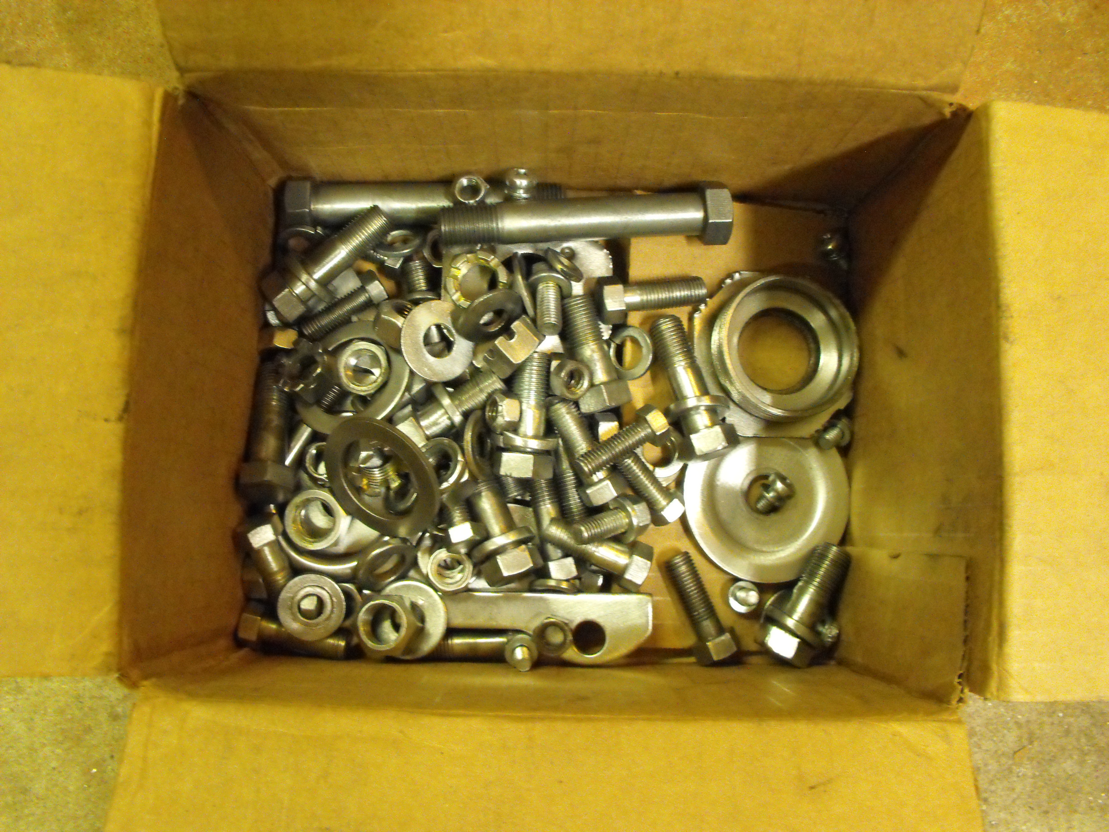

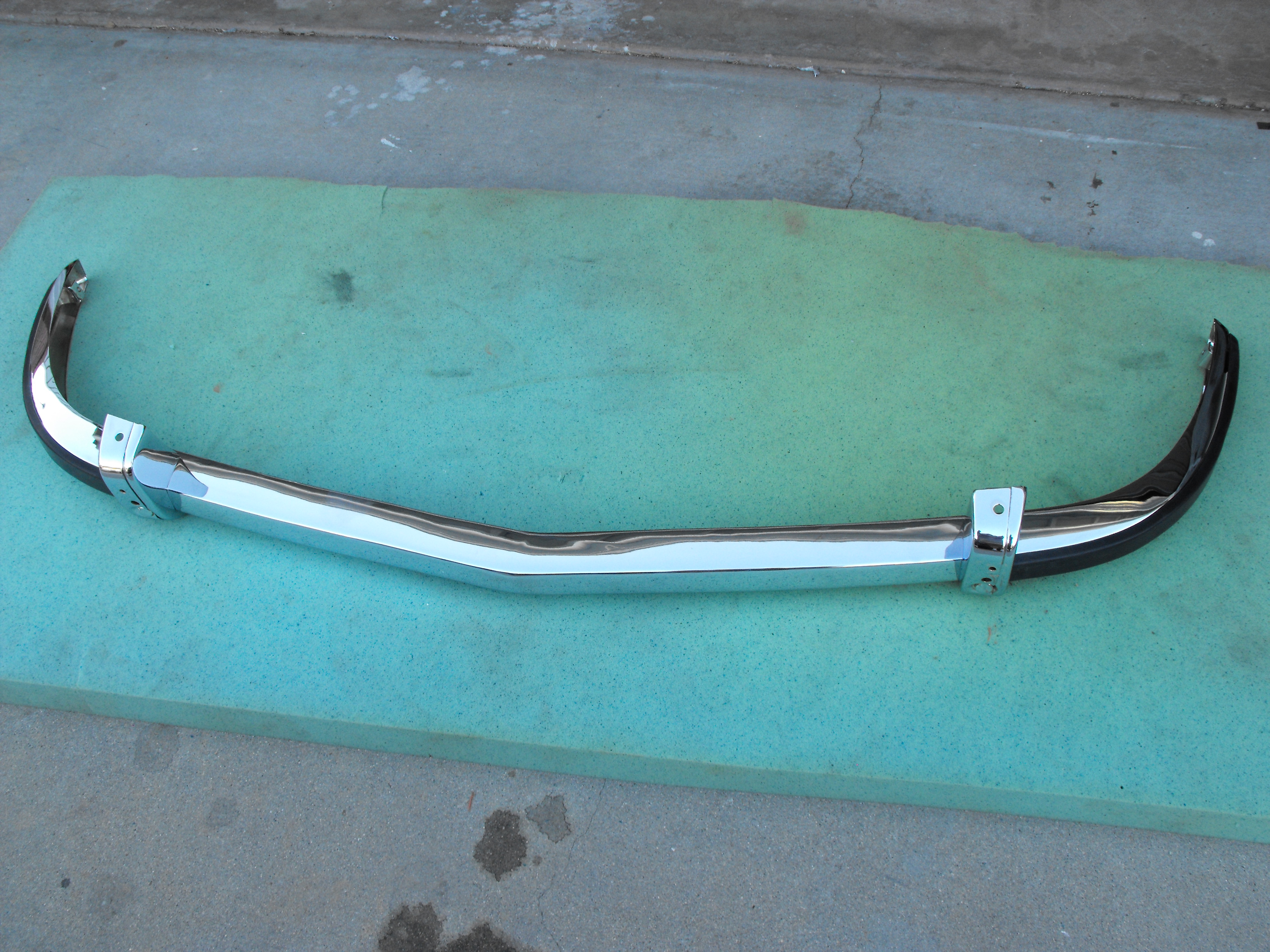

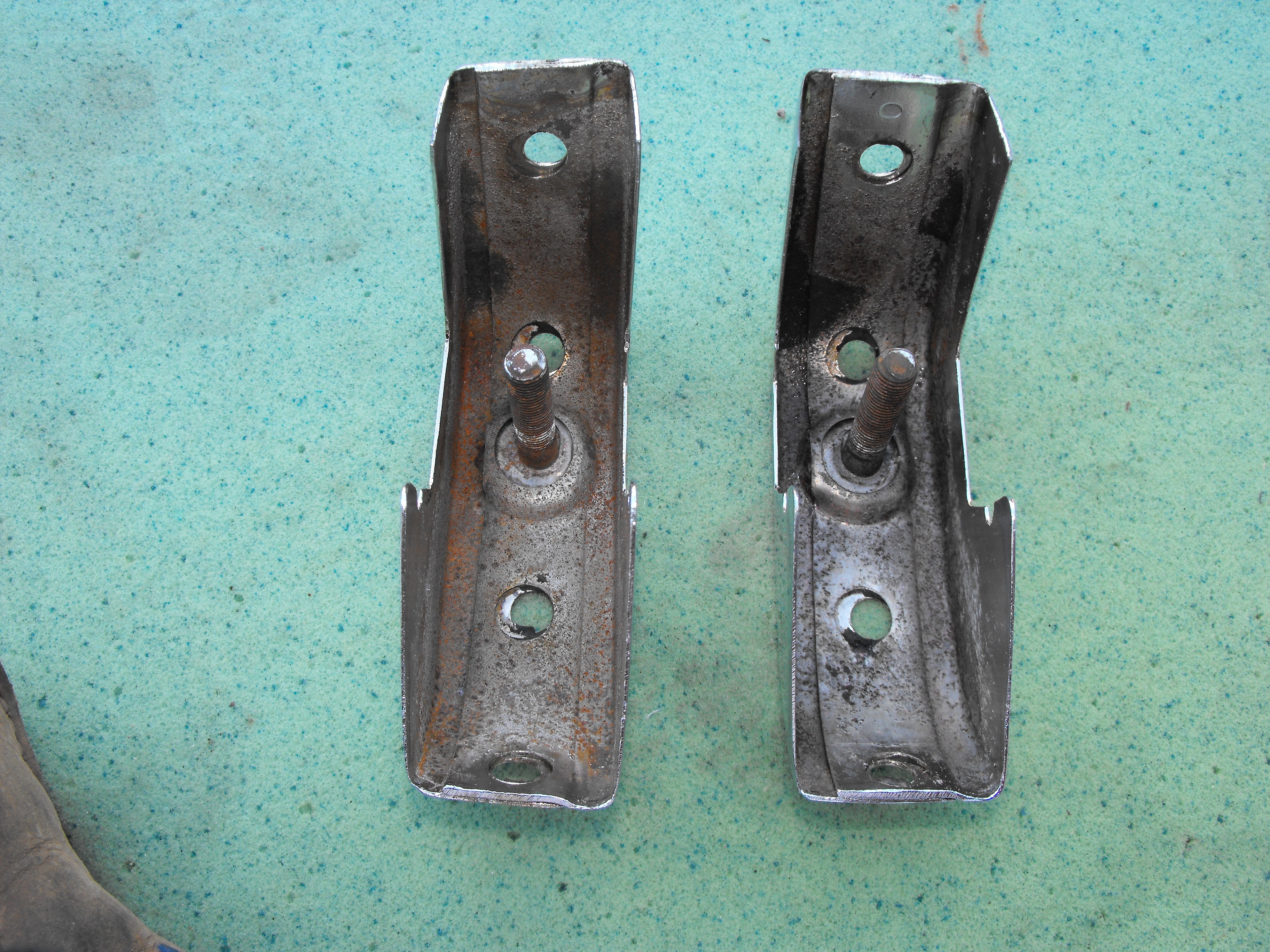

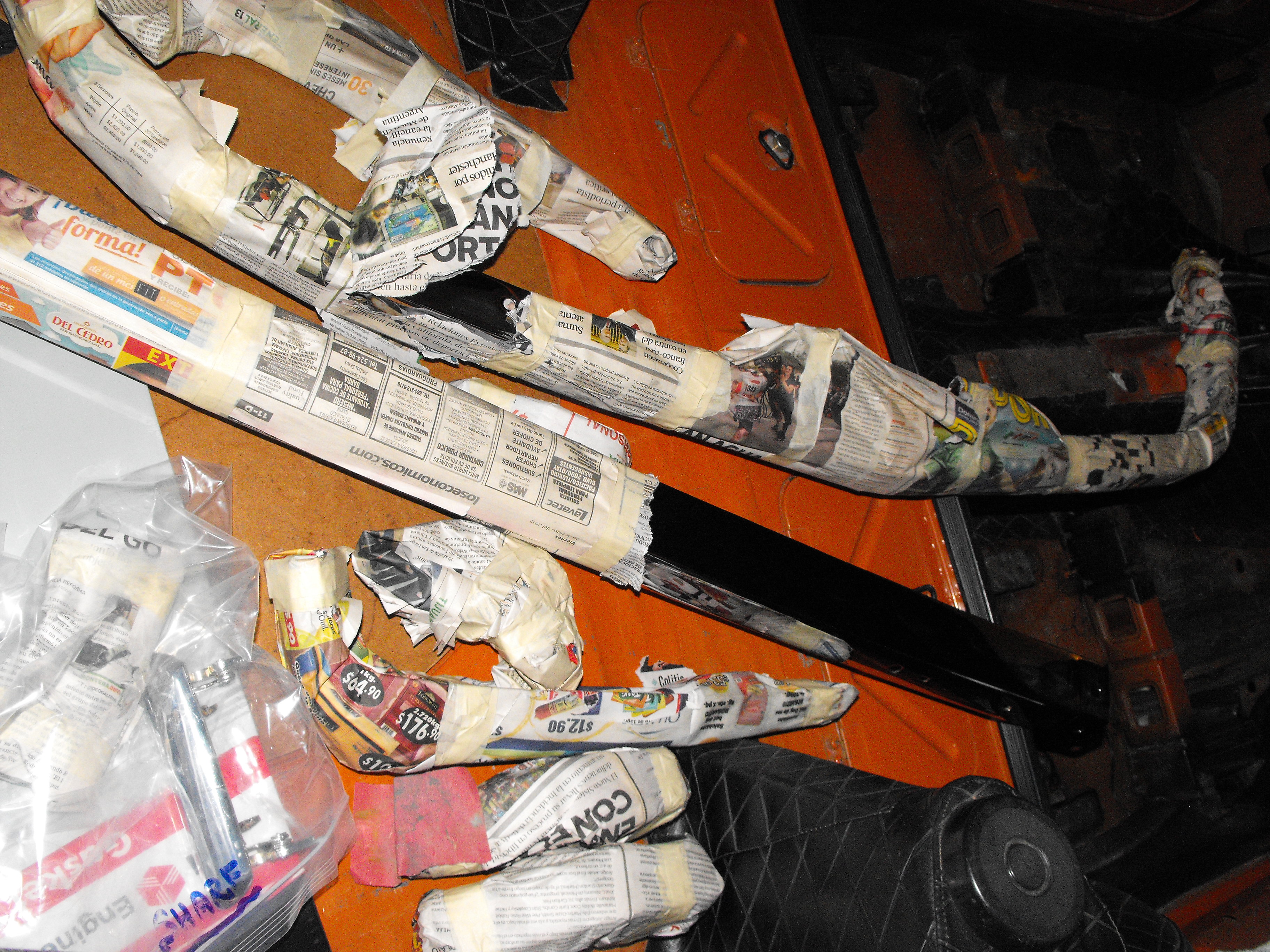

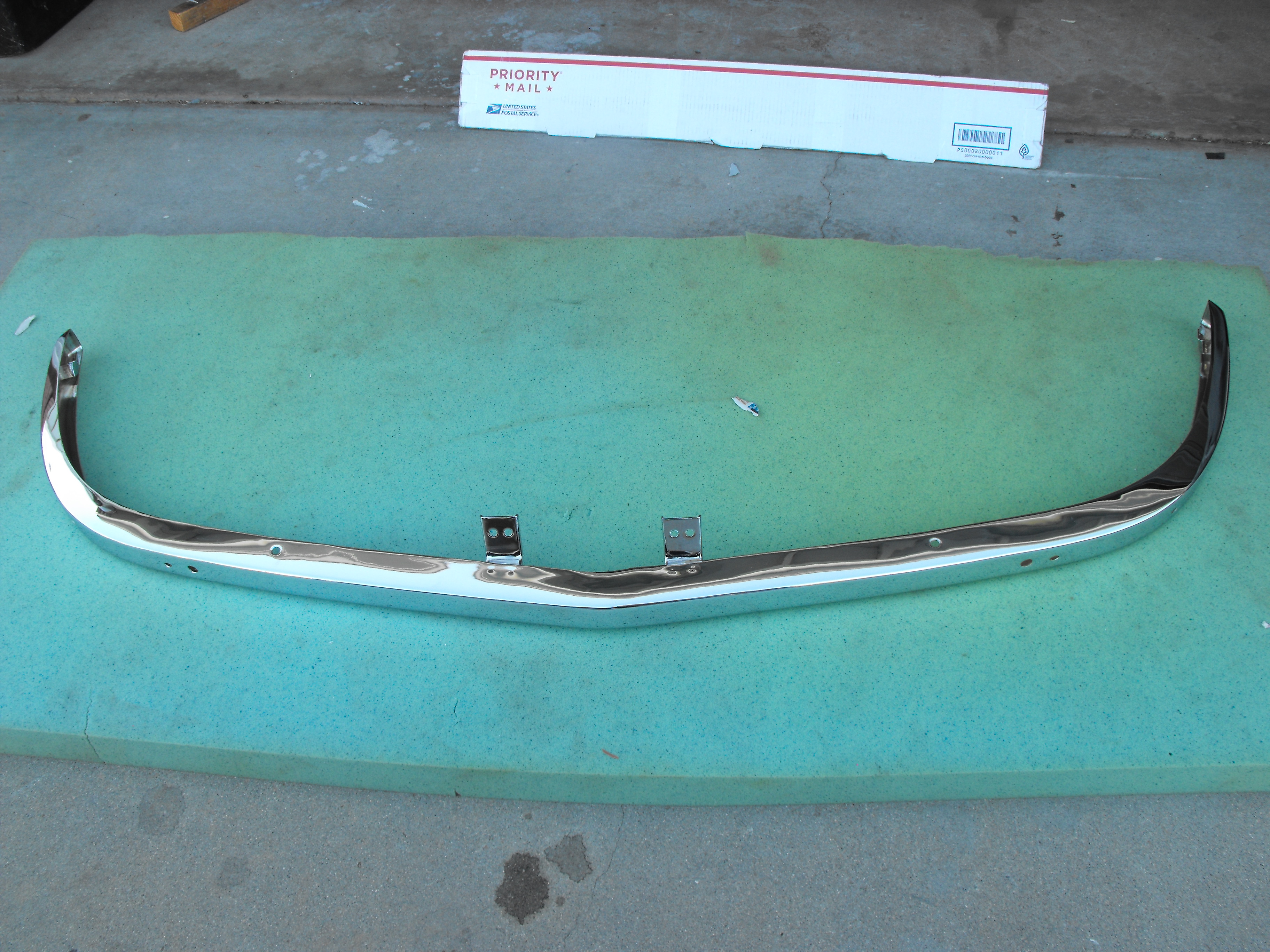

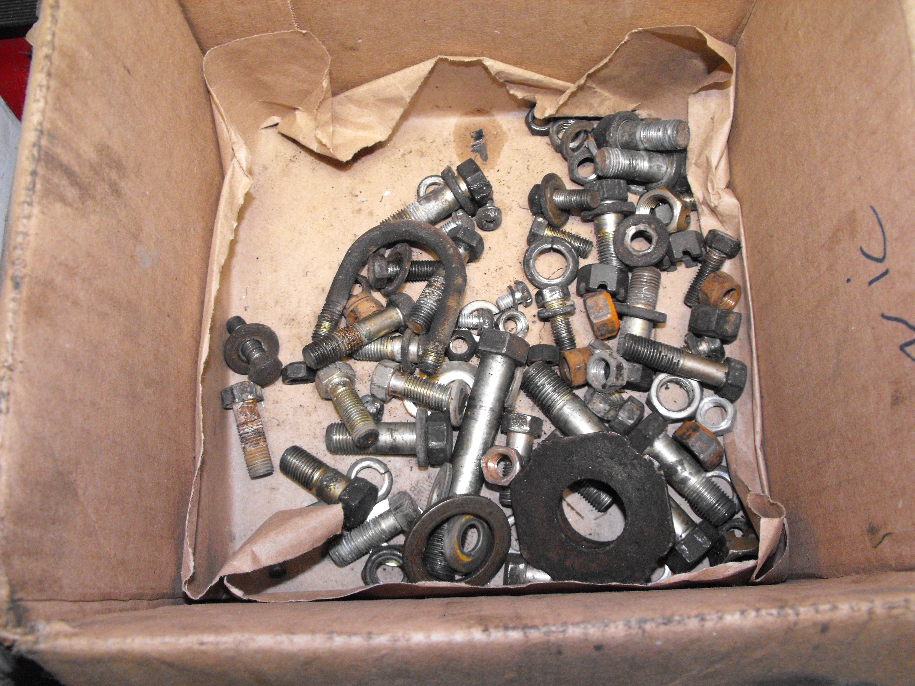

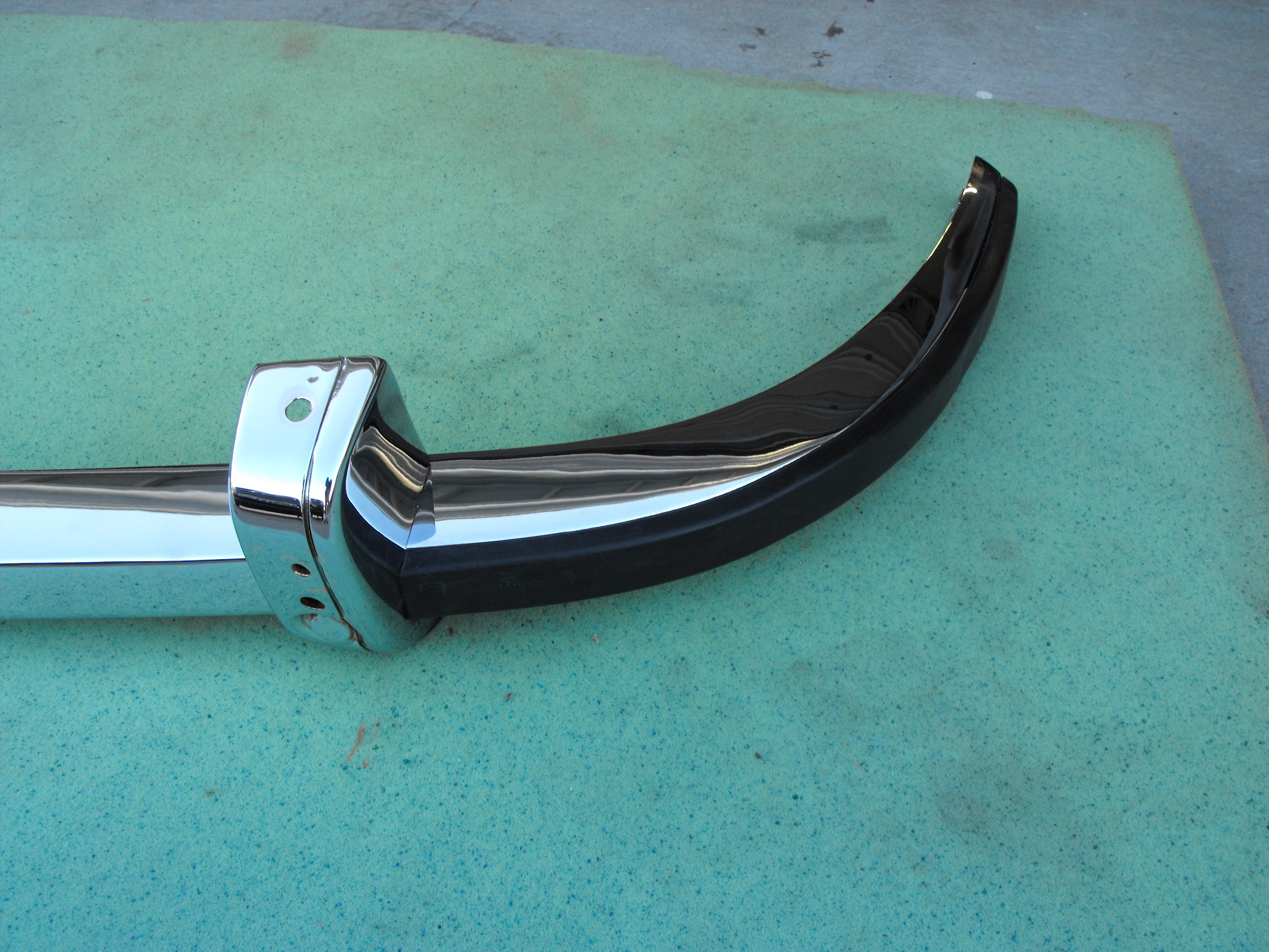

Cleaned up the front suspension area hardware so I can get it plated.   Got the chrome back from Pacific Plating.  I think I will leave the chrome parts in the wrap for now until I am ready to install it.  The new chrome looks so nice!
Edited by motorman7

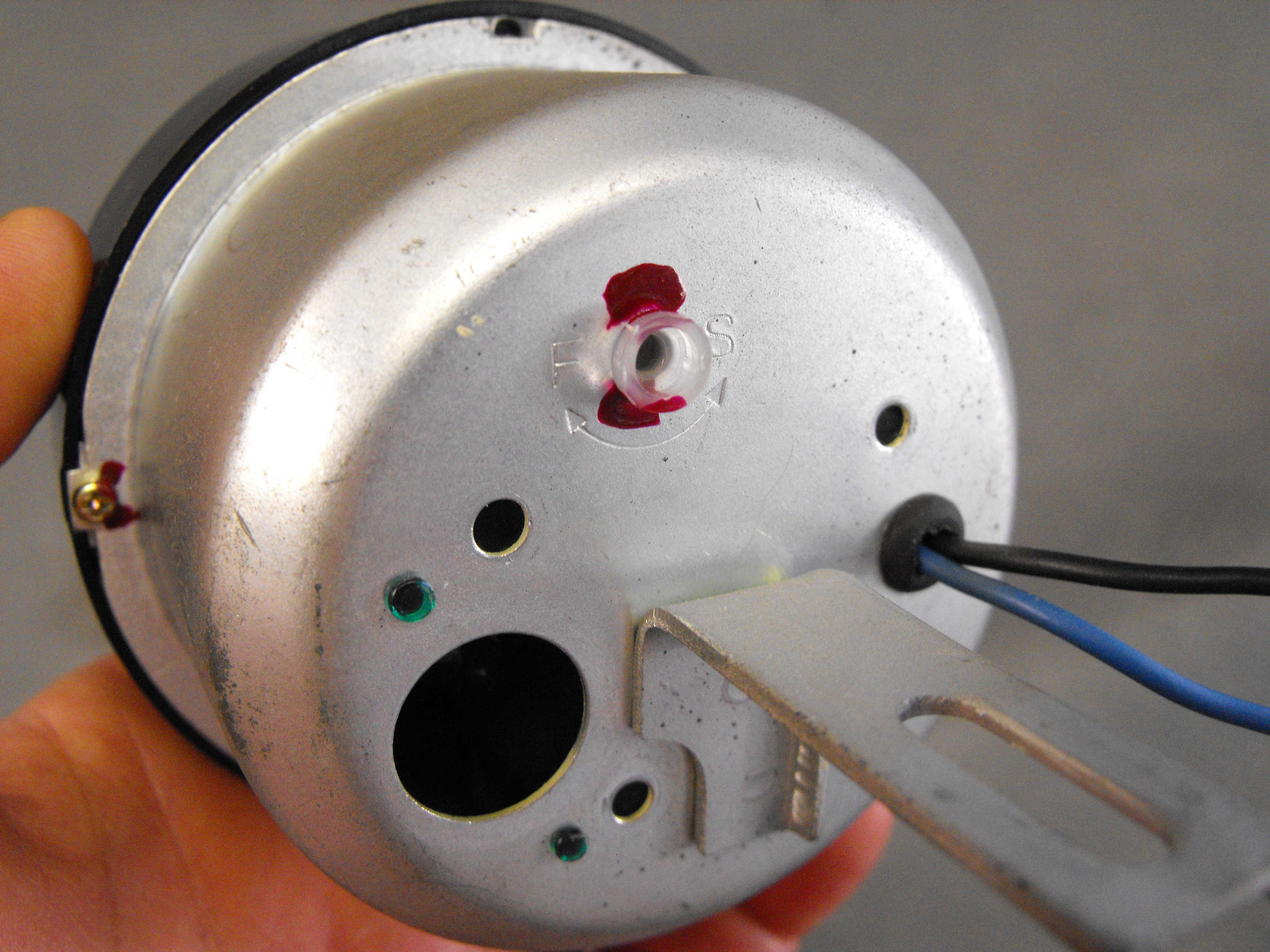

Picked up the clock from the clock repair guy.  He really does a great job.  I gave him the broken clock over two weeks ago.  He installed a quartz mechanism and then monitored the time for almost two weeks to make sure it was EXACT.   He even puts marker on the back for the clock speed adjustment which I thought was interesting.  He did the clock on my 71 Z and the clock keeps excellent time.  Pretty nice for a 240Z.

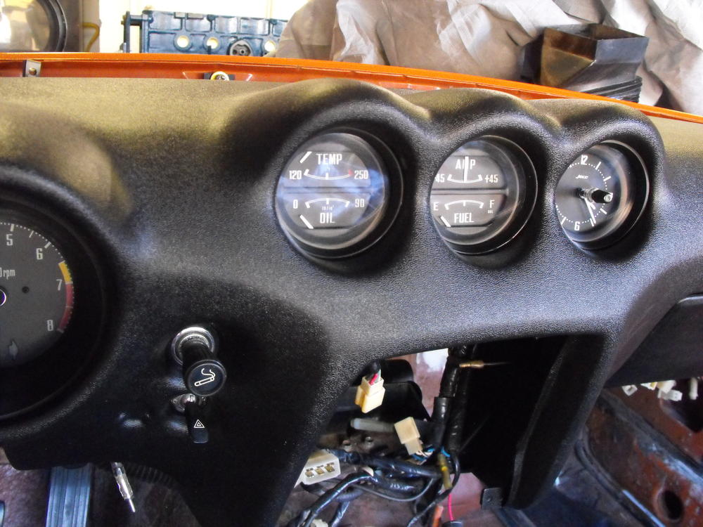

Also installed the clock in the dash.  Pics below.

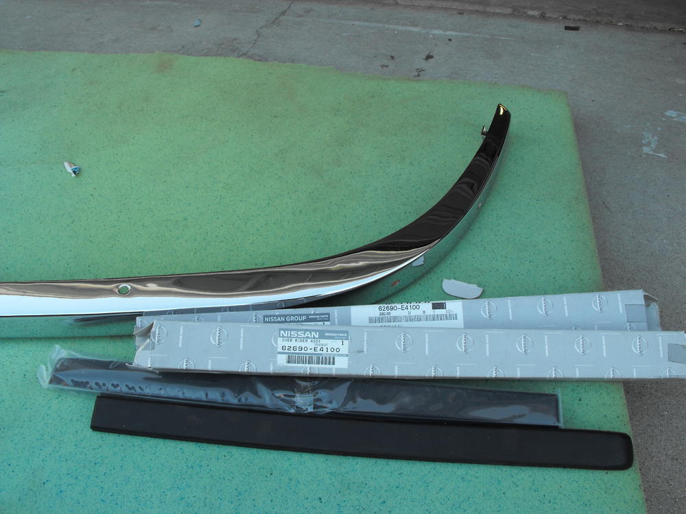

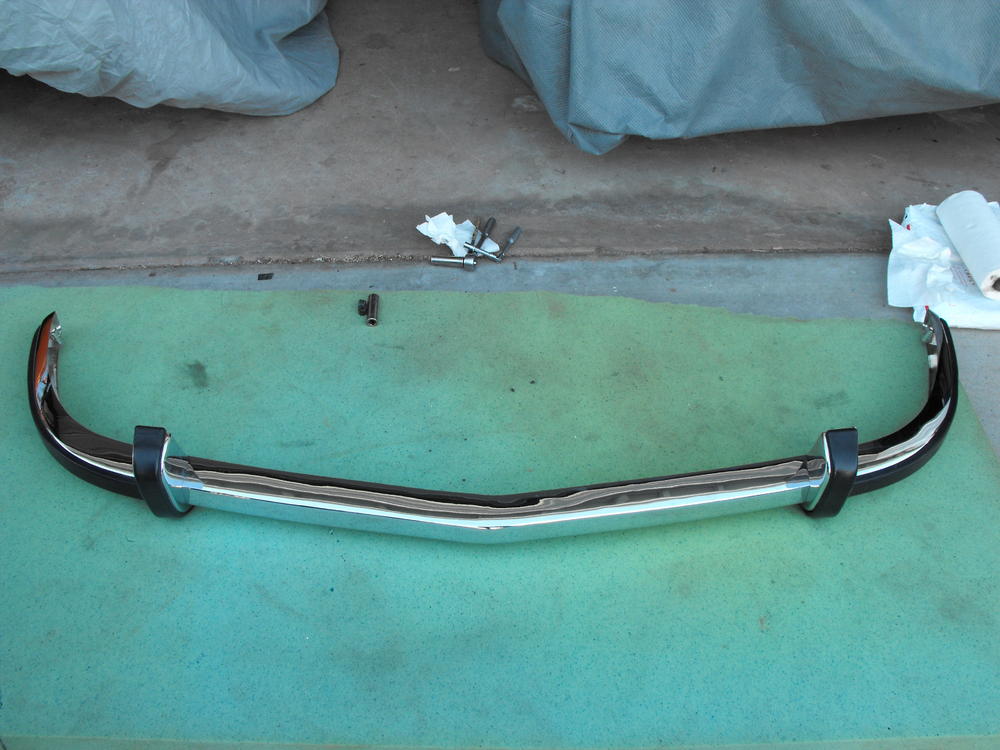

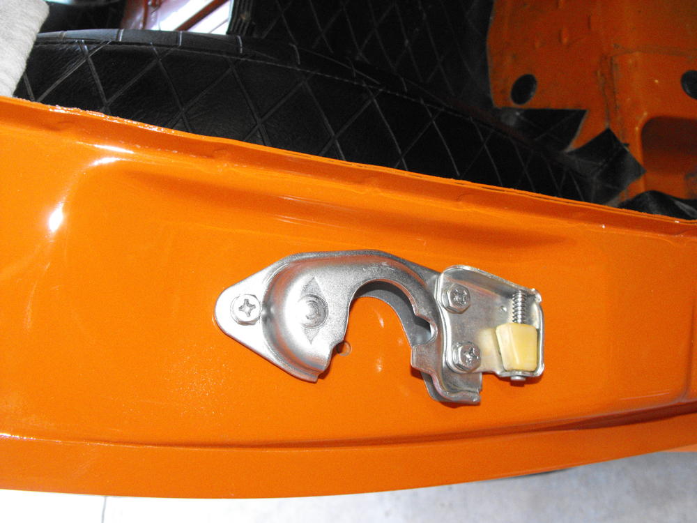

Installed the door latches and also installed the outside rubber on the front bumper.  The over rider rubber should be in tomorrow.  Pics below

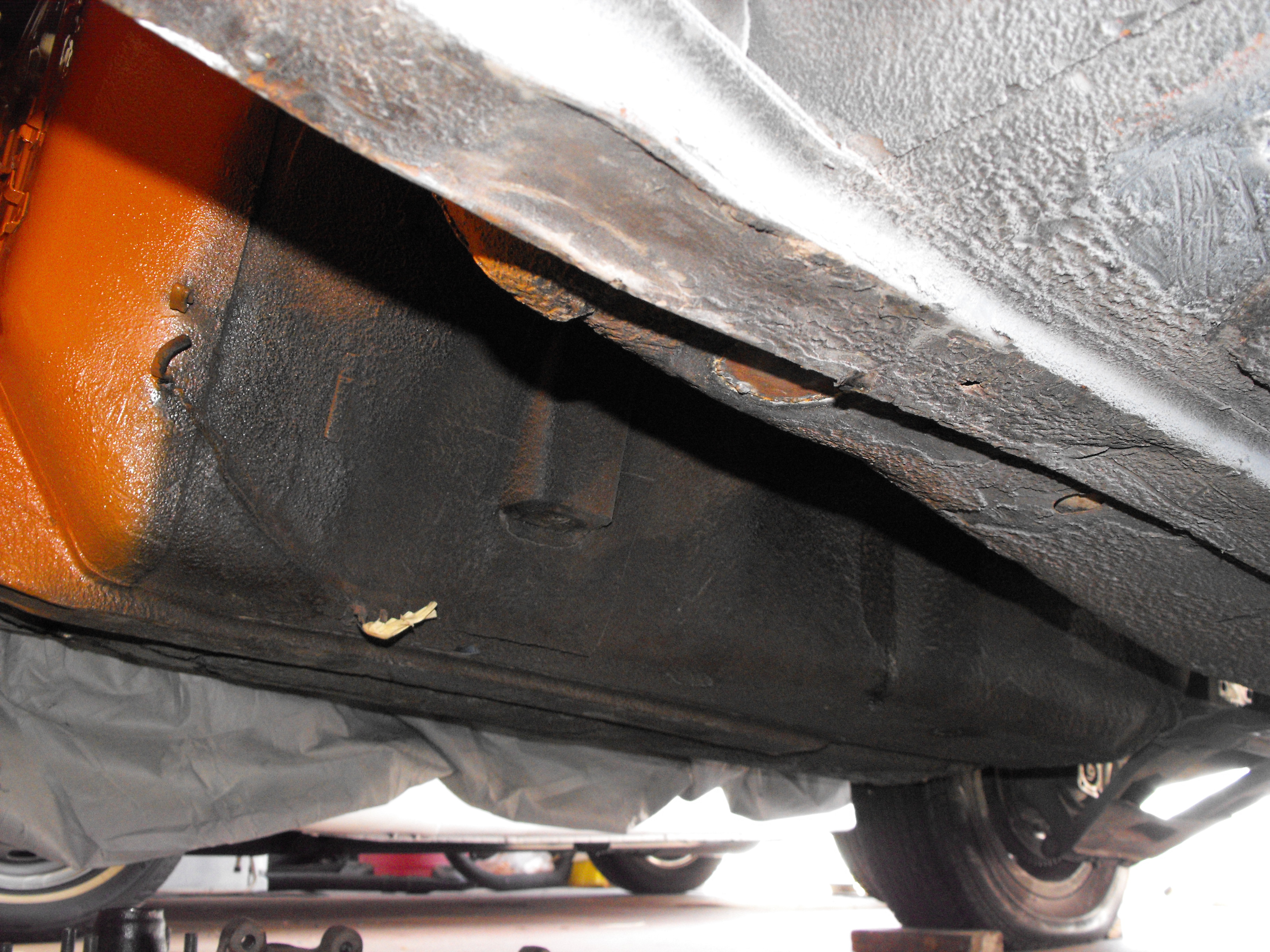

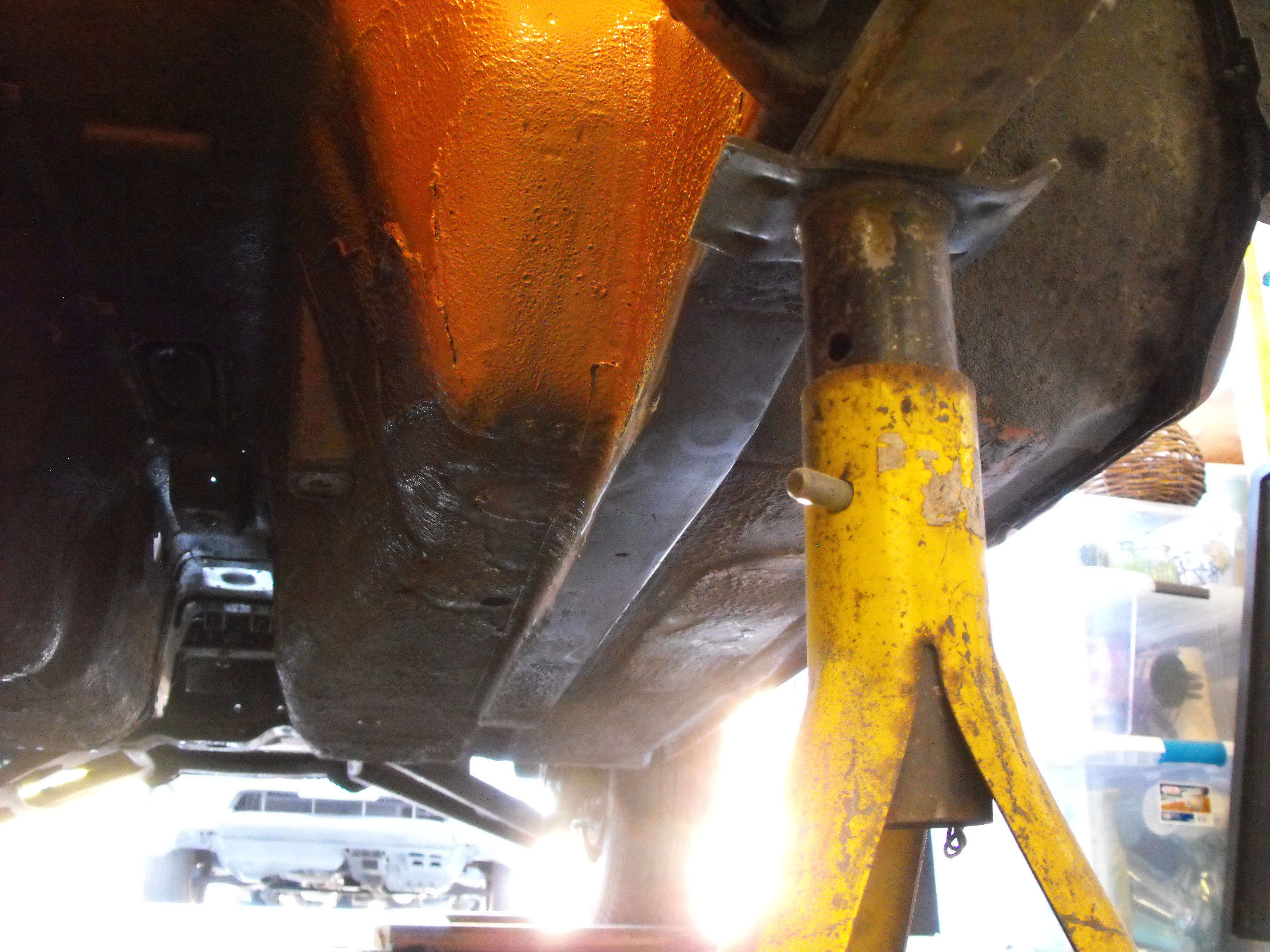

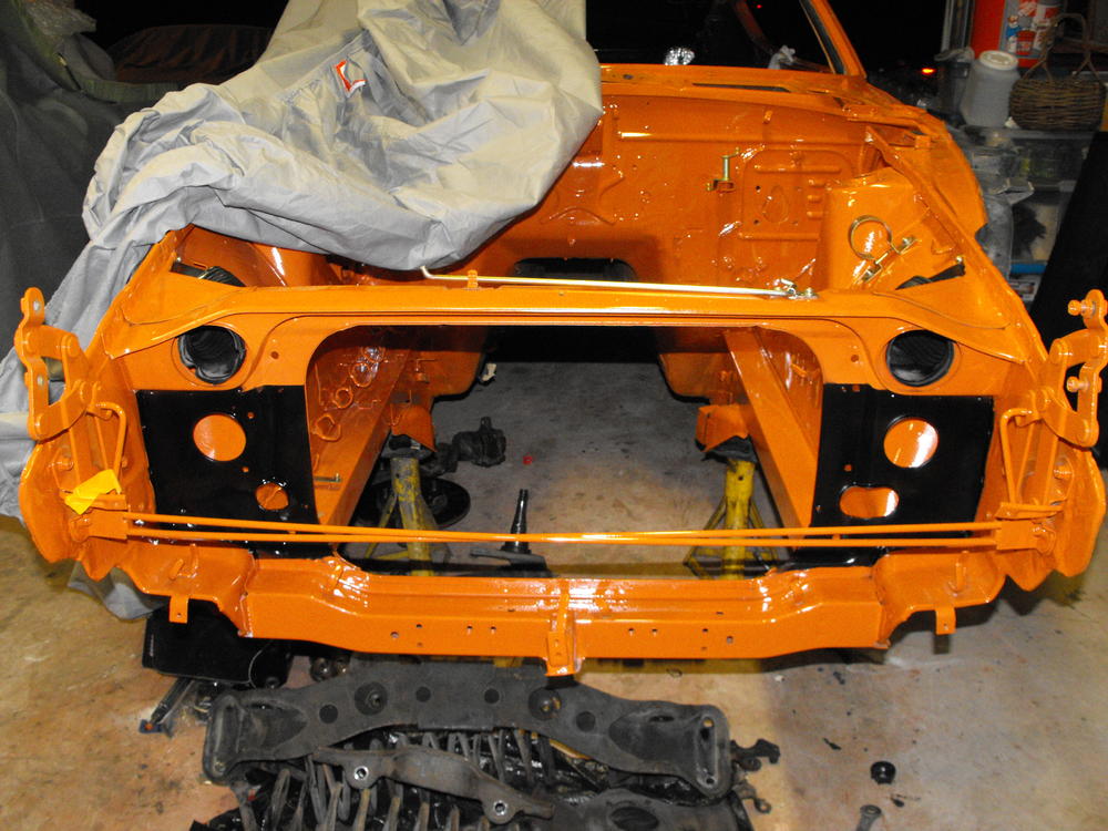

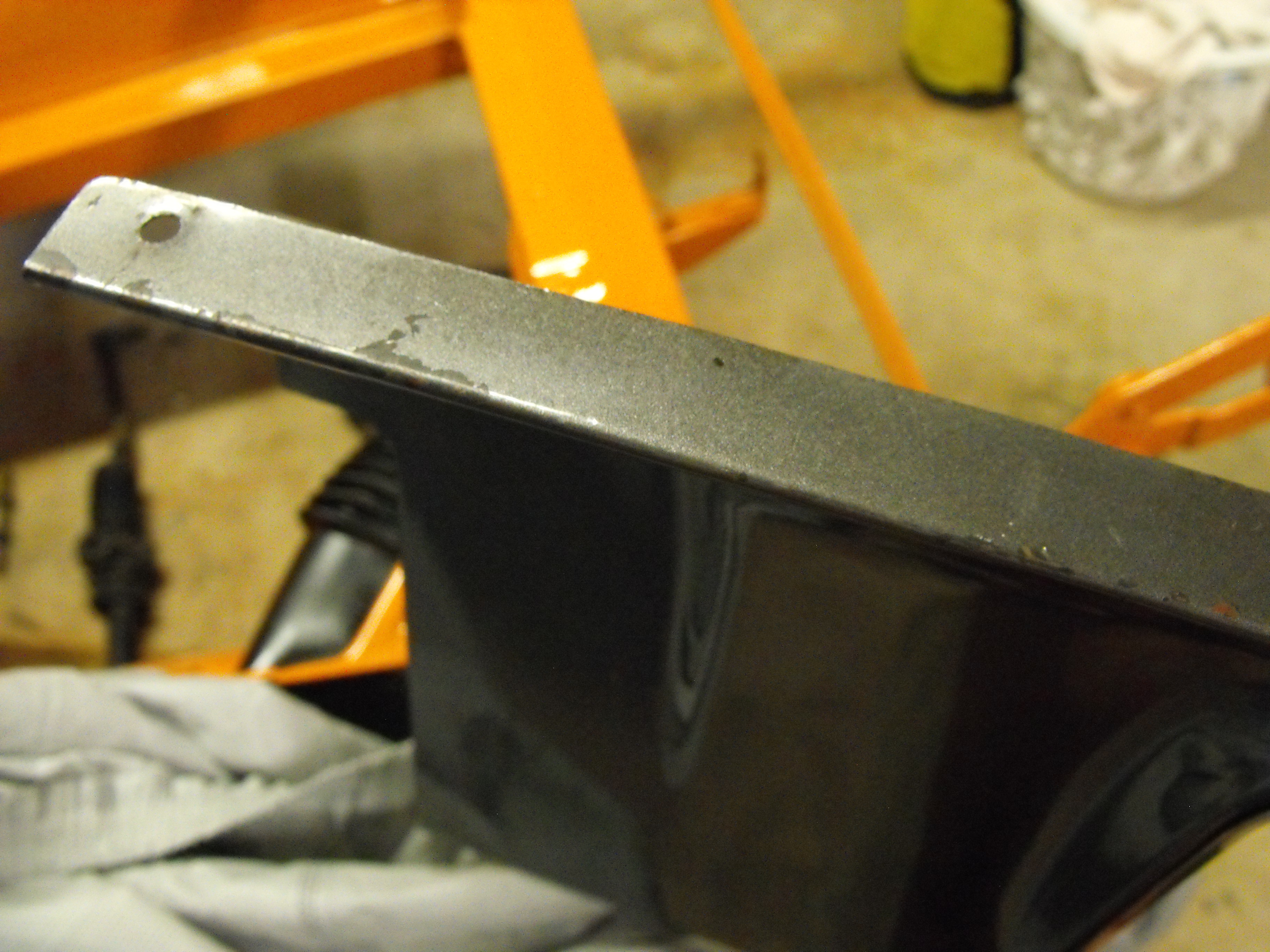

I worked on the drivers side frame rail today.  It had a few significant dents, so I used a slide hammer to pull the dents out and then some filler to clean them up.  I will use POR-15 on this area and then spray the undercoating on top of that.  Pics below are the before pic and the straightened frame rail.  Still need to POR-15 and undercoat these.
Edited by motorman7

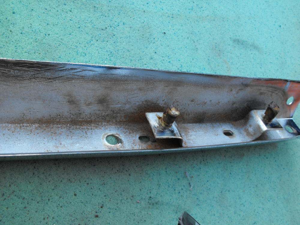

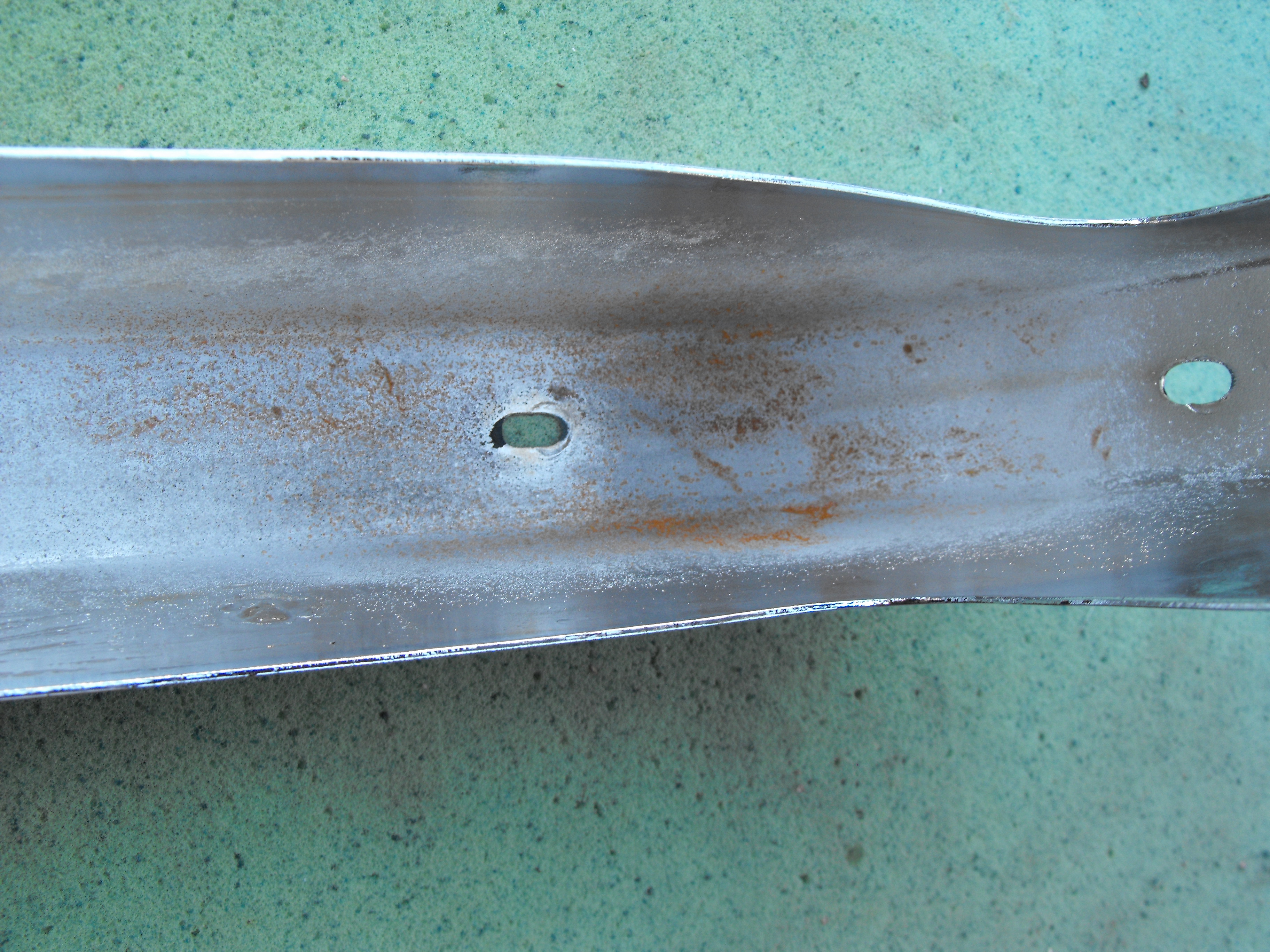

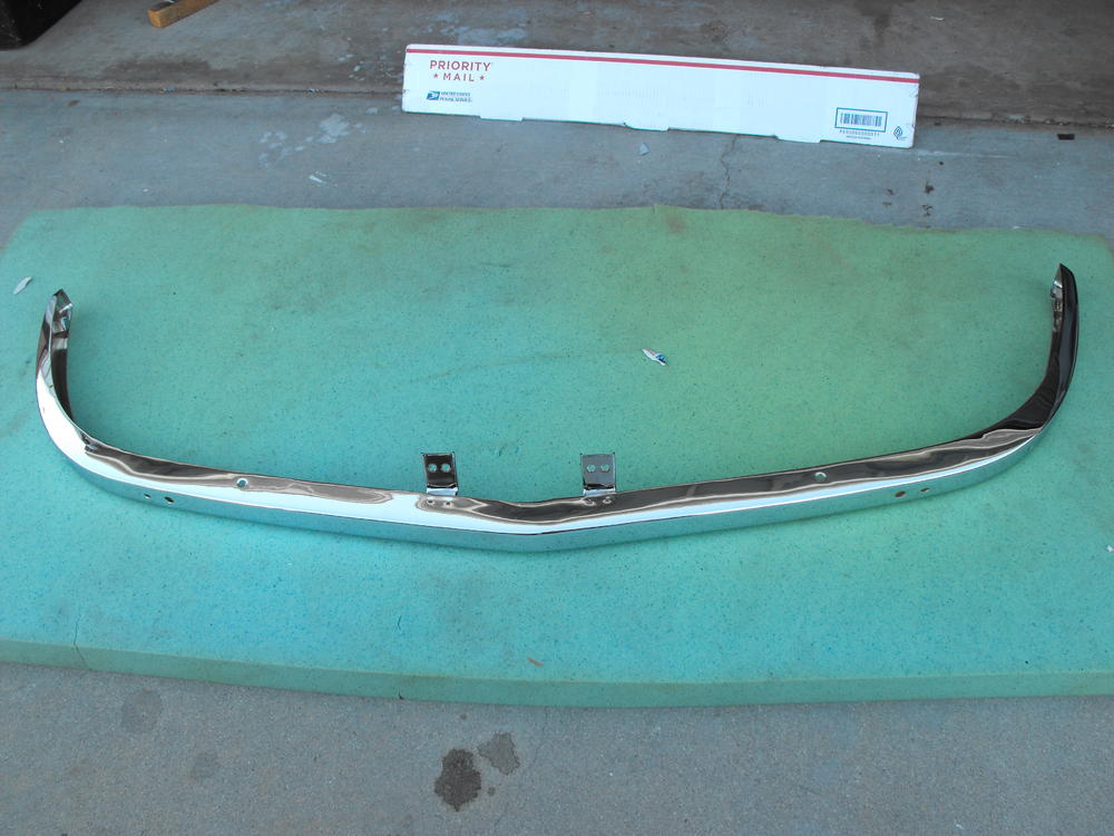

I was checking over the new chromed bumpers and noticed a very light surface rust on the inside (which of course really bugged me!) So I passivated the rust using phosphoric acid (rust turns dark when rinsed with phosphoric acid: converts iron oxide,rust, to ferric phosphate, second pic) , wiped clean and then painted with Silver POR-20.  That should remedy the rust.  It is pretty much a non-visible area so I just applied the paint to prevent the rust.  I am told that most chrome shops recommend that the inside of the bumpers be painted so this should work well.
