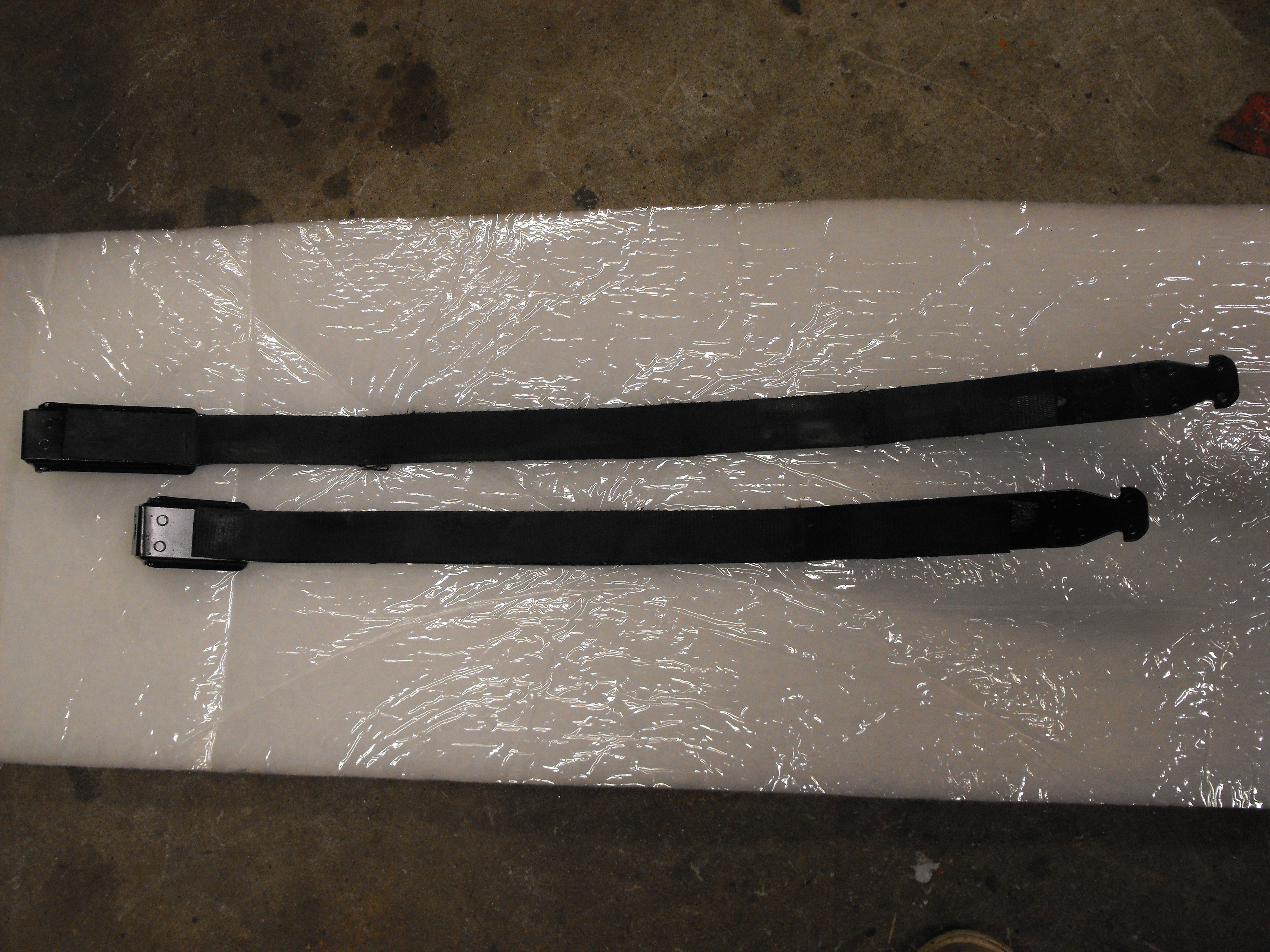

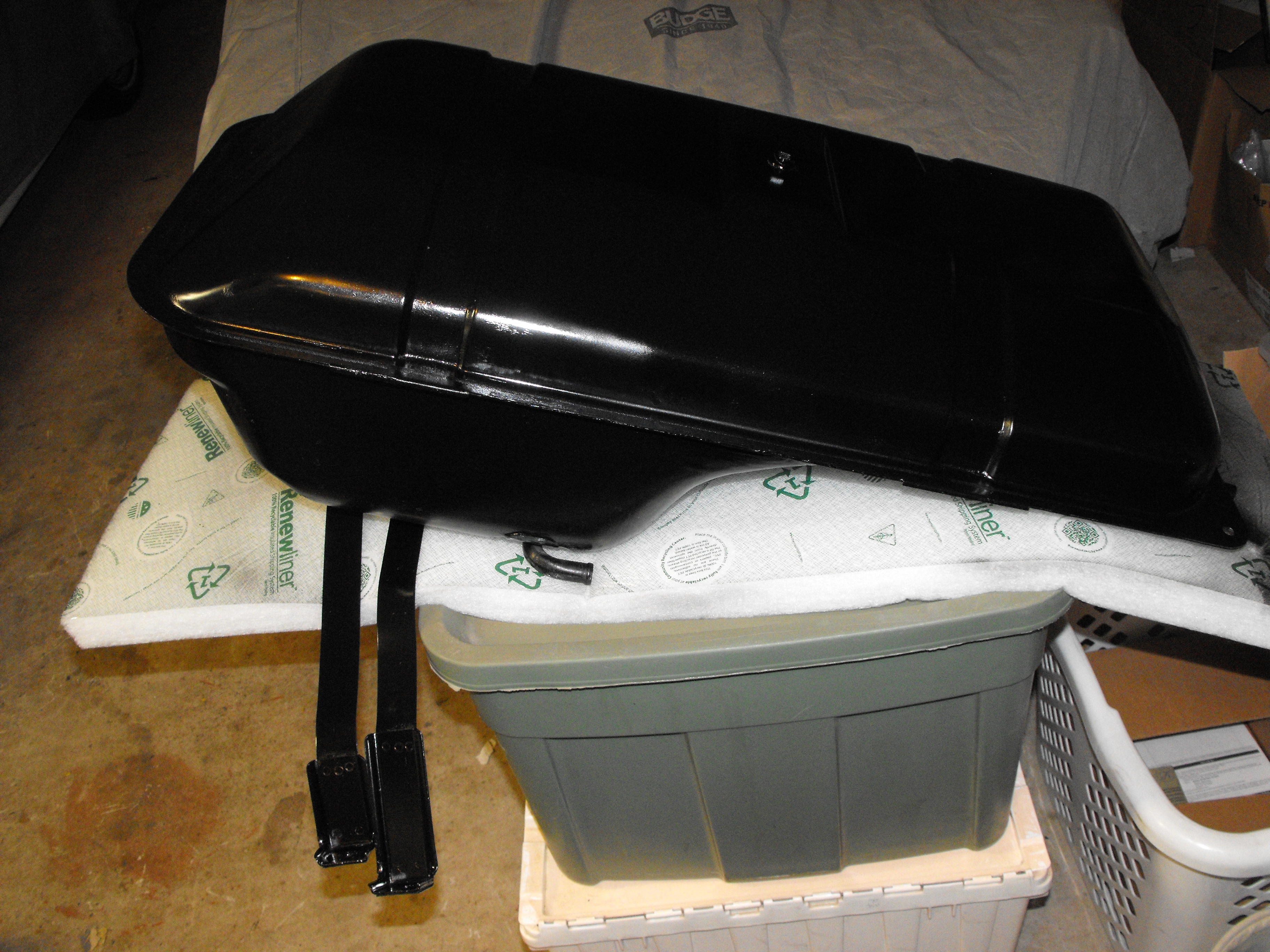

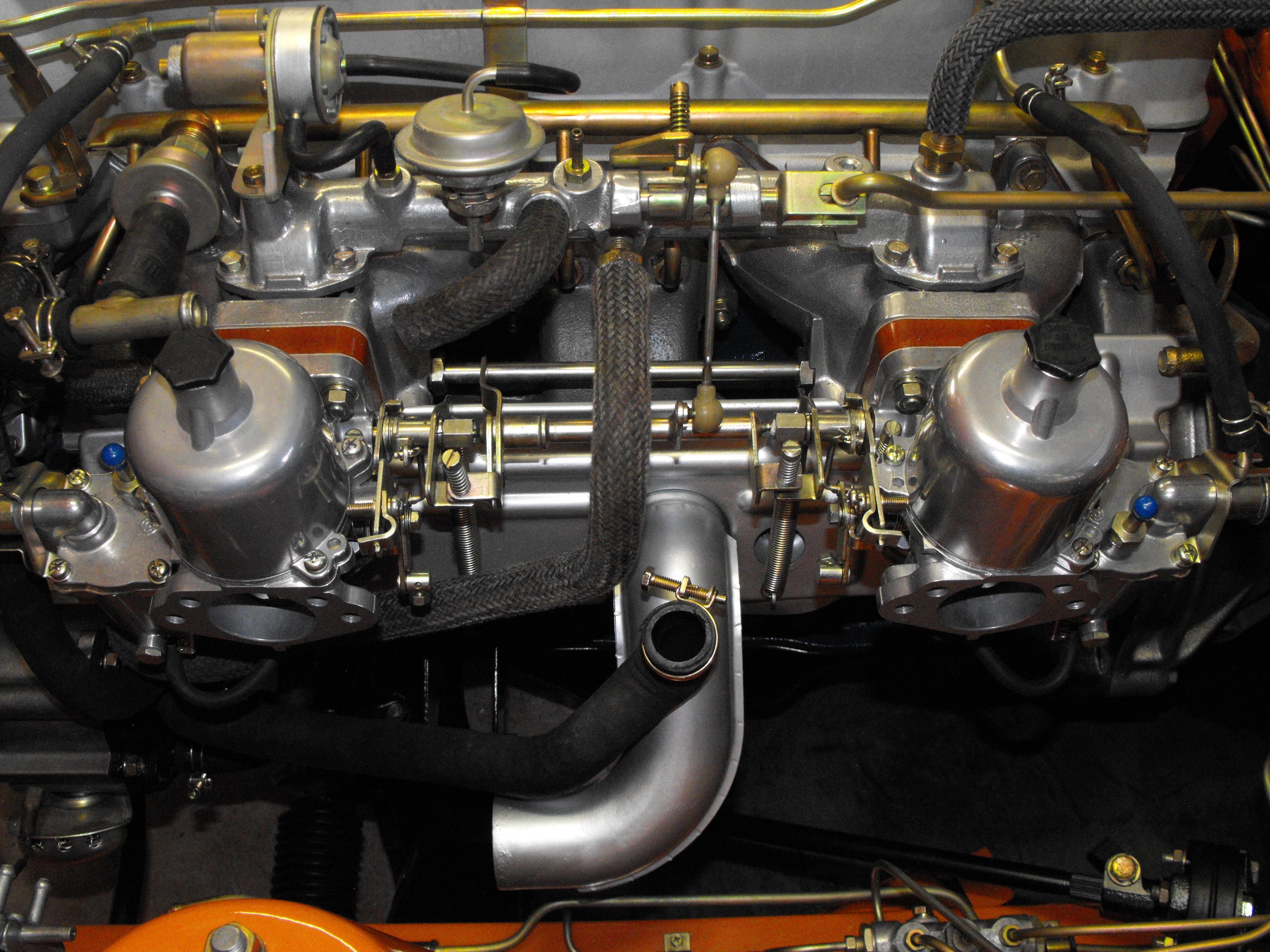

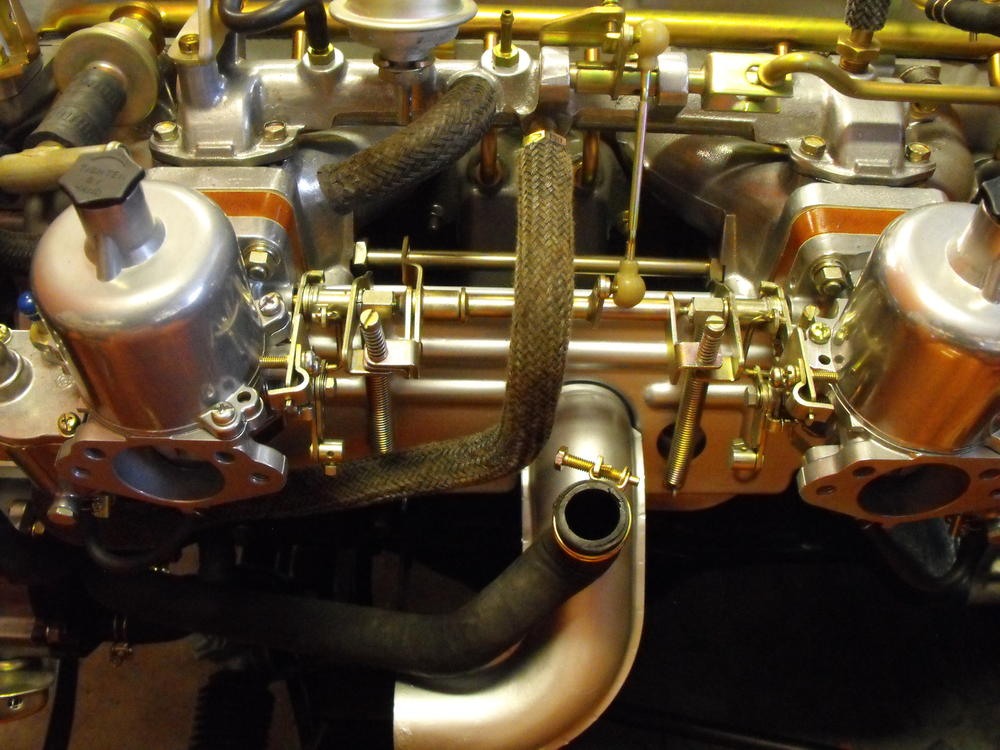

November 13, 20177 yr Author comment_534707 I got the Heat shield and Exhaust Manifold Air Warmer duct (not sure what the exact name is) cleaned and painted with high temp aluminum paint. Also got the fuel tank straps cleaned and painted and the tank finished. I should have the tank installed tomorrow. Just a few pics below. And I ran a half marathon this AM. Finished in 1:52:05. That is about 8:33 average per mile and my best ever half marathon time. Not bad for a 56 year old man. Link to comment https://www.classiczcars.com/forums/topic/56833-deja-vu-1971-restoration/?&page=29#findComment-534707 Share on other sites More sharing options...

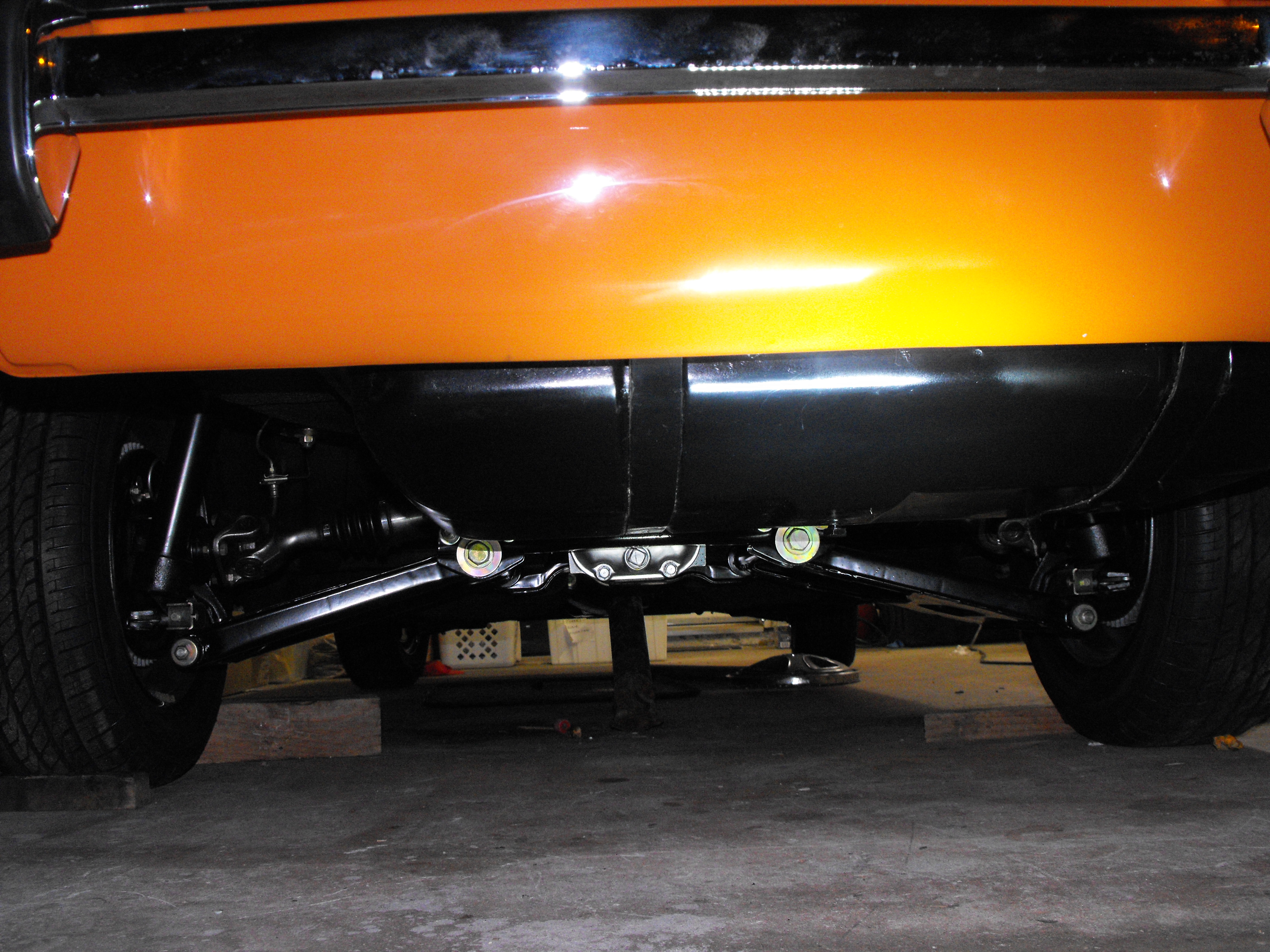

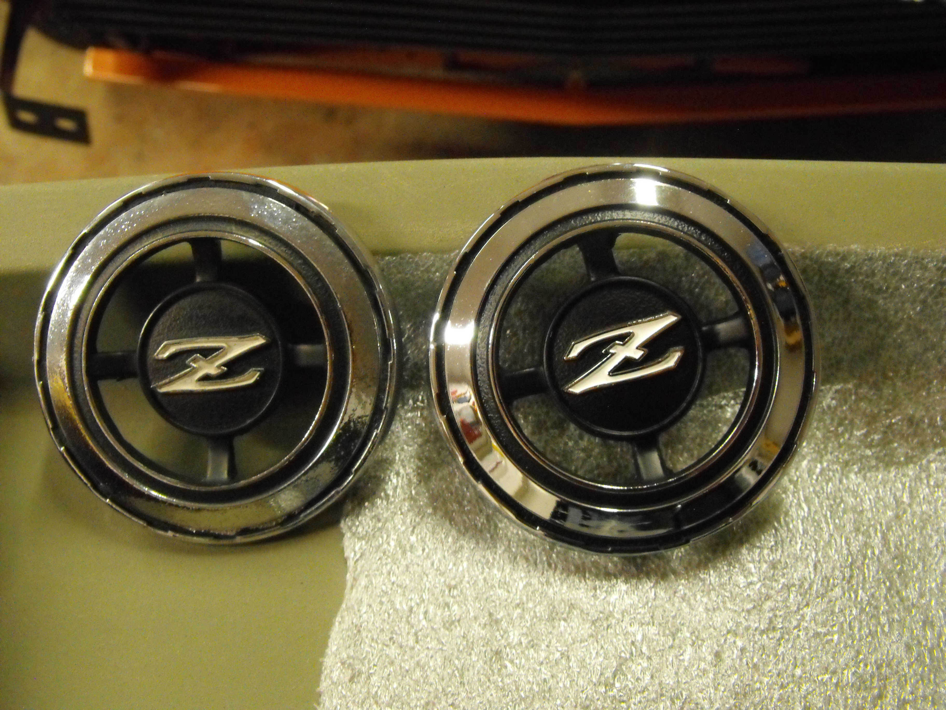

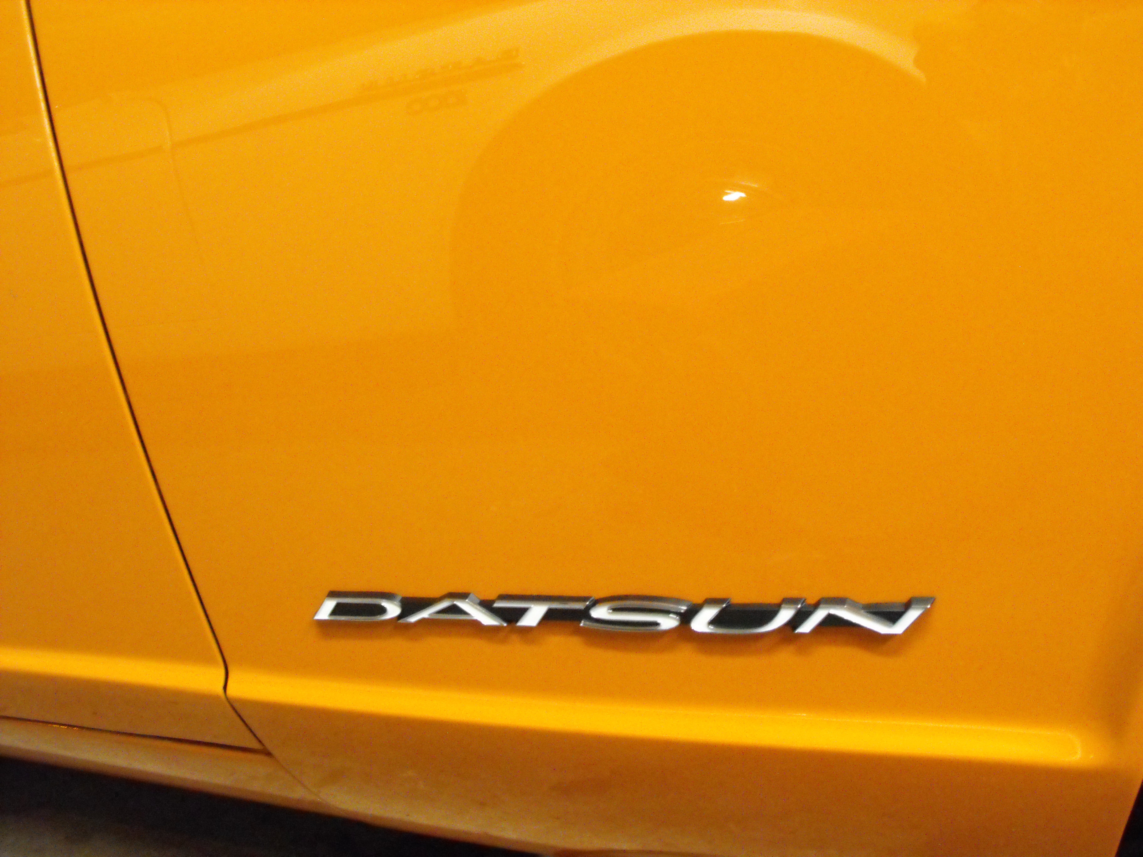

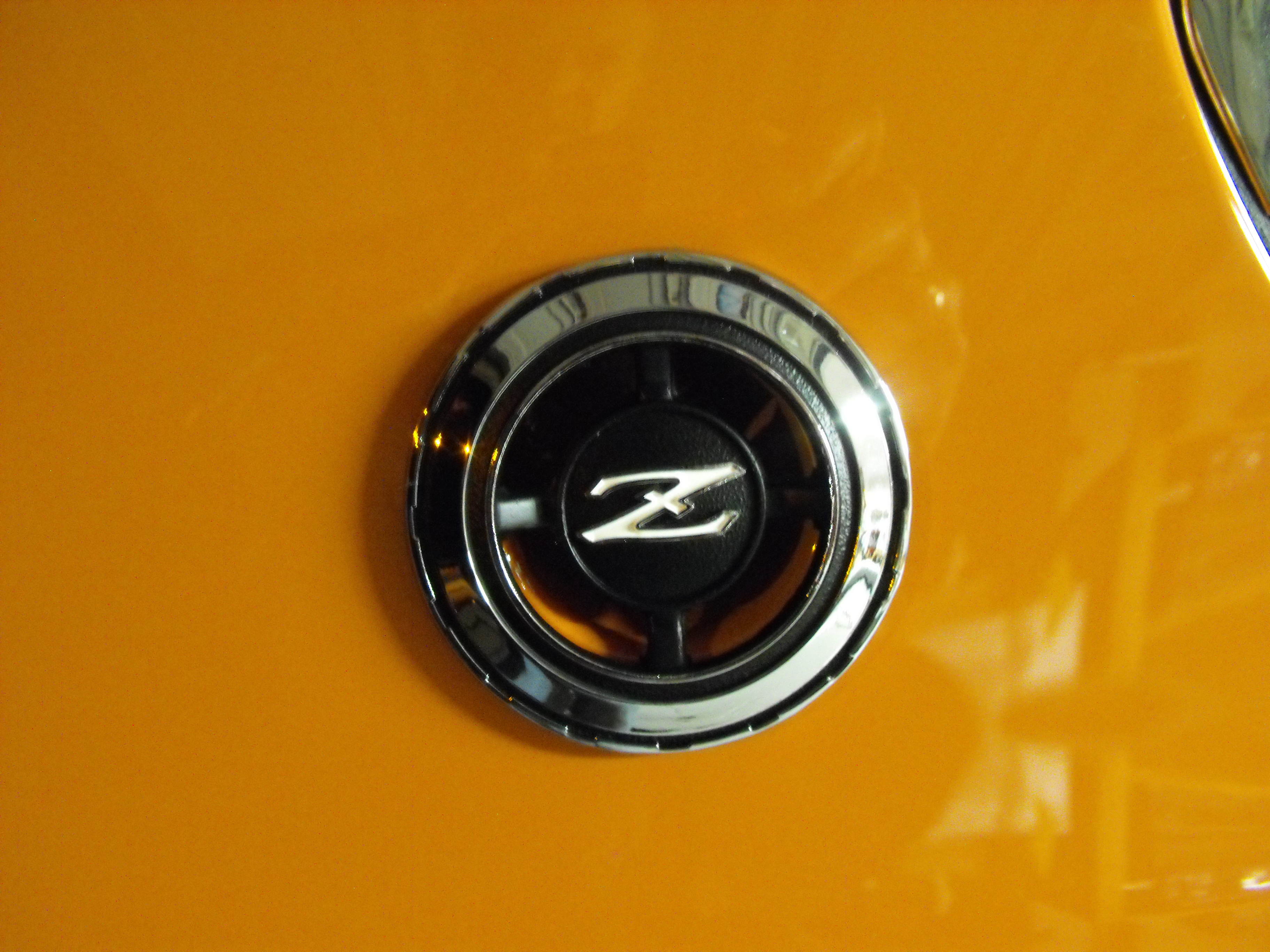

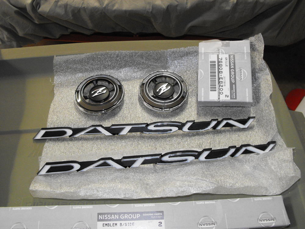

November 14, 20177 yr Author comment_534814 Got the new emblems in so I put those on. Very pretty . The old ones were a pitted as you can see in the one pic. They look nice with the fresh paint. Cleaned up the tank straps and put the cleaned up rubber material on them. Then installed the tank. Nice to have that in. ( I really hate this camera. It takes terrible flash pics. Although, it could be the bad photographer.) Edited November 14, 20177 yr by motorman7 Link to comment https://www.classiczcars.com/forums/topic/56833-deja-vu-1971-restoration/?&page=29#findComment-534814 Share on other sites More sharing options...

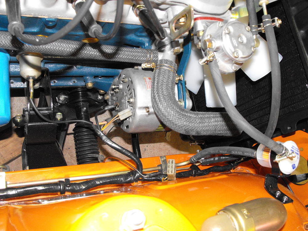

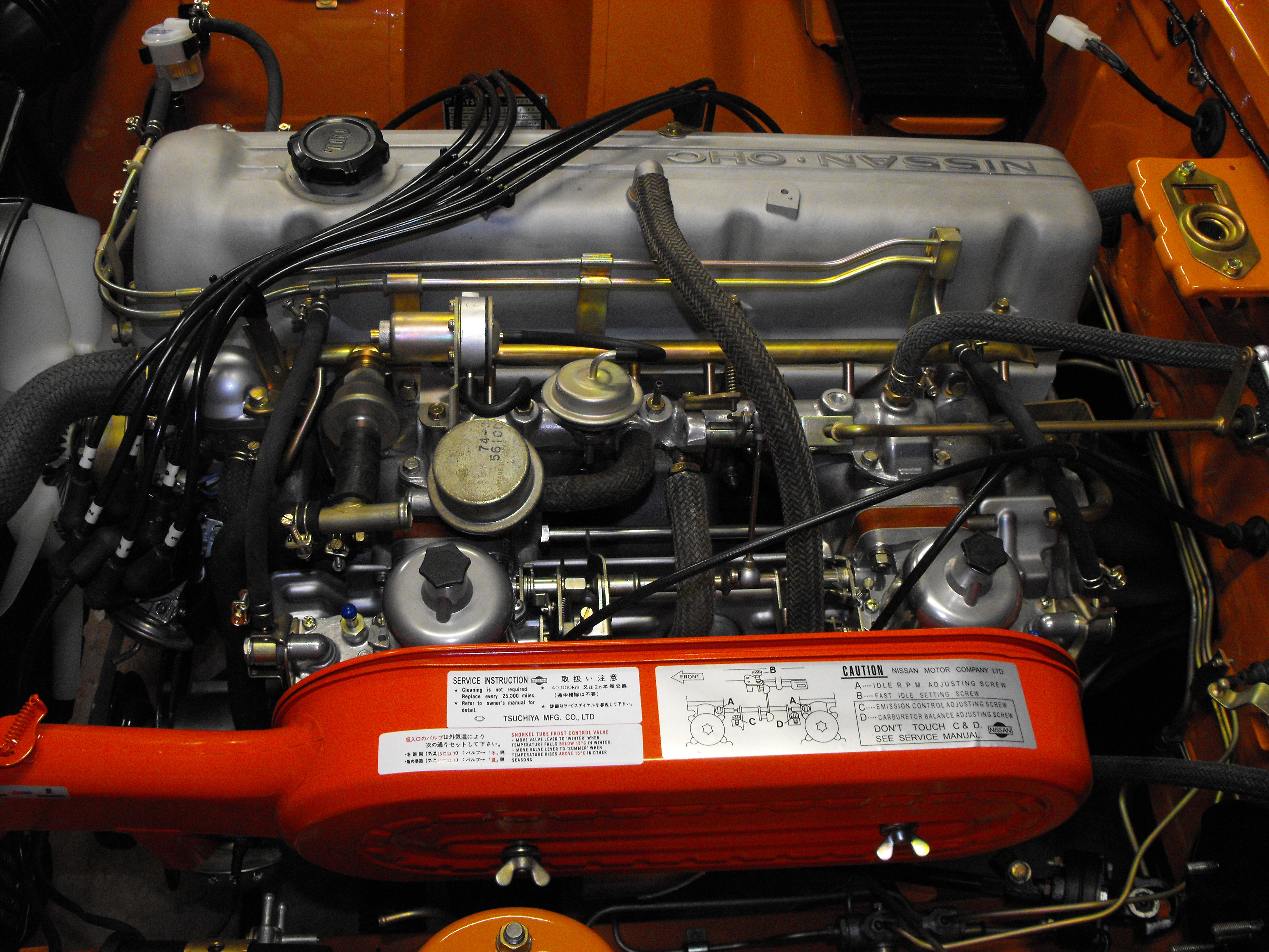

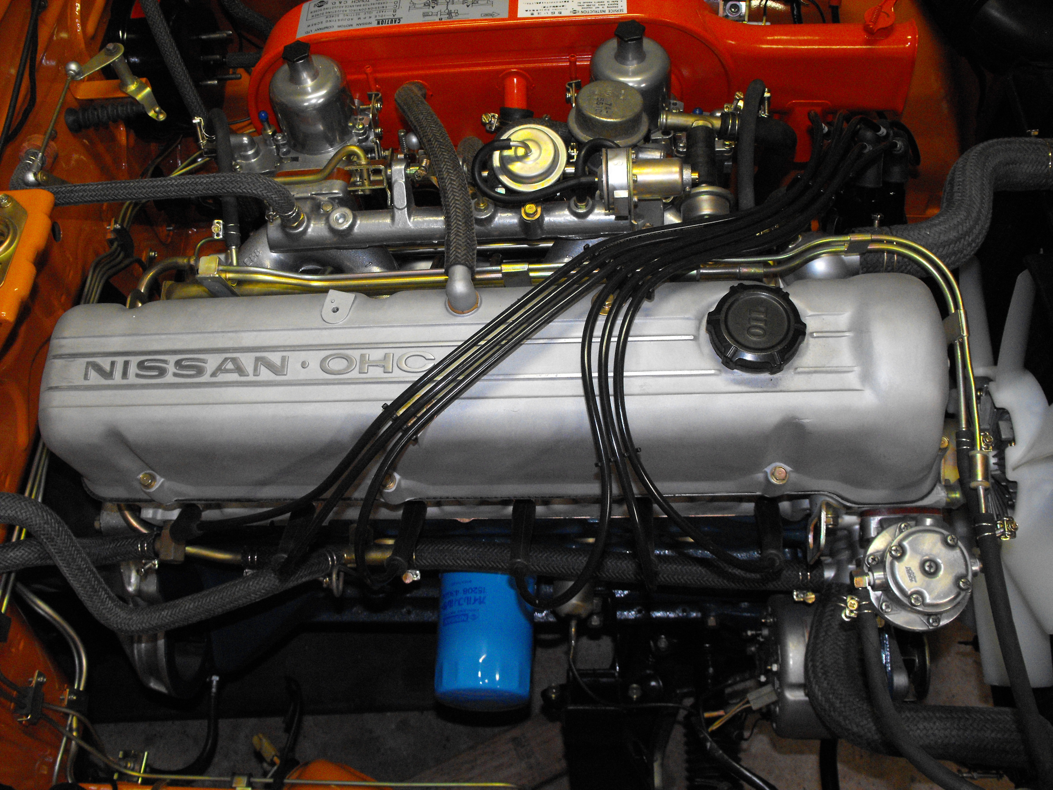

November 17, 20177 yr Author comment_535156 OK, I know your tired of the engine pics, but I got the new spark plug wires in and wanted to show them. Nissan wires are no longer available (several sights listed them but the orders were cancelled with product no longer available) , so I went with the premium Standard Motor Products wires because they were black, cut to correct length, and had the #6 plug with a slight angle. That is about as close to the original as I could find. I am not sure about the red cap on the coil, I do not think that is correct, but everything else is just about right. I also put in the choke cable and alternator. I will make the final connections after I replace the connectors. I should have the engine bay about finished this weekend. Link to comment https://www.classiczcars.com/forums/topic/56833-deja-vu-1971-restoration/?&page=29#findComment-535156 Share on other sites More sharing options...
November 17, 20177 yr comment_535164 Hi Rich--- Certainly NOT tired of the engine pics---beautiful work there! Not to worry about the red coil wire boot----I 'm pretty sure it would be correct. I purchased a NOS set of original Nissan plug wires years ago and it has the red boot. As installed on my 73 before I returned to the original flat tops---- I love your work and uncompromising attention to detail Sir! Your restoration of this car is reference material and the story should be moved by the Administrators to a spot in the "Knowledge Base" for safe-keeping. @Mike Link to comment https://www.classiczcars.com/forums/topic/56833-deja-vu-1971-restoration/?&page=29#findComment-535164 Share on other sites More sharing options...
