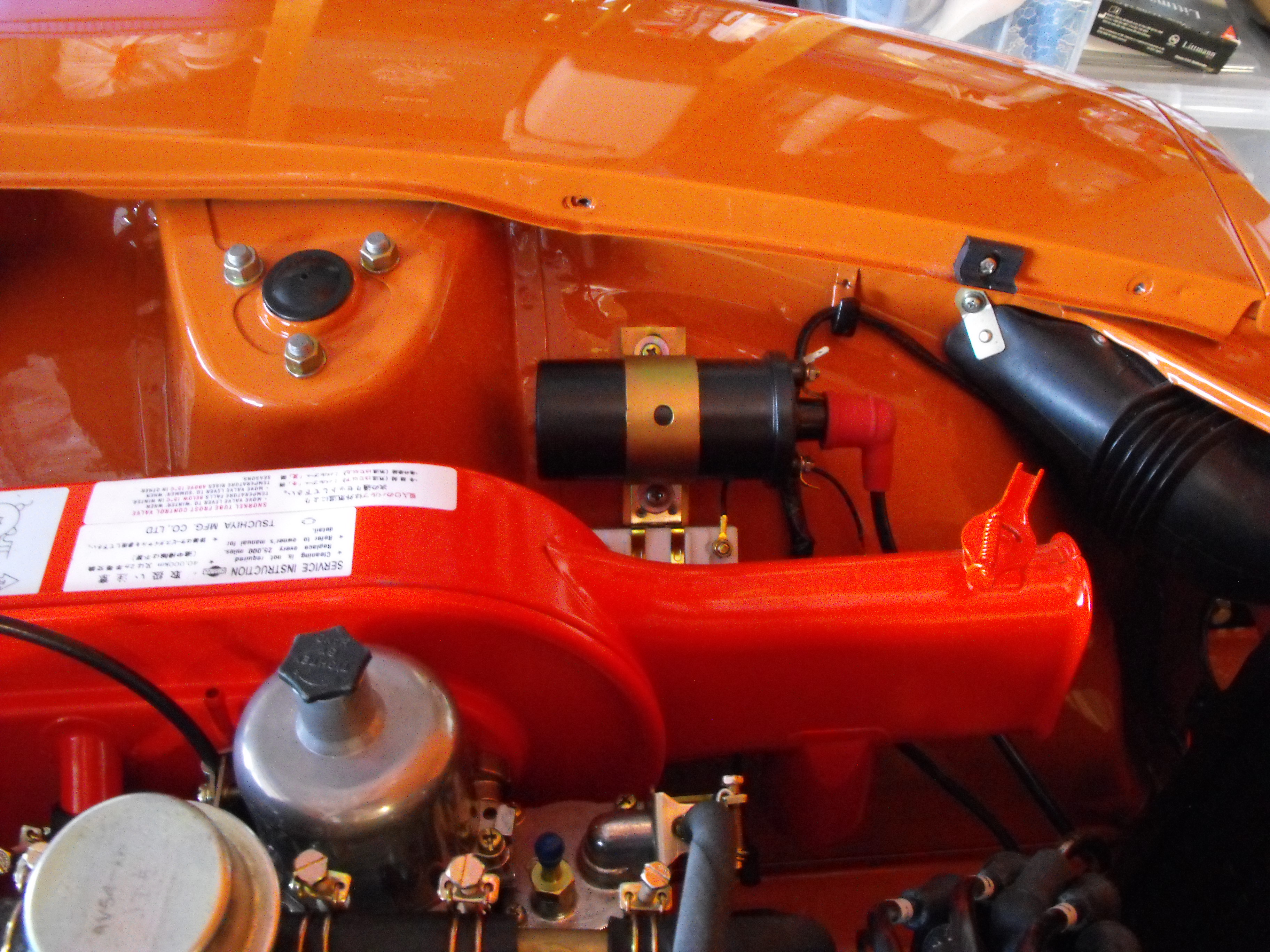

3 hours ago, Zup said:
Not to worry about the red coil wire boot----I 'm pretty sure it would be correct.
I purchased a NOS set of original Nissan plug wires years ago and it has the red boot.

Thanks for the feedback on the coil wire boot.  I was not really sure on that one.

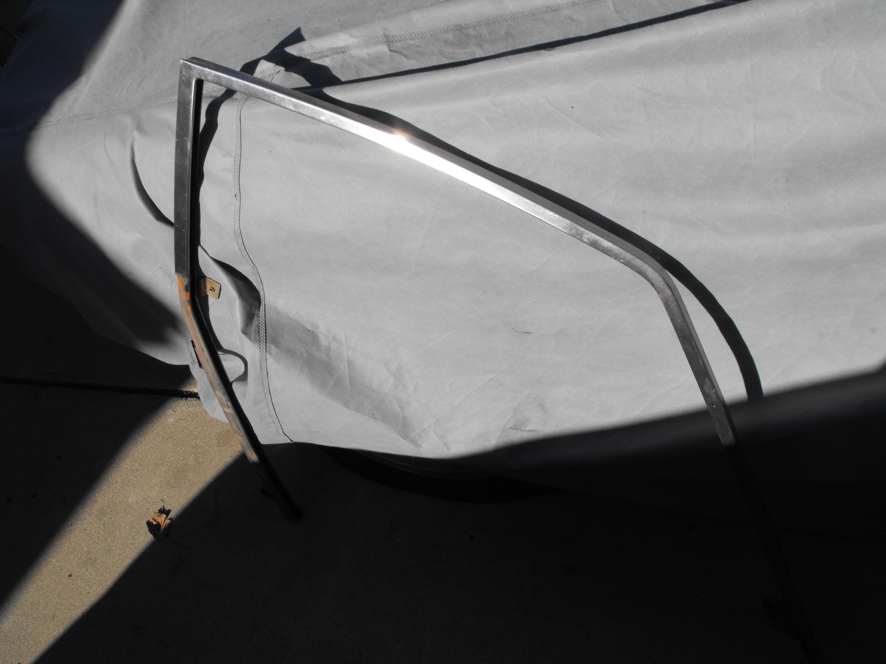

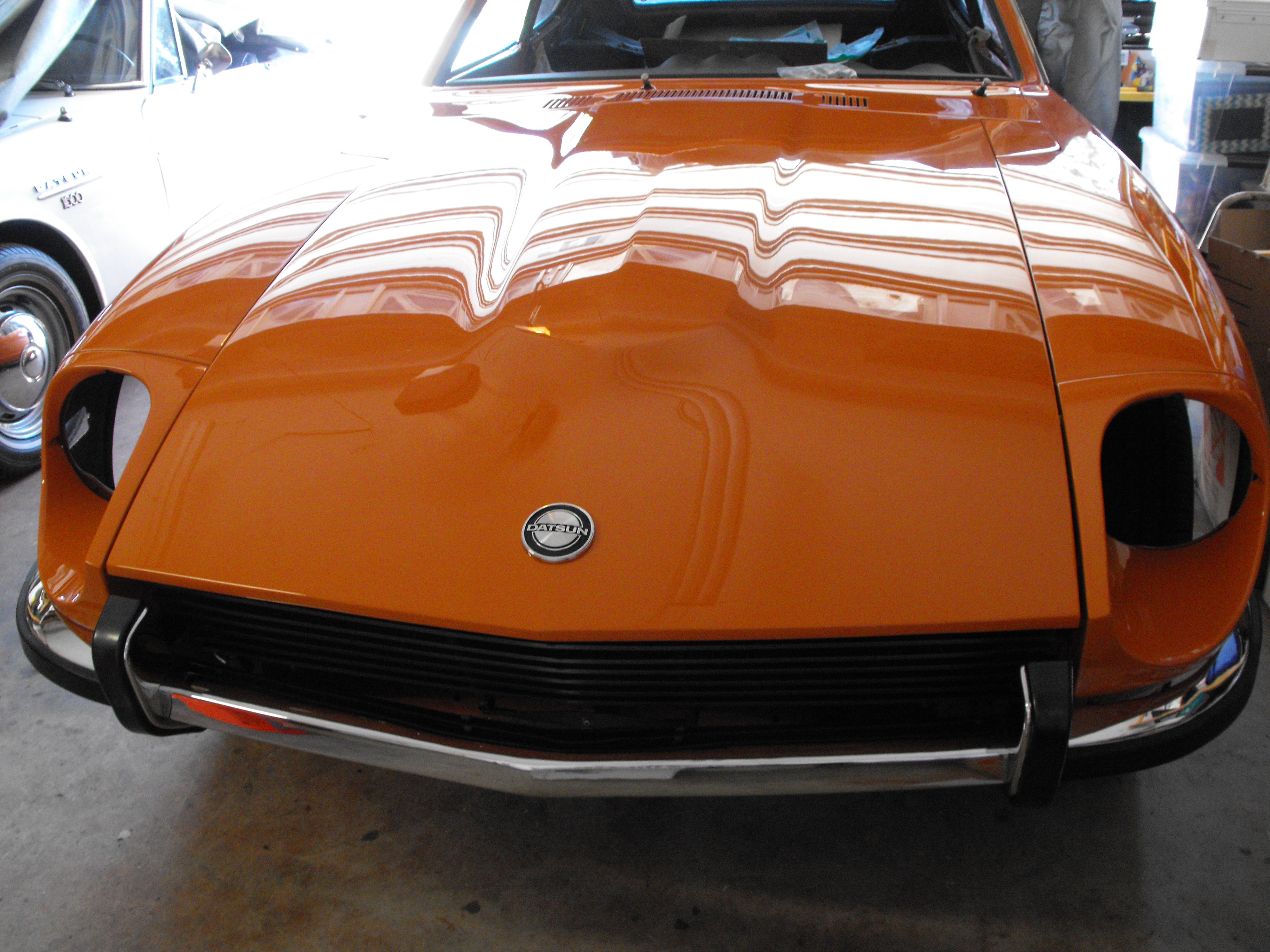

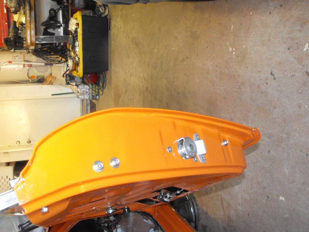

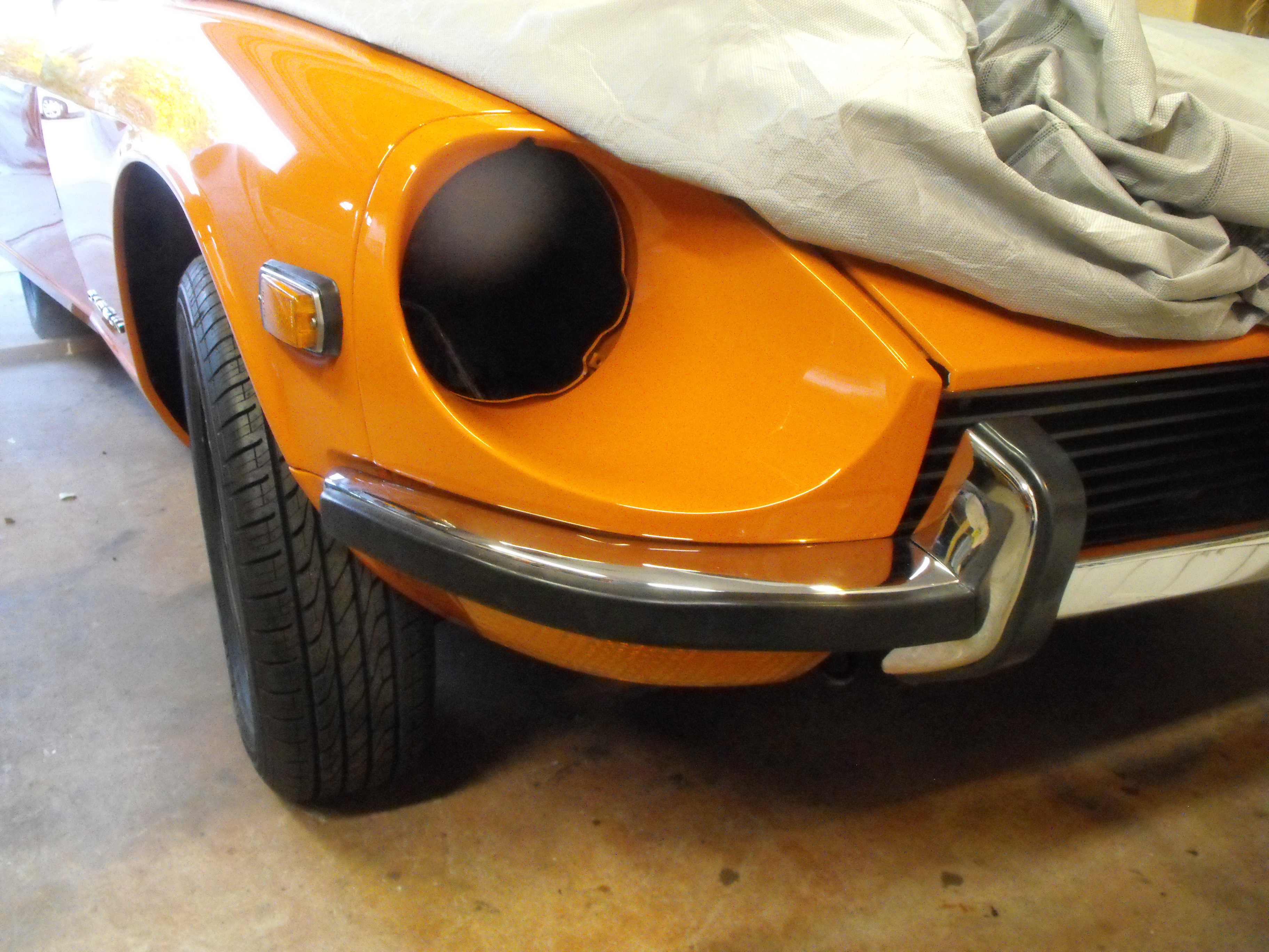

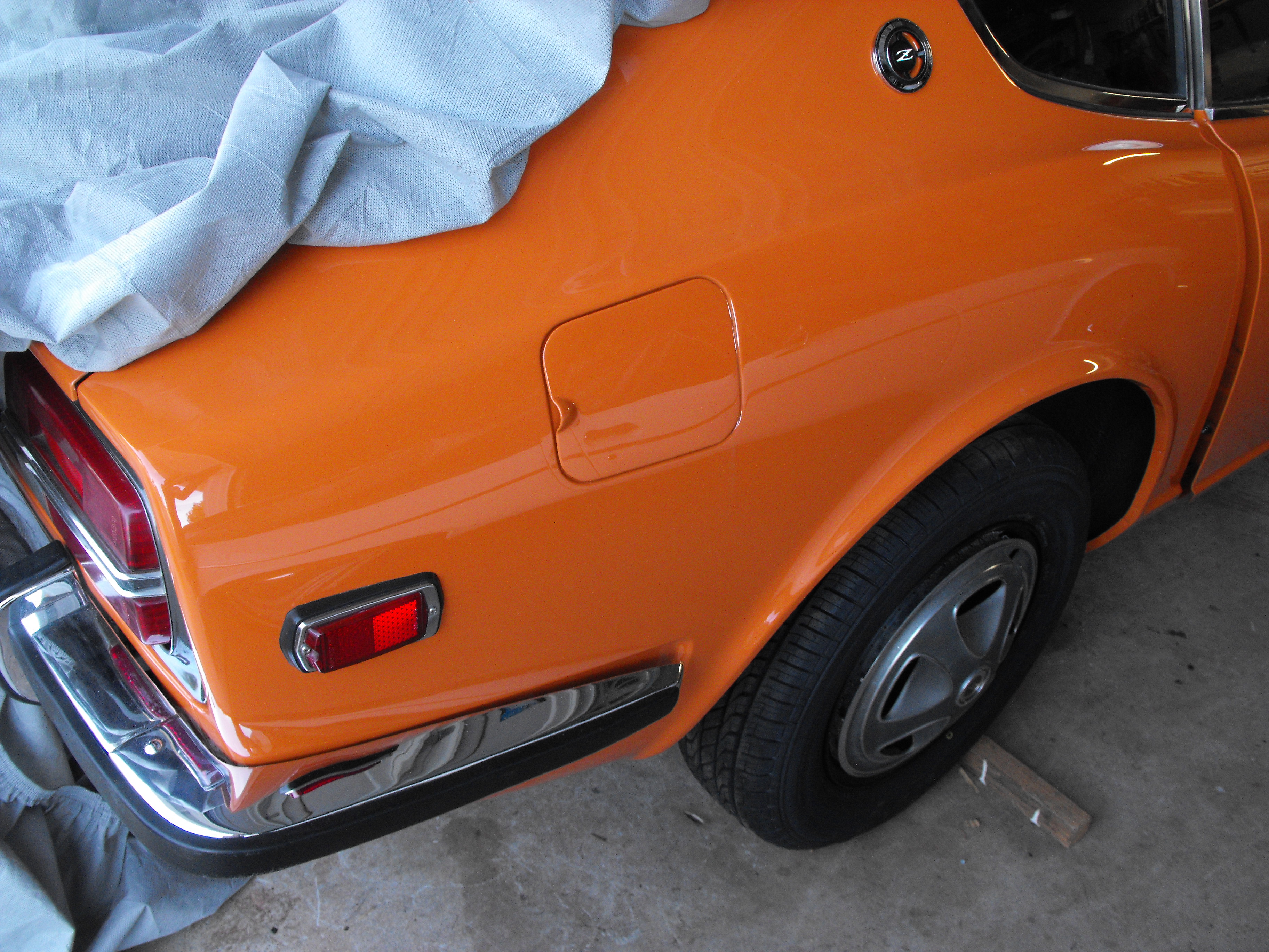

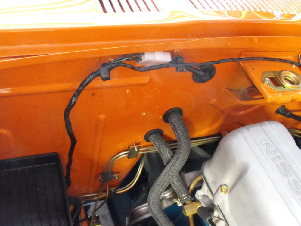

Thanks for the support everyone.  it really is pretty fun putting it all together.    Got a lot done yesterday and today.  Got the door window frames cleaned, polished and installed.  Replaced some of the connector housings, got the rest of the smog lines in.  Got the headlight buckets on (will probably revisit those, gap is a bit wide.  Thinking I may shim the inside lip.)  Got the fuel door on. Also, here is a pic of the red coil cap

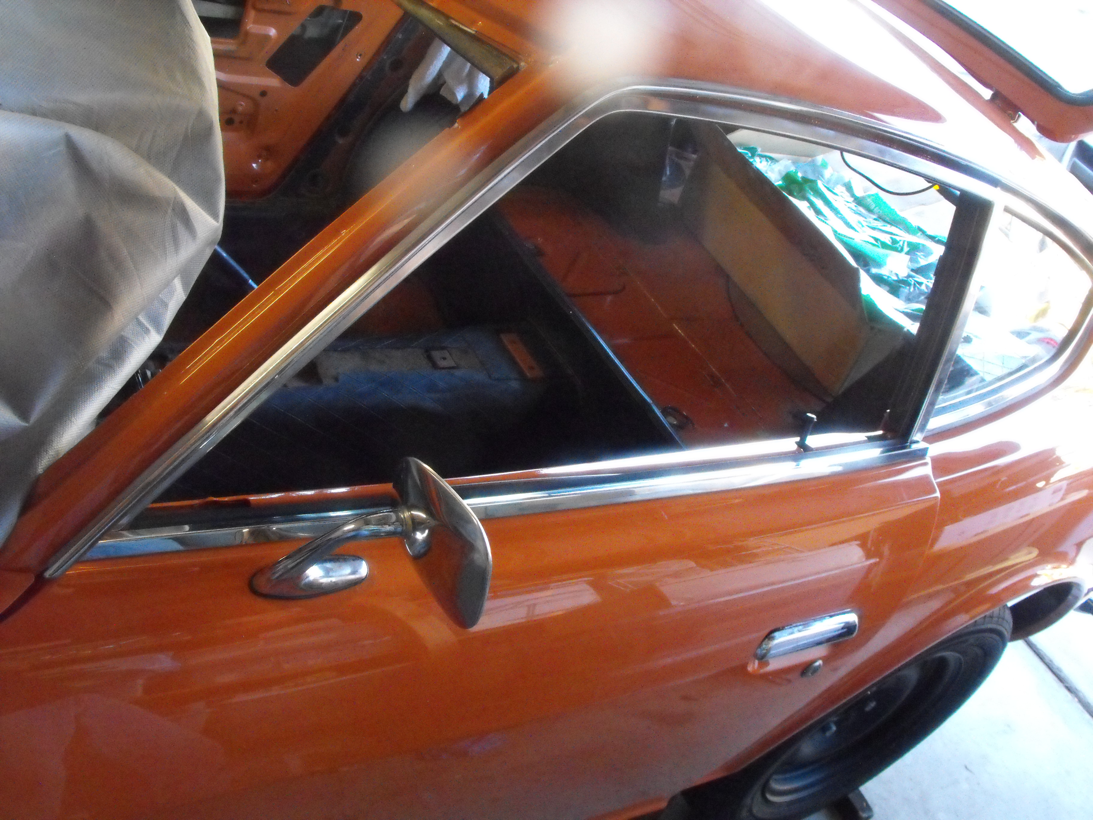

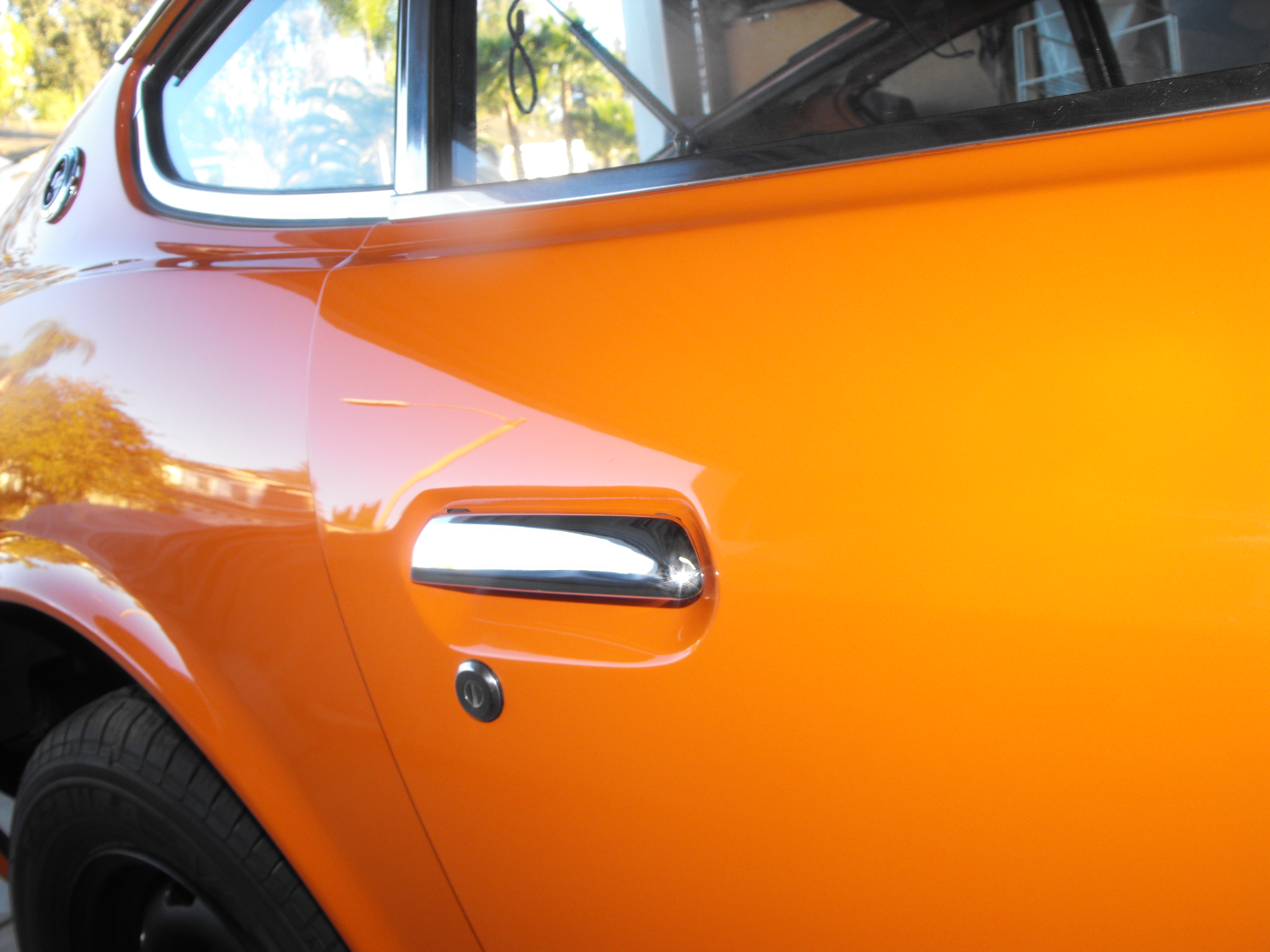

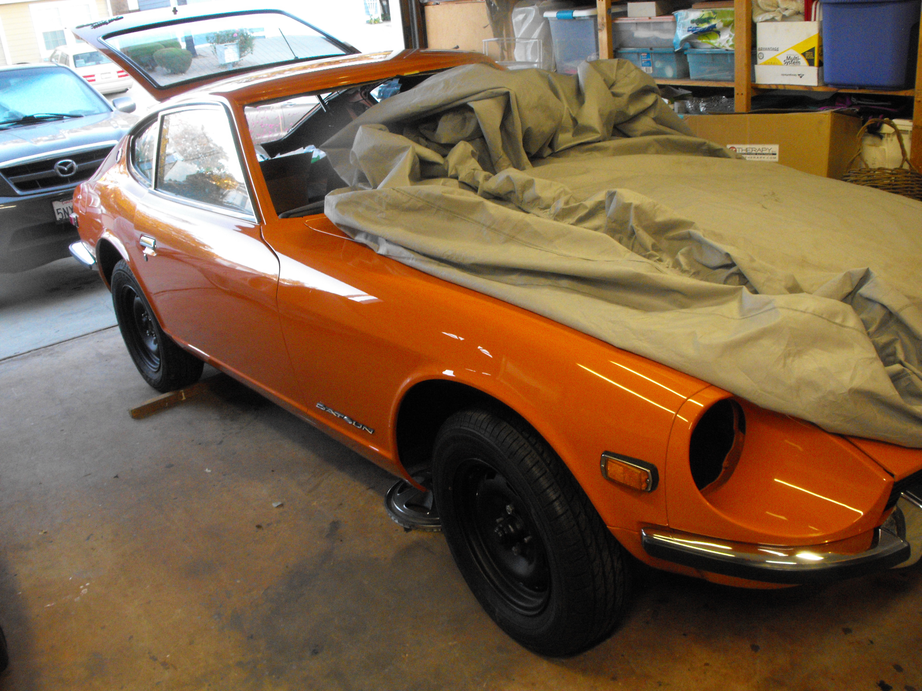

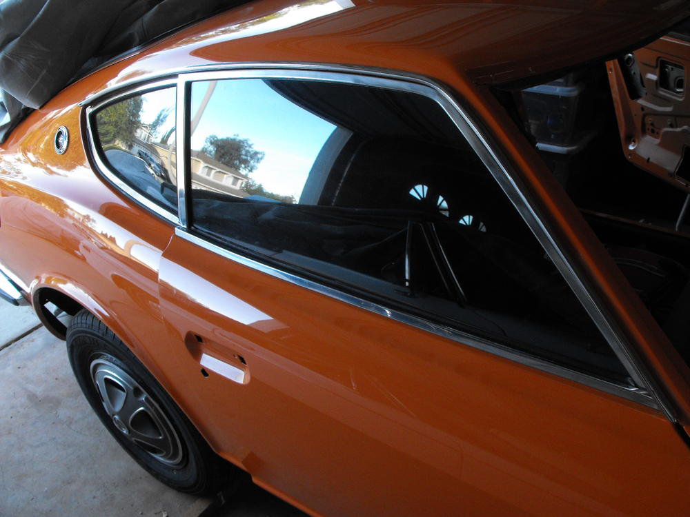

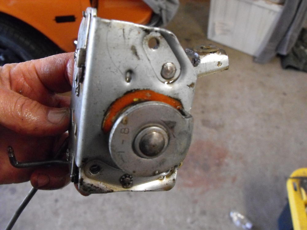

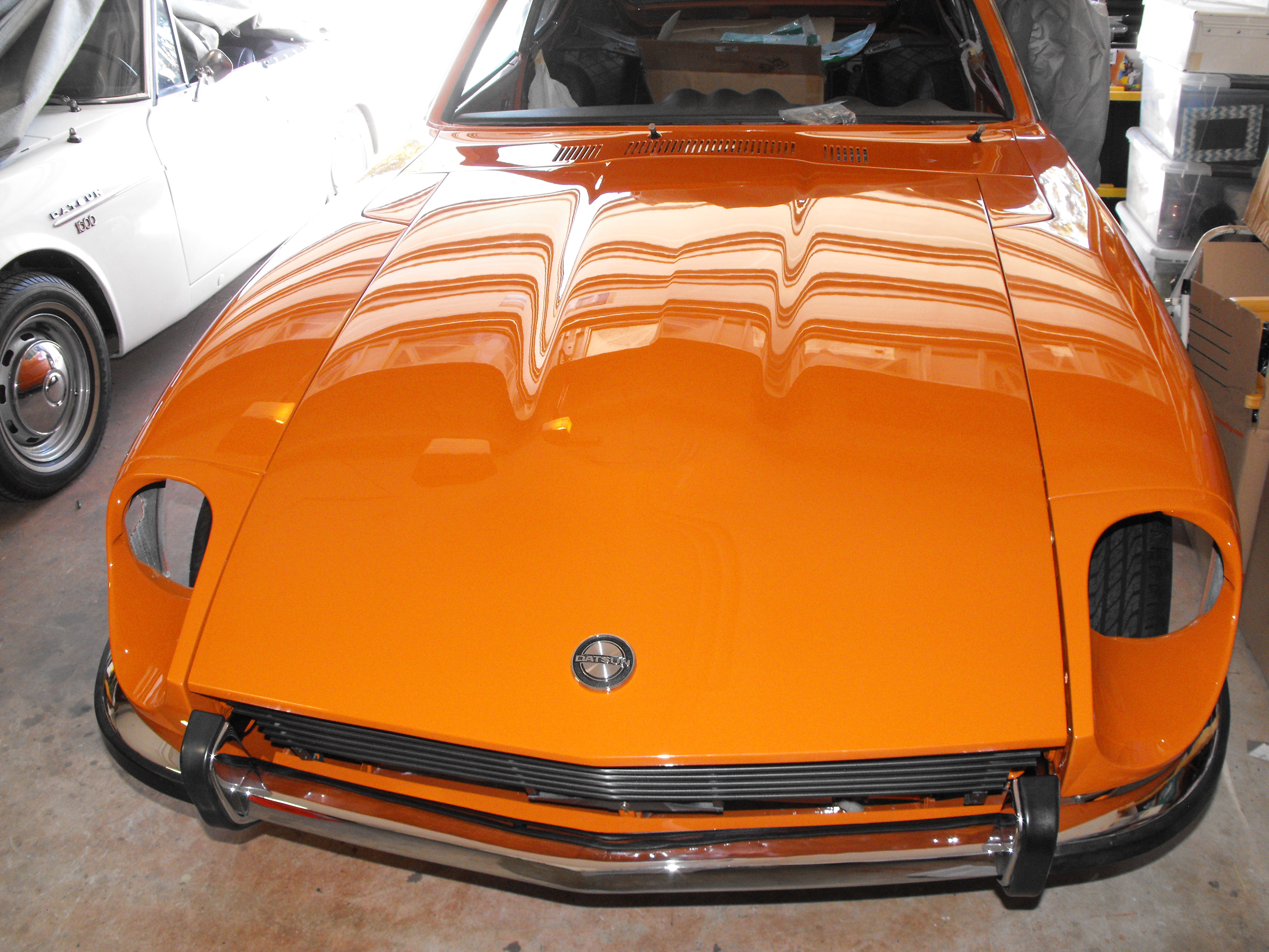

I got the door mechanisms cleaned up and installed.  Got the door handles, locks, inside handles all cleaned, installed and working nicely.  Had to clean up some over spray from previous paint job.  Also got the drivers side mirror buffed out and installed (That was tricky).  Got the front turn signals and lights cleaned up and installed.
Also got a new pair of OEM windshield wiper supports.  The wipers on the car as received were not stock. The OEM design of the  wipers is a work of art and a must have.
I am about ready to put in the headlights, but would like to put in the original Koito brand lights.  I have one and think I can probably get a second one from @Montezuma or Les.  I think that would be a nice touch.
A few pics are below.

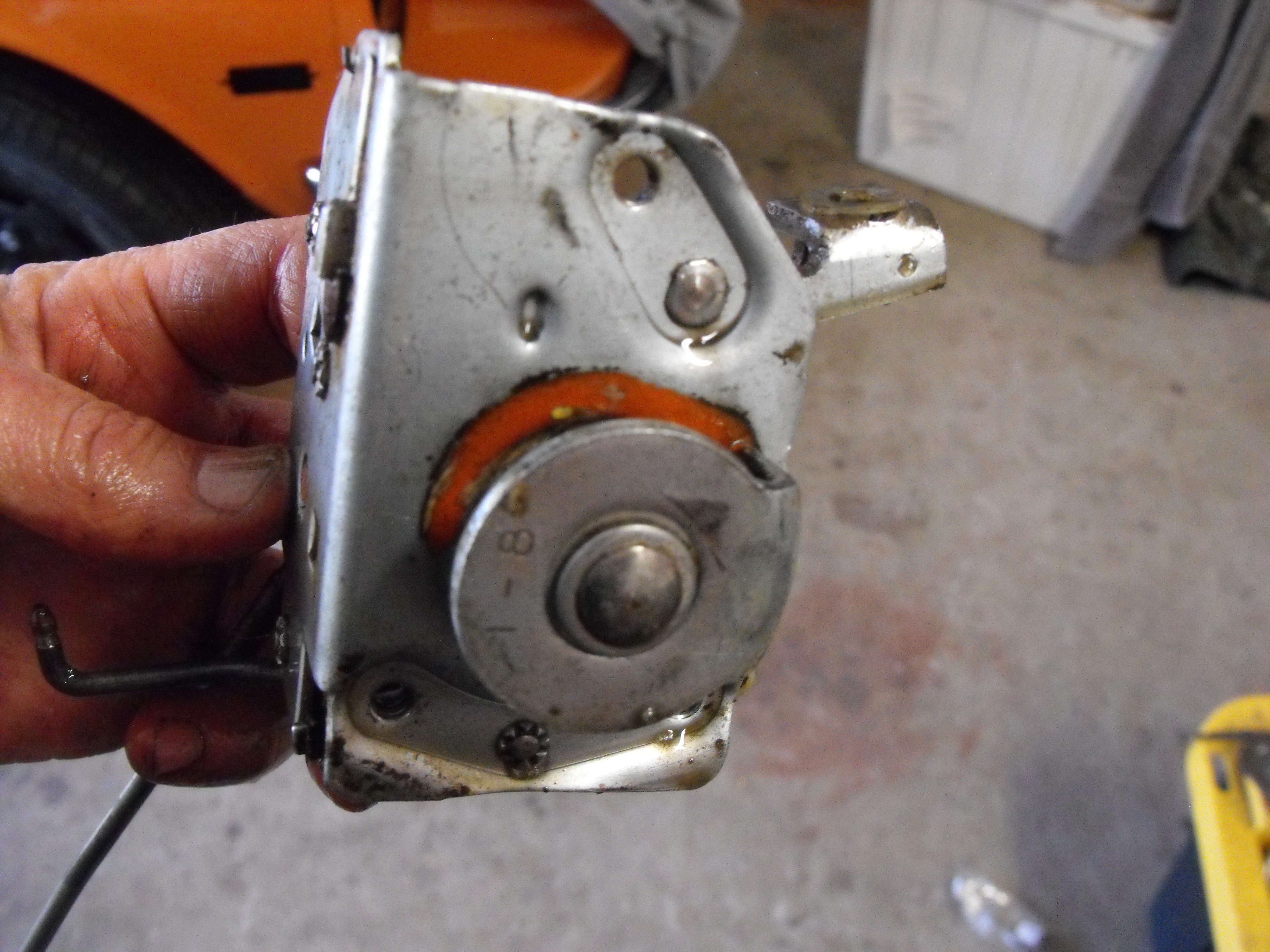

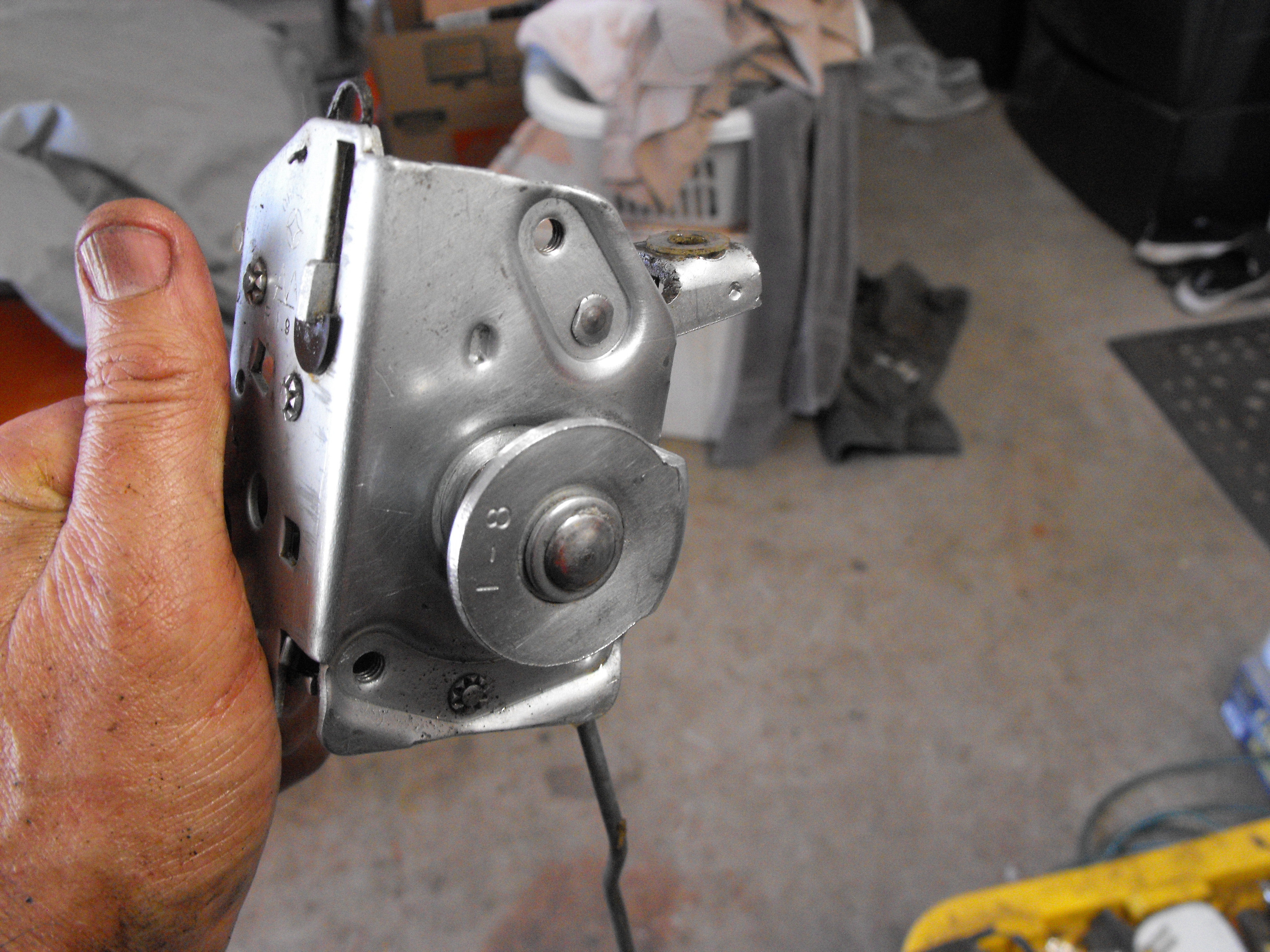

8 hours ago, Patcon said:
What technique did you use to clean the lockset? It turned out good...
I soaked them in paint thinner and used a soft wire brush to remove the over spray.  Used a parts brush to clean into the crevices on the mechanism side.  Finished the visible portion, where needed, with steel wool, trying to minimize the removal of the zinc coating.  Both sides came out pretty nice.
