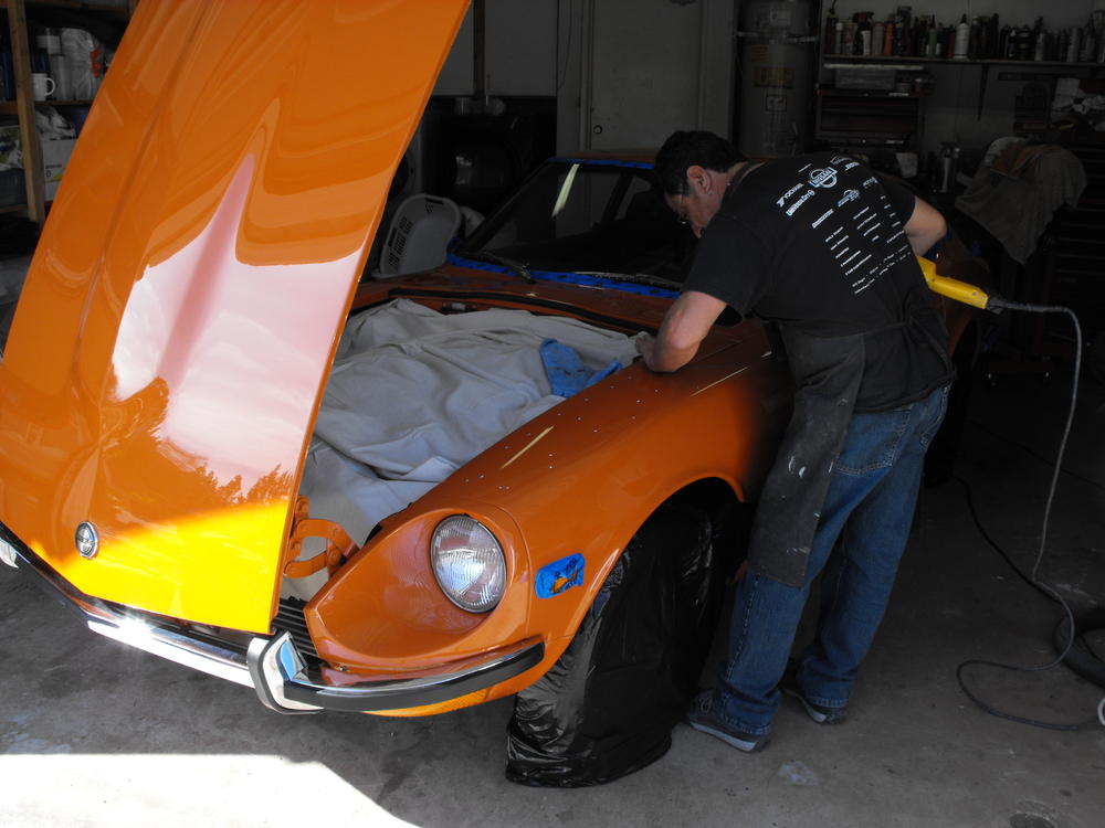

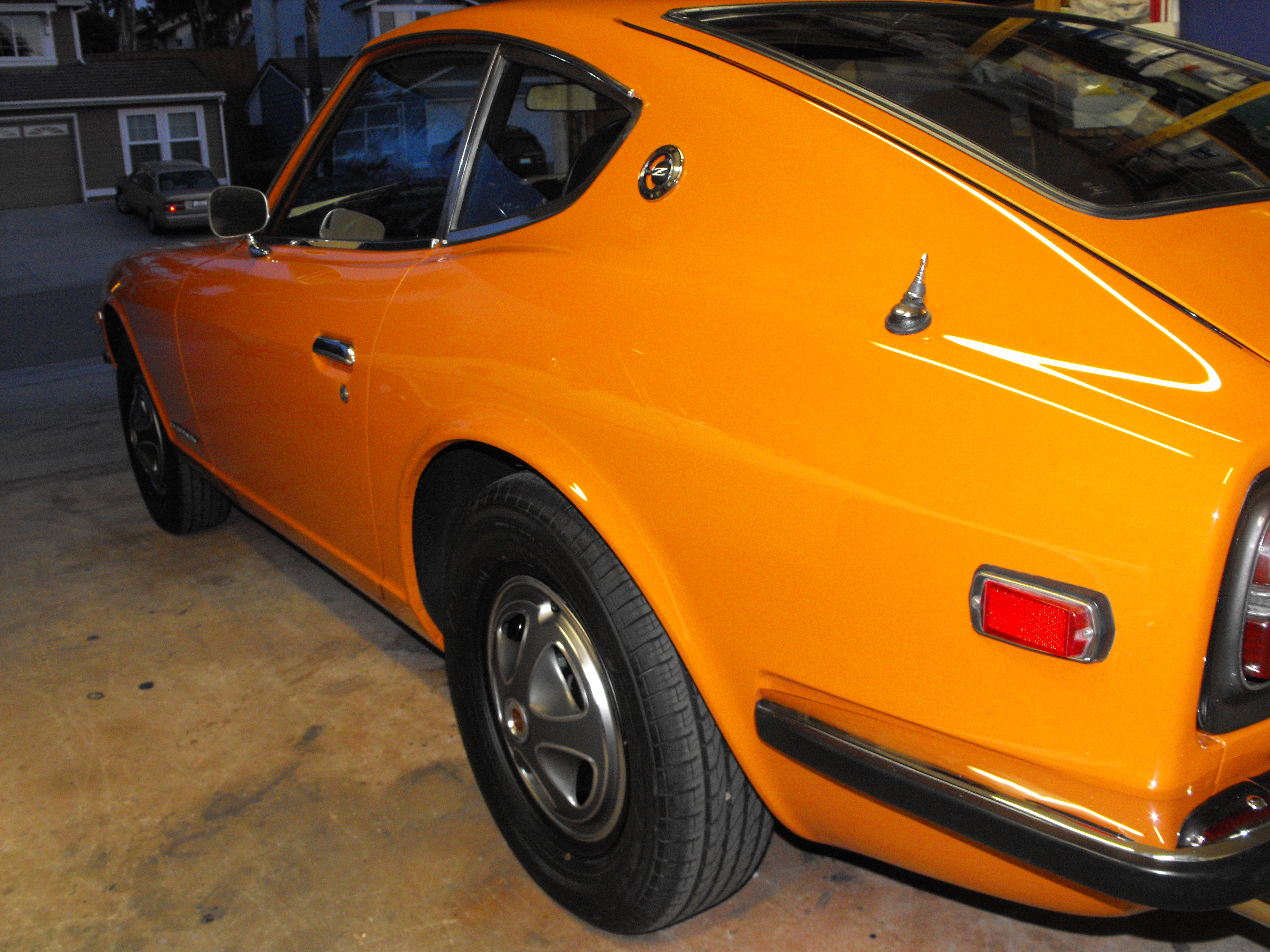

Well, things are getting close to the end here.  Still waiting on a few parts to come in and the revised center section of the exhaust to be completed then she will be about ready to go.  Miguel came over today and did the final polish on the paint which actually looked pretty amazing before he even started.  After about 6 hours of polishing with three different compounds and pads, the paint is absolutely incredible.  Not a single scratch or swirl to be seen.  There are a couple pics below, but they do not do the paint justice.  I will have to wait for a nice sunny day and take some pics here to really show the quality of the paint job.

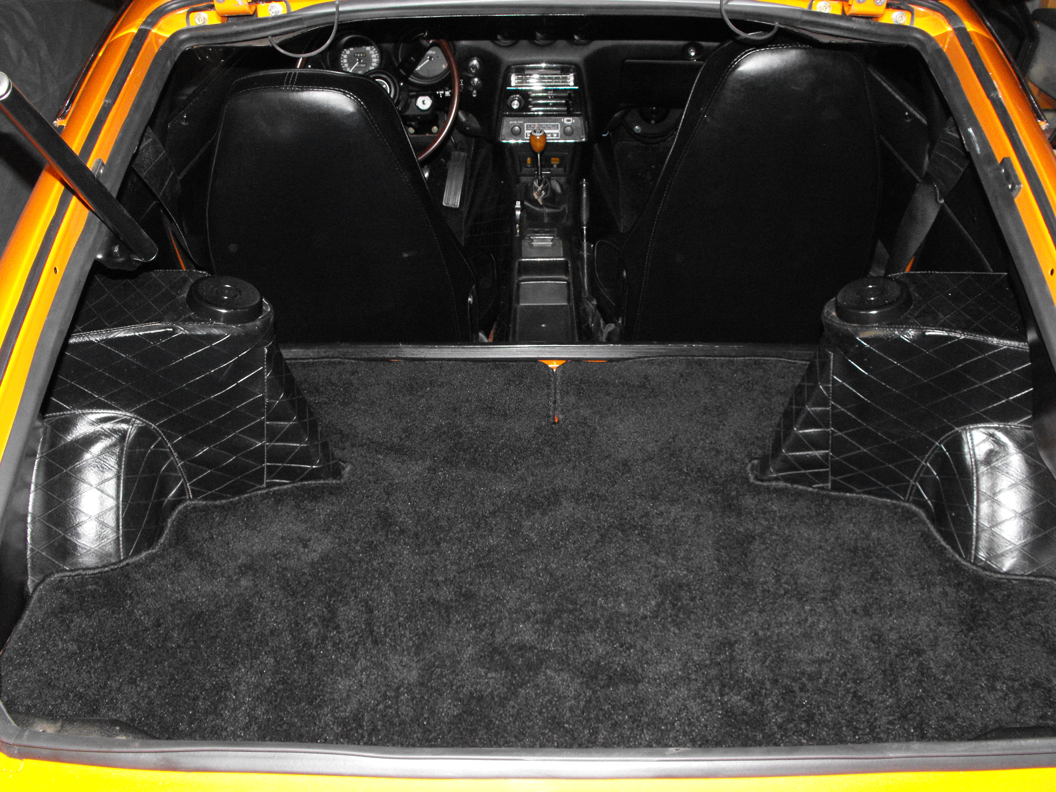

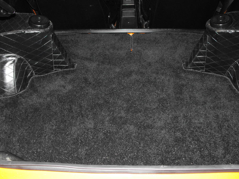

While Miguel was doing the polishing, I painted the rear carpet which really looks great.  I was a little skeptical of how it would look, but it really looks like new carpet. I should get the new luggage straps in from Jay in the next couple days to complete the back hatch area.  It should look great once these are in. Also got the hatch plugs coming in as well.

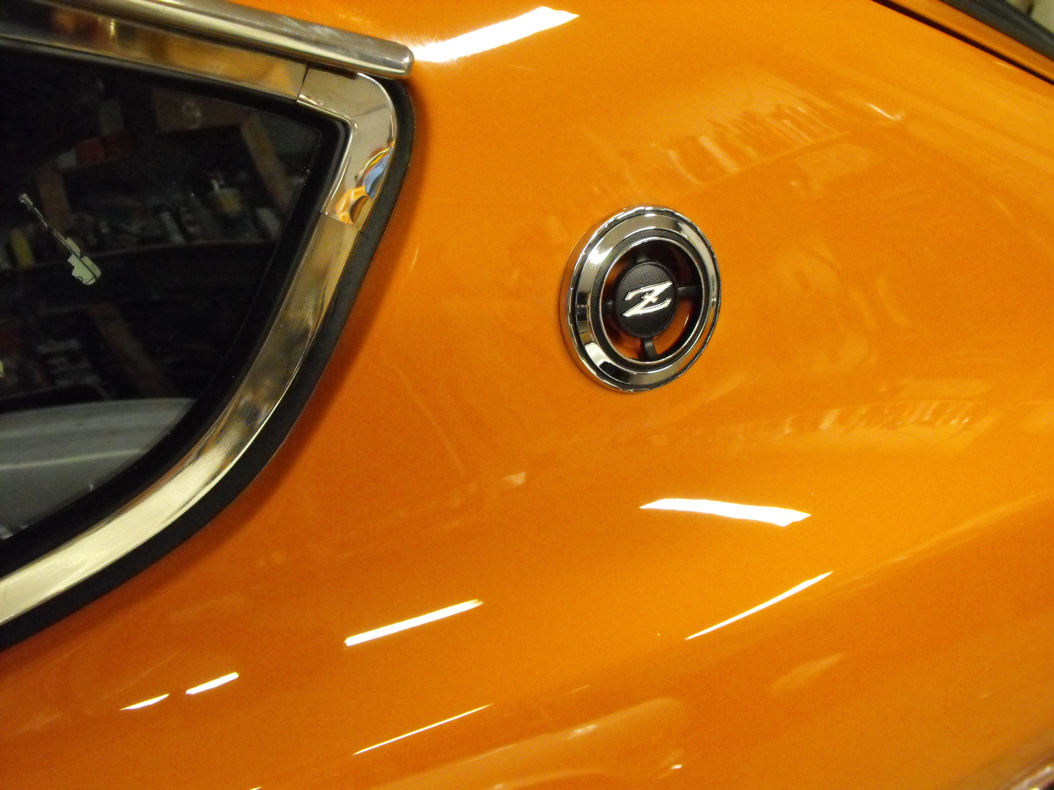

Got the horns refurbed and installed.  Also put in the final fender screws and touched those up with paint to match.
