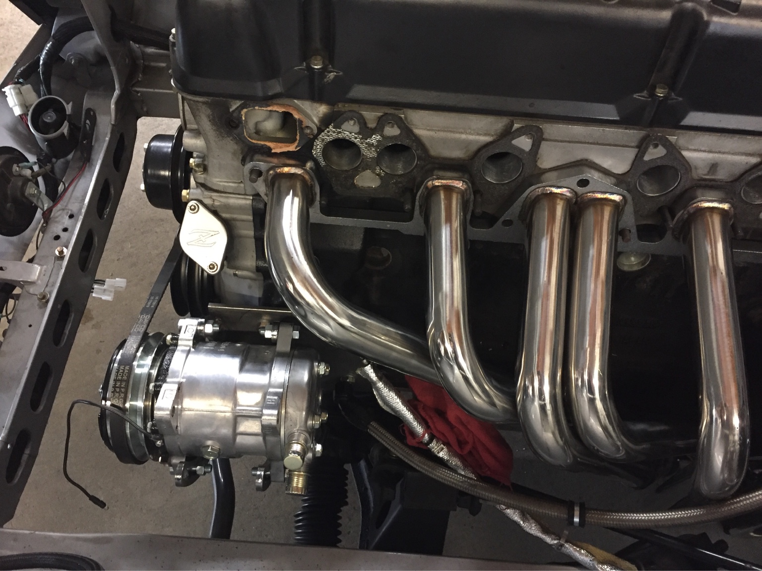

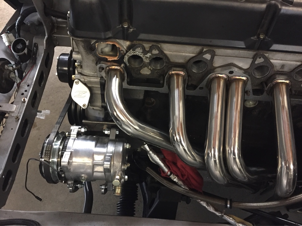

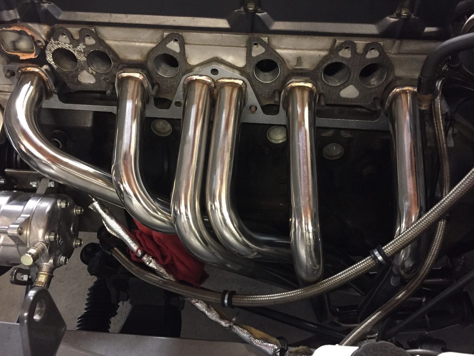

February 12, 20178 yr Author comment_512630 Did a test fit this morning of the header. Fit is excellent and no problems dropping in place.Don's iPhone using Classic Zcar Club mobile Link to comment https://www.classiczcars.com/forums/topic/56854-z-story-exhaust-on-a-stock-240/?&page=2#findComment-512630 Share on other sites More sharing options...
February 12, 20178 yr comment_512663 Looks very neat and tiday down there paintjob soon and is that a PRC belt I see ? Link to comment https://www.classiczcars.com/forums/topic/56854-z-story-exhaust-on-a-stock-240/?&page=2#findComment-512663 Share on other sites More sharing options...
February 12, 20178 yr Author comment_512666 Yes it is. Test fitting an AC compressor for the addition of AC to 240's with different headers and best way if routing the refrigerant lines away from the header. Your day must about over? Did the Loire valley chateaux and Paris in 2015 and need to go back. Paris is a perfect add on/stop over on our Eastern Europe plans later this year. Don's iPhone using Classic Zcar Club mobile Link to comment https://www.classiczcars.com/forums/topic/56854-z-story-exhaust-on-a-stock-240/?&page=2#findComment-512666 Share on other sites More sharing options...

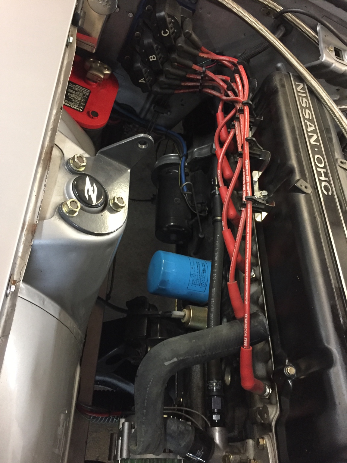

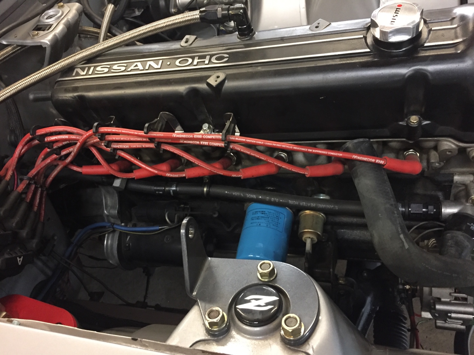

February 20, 20178 yr comment_513403 I notice your distributorless. What Ignition are you running. Coil pack reminds me of an old electromotive tec2. Link to comment https://www.classiczcars.com/forums/topic/56854-z-story-exhaust-on-a-stock-240/?&page=2#findComment-513403 Share on other sites More sharing options...
February 20, 20178 yr Author comment_513427 This is a friends car. He is running individual throttle bodies and a crank ignition system. It is a three coil pack system. He calls it a "waste system" because each coil fires on two cylinders i.e.. six and four, etc. because when it fires on six, four has no compression and the spark is wasted. He has also built a 280 with individual coil packs on a fuel injected engine. Ps that car is "Gold Award" winner. We were test fitting Sean exhaust to make sure it didn't interfere with his throttle bodies. I still haven't retrieved my car from it winter home. It snowed last week and it's garage space is occupied by a C1 Vette. Don's iPhone using Classic Zcar Club mobile Link to comment https://www.classiczcars.com/forums/topic/56854-z-story-exhaust-on-a-stock-240/?&page=2#findComment-513427 Share on other sites More sharing options...
